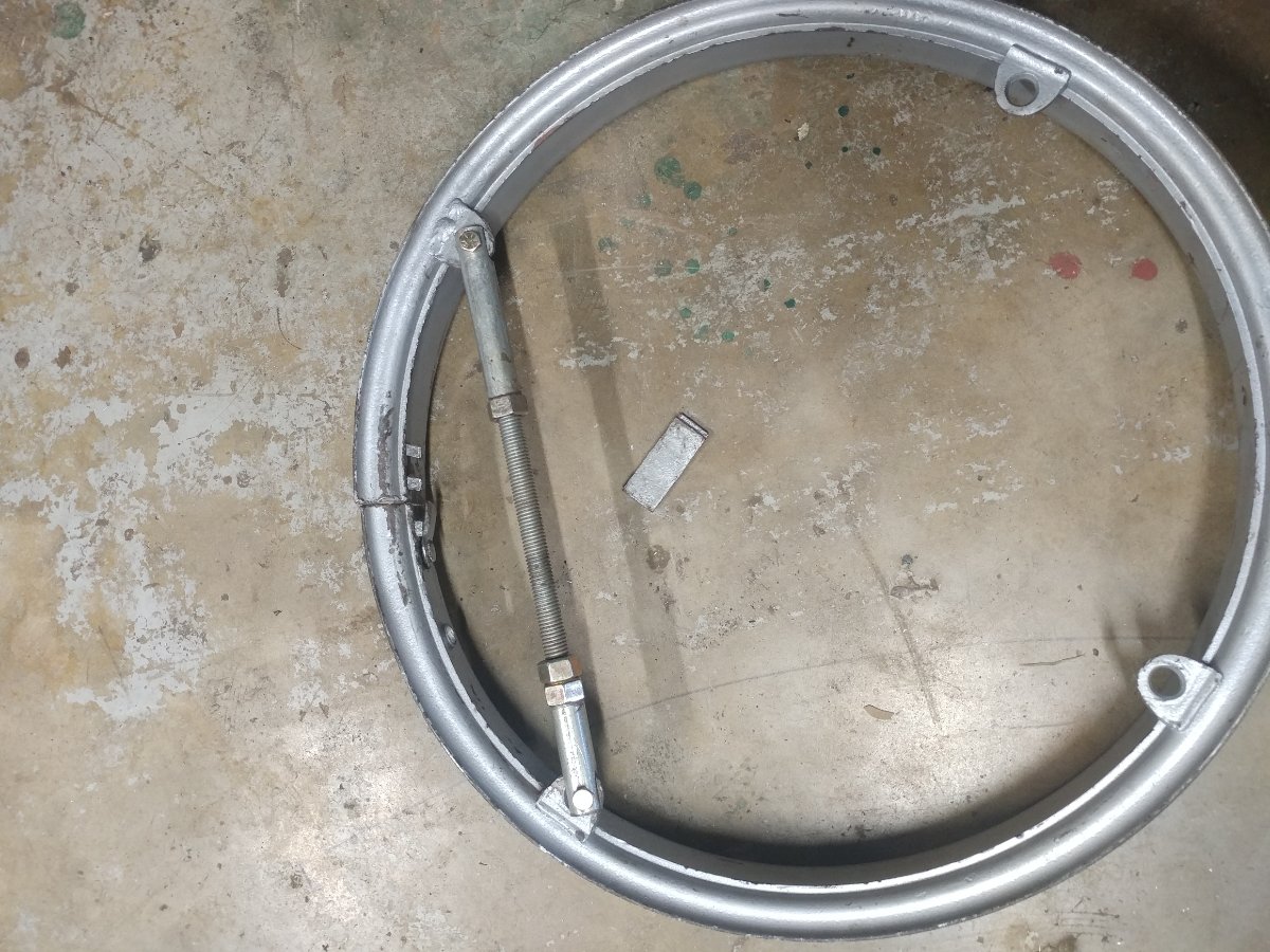

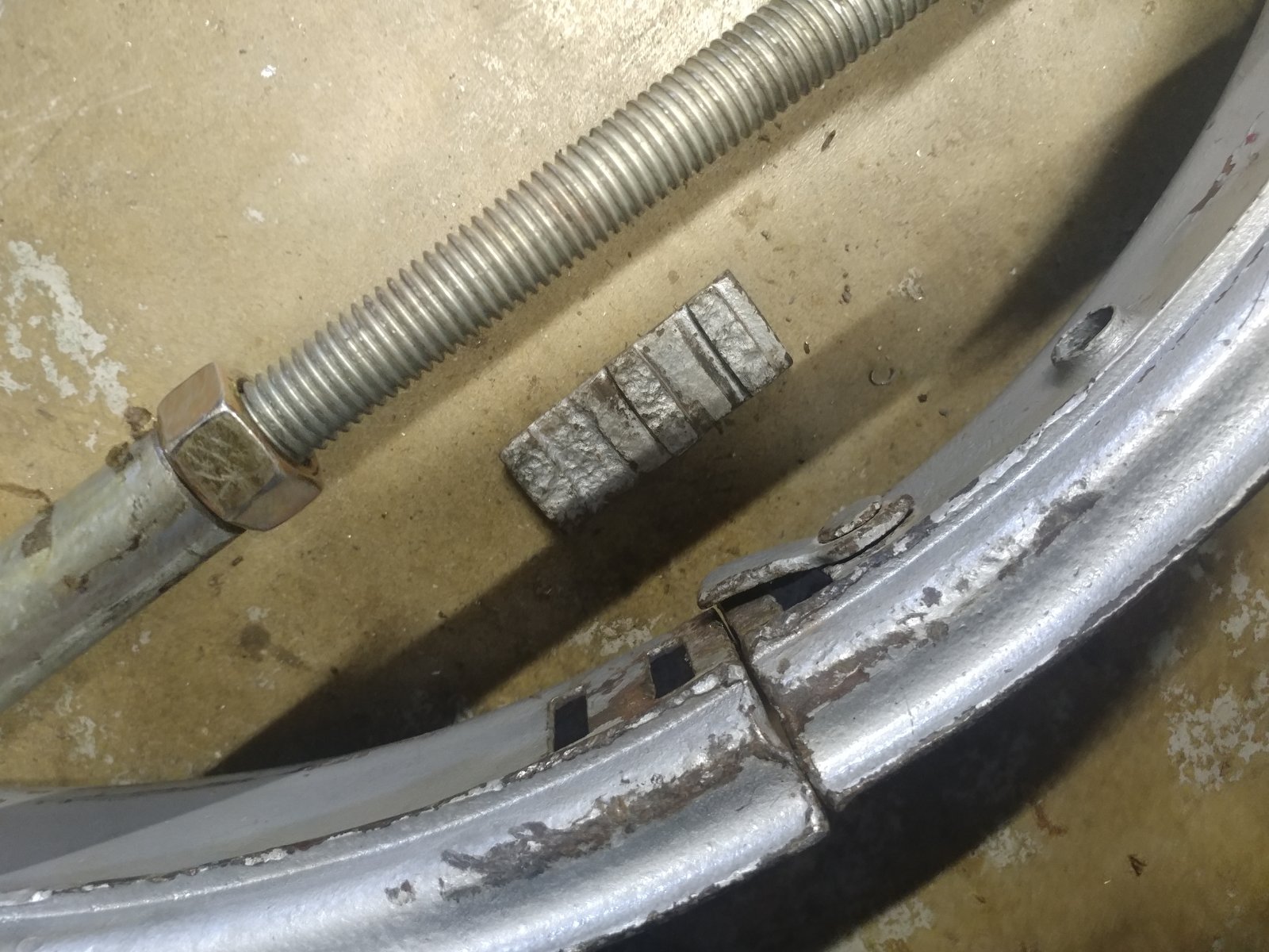

Is this rim lock supposed to be attached permanently to the rim. Ive spent 3 days trying to get the tire mounted and no success. I am using a spreader as pictured but the rim wants to twist and will not align as it should. Words of wisdom welcomed.

Yes that loose piece was made part of the rim, riveted or welded in place. Some rims no matter what you try, are sprung. Sometimes, if you can get the tire on and latched it will be ok once you get it on the wheel and inflated.

Those 21 inch model T split rims are made of fairly soft steel. They get warped easily by misuse of rim spreaders, tire irons, and other pressures applied for a variety of reasons. The flip side of that, is that they are not difficult to straighten. I draw an appropriately sized circle on cardboard, it makes it easier to see where the tweaks are needed. I use the tongue of my trailer as a solid point and fulcrum to carefully push the rim back toward round. They are usually not hard to get really close to right.
The piece of the rim clip/lock is supposed to be permanently attached. Two rectangular bumps on the one side of the piece should fit into two rectangular holes on one end of the round rim. Originally, these were neither riveted or welded into place. They were put into place and the rectangular "bumps" were staked (hammered, punched, sort of like a rivet?) on the tube side of the rim. That was all that held them in place. Once they work loose, and fall off, the easy fix is to weld (or braze) the clip in place. Sometimes a little grinding is necessary to fit it into place. Once everything is together properly, the tire mounted and rim expanded and snapped in place, the little lever/handle on the other end of the circular rim can be turned (doesn't move much!) to safety lock the clip and hold it until aired up and mounted on the wheel.
Steve T's suggestion to only air up to 10 to 12 psi until mounted on the wheel is a good idea. At least until you are more familiar with these things, and know that particular rim will hold like it is supposed to. As I said, these rims are a bit soft. And even if they look really straight? Sometimes they can still be tweaked just enough to snap apart when they are not supposed to.
