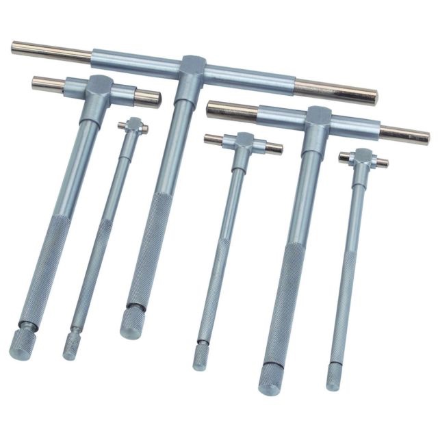

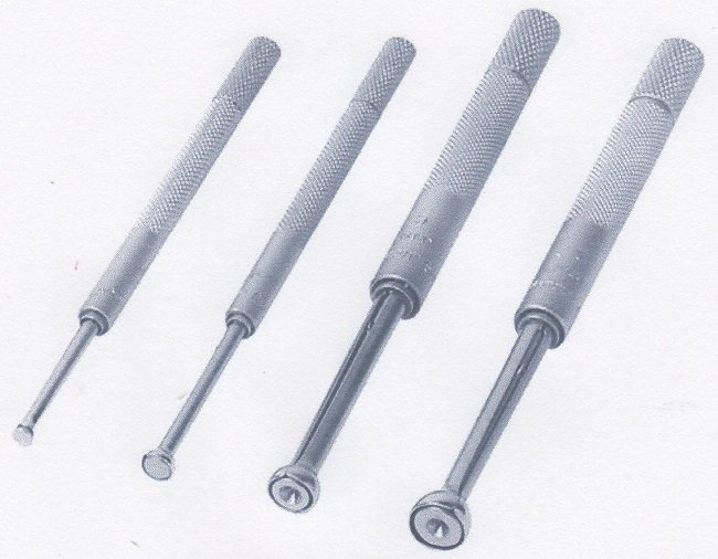

How did you measure the guides? I have never figured out how to measure the ID of a small bore. Thanks.

Re: Valve guide clearance
There's various styles of bore gauges.
This is the less expensive type...
Thanks for the reply, Dan. I have those, and can measure the larger bore diameters like cylinders. But how do you measure a small bore like valve guides? He said he was measuring a consistent .317". That is a much smaller diameter than can be measured by one of the telescoping bore gauges that you show.
One set I have goes down to 5/16"...Steve Hughes wrote: ↑Fri Jan 25, 2019 4:32 pmI have those, and can measure the larger bore diameters. But how do you measure a small bore like valve guides?
Some go down to near zero, but those are a little pricey...
I was editing my post while you were typing. I had no idea that there were gauges like that that were so small. I will have to check to see what my smallest gauge will measure.
Just checked my gauges, and my set does go to 5/16". I'll be darned. Learned something today. Thanks for the input.
Ball gauge per Kerry is the tool to use. Measure top, middle, bottom of the bore. Mic the OD of the fixed gage when withdrawn from bore.
Scott, wouldn't the other style show out of round better ?Scott_conger wrote: ↑Fri Jan 25, 2019 5:11 pmBall gauge per Kerry is the tool to use. Measure top, middle, bottom of the bore. Mic the OD of the fixed gage when withdrawn from bore.
The style Frank showed would only show taper, IMHO.
Three measurements will show taper or not. Whether or not round is of no consequence, really, as the out of roundness for this particular location is minimal in any event. Simply twisting the gage in the bore will find if out of round or not if that is a real concern. These gages are not sprung like telescoping gages. They are fixed to size by wedge action of the adjuster. If it is gently snug and you rotate slightly and it goes slack, well then, you've found out of round and can fix it to that size and measure it. Still, the problem is "is it oversize and by how much?", not "is it round?"
I can agree with that, but either style will give you a close enough reading. If Steve has the telescoping version, I see no need to get the others.Scott_conger wrote: ↑Fri Jan 25, 2019 5:34 pmThree measurements will show taper or not. Whether or not round is of no consequence, really, as the out of roundness for this particular location is minimal in any event. Simply twisting the gage in the bore will find if out of round or not if that is a real concern. These gages are not sprung like telescoping gages. They are fixed to size by wedge action of the adjuster. If it is gently snug and you rotate slightly and it goes slack, well then, you've found out of round and can fix it to that size and measure it. Still, the problem is "is it oversize and by how much?", not "is it round?"
Dave
for this application, I agree with you. However, the ball-type is a fixed wedge and once set to a measured size will not alter itself one whit. Telescoping gages are best used where they can be made "large" and inserted to the bore then swept from side to side so that the "smallest" size is recorded by the gauge. Real care is then exercised to not bump them to close them or allow them to re-expand and give false reading in any case.
I would never take the first reading of a telescoping gage as gospel...I'd take multiple readings to ensure correct and careful use. The ball gages are far less suceptible to to error or eroneous use. For small holes that I must have an accurate reading, ball gages are my go-to tool.
