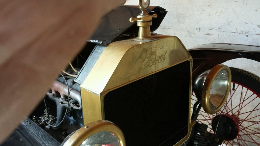

Dressed up with extra brass to look like a 1915. As Steve T says, it depends on the mechanical condition. I paid $8500 for my 1915 runabout, but it needed lots of fixing.

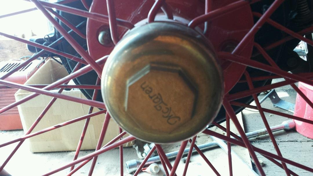

I am new to the craft. I have a 1916 Touring. I thought the wire wheels were much later. Can someone please comment on the variety in 1916?

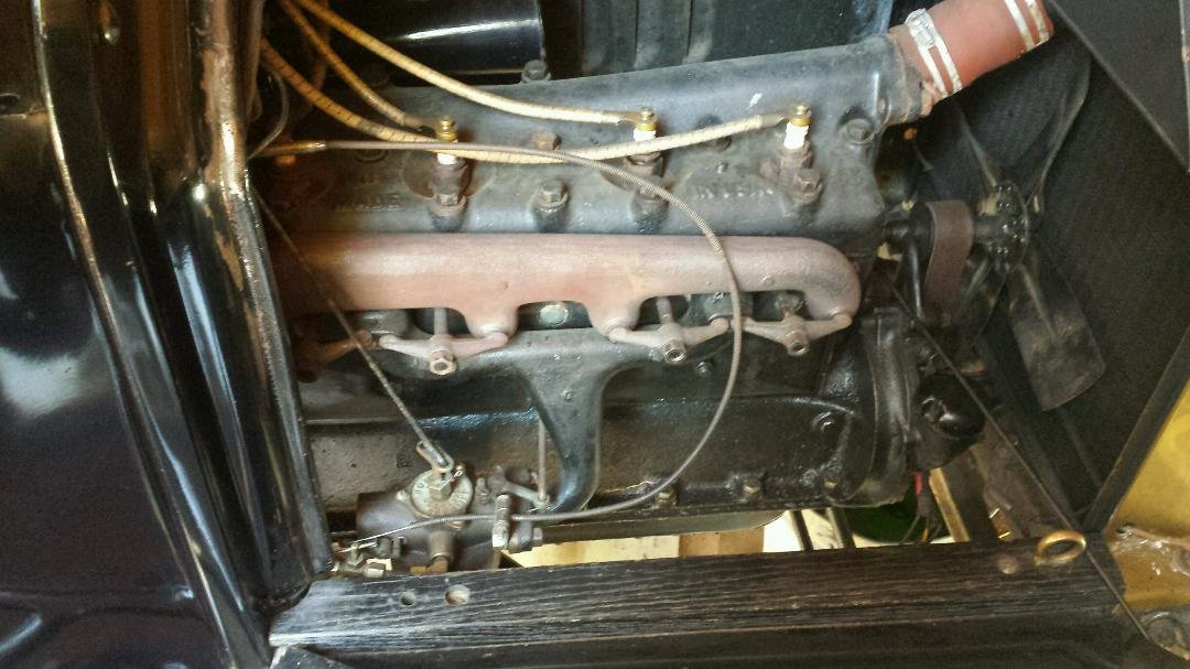

Although that car has a lot going for it such as the aftermarket wire wheels, be aware that the body is 1917 or later as the cowl has a notch in it.
It's possible that the car started life as a 1917 Ford and it has been dressed up to look like a 1915/16. Note that a block with a serial number from August through December 1916 would be in the 1917 model year.
Yes, Ford got around to supplying wire wheels as an option in 1926 and standard in 1927. Before that there were aftermarket wire wheels made for Fords by Buffalo, Dayton, and other companies. Factory supplied wheels for 1915-1916 have rounded wood felloes and were painted body color (black). They are 30 x 3 in front and 30 x 3½ in back.
The first picture on this page shows a 1915-1916 wheel: http://dauntlessgeezer.com/DG113.html

Mike...look in the 2nd pic of the 2nd bunch..right above the coil box. I noticed it too and thought "uh-oh"..another one. I have seen other 15' s for sale with the same. Happens a bit.
