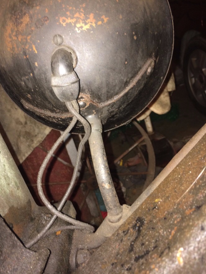

To me the earlier lamp posts are normally fairly free of heavy grooves, as the fenders are away from the lamp posts. Some may have bending marks if previous owner used pipe wrench to set the bends. Most are rather nice.
To say the Ford headlamp post had any factory defect wouldn't be proper IMO.
What you do see in the later style fenders, when the fender hole rides onto the post, that happens when the fender sags. The fender bracket bends and pulls the fender onto the post.
Add some vibration and wiggle that the fenders do on the T and.....presto...you'll have a deep groove in the lamp post
