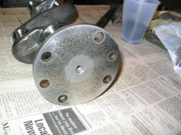

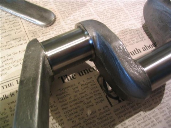

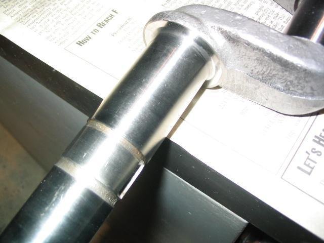

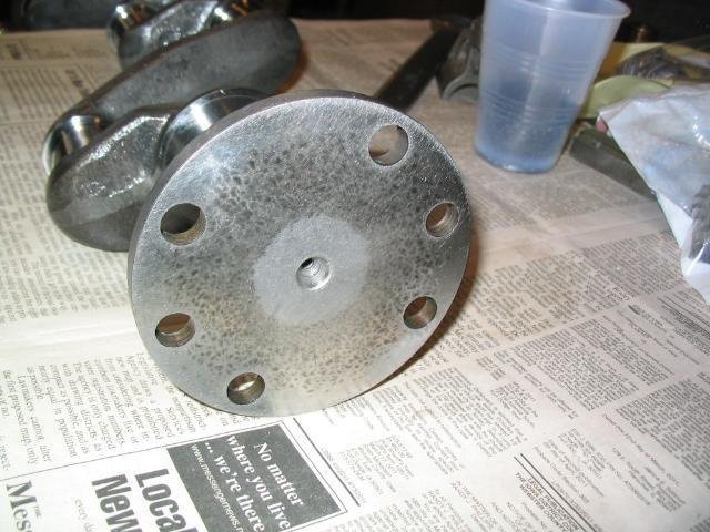

BobShirleyAtlantaTx wrote:
Tue Oct 01, 2019 8:57 am
What is the preferred radius of a T crankshaft? Thanks for your time and help. Bob 903 824 1949
It has an 1/8th, .125 inch Radius. No bigger, or smaller. Rods, and mains should be cut that Diameter, also, or you will have a mating problem.
A 2" Radius, should be closest to a 15" Diameter crank.
Her.
