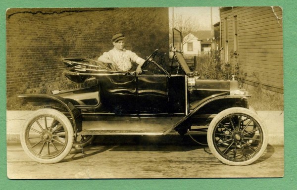

Post by keqwow » Wed Oct 02, 2019 3:07 pm
This is perhaps the clearest photo I have a '13....definitely no striping on the runabout body...but definitely on the wheels.

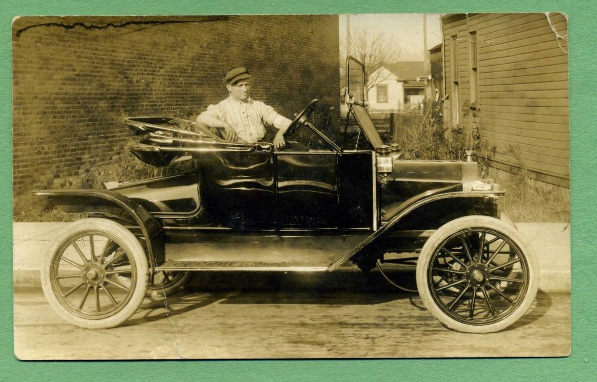

Post by keqwow » Wed Oct 02, 2019 3:10 pm
This one is relatively clear as well...no body stripes, but you can see them on the wheels.

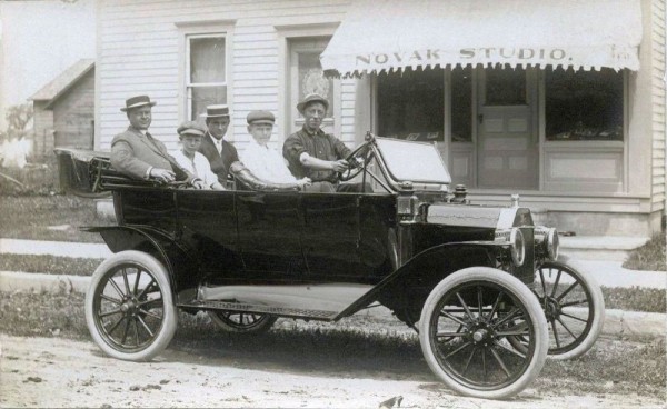

Post by Darren J Wallace » Wed Oct 02, 2019 3:47 pm
My car was built in late September early October of 1912, and was striped, and it was painted blue. I had this photo colourized and it comes out blue but I don’t have that photo handy. This picture is from 1929, original owners daughters wedding. I’ve posted it a million times😊
