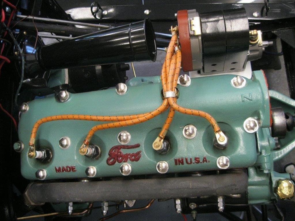

Post by sportbingo » Thu Oct 10, 2019 5:49 pm
bosch magneto for ford car.jpg (53.61 KiB) Viewed 24555 times
Smaller Bosch Magneto system ResizerImage430X420.jpg (55.19 KiB) Viewed 24555 times

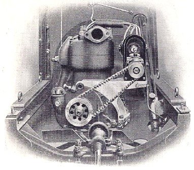

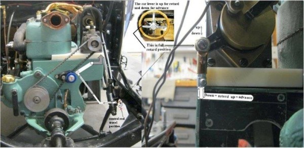

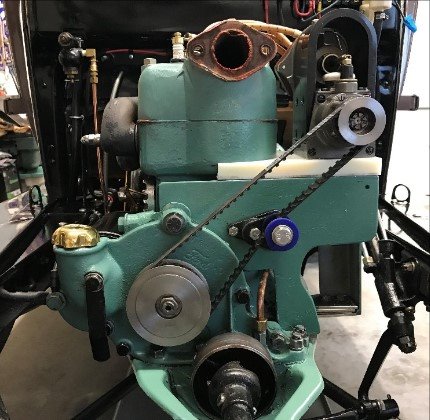

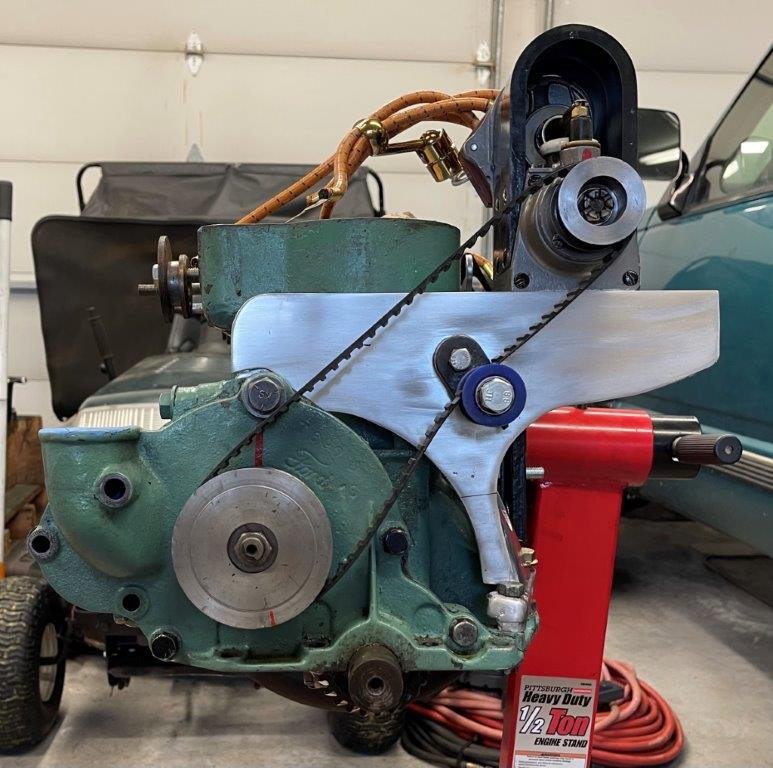

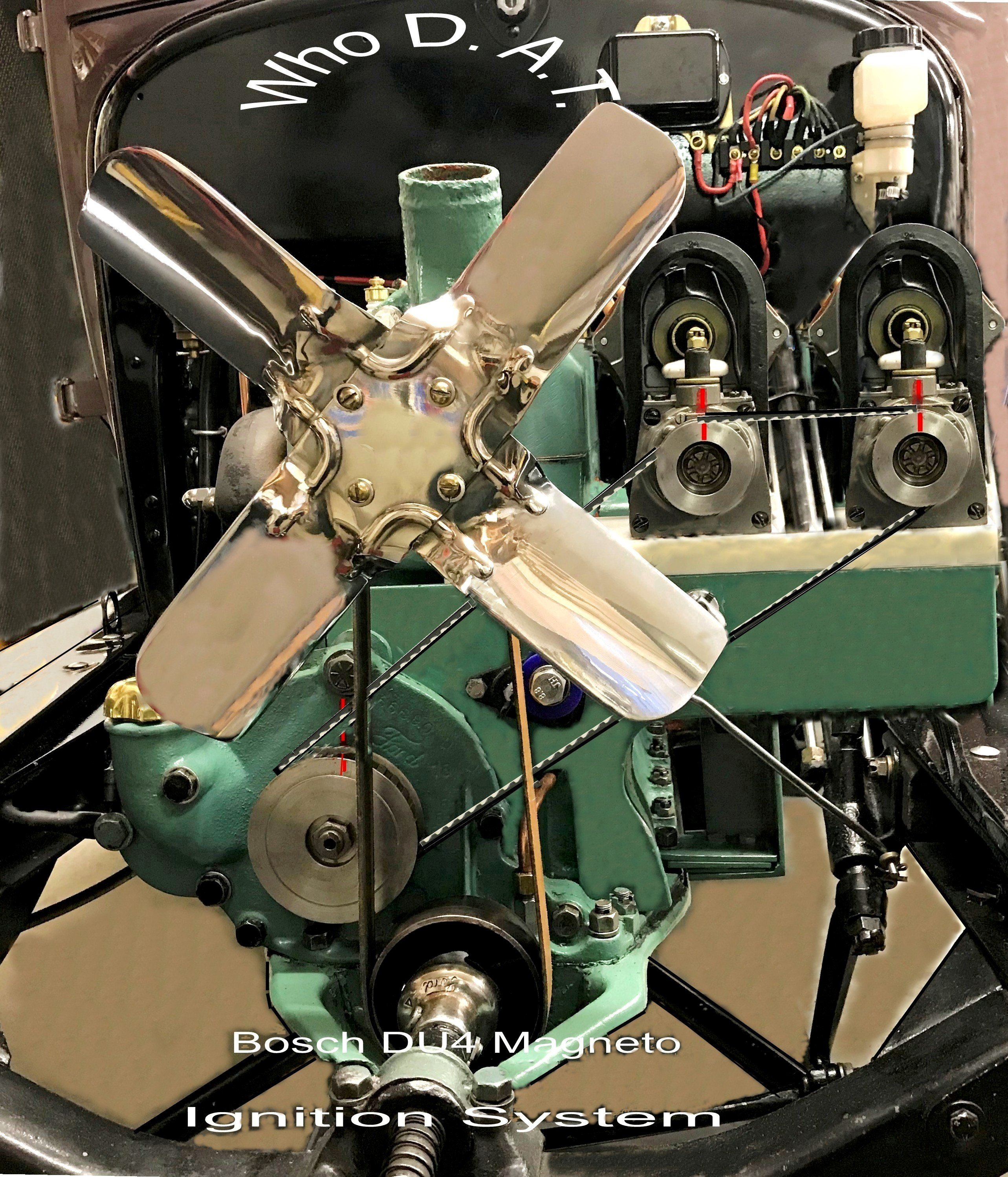

Bosch Magneto 1910 Chain Drive System vs Bosch Magneto Modern Belt Drive System
Around 1910 Bosch built gear and chain drive attachments. Their desire was to add efficiency and reliability for Ford owners. They fitted High Tension Magneto DU4 to the Ford engine. I wanted to do the same to my 1926 Tudor but I had a restriction with keeping my generator on the gear setup side. Therefore, I chose the chain/belt drive system.
My plan was to have the camshaft setup with two pulleys, one on the camshaft and the other on the magneto (with neoprene timing belt between each). I know the pulley system is not authentic or correct for the 1910 chain setup. It’s more modern than most Model T people would like, but it makes a lot of sense to improve the performance of the car. The timing belt has a lots benefits for example very little wear; no noise; no oiling/lubrication to the chain; no chain whipping; the neoprene belt body protection against grime, grease, oil and moisture; and gives a positive slip proof engagement. The Pulley/Belt System has a “PowerGrip-Timing” pulley made of fiberglass; high strength belt; high HP capability; and nylon tooth for long belt life.
The Bosch Magneto has lots of numerous benefits alone, example hotter spark; more power; better gas mileage; a lower throttling of the motor; eliminates complicated wiring (only five wires required, 4 spark plugs, and a kill switch or ground wire); and eliminates frequent filing and adjustment points.
It took me almost two years to design and build belt drive system. I had a lots of help from friends and Model T Members of the Forum. I would like to thank the following people below:
1. Steve Tomaso (RajoRacer)-Longbranch WA
2. Seth Spratin (Wreckrod)-AL
3. Roger Karisson-Southern Sweden
4. Steve & Debbie Belanger Maine-Mainely Magnetos Belanger’s Auto Electric INC. (rebuilt Mag)
5. Howard Kingford-Smith-New Zealand
6. James Pringle-Scotland
7. Jim Boyland-Whidbey IS WA
8. Eric Snow-E T Precision Machine-Whidbey IS WA (machine/weld)
9. My Wife Dorothy-Whidbey IS WA
10. My Son Mark-Whidbey IS WA
It takes village! Thank You All!

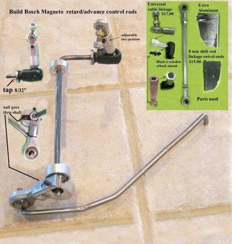

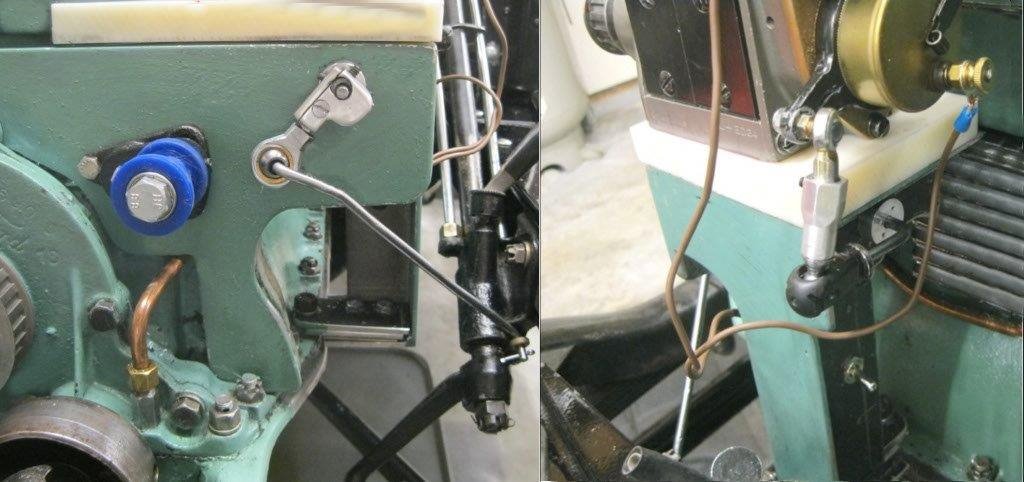

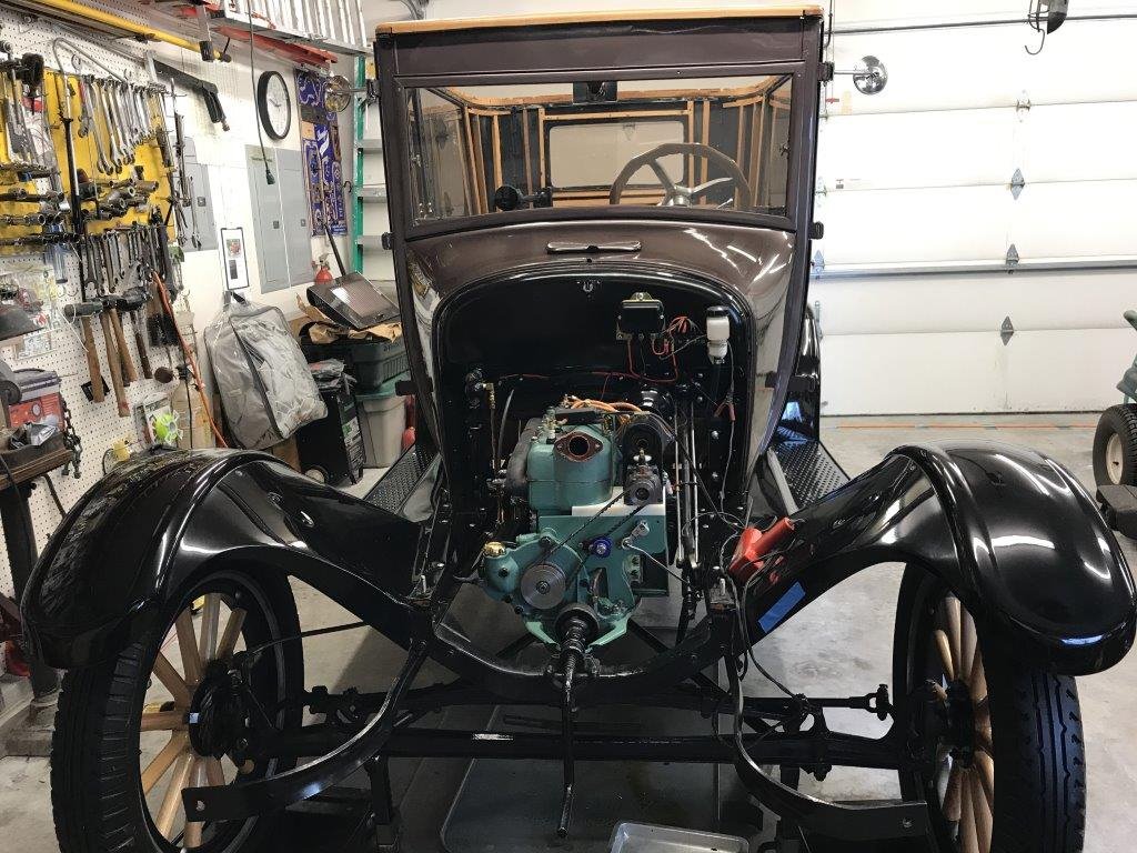

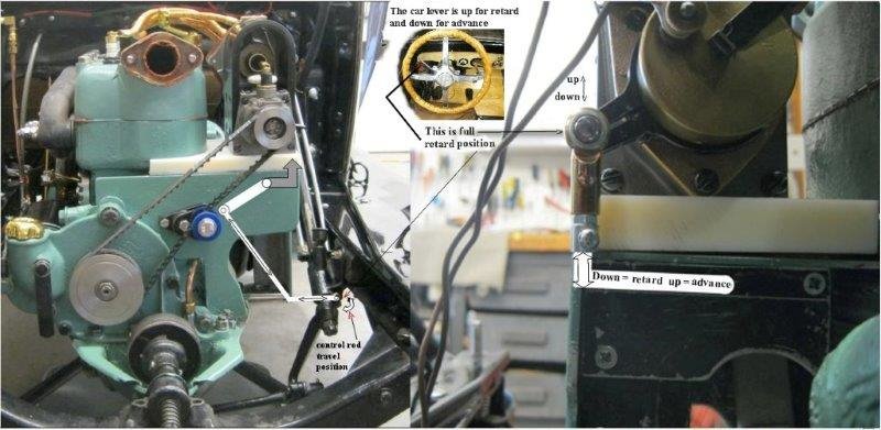

The engine runs great! I still have some remaining work such as the building a control rod for retard/advance; painting; and general cleanup.
Art Taylor (sportbingo)

Not sure if I should mention this as it is complete but would it be possible to add a second pulley on an adjustable cam? The current tensioner would ensure everything is tight and the movable pulley would allow for an advance or retard on a mag that doesnt have an advance.
Posts: 5552
Last Name: Gregush
Location: Portland Or
Re: Who D.A.T. Ignition System
Post by Mark Gregush » Thu Oct 10, 2019 8:21 pm
LIKE! Never thought about running off the camshaft. Most that I have seen seem to run off a gear on the pulley, or look that way. Thanks
Don't see much difference than running a modern Gates fan belt.
Art, that is exactly why I used a timing belt to retrofit a distributor on my dead magneto ’26 T.
Nice job! Will be interested to see how it performs.

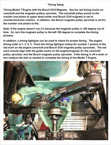

Building A Bosch DU4 Magneto Pulley Belt Setup.

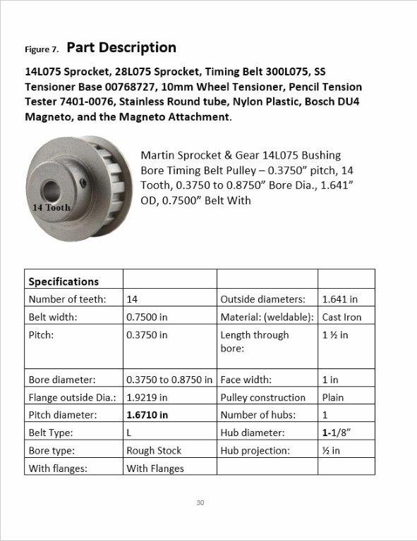

Let’s start off with discussing the elephant in the room. The cost of the items:
1) Bought Bosch DU4 magneto on EBAY $155.00.
2) Rebuilt Bosch DU4 magneto (Counter Clockwise) for $563.68
3) Purchased 10mm chain wheel Tensioner $11.99
4) Purchased SS base tensioner $26.00
5) Purchased 14 tooth gear pulley sprocket $34.14
6) Purchased 28 tooth gear pulley sprocket $71.48
7) Purchased timing belt $23.40
8) Purchased stainless round tube for camshaft $15.60
9) Purchased natural nylon cast sheet shimming bracket $52.86
10) Purchased 7’ foot spark plug wire and brass connector $18.00

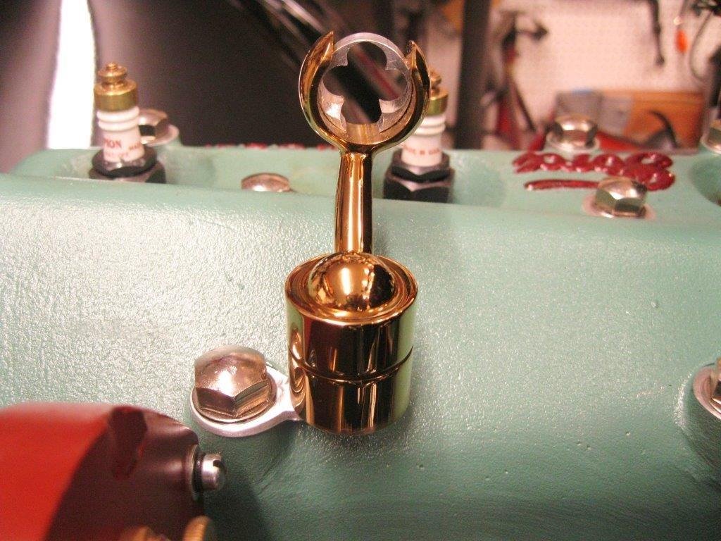

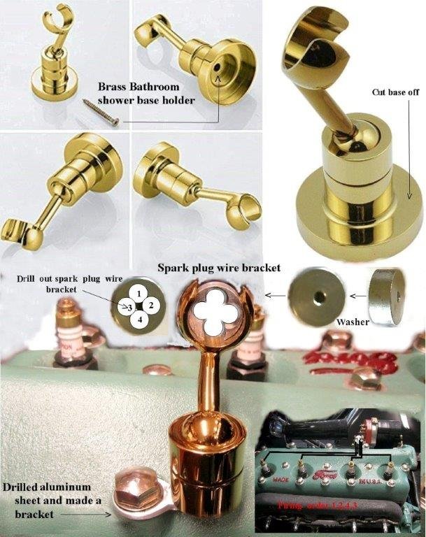

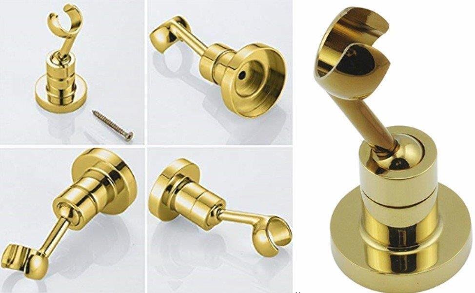

11) Purchased Brass TINTON LIFE Universal Bathroom adj. shower head wall mount holder base org spark plug $16.97
12) Optional purchase pencil tension tester $23.22
13) General bolts, nuts, drills, skill saw blades (guess) $30.00
14) Salvage yard purchase street aluminum light fixture $50.00
After, spending better than $1,092 dollar I still didn’t have a turn-key working setup. Each task requires doing my homework. One of the main problems I experienced was that no one had built a setup on a Model T Ford using a pulley sprocket belt system. So, the only guide/design was using the 1910 Bosch chain drive setup.

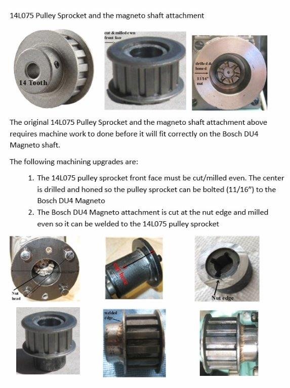

5) Building of the bracket based on my research and using Bosch chain drive setup as a guide.
6) Research and modification of the pulleys, belt, and tensioner using the original chain drive setup.
7) Machining and welding the pulley sprocket and drilling the pin location hole camshaft.

9) Final looking at design of the retard and advance of Bosch Magneto.

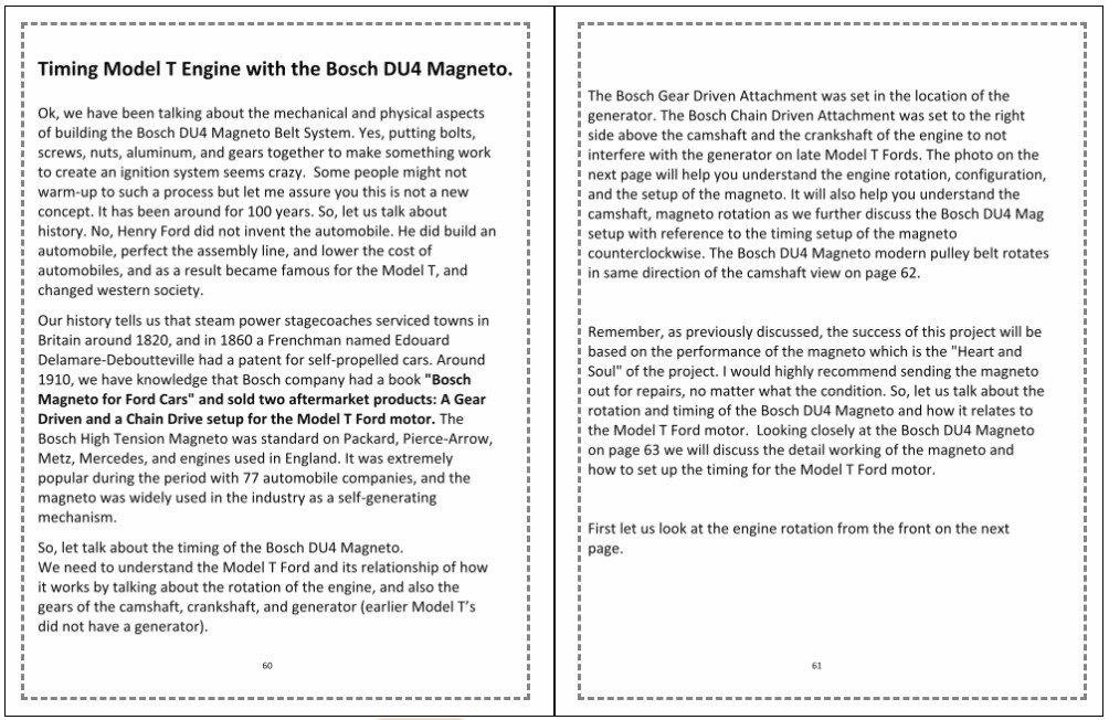

First stage of building the Bosch DU4 Mag Pulley Belt Setup documentation.
I researched all aspects of this project. Note: In all cases I gathered information, for example books and documentation from the Model T Forum about the subject Bosch Magneto.
1) I purchased a book titled “BOSCH MAGNETO for FORD cars.” This book has a section on “Installing the Chain Drive Attachment” pages 11 thru 12. You can view the book online by “CTRL CLICK” on the address below:
https://www.bing.com/images/search?q=bo ... &FORM=IGRE
a. Book items of value pages 3-4 benefit of the Bosch attachment.
b. Book items of value pages 8-9 timing & high-tension connection.
c. Book items of value pages 14-15 picture of the bracket parts.
2) I used the search in the Model T Forum “Bosch Mag” for any article about the subject.
a. When I got a hit and it was of interest, I saved it in my binder.
b. Some of my contacts were made in the USA. Other contacts using a chain drive setup which is odd was made oversea in Southern Sweden, New Zealand, and Scotland. In all cases I asked for pictures, of the bracket, Bosch magneto timing, performance, and trouble shooting
c. Two Binders were created as follows:
a. first collection all information related to the Bosch subject;
b. second a technical document of tasks needed to be accomplished, pictures of progress showing task completion, and part manufacturers specification/order confirmation/shipping manifest.

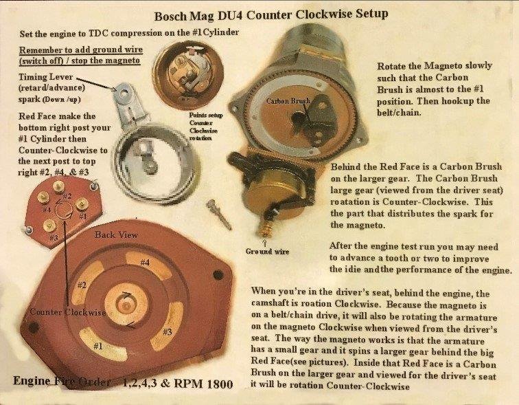

c. Finally, Bosch Magneto DU4 Counter Clockwise Setup diagram/layout.
YouTube video on Documentation ‘ctrl-click’ below:
File name= 1080p Model T Ford W pulley belt setup documentation
Address =
https://www.youtube.com/watch?v=ig8fsIZhsPE
Note: If you haven’t seen the YouTube video of the Bosch Magneto Pulley Belt Engine running
‘ctrl-click’ below:
Address =
https://youtu.be/Cg-1Kqr7dts

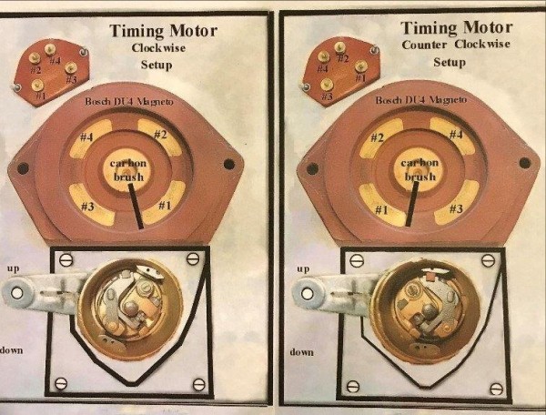

Second stage, the purchase of a Bosch DU4, repair and setup.
After purchasing the Bosch DU4 Magneto off EBAY for $155.00 dollars. I proceeded to clean all the grease/oil/grime off the magneto. My main goal was to send the magneto out for repair no matter what the condition. The success of this project will be based on the performance. The magneto is the “Heart and Soul” of this project.
IF THE MAGNETO FAILS THE PROJECT FAILS.

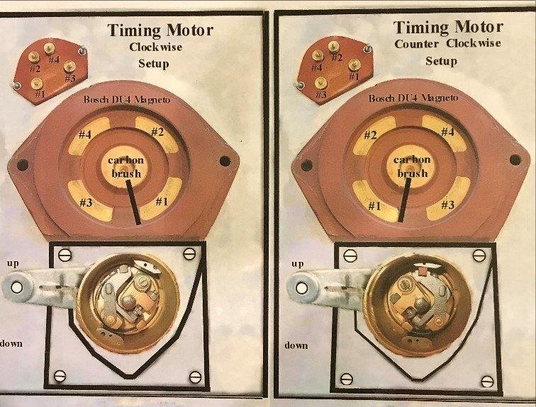

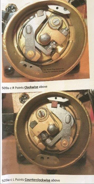

My research of the magneto consisted of following phases:
1) Using the internet, to check the drawing for missing parts
2) Finding a repair company (Mainely Magnetos Auto Electric Inc.)
a. Request mag be setup to get a strong spark
a. Rewound coil
b. Replace the condenser
c. Replace the point assembly
d. Get an extra point assembly
e. Request the control arm (retard/advance) be put on the left side
f. Request the magneto be setup “COUNTER CLOCKWISE”
g. The restoration cost of the magneto was $563.00
3) Researching the Model T Forum for members who have a Bosch DU4 magneto setup on their Model T.
a. Viewing YouTube video of Magneto with a strong spark
b. Setup Magneto documentation
c. Timing motor documentation
d. Points assembly documentation
Third stage, do/don’t/using, and the servicing the magneto.
I was told by (Mainely Magnetos Auto Electric Inc.) the following:
Never connect voltage to any magneto. Always have a ground wire to (kill/stop) the engine.
Never gap the spark plug greater than 1/32”. Always use solid core wire not resistor type.
Never spin a magneto without giving the spark a place to go to ground. Always oil once a month with a (toothpick).
Never drive with the spark retarded. Always start with retarding the spark, drive with spark advanced.

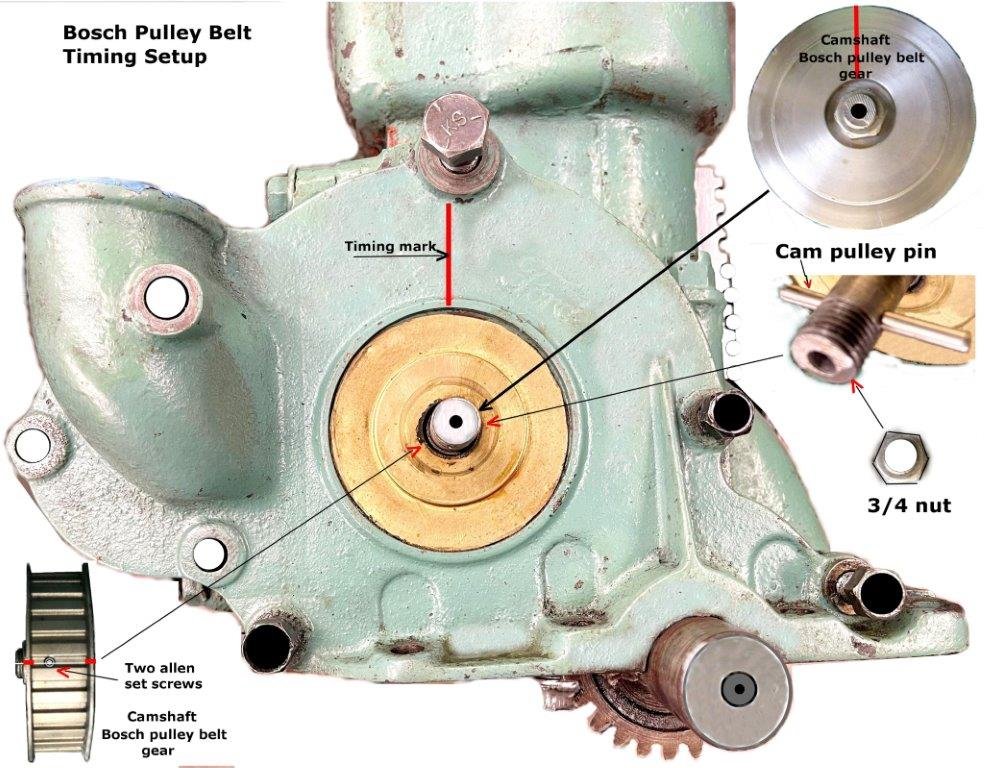

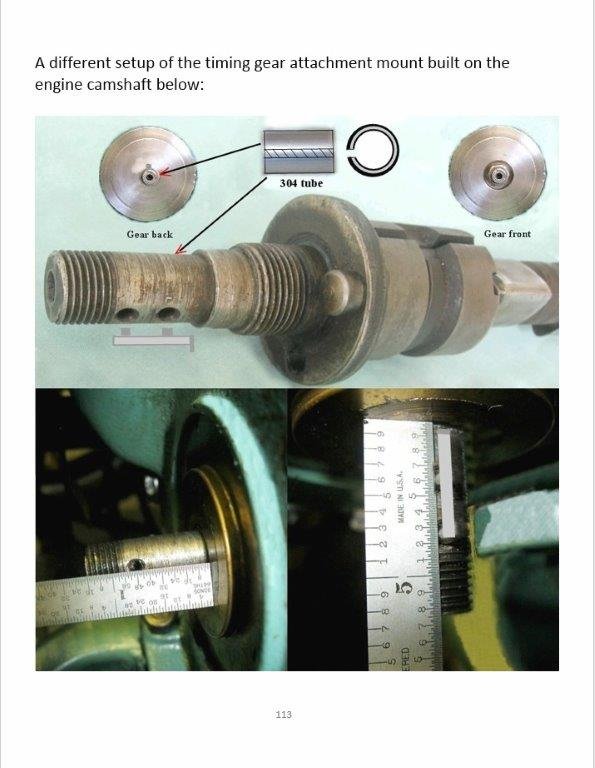

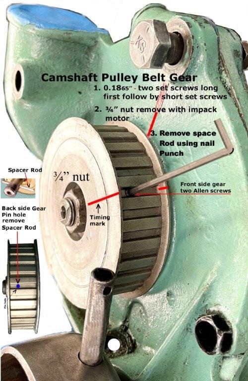

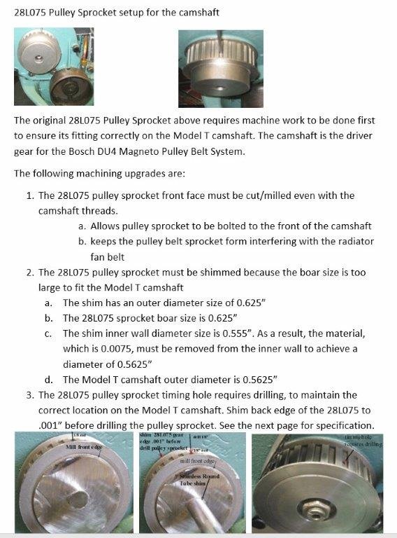

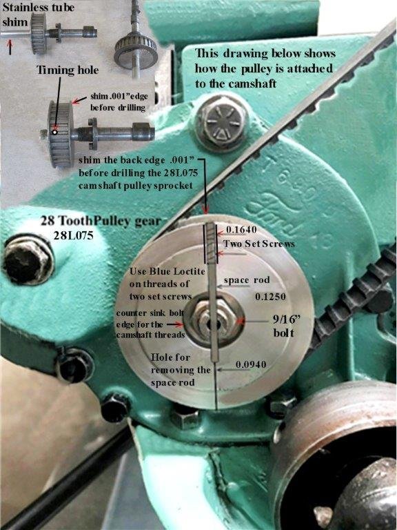

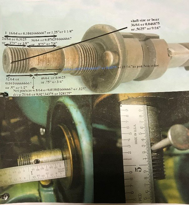

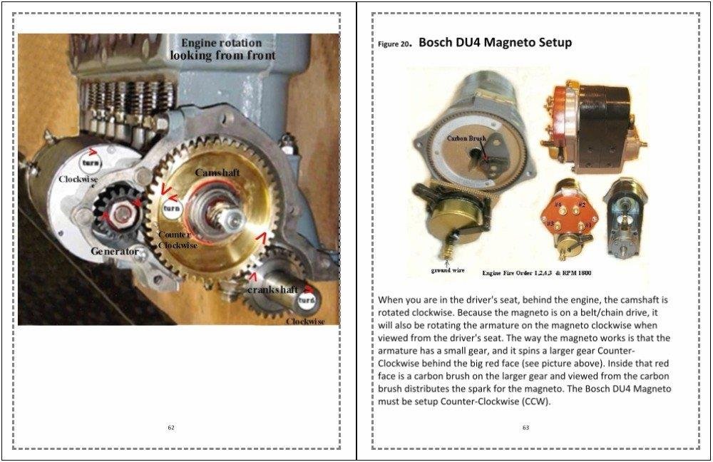

Forth stage: I researched the Camshaft outsize dia., length, location of camshaft pin, length of the threads.
The camshaft extension shaft is a very important part of this design. The large sprocket is attached to the shaft extension. The 1910 Chain Drive Setup indicates the shaft must be drilled completely thru on both sides.
The Bosch book “BOSCH MAGNETO for FORD cars” page 11, requires that the installer drills the pin hole with 5/32” drill. The pulley sprocket will have a special key to hold it on the shaft.
1) A CRITICAL DECISION MUST BE MADE TO MOVE FORWARD WITH THE PROJECT AT THIS POINT, BECAUSE DRILLING THE SHAFT CREATES A LARGER PIN HOLE. A larger pin hole will make other timing devices harder to attach without some modification. Question, “Why build the Bosch Magneto Setup”? See the benefits below:
2) I waited until the pulley sprocket was built and ready to install before I drilled my camshaft.

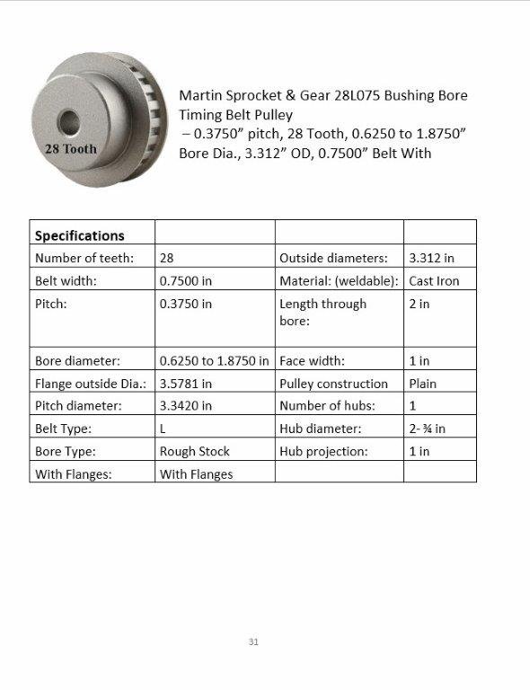

3) The camshaft pulley sprocket was sent out for machining at a cost of $280. I will cover this machine work in more detail later.
4) Note: In the second photo above of the pulley sprocket design will not extend to interfere with water/fan belt.

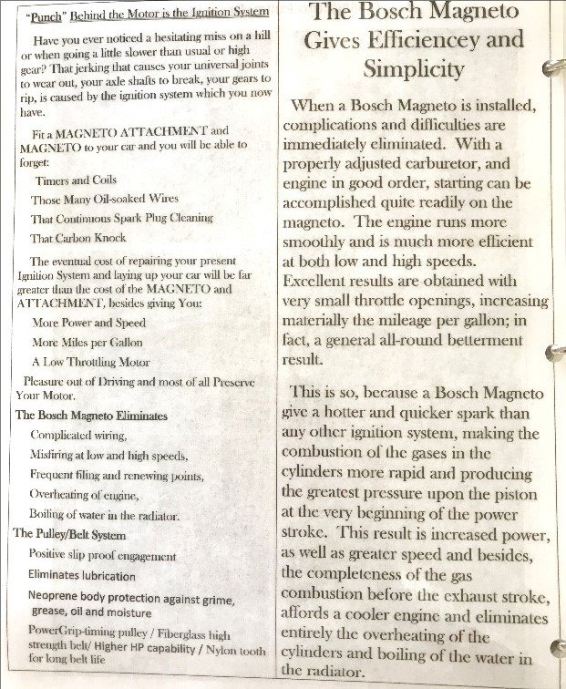

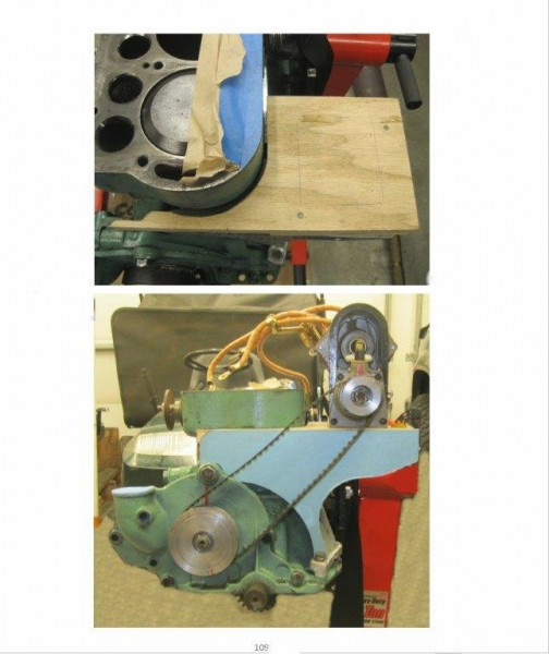

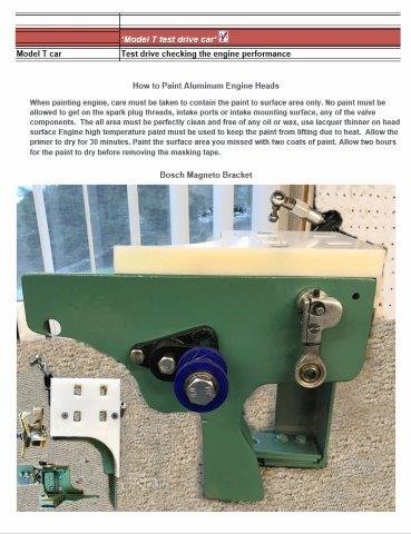

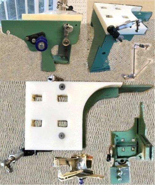

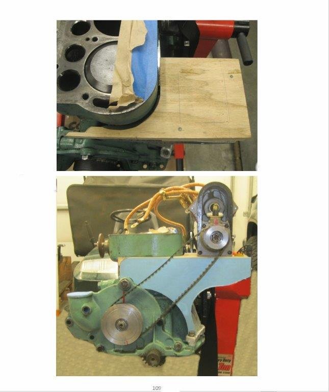

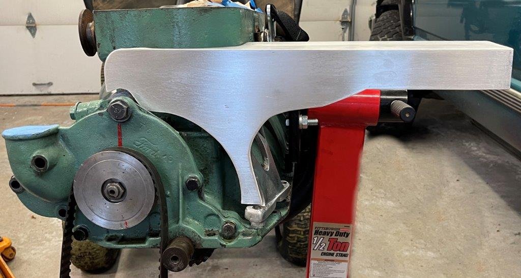

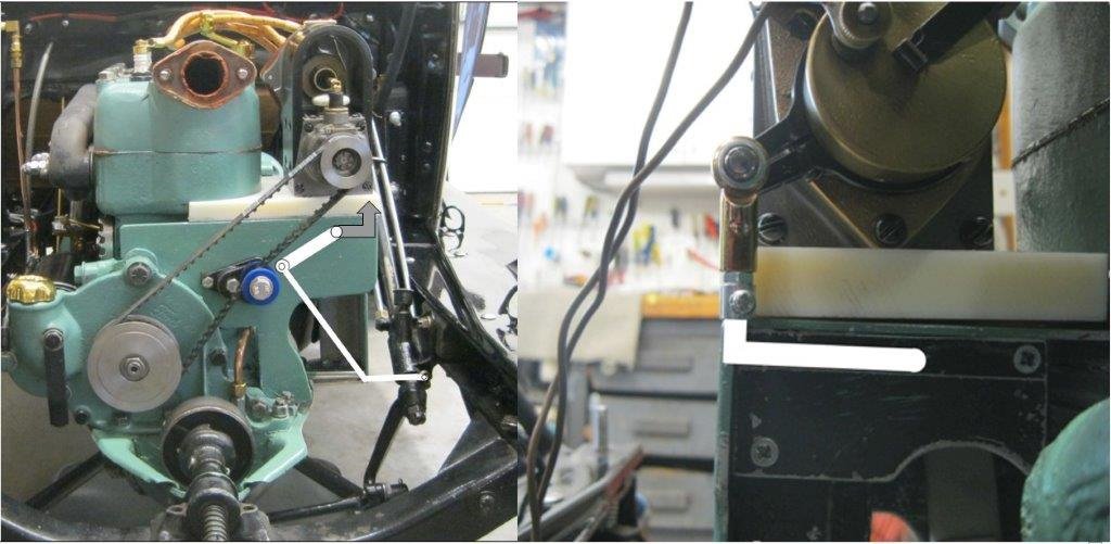

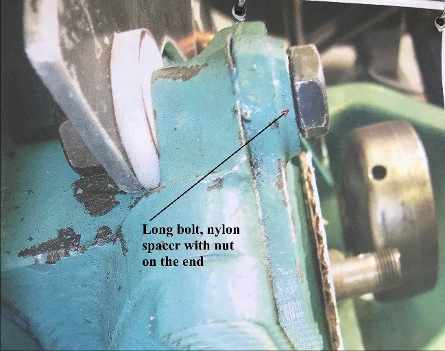

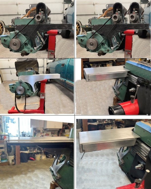

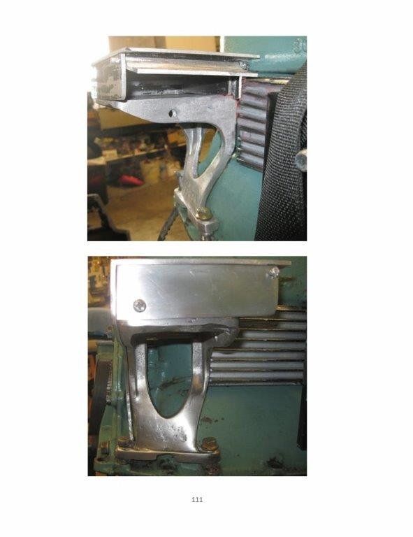

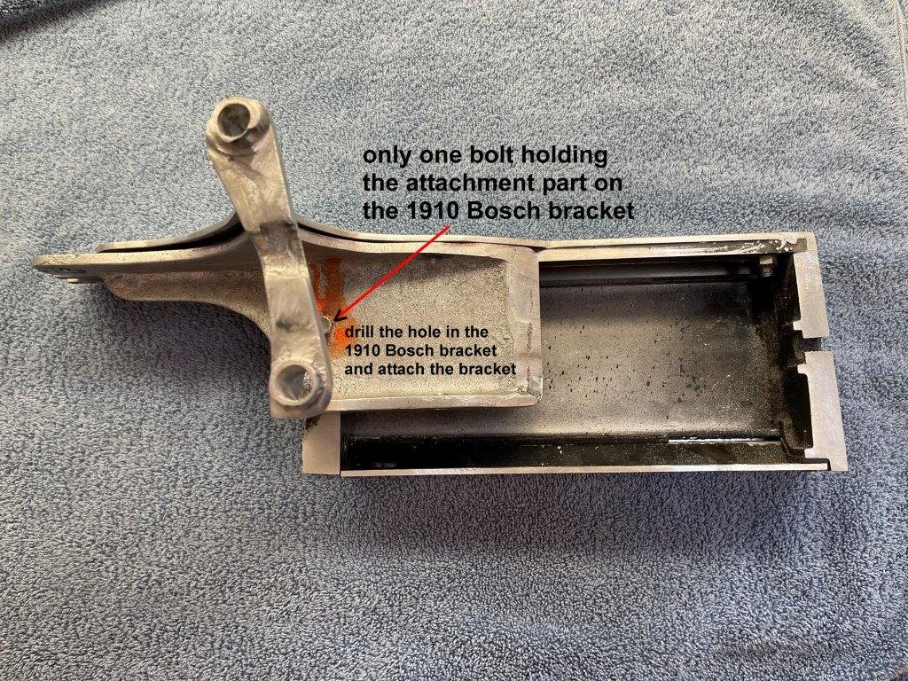

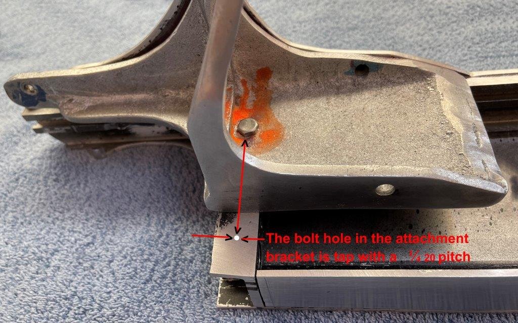

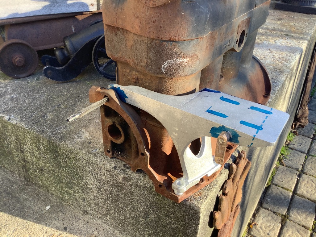

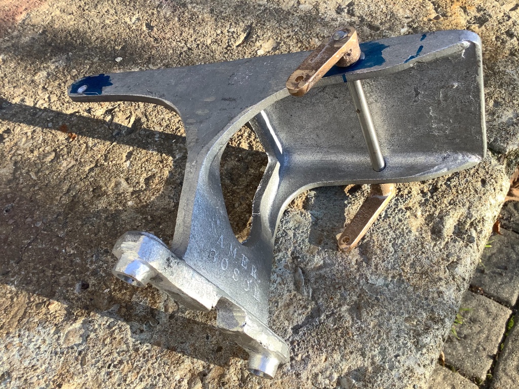

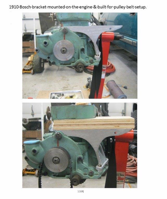

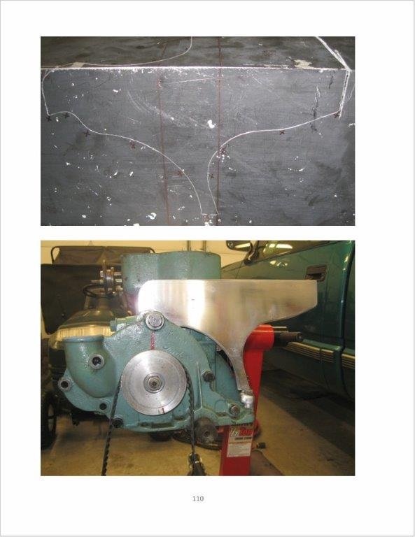

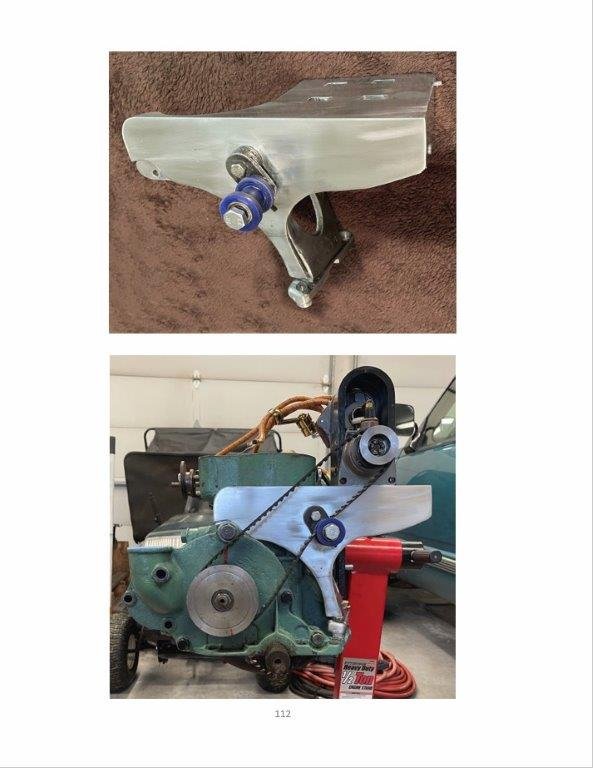

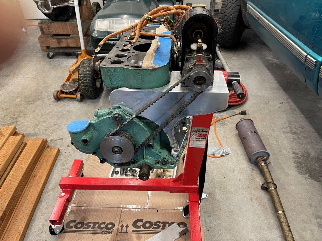

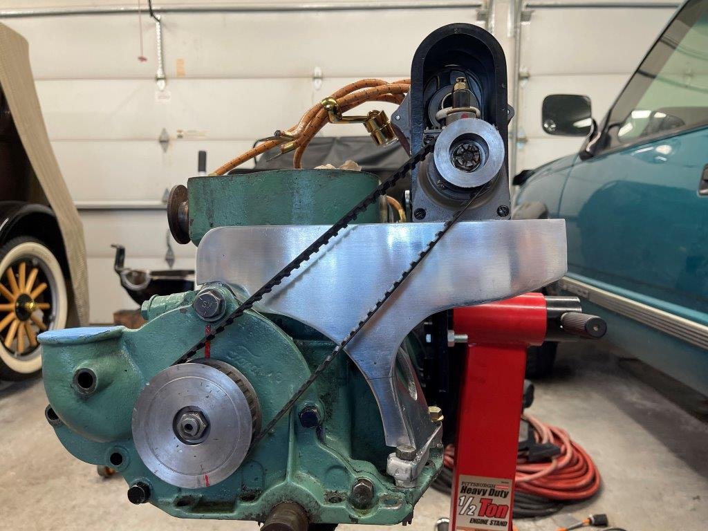

Fifth stage: building of the bracket based on my research and using 1910 Bosch chain drive setup as a guide.
Building the bracket which supports the magneto was designed by copying 1910 Bosch bracket. A larger front face to hold the belt tensioner base required some design modification
1) First, it was important that the top of the bracket be level front to back and side to side.
2) Second, it was important the bracket have three bolt attachment, (front plate, two point on the oil pan) so it will hold the magneto firmly while driving the car.
3) Third, it was important the bracket does not interfere with the water flow from the engine block to the radiator
4) Finally, it was important the bracket does not interfere with the front oiler

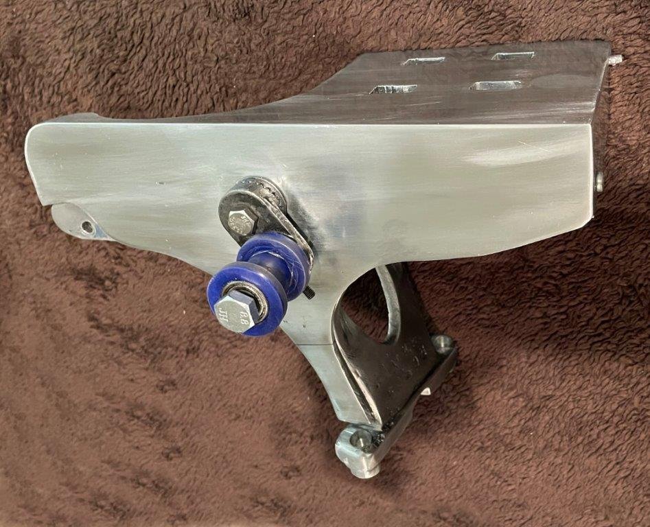

I started building the bracket base by using Styrofoam sheet 24 X 24 X ¼”, and a glue gun. When my bracket mockup was completed, I reviewed all my design requirements to see if they were satisfied.
1) Because I had no welding equipment, I chose aluminum for my base material. It is lighter and easier to cut and shape to my design.
2) After building my bracket mockup in Styrofoam I went around metal salvage yards looking for aluminum items matching my model.
3) With the help of a friend we found a streetlight which was a match of the mockup model. I bought the streetlight with the intact lamp for $50.00. Enough material to make three aluminum brackets.
4) Using my mockup templet, I made wood templets for the sides of the aluminum streetlight.
5) I proceeded to cut the aluminum streetlight to form the Bosch bracket.
6) I mounted the bracket on my engine and drove the car with the new bracket checking for a level and a solid mount.
7) Later in building/mounting of the pulley sprocket I added a nylon base to take up the belt slack.
8) The Bosch Bracket and nylon base are slotted to add bolt to bottom to hold the Bosch DU4 Magneto down.
9) The front face was drilled and tapped to hold the belt tensioner bracket.

Model T Ford Items of information
Engine Fire Order 1,2,4,3
1926 Model T Ford engine 22.5 HP
1926 Model T Ford RPM 1800

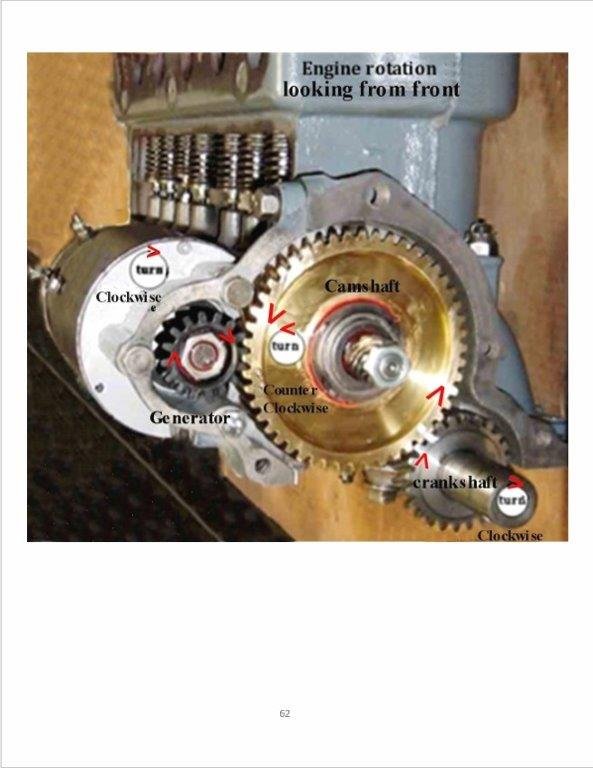

Timing the engine – set the #1 cylinder to TDC
Bosch Magneto DU4 Items of information
Stop the engine by adding a switch to ground the magneto.
From driver seat Camshaft Magneto setup Counter Clockwise
The points are left hand setup.
Camshaft gear ratio is 2 to 1
My Camshaft large gear is 28 teeth & Magneto small gear is 14 teeth
From driver seat Crankshaft Magneto setup Clockwise
The points are right hand setup
Crankshaft gear ratio is 1 to 1
The PowerGrip timing belt tension is 12 force pounds

The Bosch Magneto stage 7, 8, & 9.
Purchase of wiring for the engine and building a wire collector keeping it engine looking neat.
Final looking at design of the retard and advance of the Bosch Magneto.
I produced a new video describing the pulley sprockets research, modification, and build below:
File name= 1080p Model T Ford W pulley research, modification, & build
Address = https://youtu.be/RYVSKIsrv1c
I purchased the wires and clips from Lang’s Old Car Parts (bulk wire yellow with black tracer sold by the foot (7’ of wire)). Also, purchased brass terminal ends for the spark plug wires (quantity 2 per spark plug). Notice: I set the wire up in a collector which matches the timing order of the car 1, 2, 4 & 3.
The wire clip holder was built using a brass bathroom fixture at a cost of $18 along with a drill out washer.
Final looking at the design of the retard and advance of the Bosch Magneto DU4

Post by sportbingo » Mon Dec 16, 2019 7:35 pm
After reviewing the design above I built the retard/advance control rods out of scraps aluminum, shifter rod linkage cost $15.00, universal cable linkage cost $17.00, used/scrap Honda black window shock mount, and ¼” steel rods.
IMG_0230ab - 40KB.jpg (53.13 KiB) Viewed 23258 times
bracket and linkage 61KB.jpg (83.83 KiB) Viewed 23258 times
Above is a 360 view of the bracket and the retard/advance control rods.

Very nice! I am wondering the reason for the plastic type material that the mag sits on? The only ground would be the advance retard assembly to complete the circuit. Normally the mag would sit on a metal bracket or would be attached directly to the engine. Or are you going to run a wire between the mag and engine to complete the circuit? I would not think the linkage would make a good ground.
sportbingo
Posts: 65
Joined: Thu Oct 10, 2019 5:10 pm
First Name: Art
Last Name: Taylor
Location: Whidbey IS Washington
Post by sportbingo » Wed Dec 18, 2019 12:09 am
Hi Mark
Great question! The reason for the nylon plastic material:
Nylon serves as a replacement for many metals, it offers a noise reduction, and long life. Other qualities of nylon are listed below:
• Toughness, strong and stiff
• Withstands high operating temperatures
• High dimensional stability
• Wear resistant
• Can replace metal bearing or bushing
• Eliminates need for external lubrication.
• Good chemical resistance
• Easy to machine
My main reason for using nylon:
1) I needed additional space between the camshaft gear and the magneto gear to make the standard pulley belt work. The standard 80 teeth belt cost $23.40. A custom belt would cost more because of special setup and machining. I sure the vendor would make such a belt.
2) Nylon (.750 x 5.125 x 10.00) cost $52.86 and the plate is easy for me to machine. My home cutting equipment is limited to Bandsaw, Hacksaw, Sawzall, Drill press, and Air fiber cutting wheel.
3) Yes, steel and aluminum would be a good conduct of electric, but it would be difficult for me to handle.
4) The aluminum bracket I built using a light fixture cost $52.00 and had its limitation of size.
The magneto presented is grounded (kill switch) to itself with an on/off switch.
The bracket also has steel bolt which connect the magneto to the aluminum base and can be used to conduct electricity to ground the magneto.

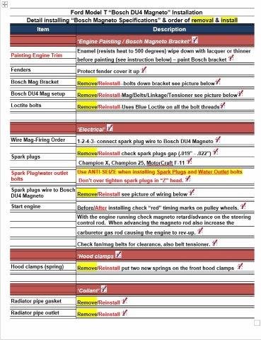

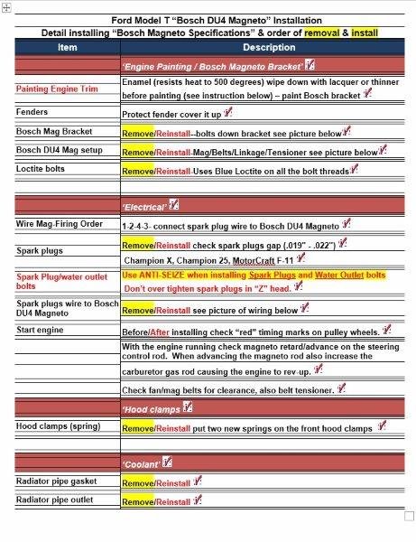

Post by sportbingo » Sat Jan 18, 2020 5:09 pm
Bosch DU4 Magneto Installation page 1 .jpg (64.02 KiB) Viewed 22803 times
Bosch DU4 Magneto Installation page 2.jpg (91.62 KiB) Viewed 22803 times
Bosch DU4 Magneto Installation page 3 .jpg (48.67 KiB) Viewed 22803 times
Bosch DU4 Magneto Installation page 5 .jpg (67.79 KiB) Viewed 22803 times
Model T Ford W Bosch DU4 Mag Reinstall All T Parts & Test Run One Hour
This video is about High-Tension Bosch DU4 Magneto testing/ running of the engine for an hour. I inventory all my T parts, old/new which needed to be reinstalled/repaired on the car. My 1926 Model T Ford Tudor has an original Cast Iron Piston, Stock Camshaft, Z-Head, Old Faithfull Oiler, S4BF Zenith Carburetor rebuilt by Stan Howe, and ignition with Bosch DU4 Magneto Pulley Belt Setup.
I sat down at my computer and recorded the tasks which will be needed for the hour test run. As the Items were completed, they were checked off my list. See the task list above or in the video.
My objective was checking for oil/antifreeze leaks and fix any problems which might occur during the hour run. After starting the car with the Bosch DU4 magneto in retard mode, the engine magneto was advanced/gas-throttle reset to idle, and later I advanced the magneto and increased the gas throttle to rev up the engine, checking the engine performance. I was amazed how powerful the engine sounded with very little magneto advance and gas throttle. The engine had so-much more Magneto advance and gas throttle left. I had some leaks, most were fixed, also had some minor oil leaks remaining around the crankshaft felt gasket and transmission pedal opening. Everything checked out and the engine sounded healthy and great.
1080p Model T Ford W Bosch DU4 Mag reinstall all T parts & test run one hour
New video: https://youtu.be/brtYuNHfUpw

2. Reduces complicated wiring and Model T mag oil-soaked wires
3. Solving mag problems by pulling the motor and rebuilding the mag coil ring and or charging the Model T mag setup
4. Battery is not needed to start or run the motor
5. Hotter and quicker spark
6. Cleaner spark plugs
7. Eliminates misfiring at low and high speed
8. The motor runs smoothly and efficient at both low and high speeds
9. More power and speed
10. Low throttling of the motor
11. Better gas miles per gallon
12. Burning of gases are more efficient, reducing combustion carbon
13. Cooler engine due to efficiency of motor with less boiling of water in the radiator
The 1910 Bosch Chain Drive setup was not as popular as the Bosch Gear Driven, and the X Brand Cross-Drive setup, for the following reason.
1. Noise of the chain
2. Wear of the chain
3. Whipping of the chain
4. Stretching of the chain
5. Breaking and slipping of the chain
6. Oiling and lubrication of the chain which causing slinging motor oil all over the motor and the car
The 1910 Bosch Gear Drive and the X Brand Cross-Drive setup is unfavorable because of the following:
1. Not an easy setup to maintain because of lubrication and oiling gears
2. Oiling and Lubrication of the gears requiring removing the drive setup or cover. Also, the process of cleanup during this maintenance
3. Removing the radiator during the maintenance
4. Cannot check the conditions of the gear setup without removing gear covers or setup
5. Not easy to maintain or fixing problem until it occurs during operation
6. Finding replacement gears parts due to wear
The Bosch Magneto Modern Belt Drive System has many advantages over the following ignition systems 1910 Bosch Chain, Bosch Gear, X Brand Cross-Drive setups, and the Model T point and coils.
1. Positive slip proof engagement
2. Eliminates lubrication of gears, oil of points, adjustment of coil points
3. Neoprene body protection against grime, grease, and oil and moisture
4. High strength nylon teeth for long life
5. PowerGrip-timing pulley belt is made of fiberglass high strength which can easily and quickly be removed and replaced. The only situation might occur during this repair (such as changing belt) is re-timing the engine because you might be a belt tooth off from the motor correctly timed. The pulley belt is easy to install and resetting the timing if necessary, for operation of the motor.
6. If a problem occurs with the PowerGrip-timing pulley belt, keep an extra replacement belt if needed during the operation of the car
7. Corrosion resistance
8. Excellent abrasion resistance
9. Clean operation
10. Neoprene teeth high strength
11. Long trouble-free service
12. The Bosch DU4 magneto has two spots which must be oil monthly with a tip of a toothpick
13. Keep an extra set of counter-clockwise points for the Bosch DU4 magneto if necessary, for the operation of the motor

The Book “Who D.A.T. Ignition System” goes in detail describing the gearing of the magneto, camshaft, belt makeup, difference configuration of the tensioner, tensioner setup, and force rate of the tensioner
Pages 13, 25, 26, and 32 PowerGrip-timing belt makeup, belt tooth, and gearing of the belt.
Pages 28, and 33 different tensioner configurations and layout.
Pages 25, 28, and 33 tension force rates, plus pencil tension tester.
Pages 30, 31, 43, 44, 46, 47, and 48 park description, camshaft sprocket, and magneto gearing.

For those who have purchased my book on Amazon, I have updated it with new pages 61 and 62 because the information was confusing and inaccurate. The update below shows how it looks in the book “Who D.A.T. Ignition System”. Also included below are the two pages that you might want to print out and replace for your book.

Post by sportbingo » Sun Jan 10, 2021 8:08 pm
For those who have purchased my book, on Amazon, I have built a pulley belt setup with the 1910 Bosch Bracket.
See the photo. Also, you can contact me for additional photos.
Post by Norman Kling » Sun Jan 10, 2021 9:29 pm
It would be interesting to see how this fits with the fan and fan belt in place.
dmdeaton
Posts: 732
First Name: Danny
Last Name: Deaton
Post by dmdeaton » Mon Jan 11, 2021 5:58 pm
Norman
Pics above in the thread show the finished product with all belts in place. It was using his homemade shelf, but belt placement is about the same
sportbingo
Posts: 65
First Name: Art
Last Name: Taylor
Post by sportbingo » Sun Jan 17, 2021 5:42 pm
Danny
Your correct, the 1910 Bosch Bracket setup has the pulley belts alignment in the same location. See the photo.

I have built two attachments to fit on the original 1910 Bosch Bracket using the material from the light fixture picture in my book. Both attachments are setup to uses the 1910 Bosch pulley belt ignition. One is for a single DU4 magneto and the other is for dual DU4. The dual DU4 bracket can be modify for a single setup. My plan is to us the single DU4 setup on my car when my engine is rebuilt and sell the dual DU4 setup around the first of April after my vacation. Attached are picture of both setups below.

Post by sportbingo » Thu Mar 18, 2021 3:02 pm
Attached are more detail pictures of using the material from the light fixture picture in my book. See the single and dual setups below. Both attachments are setup for the
. Enjoy!

Attached is a copy of the review of my book below; “Who D.A.T. Ignition System,” feature in the Vintage Ford Magazine for January/February on page 31 by Mike Vaughn.
The Book "Who D.A.T. Ignition System" is available on Amazon.

To: Danny, & other builders
Special offer to anyone to help you anytime to build the Bosch Pulley Belt Ignition System. For example, additional pictures, detail measurements, answer specific question/concerns which you are having during the build.
Six tasks to building the Bosch DU4 Magneto Pulley Belt Ignition System
  • 1. Purchase and rebuild the Bosch DU4 Magneto
      • a. Setup timing rotation counterclockwise
      • b. Biggest expense in the build (purchase and sending it to professional to be rebuilt)
  • 2. Purchase of the books on building the setup.
    • a. Bosch Magneto for Ford cars (justification for building the Bosch Pulley Belt Ignition System (read it online))
    • b. Who D.A.T Ignition System (for reference and discussing building process of the six tasks)
  • 3. Purchase a Bosch Magneto bracket
    • a. Build your own special bracket.
    • b. Original Bosch Magneto Bracket
    • c. After-market Bosch Magneto Bracket
    • d. All the brackets require modification and setup for the following:
      • i. Purchase Timing Belt length of 80 teeth
      • ii. Placement of Bosch DU4 Magneto
      • iii. Building the control timing rod
      • iv. Purchase and modification/mounting the Tensioner Base and Wheel
  • 4. Purchase a Bosch Magneto gear
    • a. The modification of this sprocket following:
      • i. Mill the front extended inside to accept the Bosch DU4 setup key.
        • Require special milling setup for tapper Bosch key.
      • ii. Drill the back of the sprocket to accept the bolt nut.
        • Based on the size of the nut and room for the socket sizes.
  • 5. Purchase a Timing Gear
      • a. Purchase stainless- round tube 304 welds.
        • Might require inside the tube sanding to fit the Ford camshaft.
        • 250 fine sandpaper can be accomplished on a standard drill press.
      • b. After task (a) accomplished cut the front face of the gear which extends the main gear using Saw All.
        • Careful not to damage the main gear during the cutting of material.
      • c. Finally require milling by you or have it machined by professional.
        • Can be accomplished using a precise and heavy-duty good drill press.
        • 1. My small drill press was not precise.
        • 2. Buy new drill, reamer, and tap as needed to accomplish the tasks.
        • 3. Buying spacer rod and set screws.
        • 4. Cutting the 304 round tube to fix the gear and glue it before drilling timing gear hole.
        • 6. Finally drilling the Ford camshaft to accept the spacer rod.
Note: Contact me through MTFCA forum and I will send you my phone number and email address. I am willing and available to help you on any tasks listed above during the build process.
Art Taylor

For those who have purchased my book on Amazon, I have corrected spelling errors on pages 30 and 31. Also, the update below shows how it looks in the book “Who D.A.T. Ignition System”. Included below are the new pages 108 thru 114 that you might want to print out and add to your book. The pages show the building of the 1910 Bosch bracket attachment to support the pulley belt setup and another way to connect the drive pulley sprocket camshaft gear.
sportbingo
Posts: 65
First Name: Art
Last Name: Taylor
Post by sportbingo » Sun Jun 06, 2021 4:21 pm
more pages:

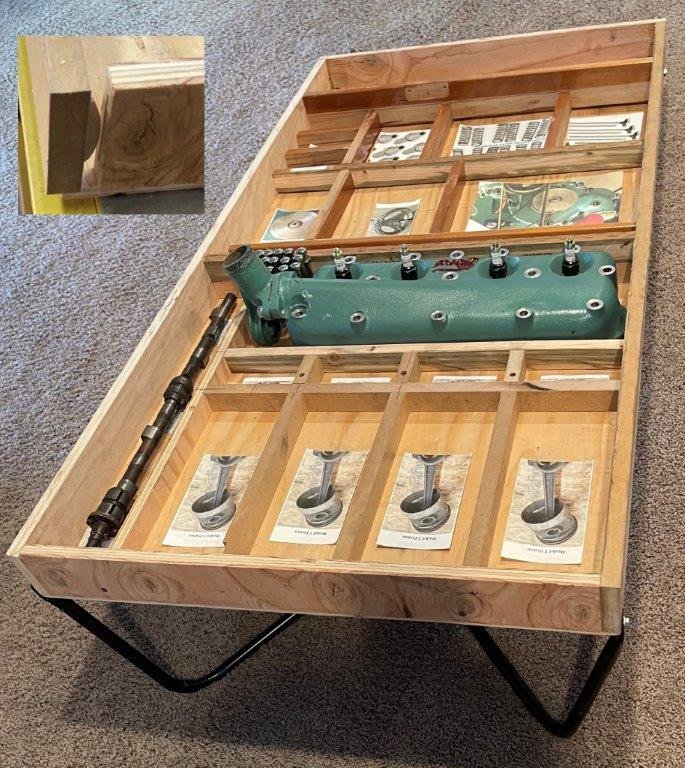

Post by sportbingo » Fri Sep 03, 2021 12:53 pm

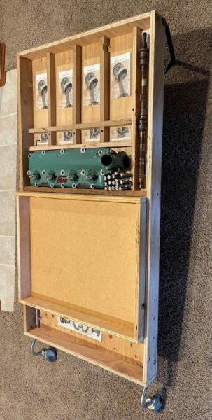

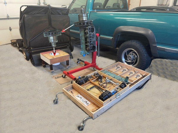

Model T Ford Engine Parts Board
After building my Bosch Pulley Belt setup and writing the book “Who D.A.T. Ignition System,” I noticed that there were four problems which needed to be addressed. First, the compression on my engine was low in the number 4 cylinder of my engine block because of a leak in the bolt thread which required installing a Heli coil. Second, after driving my car with the new ignition setup, I noticed my clutch was slipping, requiring new discs to be installed. Third, while fixing the two items above I noticed the valve and guides were oversized and not seating, requiring new valve seats and guides to be installed. Fourth, my cast iron pistons need replacing and cylinders honed. As a result, the repair requires removal of all parts before sending the engine block to machine shop. Because of the number of parts, storage, and order/organization of parts. I decided to build a display storage board to keep the parts orderly and ready to reinstall after the engine has been rebuilt. It would also be necessary that the board be mobile so it can move around the garage.
Also, it is important to keep all items on the board, including bolts and washers. Each part would have a picture incased in protective sheets and ¼” bungee cord used to tie down the items. All the parts would have enough separation so no part will have interference with another part. An addition to the main board will be an overflow parts attachment board for extra items. Also, wheels will be added to board and a sloping brace to the other side for a display.
I had a ¼” Plywood and extra wood to use for the storage board. After measuring the items and printing out pictures of the part. I placed each part on the board. Based on this design, I built the board. See the attached photos.
I plan to make video of the removal and rebuilding of the engine.

Post by sportbingo » Thu Oct 07, 2021 2:23 pm
Model T Ford Engine Parts Board Update
The engine parts display board is ready to accept parts. I have added the ¼” bungee cords to hold the parts down if one decided to move the storage display board around. Also added hinge hand holder to each side of the overflow parts attachment board for easy removal. In addition, I built a transmission storage holder with wheels to keep It from being damage and clean while the engine is being rebuilt.

Post by sportbingo » Wed Jan 19, 2022 3:00 pm
During the process of removing the parts from my engine. I’m taking the time to take photo of the parts and update them to help in rebuilding my engine. I don’t want to rush the process of the engine removal and rebuild. Attached are some photos which might be helpful in someone building the Bosch Pulley Belt System (Who D.A.T Ignition System).

Is this space reserved for Model A split valve guides...?🤔
