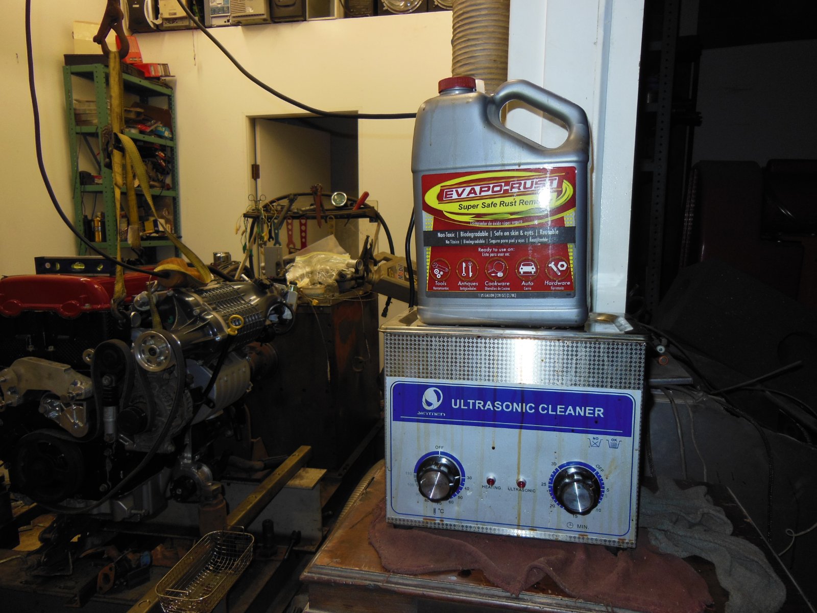

I have had great success with a heated ultrasonic cleaning tank using Evapo-rust. It dissolves the rust (Iron oxide) leaving steel, Iron and aluminum unharmed. I used to use reverse electrolysis (and still do for large Items like engine blocks but this Is the best way to remove rust on smaller Items like carburetors.
