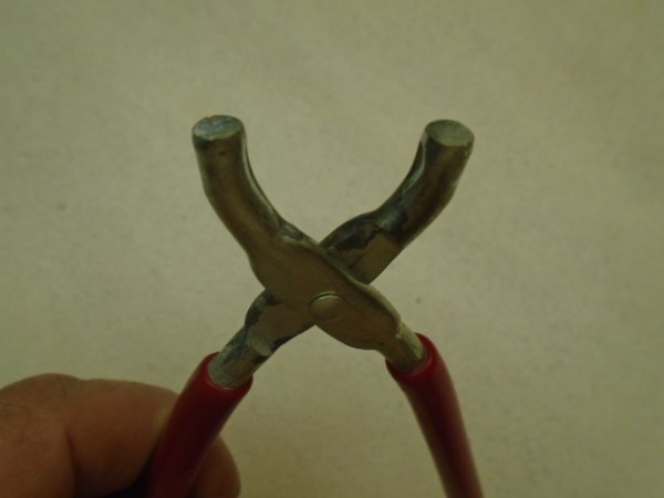

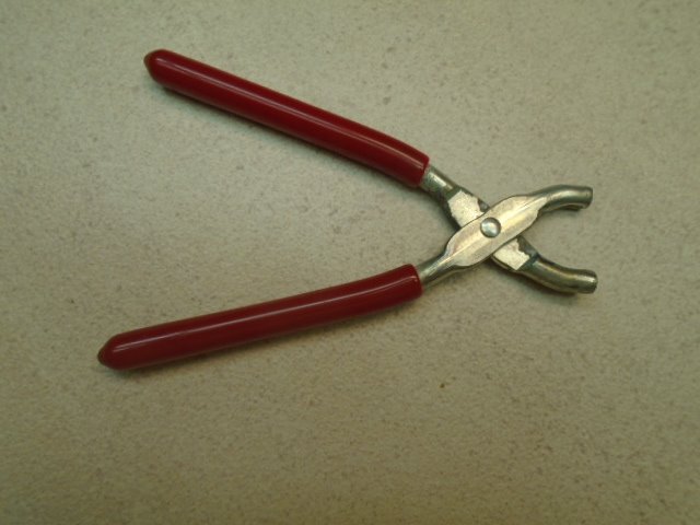

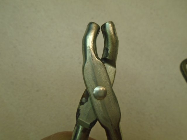

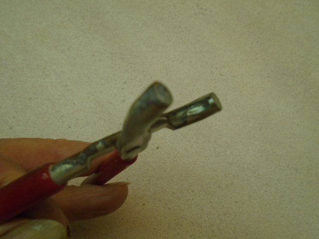

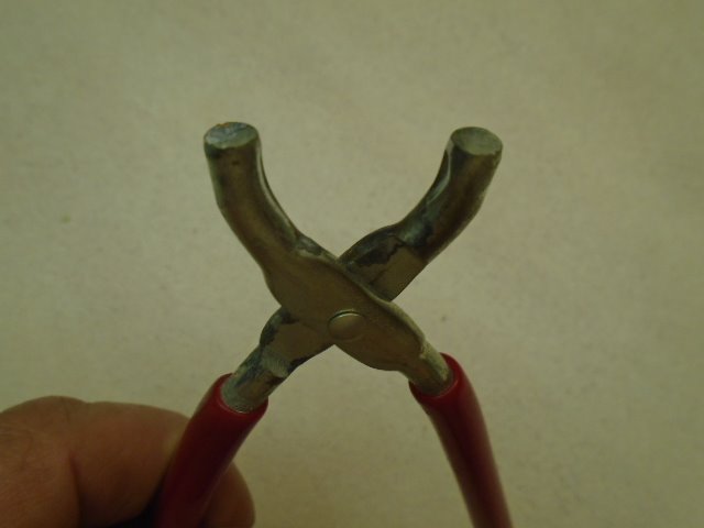

Mark, are you asking about hog ring pliers?

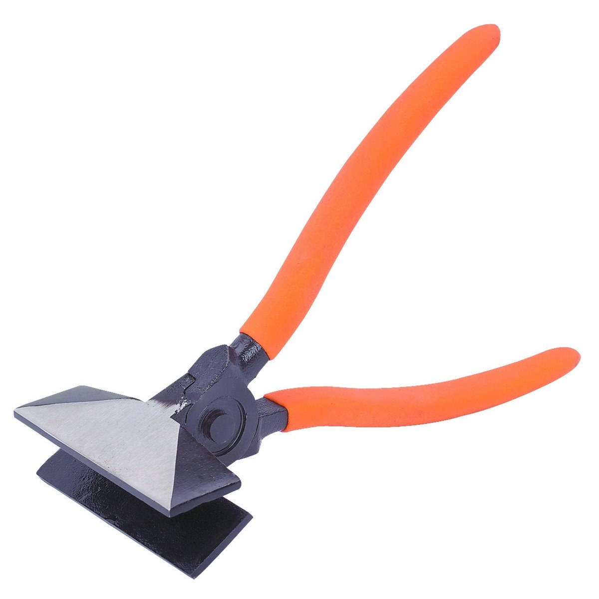

To crimp the bead in the upholstery cushion into the channel of the seat spring, I like to use this tool:
I got mine at Harbor freight.

No, the original type installation is not with hog rings it is with a metal channel around the base of the seat frame. The upholstery is pushed into the groove and then the surrounding channel is crimped. I did look at the sheet metal seam tool at Harbor Freight but it seems to wide to fit. So people have used it?

The tool that kwtownsend shows on his post worked good for me. It’s a sheet metal crimping tool I believe. Anything that will crimp the metal channel will work. Just do it evenly and it will come out great. I went along the seat and crimped it about 3-4 inches apart to evenly get the seat material in place. Then I went around again and crimped it all the way around.

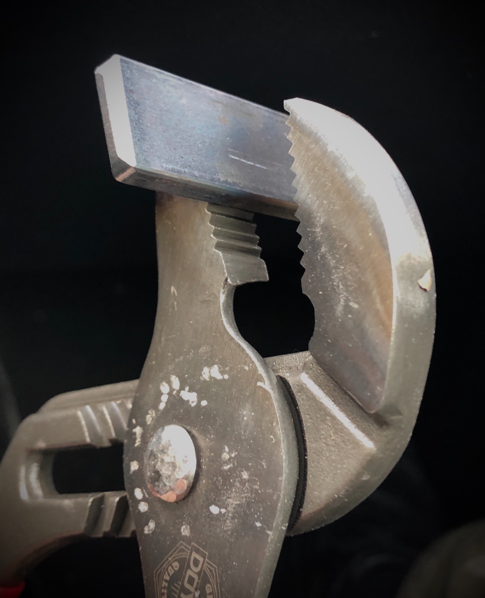

I have never installed a channel and crimp upholstery set myself. However, I have worked on a few, done repairs and so forth. For whatever it is worth. I like "channel lock" pliers for re-crimping. The "offset slide" closure pulls the jaws together in a sort of offset slide which can usually be held in a way to roll the channel in better than a straight set of pliers can do.

Hey Wayne, Thanks for this in depth description. I am using a Classtique seat upholstery kit sewn for new springs fitted with the channel system. I heard from Mike and he sent me a picture of the off set channel lock type pliers he uses that have a small flat bar welded to the moving jaw, so looks like I’ll be making one like that to do the crimping.

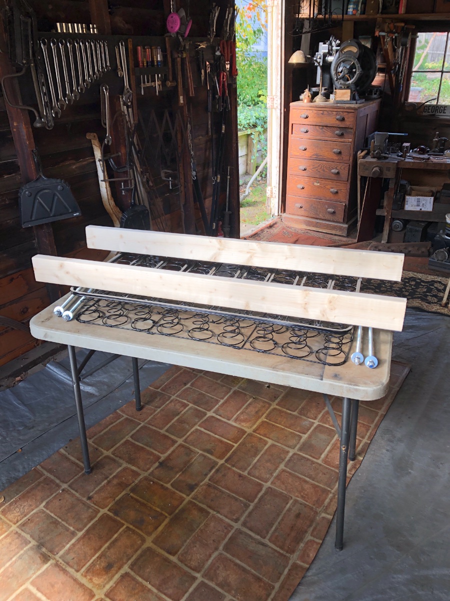

Mike suggests using a table to place the upholstery down first then the springs upside down on top of the upholstery. Then two 2x4 s are laid on top and fitted with threaded rods to compress the spring pack during the crimping process. Since the cord sewn edges of the upholstery are designed to be inserted into the channel it seems pretty easy.

LOL .. ok so I welded up some channel locks to make the same tool used by Mike at Classtique. I made the 2x4 clamps and found a table to compress the springs. Before I drill the holes in the table I tried to find where I can put those 2x4s and still get those cannel locks in to do the crimping. Doesn’t seem to work unless they all the way in the center. Anyone have some pictures or a video? Don’t tell me about that horrible video on You Tube where Mike is standing in front of all the action.

No video here but before you compress the springs move the 2x4’s to where you can get your crimpers in to do most of the crimping. Once you’ve done that compress the springs and crimp as much as you can.
Carefully loosen the 2x4’s and move the spring over one way or the other so you can have room for the crimpers. Recompress the spring and crimp the rest of it. You may need to use a small hammer with a backup to smooth out the seams as others did.
I didn’t have a large enough table to use so I bought a piece of 3/4” plywood for a top and screwed it down to 2 saw horses. The table top has to be pretty solid for the stress that’s used when tightening down the allthread bolts. If that’s a fiber or nylon top that’s on the folding table you have it may tend to give. Just my opinion.

I did not make a cool spring compressor like you did. I just put the cushion and spring upside down, put a piece of plywood on the spring, and sat down on it to crimp it in place. Start at the center of the front. Measure the perimeter of the spring where the channel is, and there the cord is on the bottom of the cushion. It should be the same. Mine had the cushion slightly bigger. I made up the difference but bunching up at the back corners.
Having an extra set of hands is helpful.
