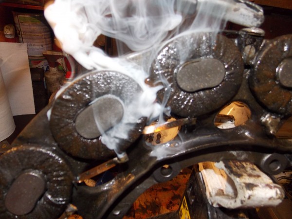

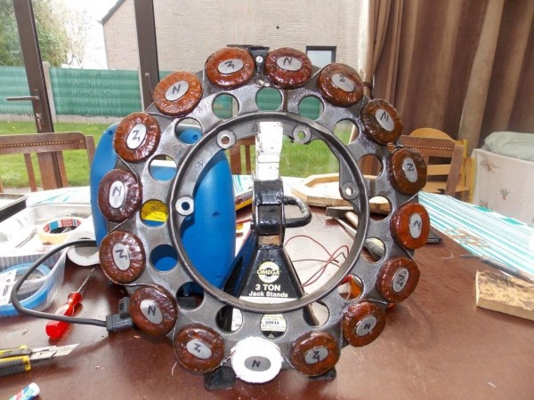

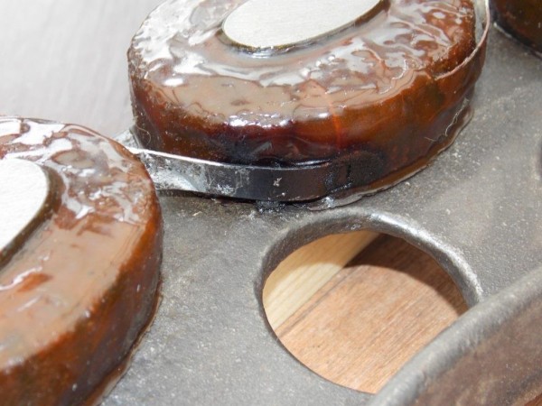

Here a few pictures of what can possibly go wrong with the magneto.
First is a double oval freshly rebuild and run for a few hours.

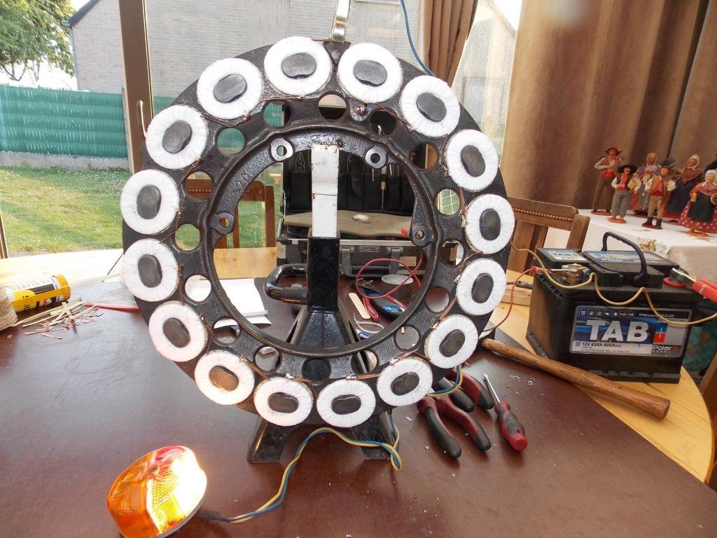

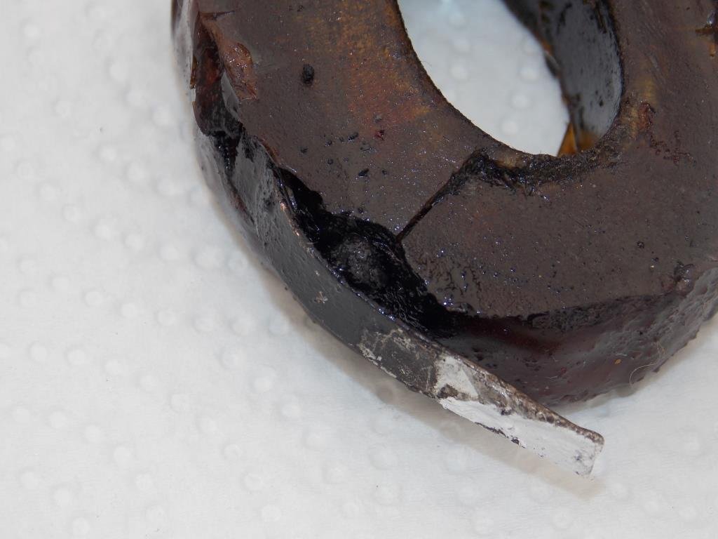

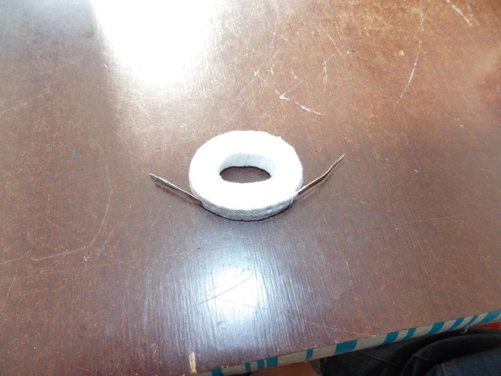

Second one was during the recharge of the magnets during the rebuild of an engine.
The magneto loop was looking fine and I tried to use it again. During the recharge of the magnets I set the loop over the flywheel and flashed it three times with 42Vdc. it started smoking at the second time. Needed a total rebuild.
Andre
Belgium
I just need to learn how to put the photos in the right order. The last photo is for the message I wrote just before this one.
Andre
Belgium
