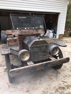

So a 1914 model T Coach just popped up less than 30mi from me for a really good price. The ad says it was last running in 1994. It looks really unique..and the price is not bad. Can any brass T owners chime in with things I need to look for? If I get it...this will be my first T. I have considered picking it up to learn on and then sell or trade up later once it is running again.
Posts: 6789
Re: Going to look at a 1914 T Coach
Post by Scott_Conger » Thu Nov 07, 2019 1:28 pm
Sounds like you have no "T" friends yet. This is a tough way to enter the hobby, but it can be done
My advice is this: reconsider
Not knowing Model Ts, Not knowing how to drive the car or operate it, and buying a non-running brass T is asking for trouble. If it was a 1919-1927 $4500 T with an electric starter, the financial damage you can do to yourself is limited. Brass cars can be misidentified, be a mix of unrelated parts, and still be offered for unrealistic prices. Unrealistic, meaning, even nicely restored, completely correct cars do not fetch much money in the overall world of antique cars.
The BEST condition, RUNNING car you can find will end up being the cheapest, by far
If you're still animated about this car, take front/rear/side photos of the car. Take photos of both sides of the engine with the hood removed. Take pictures of the front end, fairly close up. Take pictures of the rear end, overall and close up. Take pictures of the interior, including the 3 pedals on the floor...not from 10 feet away...show the details of the pedal heads...close.
Post pictures here and folks will be able to tell you roughly what it is and about how much it's worth.
Best of luck.

if this is it: https://www.facebook.com/marketplace/it ... 119230694/

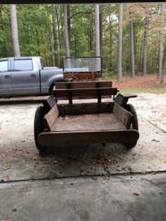

then there isn't much there, and even if a '14 engine, it's a toss-up if its even worth what you plan to offer.
There was no such thing as a "Stagecoach Edition" Model T, so you're dealing with an owner who know absolutely nothing about this thing (it's not a car) and maybe less about it's condition or anything else.
You could sink multiple $1,000's into this thing just to make it run, and when you do, it'll still be worth only what you originally paid.
OK, I just looked at the rest of the pix. My advice above is not strong enough...Something terribly wrong with rear axle and the frame appears home made.
Pass on it. Actually, I'd avoid it like the plague.
Parts only, and very few at that.
Posts: 6789
Post by Scott_Conger » Thu Nov 07, 2019 3:24 pm
Further study of the pix and I'd say you would want to sue them for the price of gas to go look at it.
It is 100% a fantasy creation and is either horrifyingly sad or comical depending on your meds today
Keep looking.

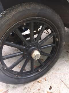

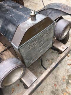

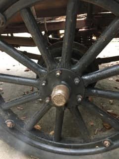

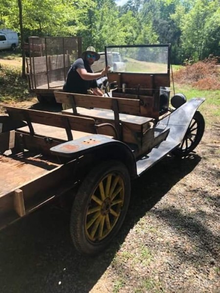

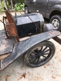

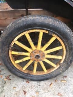

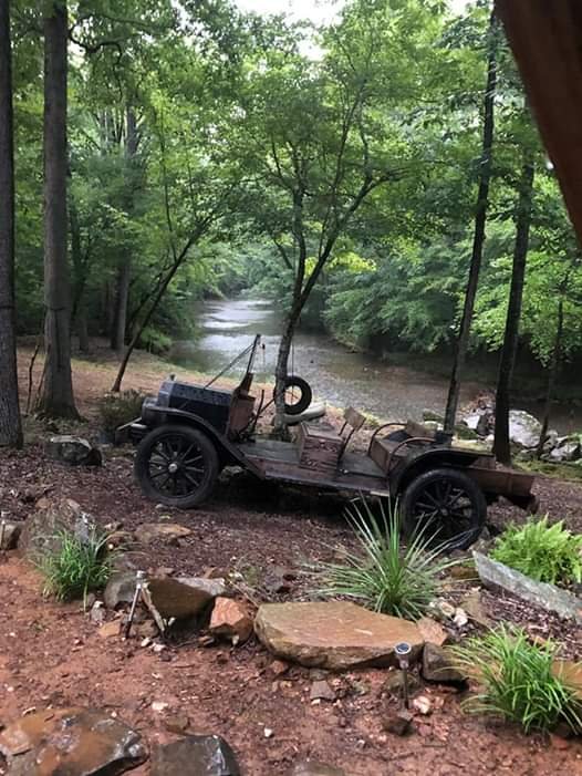

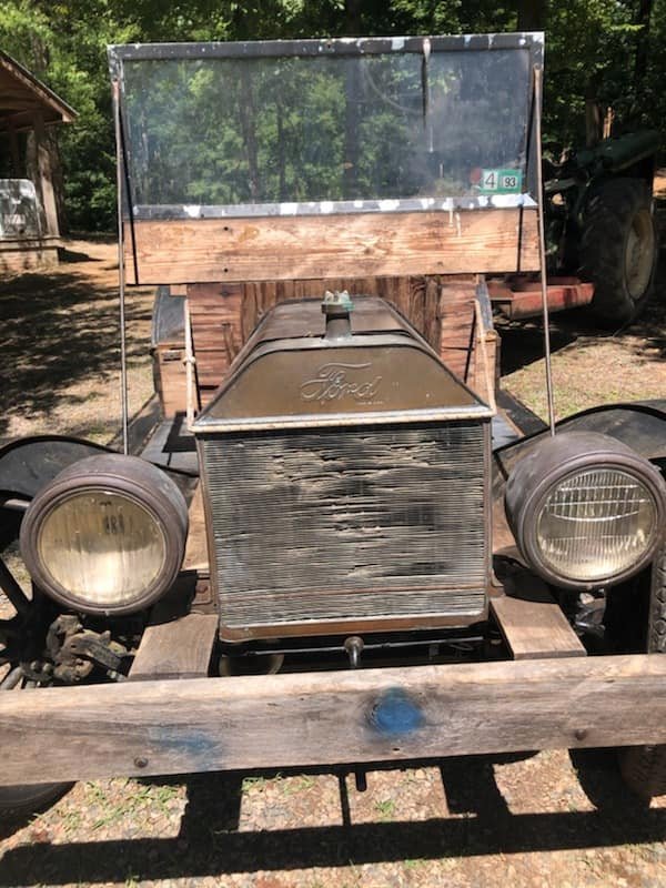

Note the Essex front wheels and the non-Ford front springs.
The hood in relation to the front axle has incorrect geometry.
It's not even a Ford. Probably an Essex running gear and engine, etc.
Very crude vehicle.

William, that is not a model t. It has a few model t parts with a lot of other manufacturers parts from various years cobbled together into a big kids go-cart. There is no evidence from the pictures that there is actually a model t engine in there.
If the radiator has not been molested it could be worth $100-$300 depending on year and condition. Ford radiators have a manufacturers tag with a year soldered or stamped on the back side.
If you want a model t ford, keep looking, this aint one.

FreighTer Jim
Posts: 1722
Last Name: Jarzabek
Location: Dayton, OH
Board Member Since: 2008
Yard Art
Post by FreighTer Jim » Thu Nov 07, 2019 5:24 pm
Yard Art
As being displayed now
If you have a use for unique yard art .... :idea:
FJ
Google “ Model T Transport “

Post by DHort » Thu Nov 07, 2019 6:34 pm
Here you go Wayne.

Model T Essex hi bred. If it runs and drives would be fun to play with as long as you know what you are getting. If you were buying as a T, not!

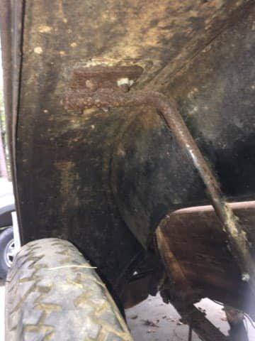

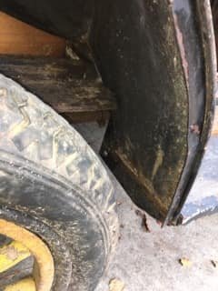

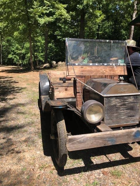

For Wayne and anybody else without access, here are more photos.
Posts: 7411
Post by Steve Jelf » Thu Nov 07, 2019 10:53 pm
Posts: 7411
Post by Steve Jelf » Thu Nov 07, 2019 10:56 pm
I could have made them bigger, but I don't think that would have made it look any better.
