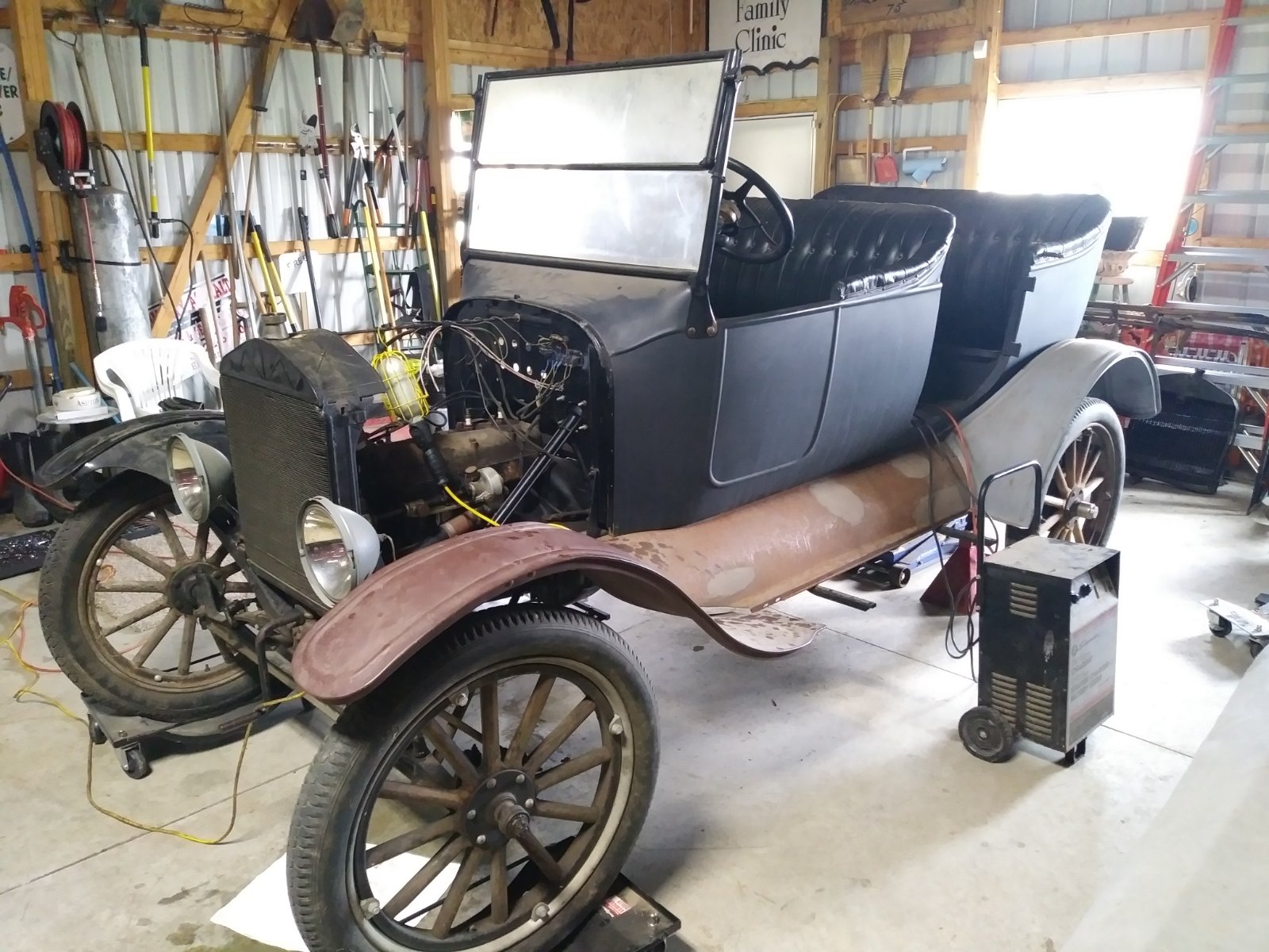

Re: Newbie continuation
Here you go...

Looks like a good start to a great car to me. Doesn't look like a neglected T from here! Even the seats look good. You plan to keep it and have fun? Lots of T's around this area and places to enjoy them and people willing to help and parts are easy to find for a 25.
Just want to have a little fun on nice weekends.
The seats were done 30 years ago, but some mice chewed holes, one several inches in diameter.
I plan on taking my time getting it ready, but no desire to have a show car..just a decent driver.
