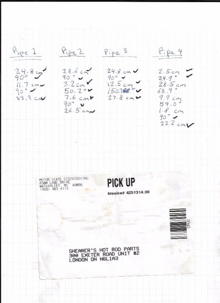

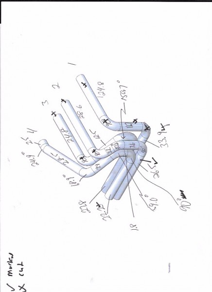

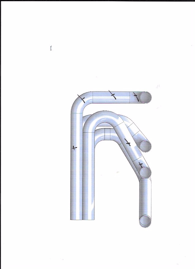

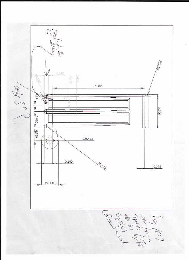

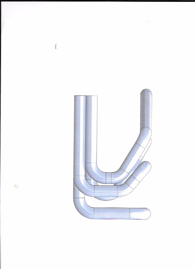

I just came across the plans my son made up for the steering cross member and header for my speedster that I am putting back together after having it apart for 5 years. The rebuild is detailed in my Speedster Rebuild thread. I am very lucky to have a son and daughter-in-law that are involved in the hobby. But my son is also my Jiminy Cricket. I was going to make the cross member from 1/4" plate welded together and the header as a log style. But "the Secrets of Speed" book says 32" primaries, and so I got told and lectured on what would and would not look period. As they say, the rest is history. He gave me his drawings and expected me to produce the parts.

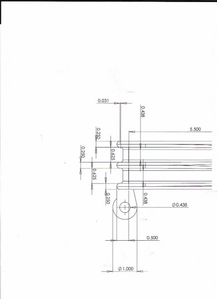

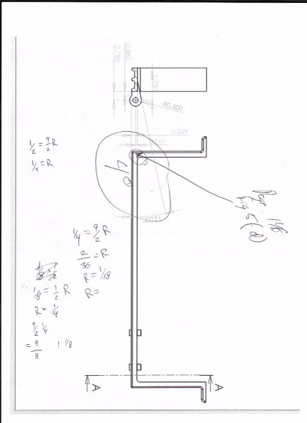

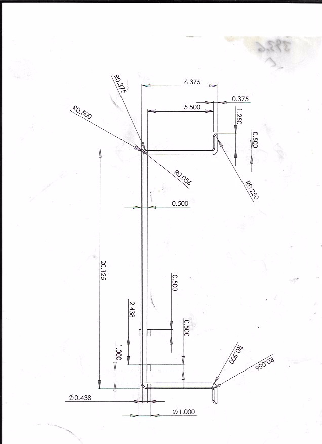

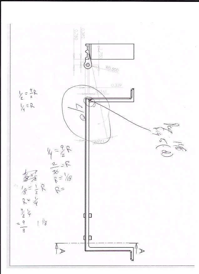

So here is the cross member

Speedway sells some pretty good tubing bend kits. All mandrel bends so you can cut part way along a bend and the tubing is still round. They also have collectors.
I like his design

Les that's exactly what we used pete

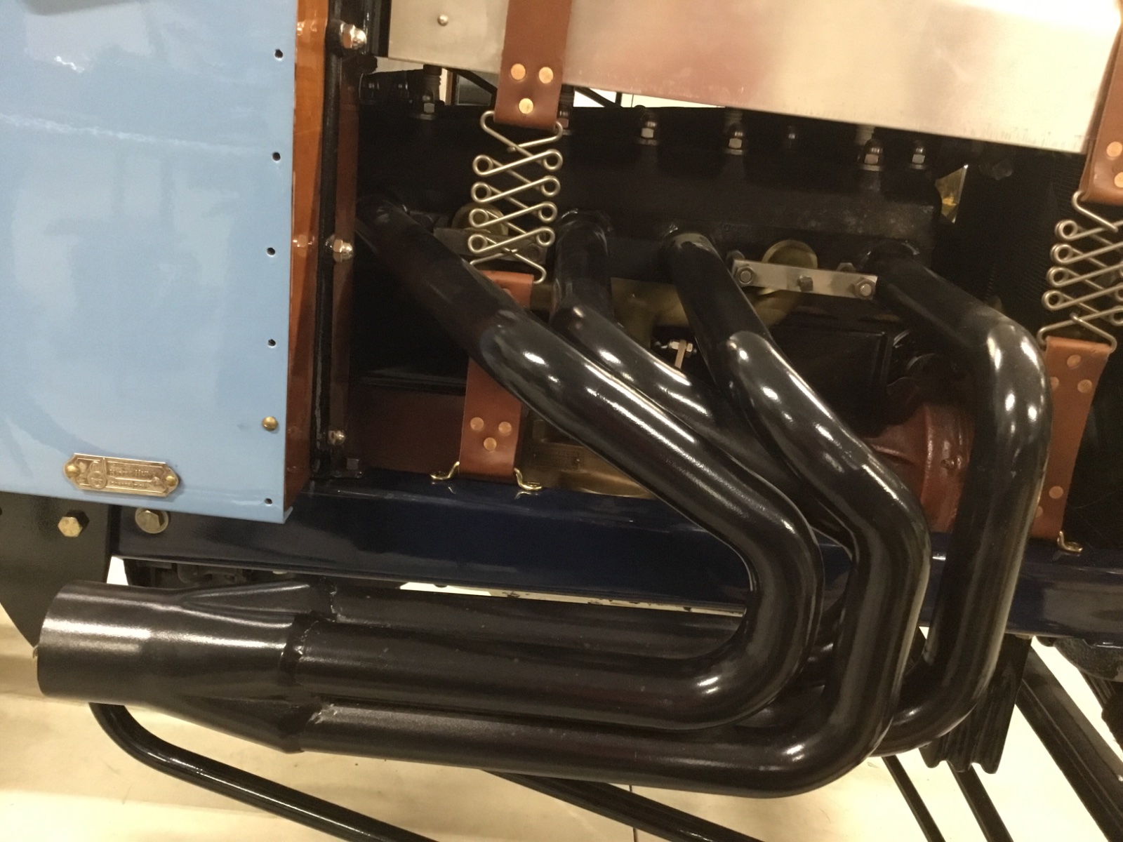

Pete,
any pics of the finished header? I am going to fabricate one for my build

Danny as requested

Very nice
Good job
