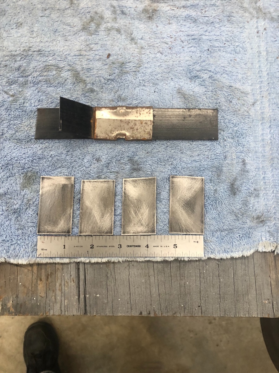

After selecting the high carbon steel strap material, slightly cut it a little oversize. Clean the metal by hand sanding first. You must anneal the metal prior to shaping and final cuts. You do this by heating the metal cherry red and letting it cool down at room temperature.

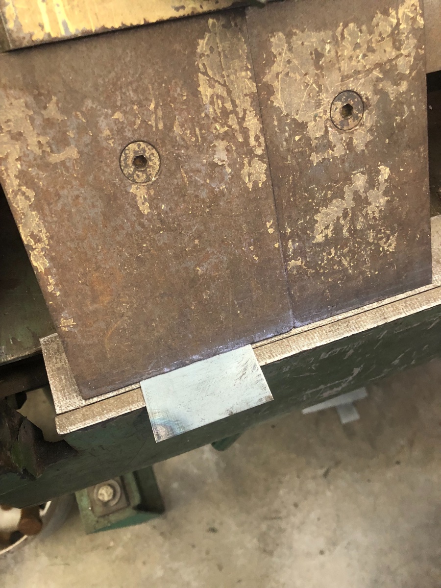

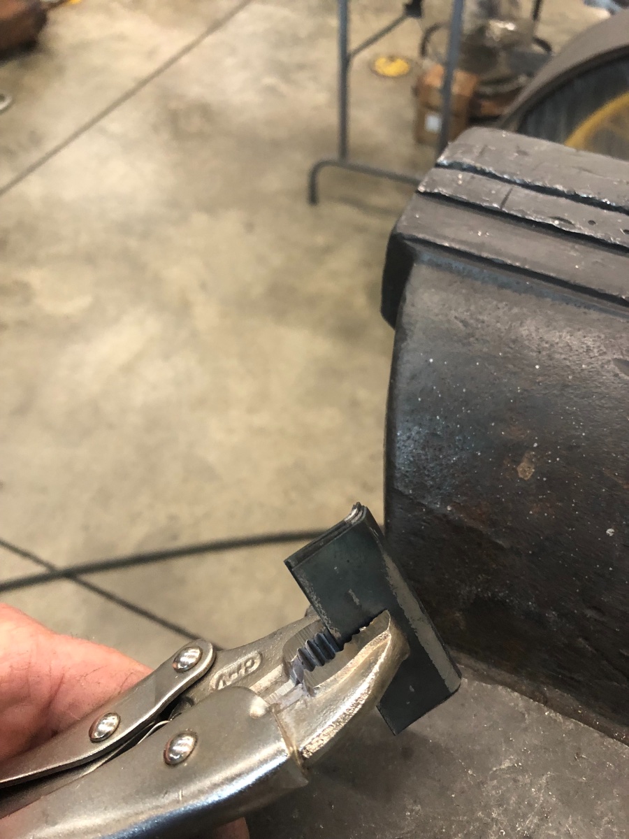

Now we can layout, form for the fitting. If you do not have a sheetmetal break, just use a vise with sharp edges on the jaws. I start with an 1/8" bending the metal a little less than a 45 degree angle. After getting the first angle, scribe the metal to be cut flush with the outside edge.

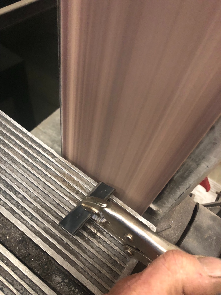

Cutting is a snap when the metal has no temperament to it. I next start fitting using a belt sander, first at the slightly bent edge. You want this to be flush or less than the side interception angle.

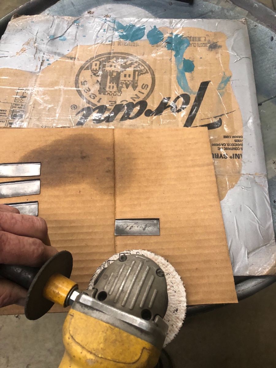

After all are to a nice fit and edges cleaned, time to re-hardened the shims. Quit simple, reverse as we annealed except we quench in water. Afterwards, I clean with a high speed paddle sanding disc and a little hand sanding.

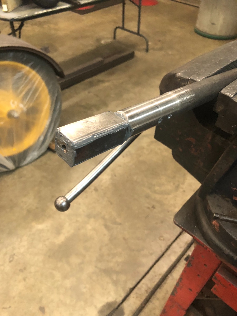

Clean with carb cleaner or any high evaporating solvent, we are now ready to attach with JB Weld. I like the bent angle to face to the right to accept the torque. Remember you are doing a lapping so they all must face the same way like fish scales. I like to load up then remove the excess as this releases air bubbles. Then as you install the shim, move it in and out to get a firm setting.
Topic author - Posts: 5509
- First Name: Henry
- Last Name: Lee
Re: Adapting a TT Warford to a Conventional Model T-Part 1
I like using small C clamps, using a little wax paper as a parting barrier is your friend with cut down wooden paint sticks. Clamping and releasing, then fully tightening down makes for a real good attachment.
I like to let set for two days, but for our purposes it will be fine.
As you can see, we are where we want to be at .875". Stay tune for part 2 tomorrow, same time, same channel!
