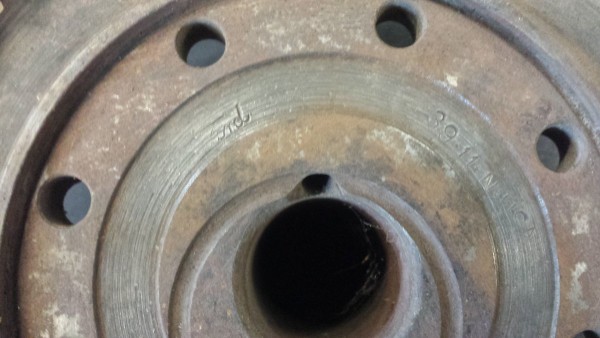

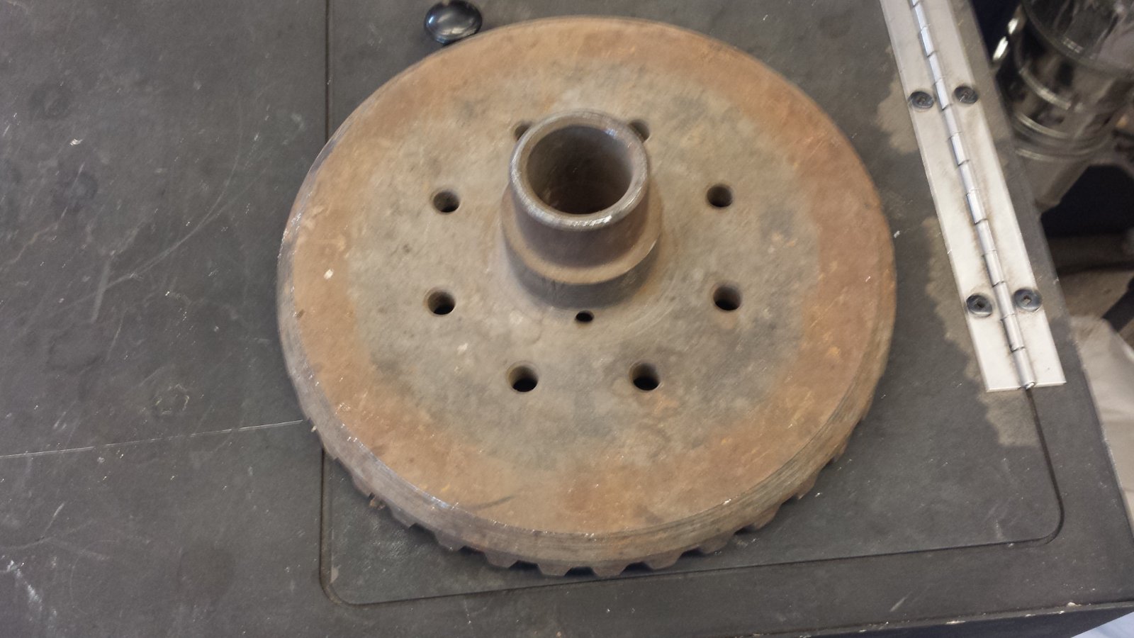

I have 3 ring gears that I do not know what they are ? Any information would be great.
Mike

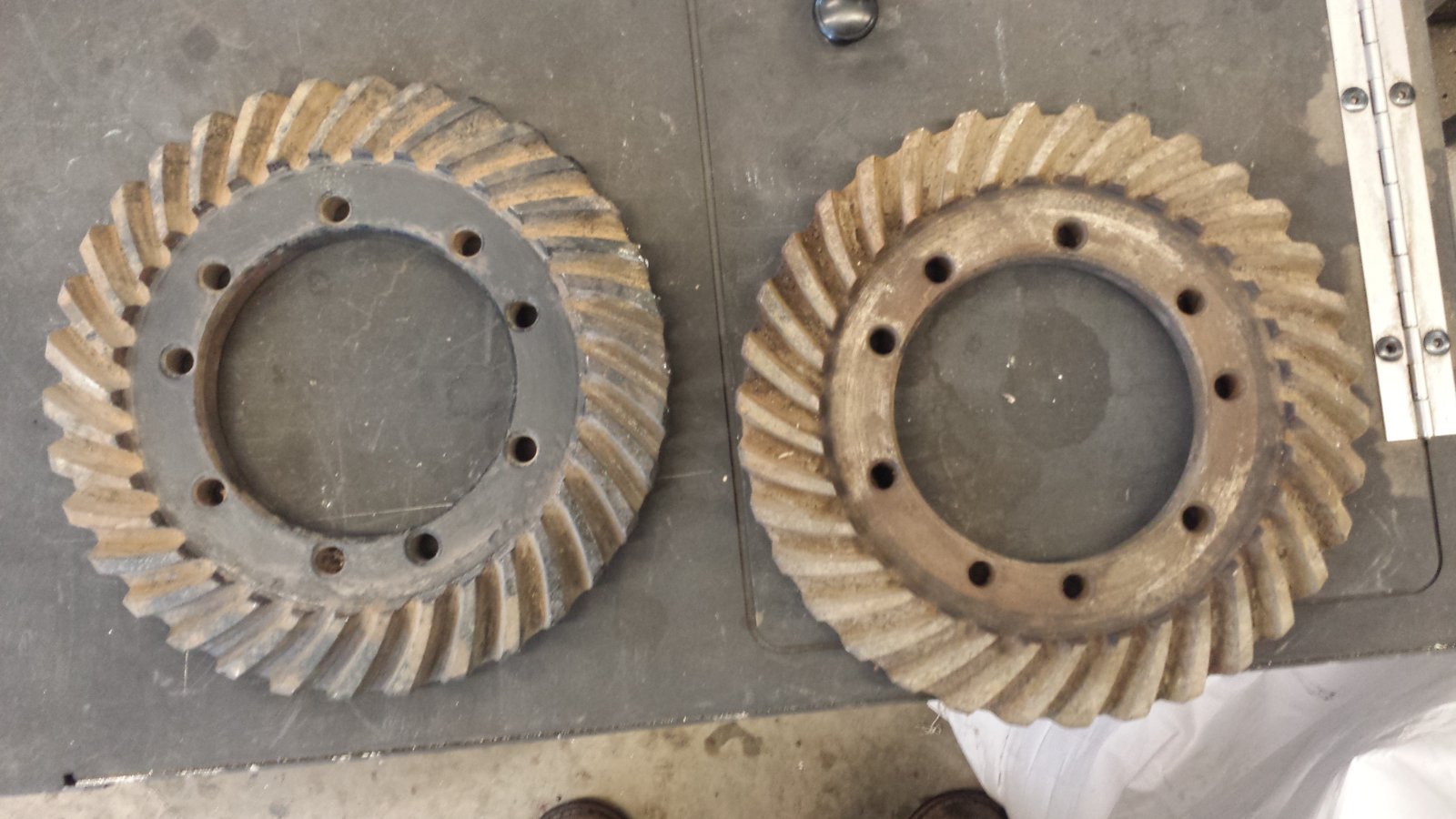

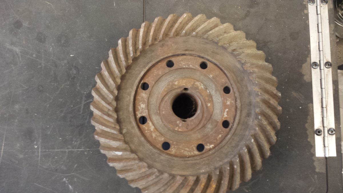

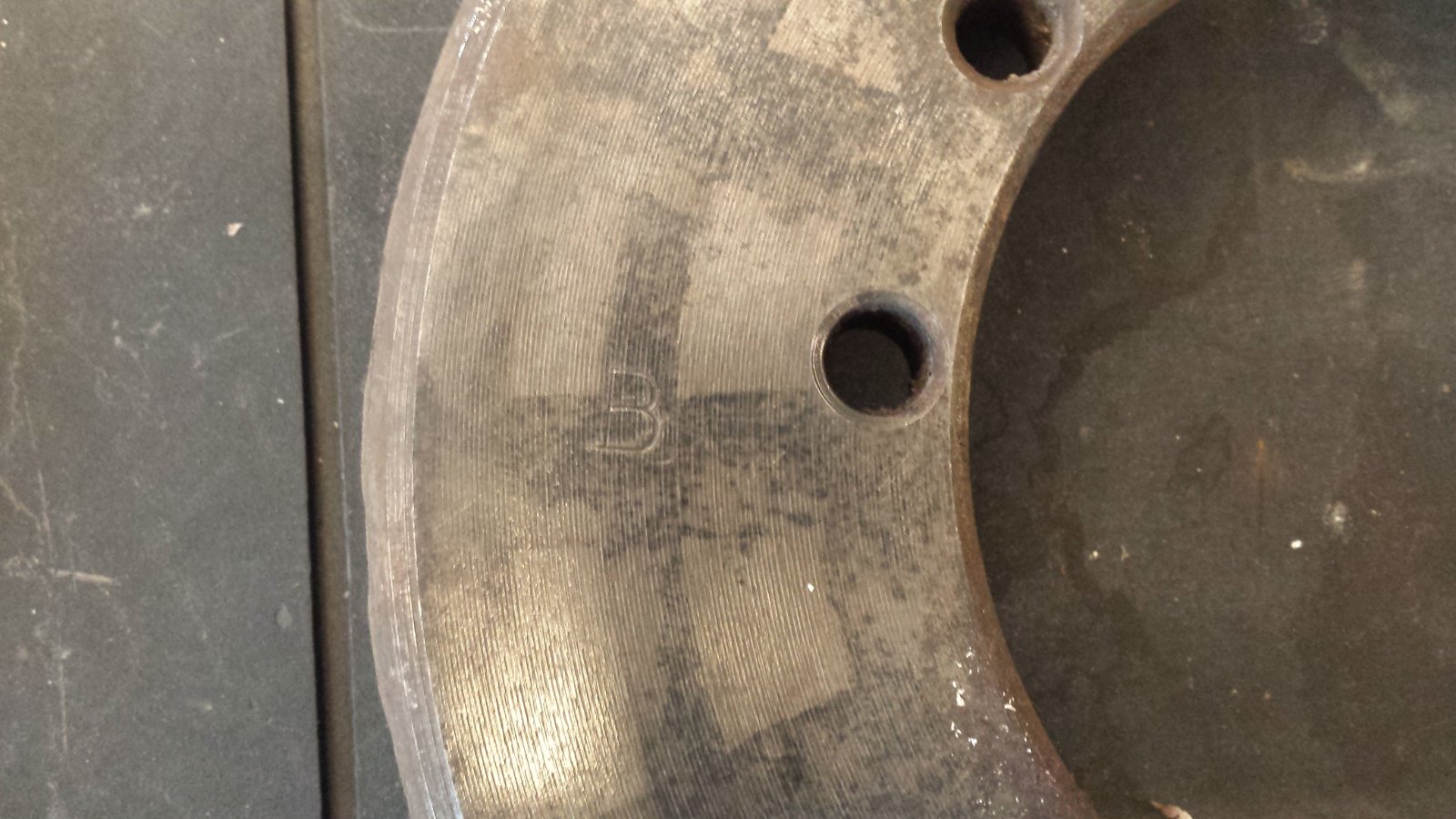

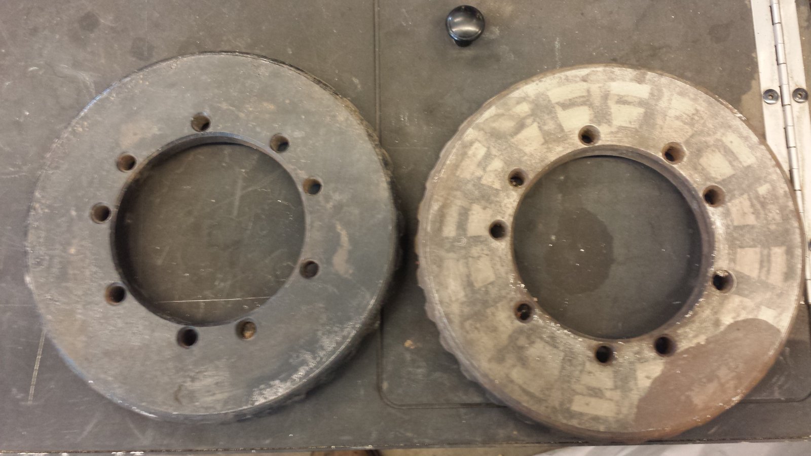

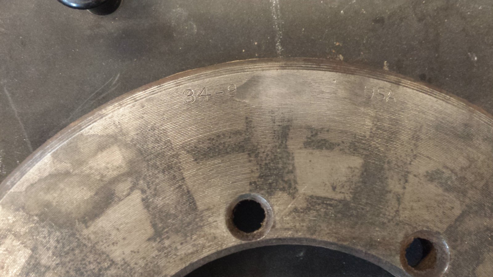

More pics Ring gears

Top one looks to be Model A and second one 30's V8.
Re: unknown ring gears
Post by Rich Eagle » Tue Nov 26, 2019 3:29 pm
I looked up a chart that says 34:9 is a standard Model A and optional Model B for lighter cars ratio. The 39:11 is post '34.
http://www.fordgarage.com/pages/rearaxleratios.htm

I forgot to mention that spiral bevel gears came in a matching sets, as ring and pinion, to try and miss match usually ended up with a diff that screamed like a fire truck siren.

The first group of gears shown are 28-34ish the 2ed group of photos are 35-48.
https://www.speedwaymotors.com/1935-194 ... 7-EALw_wcB
