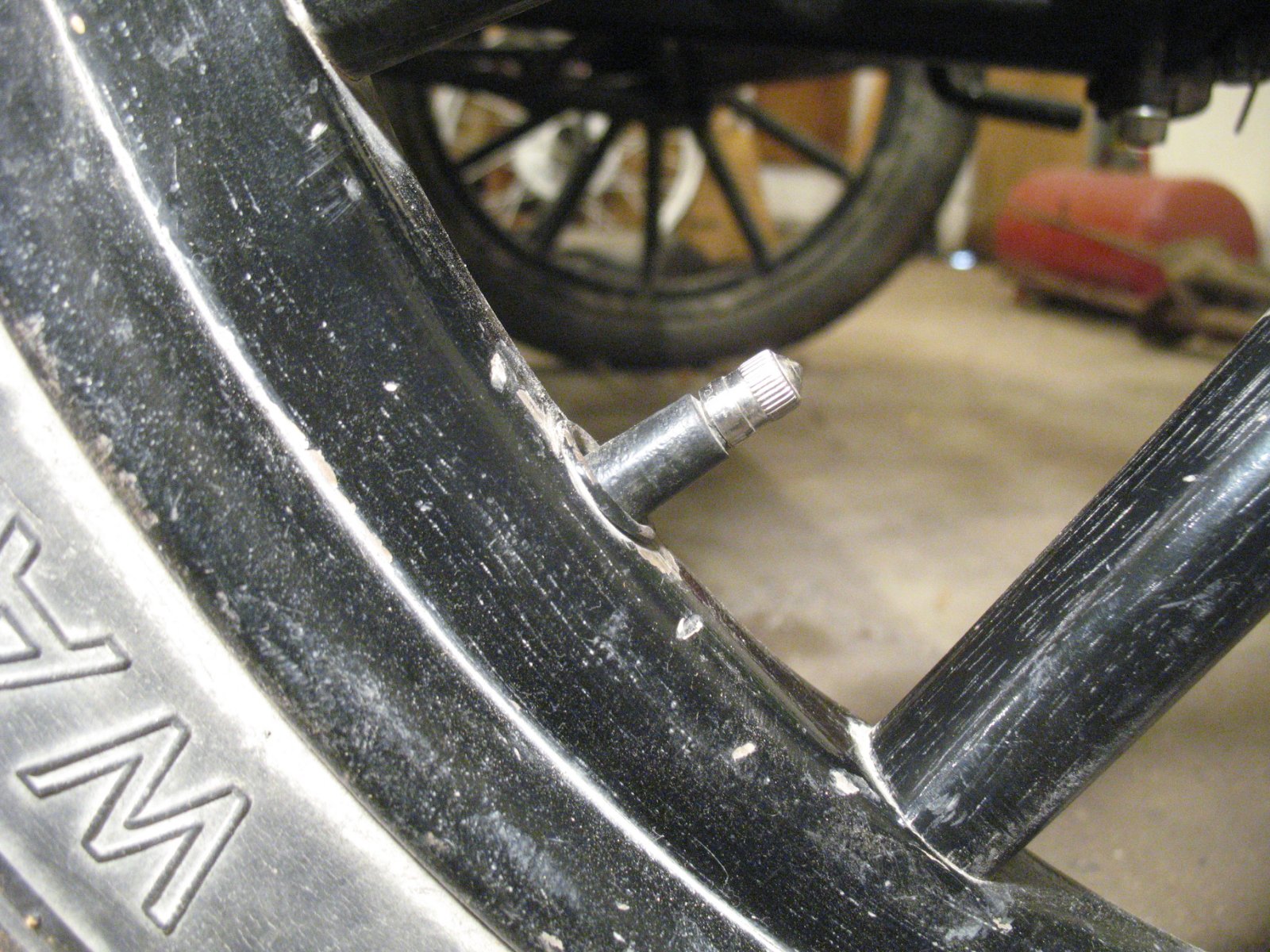

...always pay the money and get brass stems!
I save $10 to $13 a tube by getting rubber stems, cutting them off, and installing metal ones I've picked up at swap meets for $1 or so.
http://dauntlessgeezer.com/DG110.html

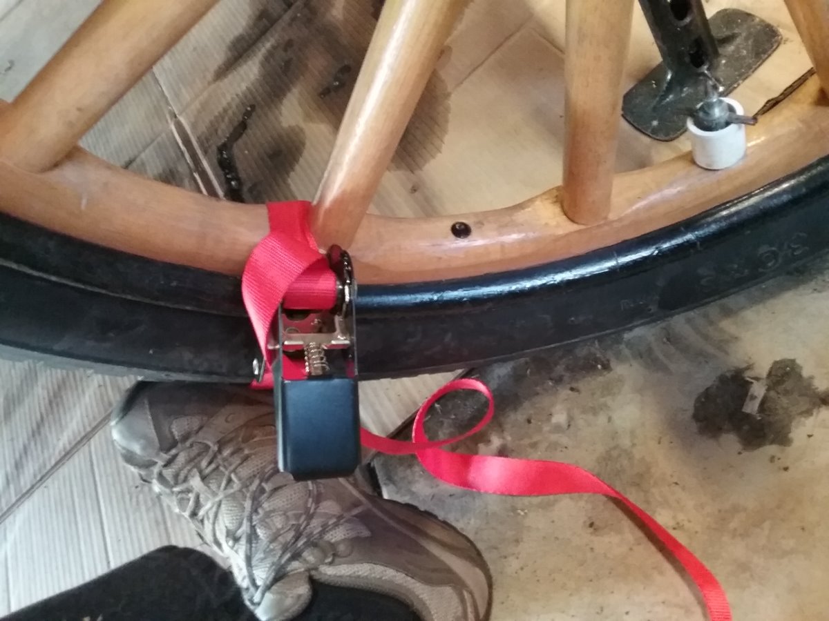

I always start at the valve. I use a non-hook ratchet strap to hold everything in place (no damage to a wood felloe) and use some really old tire irons that are about 18" long and a Harbor Freight rubber mallet.

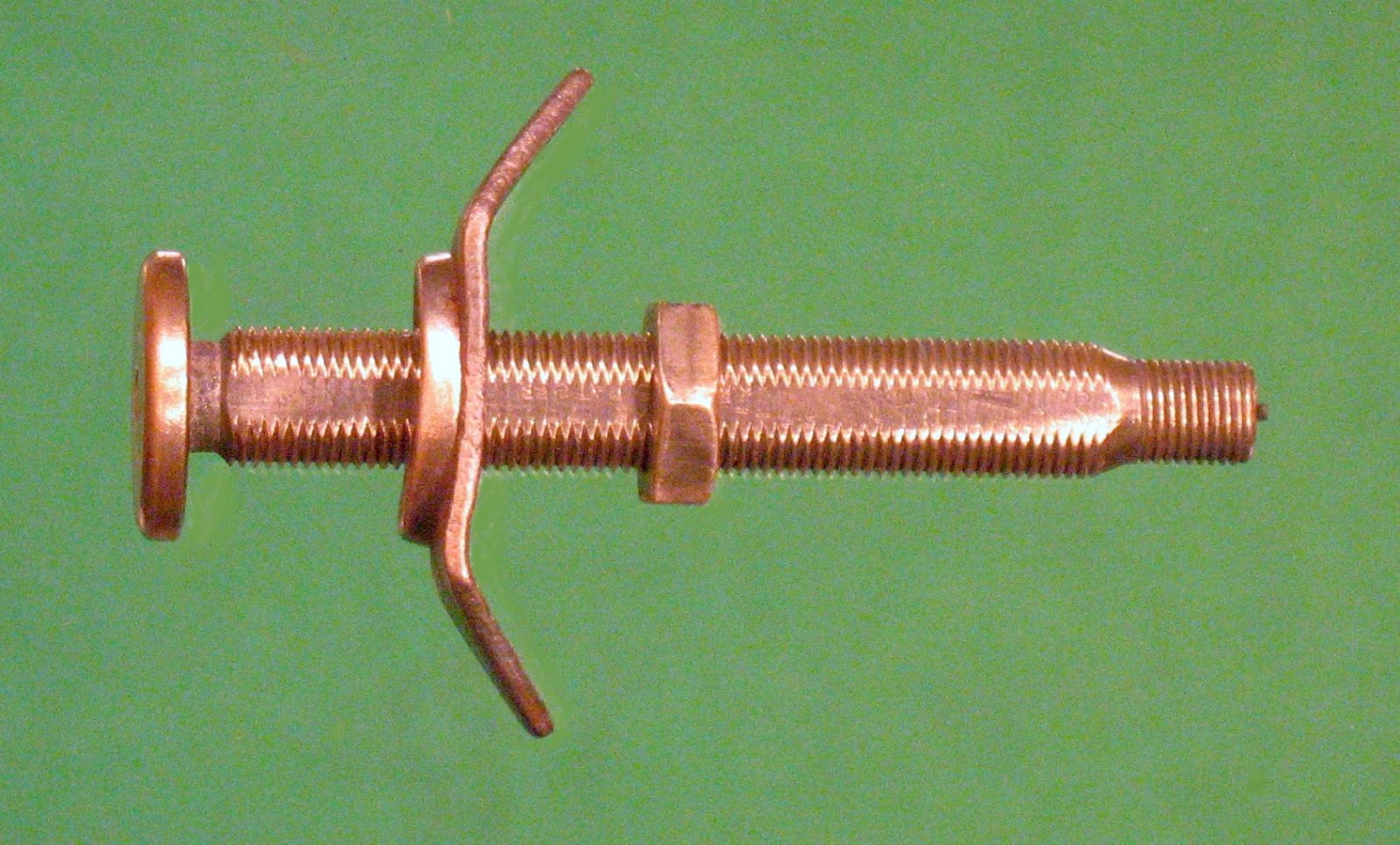

I use a tool like this
https://www.ebay.com/itm/Valve-Stem-ins ... SwxH1UJ3zS
The long end screws onto the valve stem and I use a piece of wire around the T end to pull the stem through the fellow and wrap the other end of the wire around the axle nut to keep the stem in place.
I have an old rusty one that I have had for years and recently bought one at Autozone

I believe that tool was designed to pull tubless tyre valve stems into the rim. It sure works well for that. It is also handy when installing truck tyres and the various stem configurations used on those. I have never had the occasion to use it on a T, but then I have never mounted tyres on wooden felloe rims which may require the stem be held in place.

Yup! That is the tool. Can't own a T without one. Like Steve said, I'm glad they are still available.

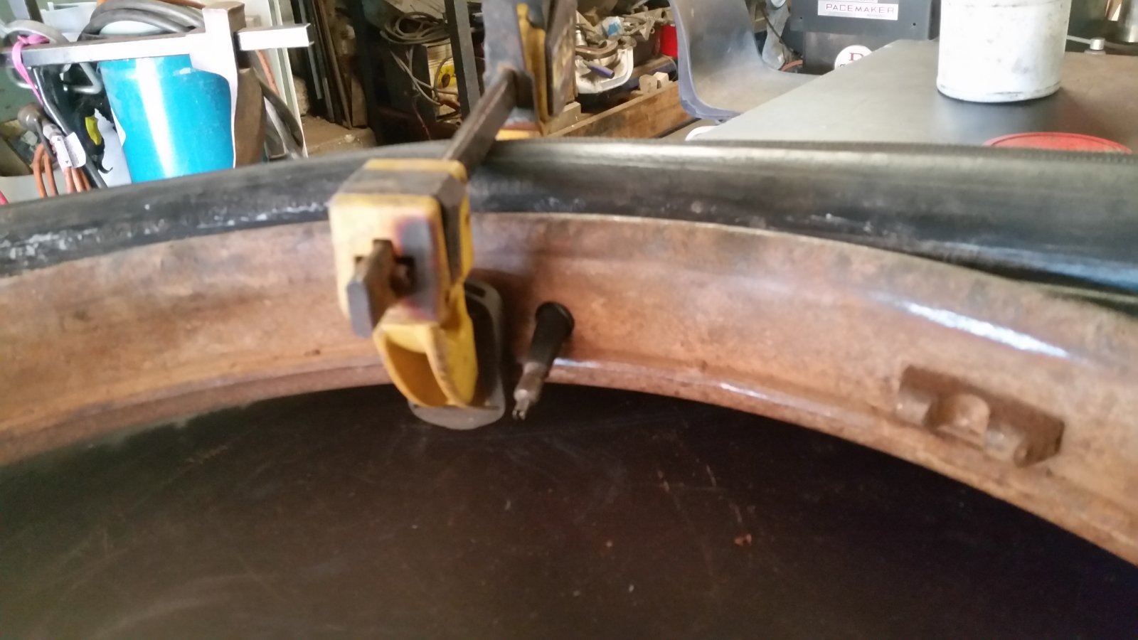

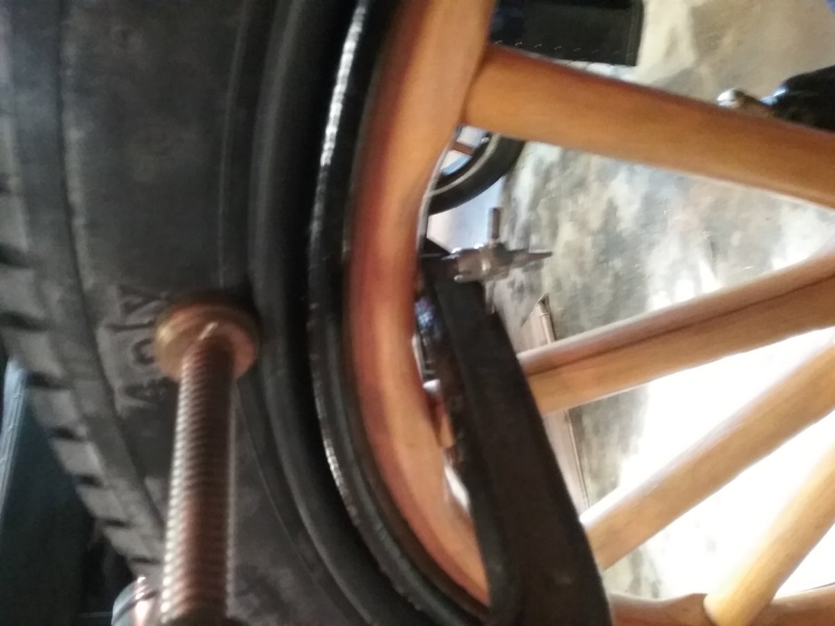

Here is what I did for mounting Excelsior tires on my non-demountable wheels:
Using the current rubber stem tubes, I was not able to get the two beads and stem inside the rim. So I notched them, like the old days.
I used my tire valve stem tool to hold the valve stem in place and used a big C-clamp to get the beads and stem in the rim.

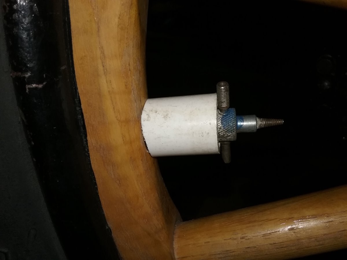

I then put the stem at the bottom of the wheel and using the stem tool to told it in place, lower the jack jest enough so the wheel does not spin.
I then use a piece of pvc pipe to put some tension on the rubber stem and hold it in place.
I seated the bead a short distance away from the stem, then put on a short strap so the seated bead would stay in place. The strap is kind to the wooden felloe. I then went the opposite direction then seated the rest of the tire. I use some old tire irons that are about 18" long, and a rubber mallet that I picked up from Harbor Freight.
There was a definite learning curve, and it would have been much easier with an extra set of hands! The first tire took me about 45 minutes to mount.by the time I got to the fourth tire, it took me about 10-15 minutes!
