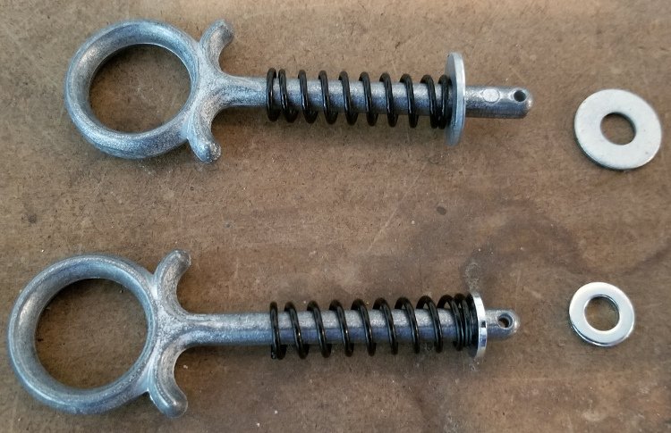

Frank
generally speaking, the hood hood hold down latches can be fit to the shelf first. With proper small washers and cotter pins suitably curled back and trimmed, they will fit down through the frame and you can then simply bolt the shelves to the frame with the two long carriage bolts.
Photo courtesey of Tom Benjay:

- Posts: 5599
Re: Hood shelf clip replacement help needed.
Going through the same ordeal Frank - no room to hold all the pieces together & insert a cotter pin - flippin starter's in the way unless you are a Rubber Band Man ! I'm going to try the suggestion of a small O.D. washer & fold the cotter pin around the hood holder so it will go through the frame hole (possibly enlarged a tad !).
Go to the hardware store and look for some metric flat washers that will just go over the end of the hook. Install the spring and hook as an assembly on the block. Be sure that the cotter pin does not extend past the od of the washer. You should now be able to install the hold down and block as a unit.

- Posts: 4411
He would need to drill considerably larger holes in the frame to try a couple of the suggestions above. Not necessarily a good idea. The best idea short of keeping the car "no starter" would be to install the fenders and hood clips before installing the starter. The brass era cars without a starter are tough enough to install those clips as per original design. Once the starter is in the way, the best thing may be to go through all the trouble to remove the starter (don't forget to remove the Bendix first!), install the hood clips, and then reinstall the starter. A royal pain in the ?? I know. But it may be the easiest way, short of drilling four 3/8 inch holes in the top of the frame.

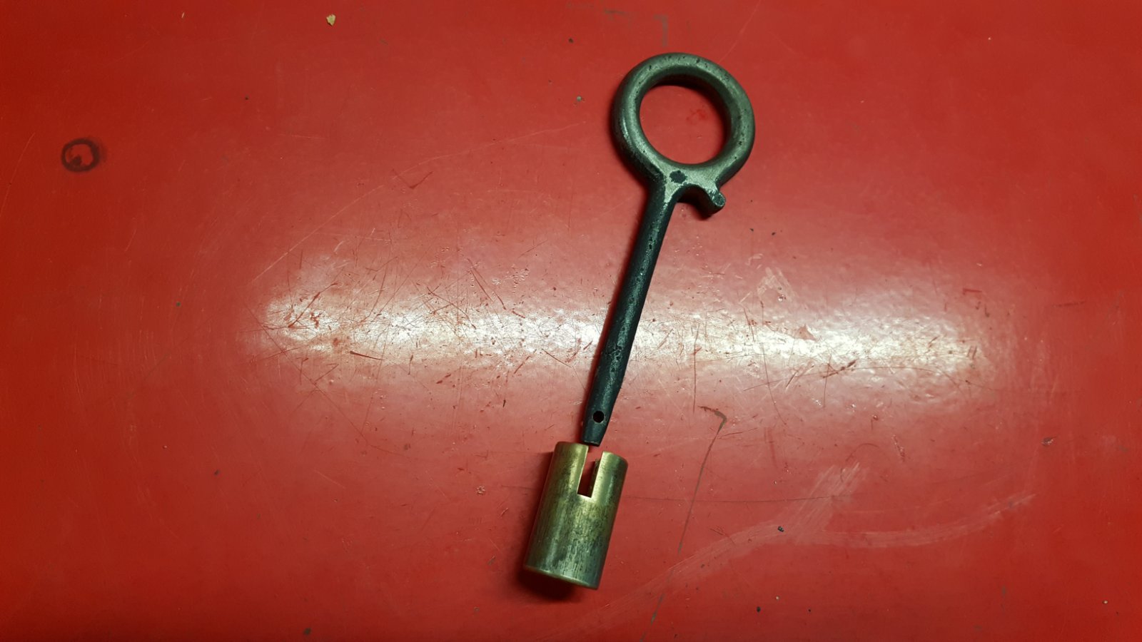

You make a spacer tool like so with a slot that stands on the inside of the frame rail. Cram the tool in place with the spring and washer on top, drop the clip through, align hole in clip with the slot in the tool, install the cotter pin, and remove.
The metric washers are not much larger than the od of the springs and are about the same size as the Ford washers. They should not require drilling larger holes in the frame.
You cannot just use a smaller washer because the spring itself is not intended to pass through the frame. Drilling the frame for topside installation of the assembly is not a good idea because then the clip spring is then pulling against the thin wood shelf on ends that are unsupported.
I think that's very much the case. Being able to make an assembly on the bench and slap it on is much more appealing having to futz with everything on car. I'm guessing the addition of a starter was not a factor in the equation since having one still makes installing the rear bolt on that side a problem.
