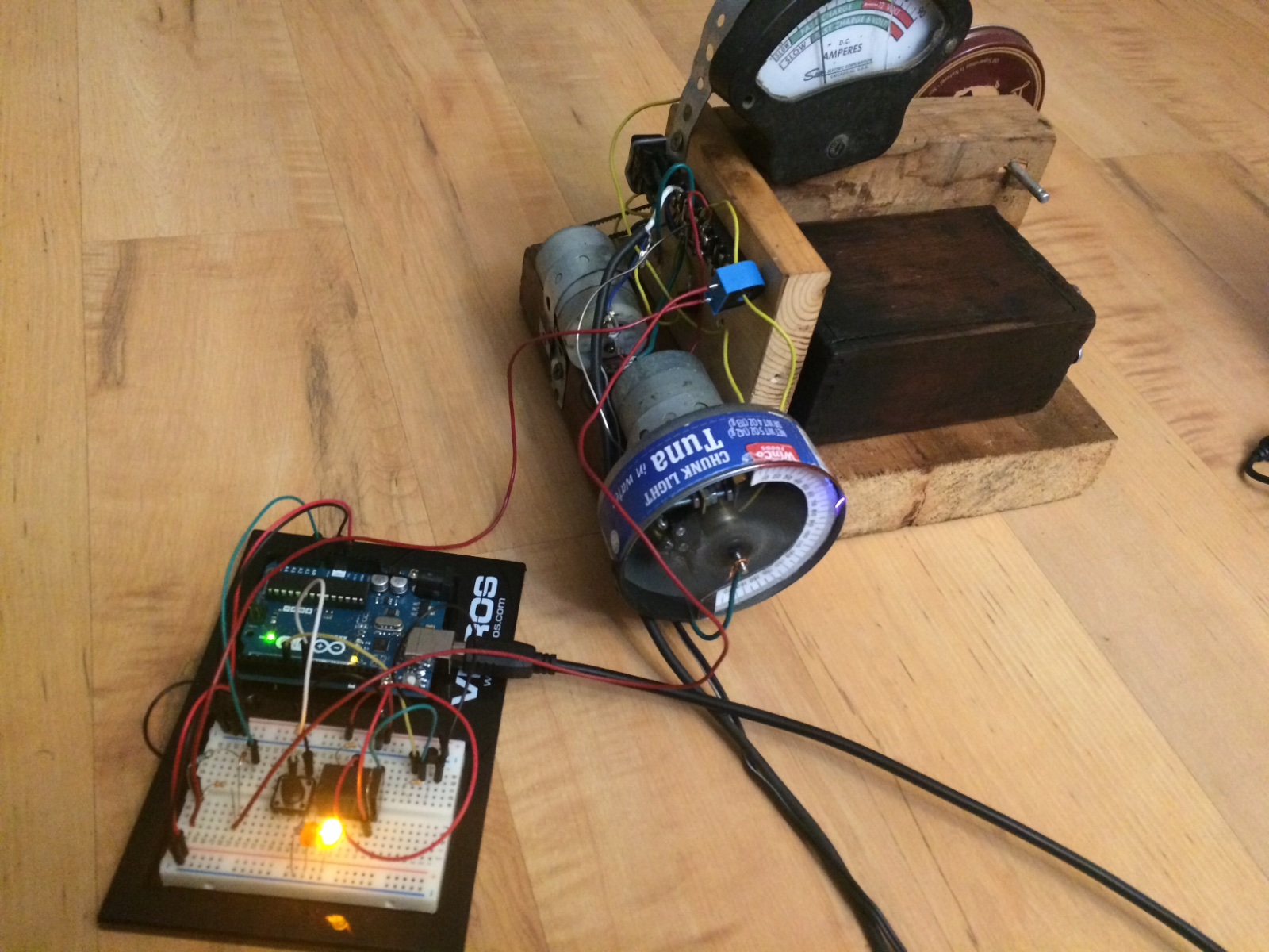

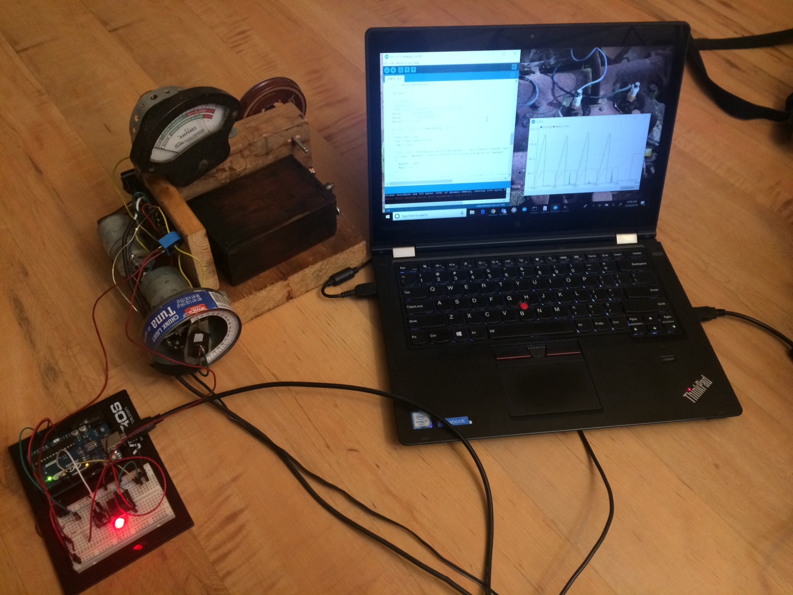

Hi,
I understand from reading a few posts that the subject of testing and setting Model T coils can be somewhat complicated...
Hopefully this post won't muddy the water, however I see that there are several methodologies of setting the coils/contacts ranging from the original hand-cranked machines, through a basic average reading current meter, to an electronic version of the hand-cranked tester.
Given several of my past and present lives I was interested in the theory/history behind the coil operation, and was intrigued to read a learned article by Mike Kossor, who I believe produces the 'ECCT'. While I've not gone into it in particular depth the detail presented in the article seemed thoroughly researched and well presented, and it prompted me to think about how I might go about testing the one spare coil I have.
Given our exchange rate the cost of the ECCT is somewhat prohibitive here in New Zealand, and as I have a little knowledge about such things I thought I'd try something dangerous and construct an electronic tester of my own.

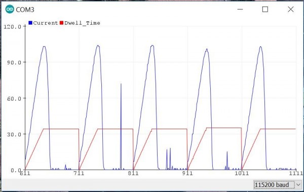

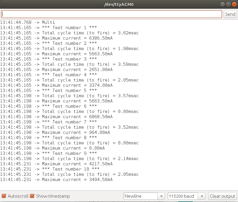

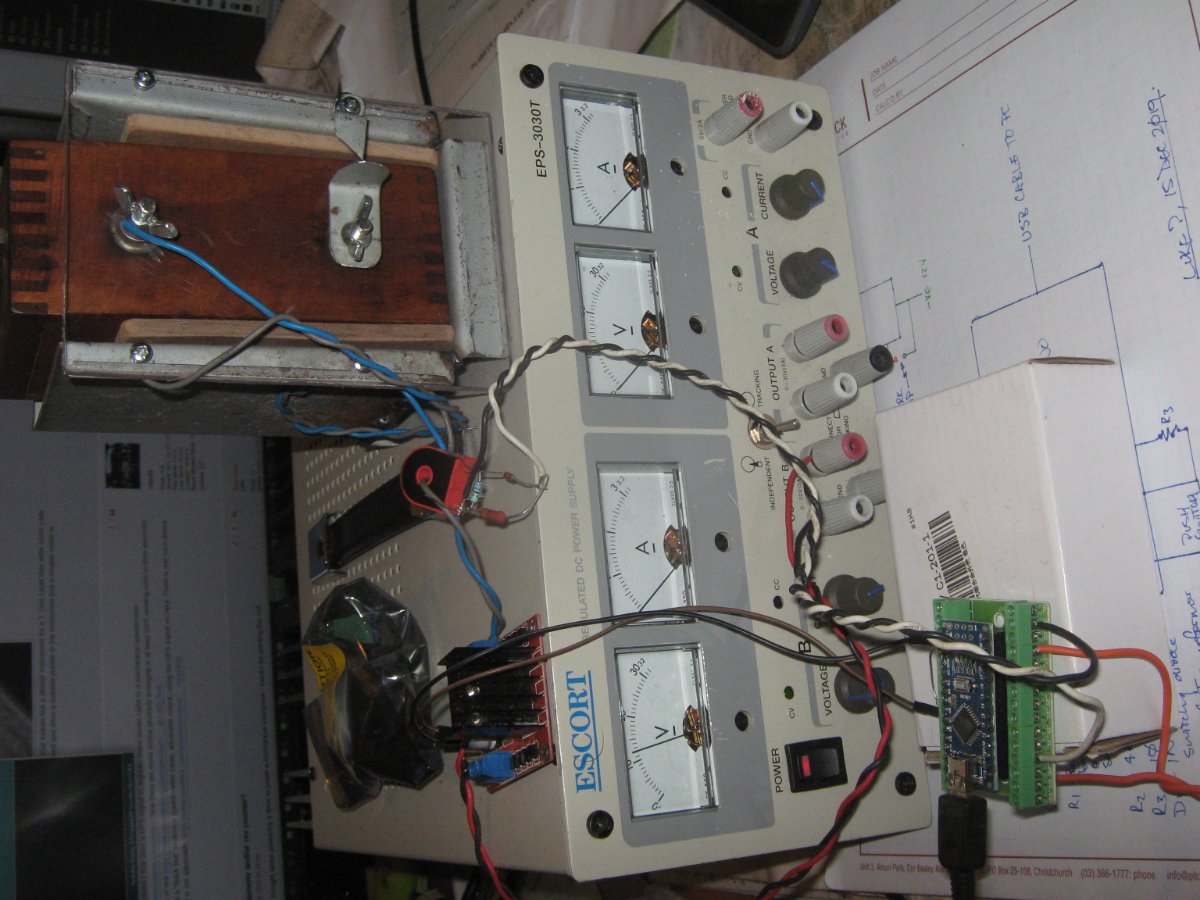

I'm pleased to report that I've done that, and at this early stage it appears to be working reasonably well. I use an Arduino (a small microprocessor) and a switching device (for example a solid-state relay) to switch the coil and take some measurements. Then I output the resultant test data to a PC. Ultimately I'll remove the PC requirement and just output the data to an LCD display.
Similar to Mike's product I am measuring the current ramp time from turn on through until the initial, then final, decay (time to fire). I also measure the peak current.
The cost of the hardware components I've used are around $15USD, not including the PC or power supply (which could be just a 12v battery). Such a tester should he reasonably straightforward for anyone with a little electronic/computer experience to assemble and use.
The Arduino requires software in order to make it into a tester. I've written a suitable program that can be uploaded to a blank Arduino and am happy to provide that to anyone who wants it (for free). In fact it would be good to post it here so that, in the true spirit of open-source, those who are far better at programming than me can pull it apart and make it better! Already a very talented friend of mine has taken my initial effort and vastly improved it, but there is room to improve and add functionality should anyone desire.
Anyway I post here to enquire if anyone's interested in this? If so is it ok by the forum for me to post the code and put up a diagram of how it fits together?

It would seem from the replies that there is some interest (I wasn't sure if there would be!), so I'll go ahead and write up what I've done to date. As I've a busy week this will take a few days, but perhaps I could do it more quickly if I separate it into two or three sections.
One thing I should make clear though. This is not a commercial product and I'm not trying to compete with anyone, nor am I selling any components - you can get what's needed from a number of sources. As it happens I've benefited from some of the things I've read here and elsewhere, and simply see this as a way to contribute back to the Model T community at large.
It's also interesting to me and something to learn from, and in releasing the code as an open-source project it'd be something that others may also learn from and be able to assist with, thus ultimately improving it for everyone that might want to use it.
Finally, some quick replies - Bob J, this is a working project, if you were local I'd say come around and see but as you're not I'll just try and start on the writeup this weekend and will post that here when written. Adam, I'd love to have a scrap pile like that! John Housego, although I prefer Python to C I don't think a Pi would work so well in this instance. Jab35, sounds like a couple of good ideas.
I'll start on writeup this weekend,
Cheers, Luke.

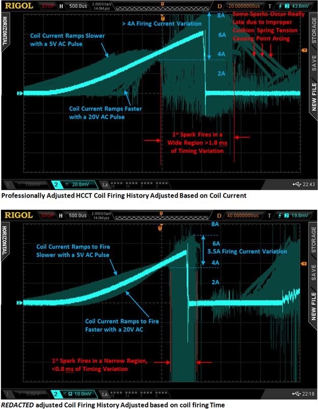

Adam, what Luke is doing is showing folks how to do for Free what others have taken years to research, develop and build into established products that benefit the Model T hobby. That’s his prerogative to freely share his investment in time, effort and education.
I feel a few comments are in order given it was my research and product development (ECCT) he cited as the basis of his work. I think it’s a fair and reasonable assumption everyone here expects their time and effort on education and training to be of value to themselves and others. That it’s reasonable everyone expects to be fairly compensated for the goods they produce or services they perform using the knowledge they learned and skills they developed. Especially if they have undertaken the added risk of producing their products in mass for others benefit without any guarantee of success. The reward is Profit and the risk is Loss. I am fortunate the work I did to design and produce the ECCT for 1/3 the cost of the old HCCT standard has proven exceptionally effective and does generate profit. I would like folks here to know a good deal of that profit was used to research and develop other innovative products for the Model T hobby many enjoy today (E-Timer, I-Timer and 3in1 coil adjusting tool) and was used to support the hobby in many other ways: Paid ads in The Vintage Ford magazine and The Model T Times magazine help keep publishing, operating costs down and MTFCA/MTFCI dues costs down, sponsoring the Montana 500 , door prize donations to various Model T Tours to help keep costs down and Youth auctions that help ensure the Model T Hobby lives on. Lastly, that profit helps offset the many hours spend on evenings and weekends discussing engine and coil performance issues with ECCT users. Offering troubleshooting suggestions and coaching them on the art of coil point adjustment using the ECCT.
Its nice Luke received a warm enthusiastic welcome on posting his open source DIY coil tester to the Forum and hope it inspires others to learn and experiment with technology. One piece of sound advice I will offer is don’t dare disclose $5 DIY voltage regulator.

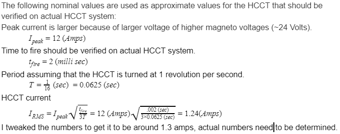

Earlier this year, I developed a Motor Controlled Coil Tester (MCCT). https://www.mtfca.com/phpBB3/viewtopic.php?t=3153 It works fine, but I didn't continue the development as I focused my spare time on other T projects. Here are some of the learning points for me:
  • Buy a set of rebuilt coils with your first Model T! I should have paid the $200 to get a set of coils rebuilt correctly as sooner. I can't imagine how many people spent time and money on engine problems that were really just coil problems. Coils are cheap compared to lots the problems or apparent problems bad coils can cause.
  • Buy a ECCT. In the process of working on the tester I realized how important a good tester is. I decided at this point I have a lot of coils and cars (mine and others) that it would be helpful to be able to test and rebuild coils. So I got that peanut butter jar (figuratively) and starting saving money in it.
I will be following your updates. I decided to make a mechanical tester, but ironically my background is in electronics. Perhaps I will be of help to you. But I would imagine no mater where you go with your development these two learning points will be helpful for others who want to spend their time elsewhere.
Matt

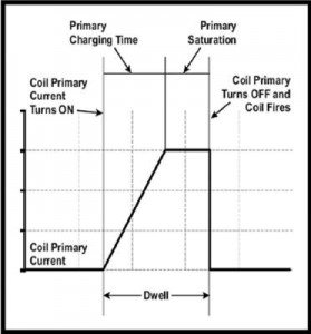

From what I could see T coils, rather cunningly, utilise the magnetic field induced when current is applied to the primary coil to also draw the points open after a time, which then collapses the field releasing the points and allowing them to close and start the process again. This operates much like a mechanical oscillator, which in the case of the vibrators could carry on for many hours without interuption, whereas the T coils are utilised intermittently as current is applied via the timing commutator, theoretically at the right time to fire the fuel mixture in the requisite cylinder.
With regard to timing, in a points-coil-distributor system there’s the ignition timing is controlled by the points, typically driven by a cam that itself is driven by gear or chain from the crankshaft. The points, upon open, will cause the single coil to produce sufficient voltage to drive a spark plug via the distributor. Other than the automatic advance-retard mechanism, once set there’s very little that will change the ignition timing of such a vehicle (disgregarding cam block wear for a moment).
Germane to the Model T it’s important to note that the spark in this system doesn’t actually occur instantly upon change to the low-tension voltage due to the ramp or ‘dwell’ time it takes for the coil/condensor/points to interoperate. An example of this time-to-fire (or ‘dwell’ time) with a standard ignition coil may be seen here http://www.underhoodservice.com/using-o ... ion-coils/ Importantly, in a modern system such as this with a single coil and distributor, the time to fire for and between each plug is fixed.
In the case of the Model T the crankshaft drives the timer/commutator, which itself may be altered manually by the driver to set the overall timing. The commutator then powers each individual coil which themselves have a set of points than can individually affect the eventual spark time according to the way they are set.
This speed or time of operation of the T coils is just as important as the voltage they produce because although the overall engine timing can be somewhat arbitrary, given it’s left up to the driver to set the advance/retard as they see fit, the cross-cylinder timing can be affected by the way each individual coil is set up. In other words while the timing set may be correct for one coil at the particular engine conditions of the time it may not be the case for the others if they don’t produce the necessary spark at the same time as the others when initially powered up.
Thus from basic calculation it seemed to me that a fairly small change in ‘time to fire’ could result in several degrees of crank rotation either way, and that perhaps it would be prudent to look at how my coils performed in this aspect of operation.

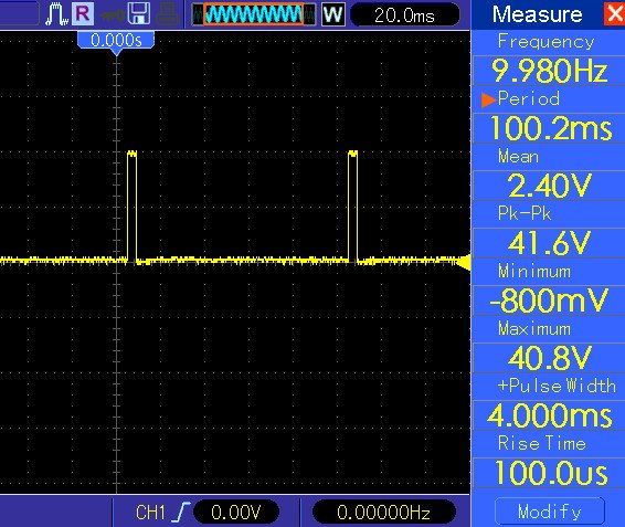

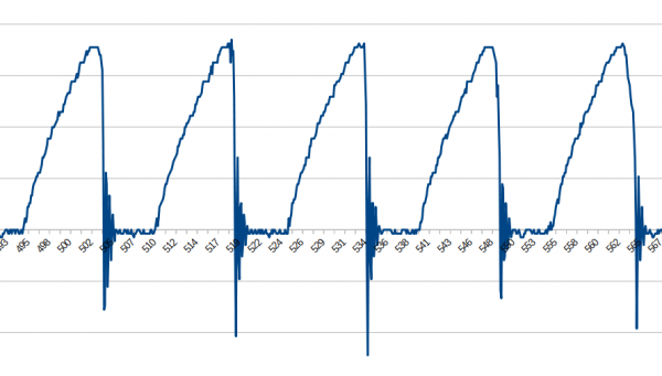

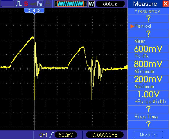

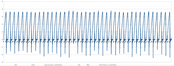

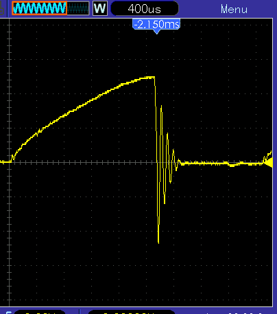

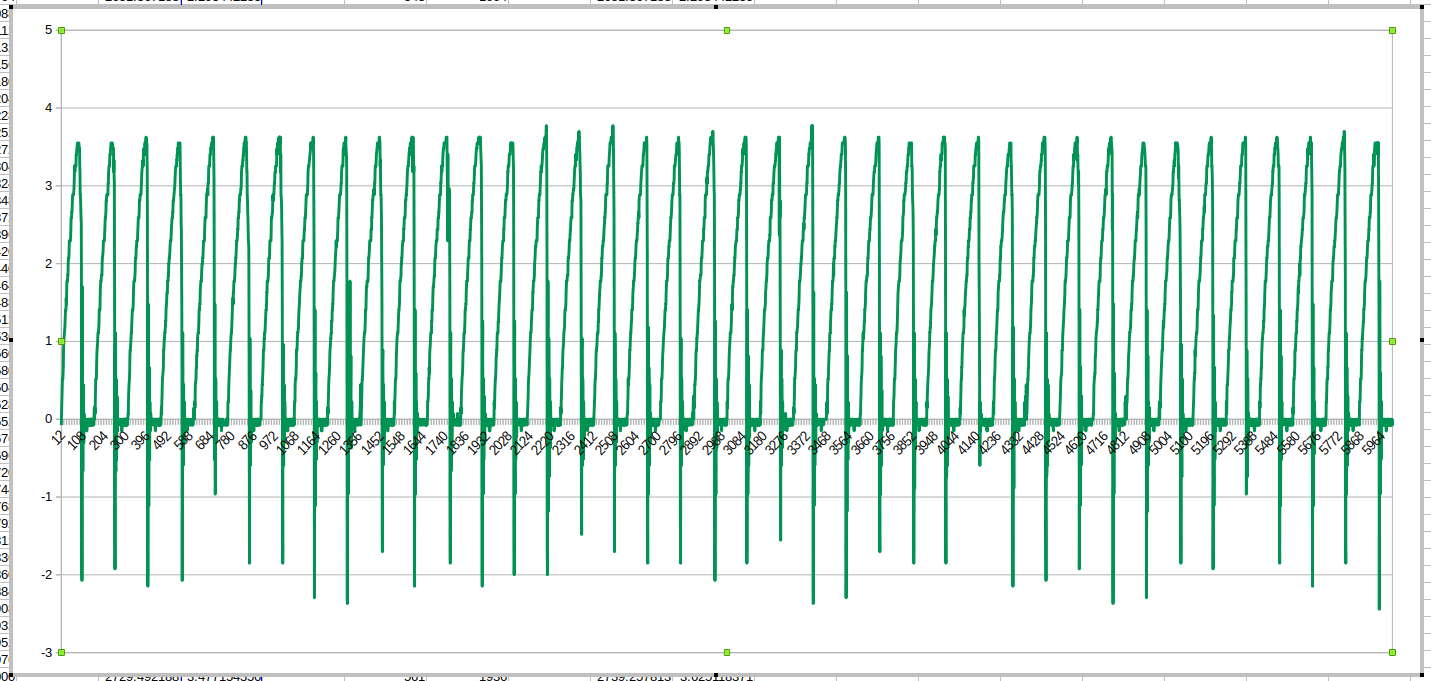

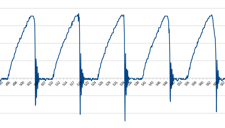

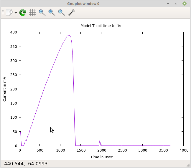

After thinking about how I might set up a suitable test (utilising a function generator and oscilloscope) I cast around the ‘net to see what others had done and came across an interesting article by ‘cool386’ here http://members.iinet.net.au/~cool386/tester/tester.html This article had a couple of links, including one to a commercial product called the ‘ECCT’. I read more about this on the product website and in an article by the designer here http://www.modeltecct.com/uploads/The_D ... dox_V5.pdf At the same time I read about the electro-mechanical coil testers of the time, known as the ‘HCCT’, and other more recent but similar devices such as a Strobo-spark etc.
Although I could have just utilised my ‘scope as is, similar to ‘cool386’s’ article I like to have and/or make specific tools for certain tasks, and this problem sounded like it could be a good candidate for just the right special tool. As such I was initially attracted to the electro-mechanical devices and considered making something similar to Gary Tilstroms design here: http://www.mtfca.com/discus/messages/80 ... -93057.pdf Unfortunately as I don’t have an abundance of old T parts here, and given my initial thoughts on testing were confirmed and enlarged by ‘cool386’ and Mike Kossor’s article, I thought going down the electronic route was probably a viable option.
Initial thoughts and design requirements for the tester
Although I started my electronic life with valves I’ve moved on and have over the years utilised transistors, IC’s, and then computers of various sizes and types. More lately I’ve used a number of different embedded micros in association with inexpensive utility modules as building blocks to accomplish all sorts of different tasks, and it seemed to me that I could do the same here. Having had some experience with them to my mind a small micro called an ‘Arduino’ could provide the necessary real-time capability to get a Model T coil-tester project operational.

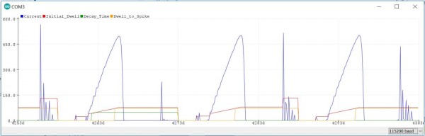

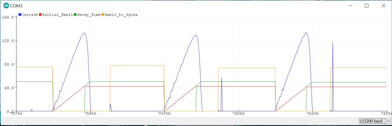

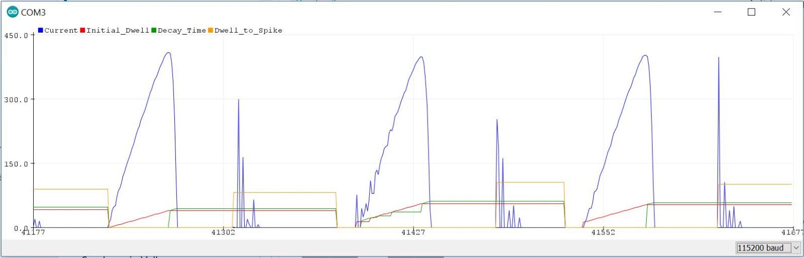

In essence it seemed to me that what I needed to do was fairly straightforward – first power up the primary coil, measuring the supply current at the same time, then look for the decay time as the points begin to open (just as you would see on a ‘scope) at which point the secondary coil should produce the high voltage for requisite sparks.
For several reasons the peak current, the time from turn on ‘till initial decay, then complete decay were the main data points I felt were needed to complete the main picture. All of this could have been provided by my ‘scope but it’s comparatively bulky and rather more complex than needed for this simple task, and as I recalled seeing something about a basic ‘scope project someone had done with an Arduino I thought this would be a good place to start my more focused research.

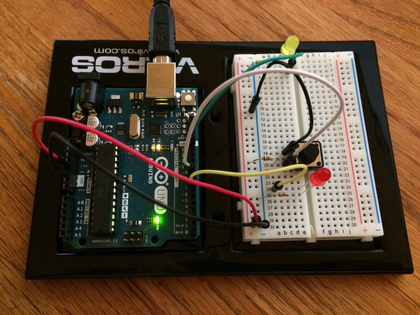

A brief explanation of an Arduino
At this point it’s probably worth explaining what an Arduino is for those that are unfamiliar with such things. The Arduino is much like a very small computer, but it has the advantage of having a number of quite configurable connections or ‘pins’ that a software program uploaded to it can utilise. These pins are able to be commanded by software to turn things on or off, or read the output of signals applied to them.
The software that runs on an Arduino works in much the same way as any software you’d use on your computer and which you control by your mouse or keyboard (ie. you command it to do something, in other words an ‘input’, and it will usually produce a result or ‘output’). One big difference is that you can’t plug a standard monitor directly into an Arduino, it just doesn’t have that facility. However you can produce results that an ordinary PC will display via a standard USB port, or you can connect a LCD display.
A new Arduino is essentially a blank slate, requiring someone to write some software code and then upload it to the unit, typically via the same USB connection you can read results from. The software tells the Arduino to do certain things, toggle pins up and down, meaure times or voltage inputs, and do various calculations for example. These things can be combined in a way to make the little unit quite a useful stand-alone processor.
If you’re interested in learning more about Arduino’s here’s a couple of links https://www.arduino.cc/en/guide/introduction and https://learn.sparkfun.com/tutorials/wh ... rduino/all
Back to the specifics of the tester design

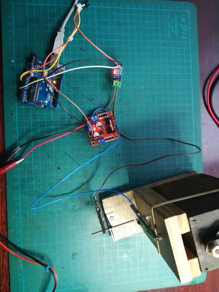

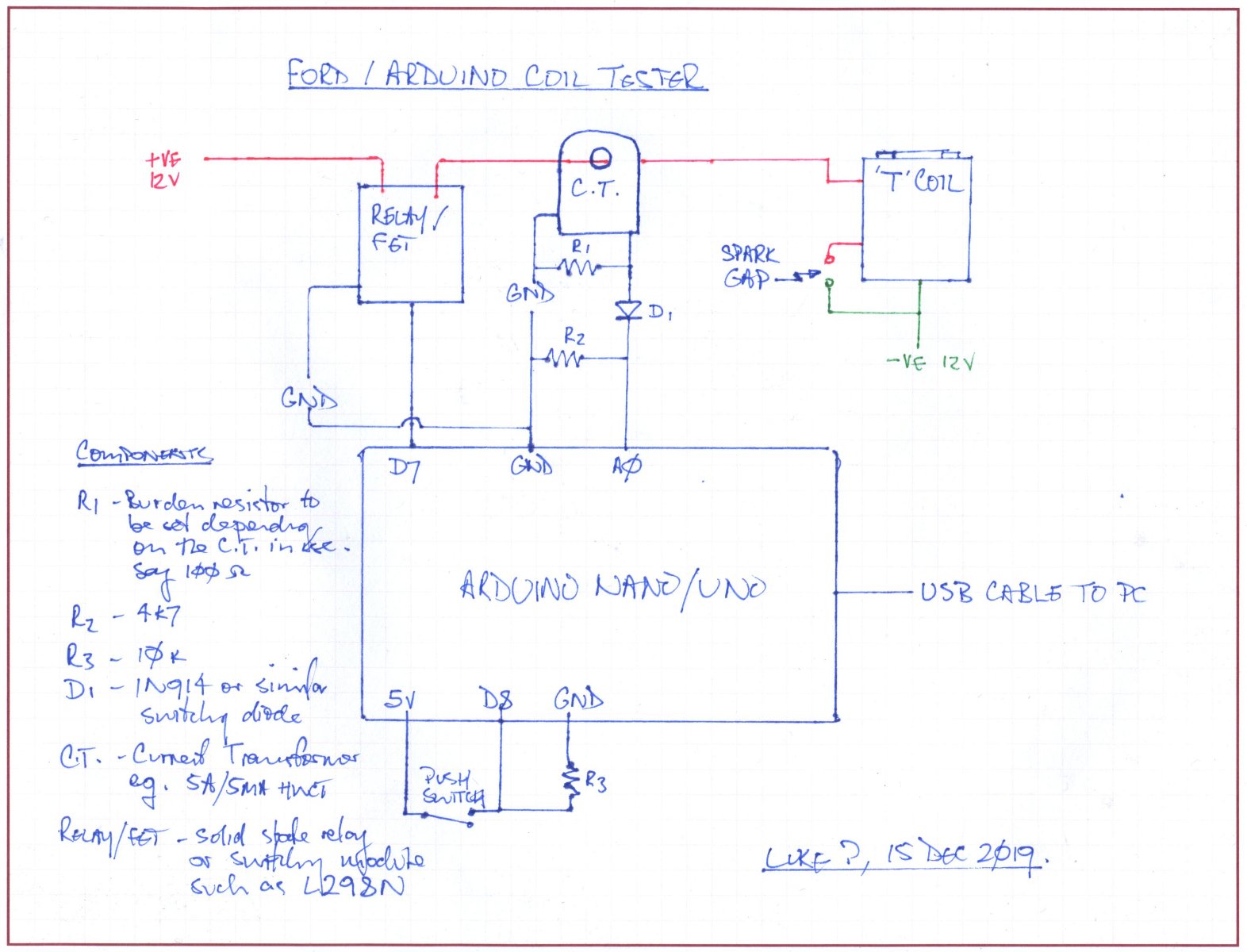

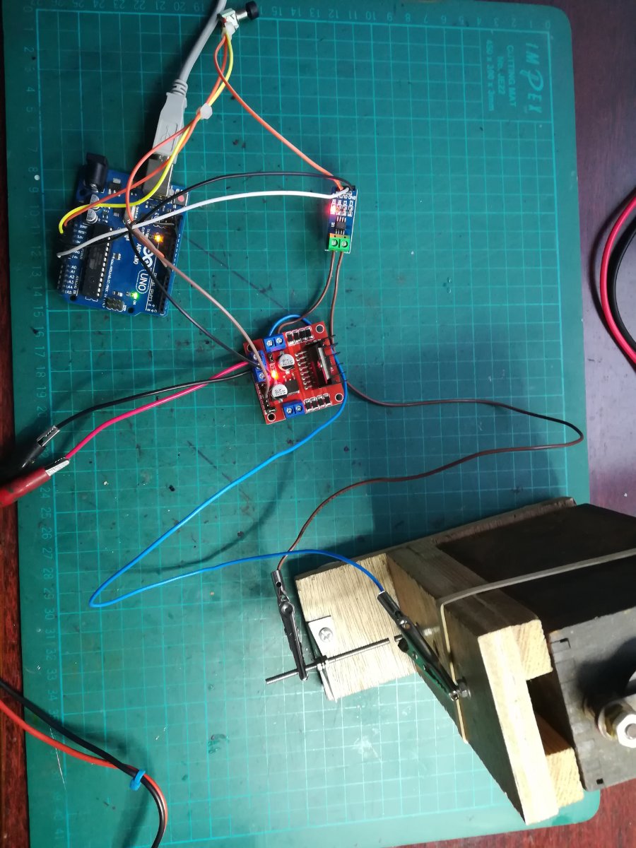

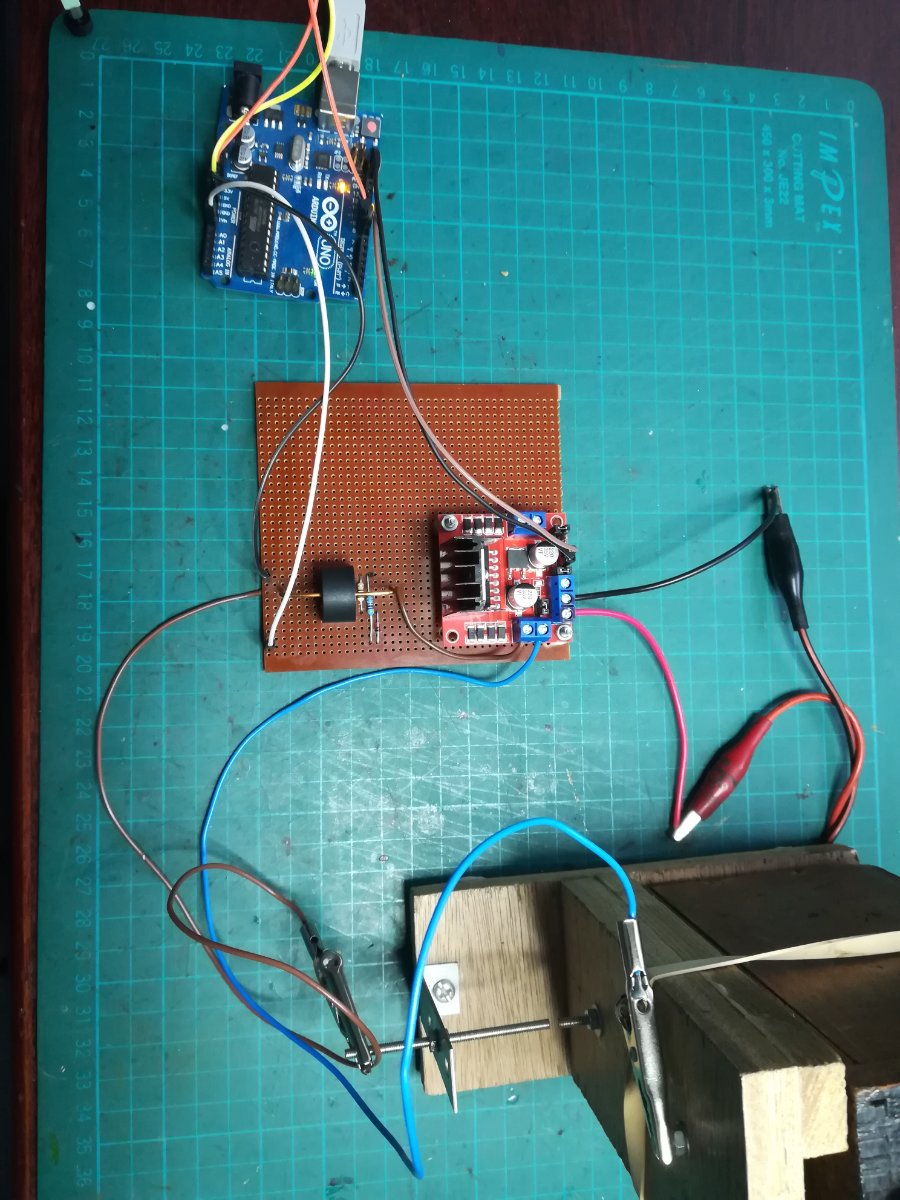

In the case of the Model T coil timer thought I could utilise a digital ouput pin of the Arduino to turn on the power supply to the coil for a short time, and an analog input pin to read the resultant current via a small current transformer (a device that provides a signal the Arduino can read). This process is started by a single push switch that’s connected to a digital input pin.
As the Arduino is a small device and not capable of handling large currents I needed use another module (in this case a spare ‘h’ bridge motor controller) to supply power to the coil. This could also be a solid-state relay or simply a suitable power transistor capable of handling peak currents of up to 10A.

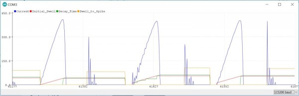

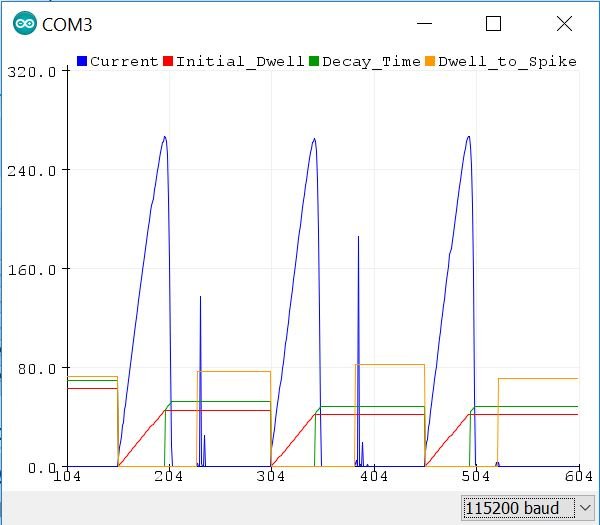

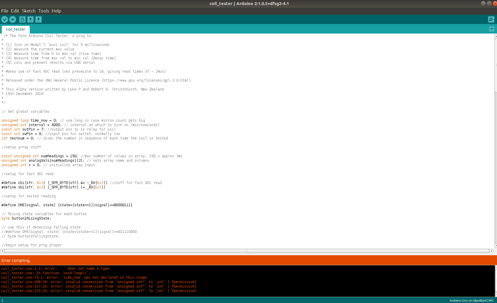

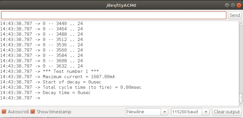

Given the blank state of a new Arduino software needed to be written to command the pins as described above. This would ensure that the current measurements from the analog input pin were captured and inputted into an array (think of it like a ledger). This array could then processed later by the Arduino and the data analysed once the spark cycle has completed. It’s important to wait because during the capture phase (right after we apply power and until just after the points open) we need to concentrate on collecting the data first, otherwise the Arduino timing could suffer.

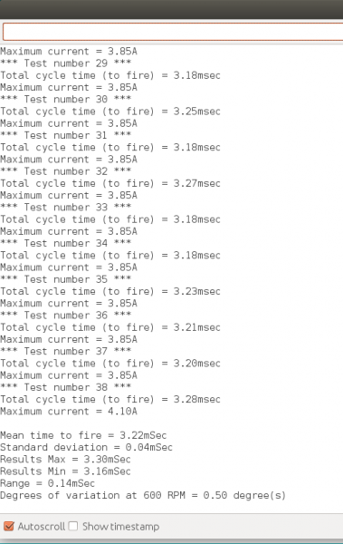

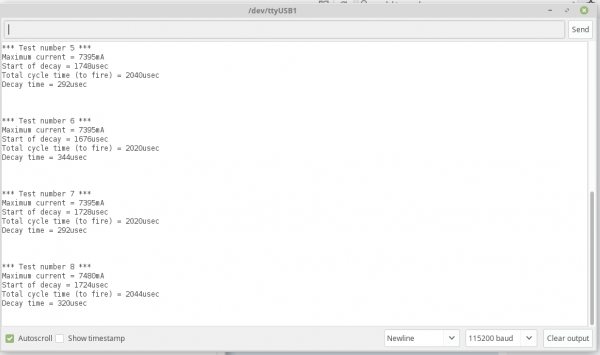

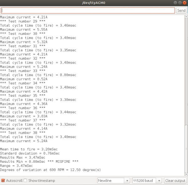

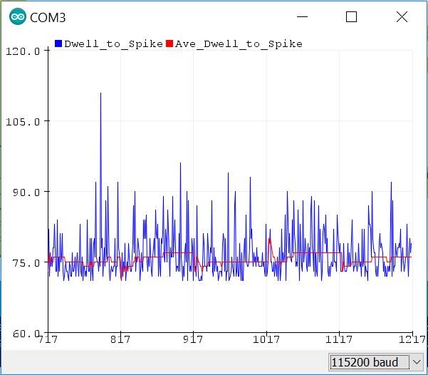

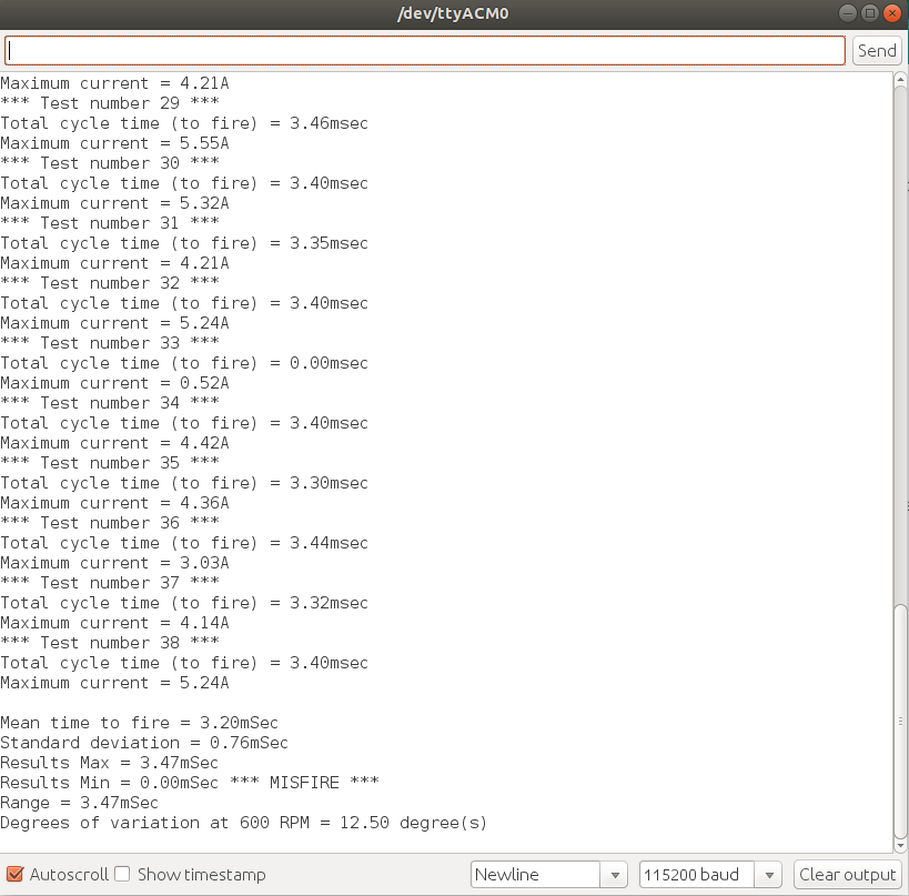

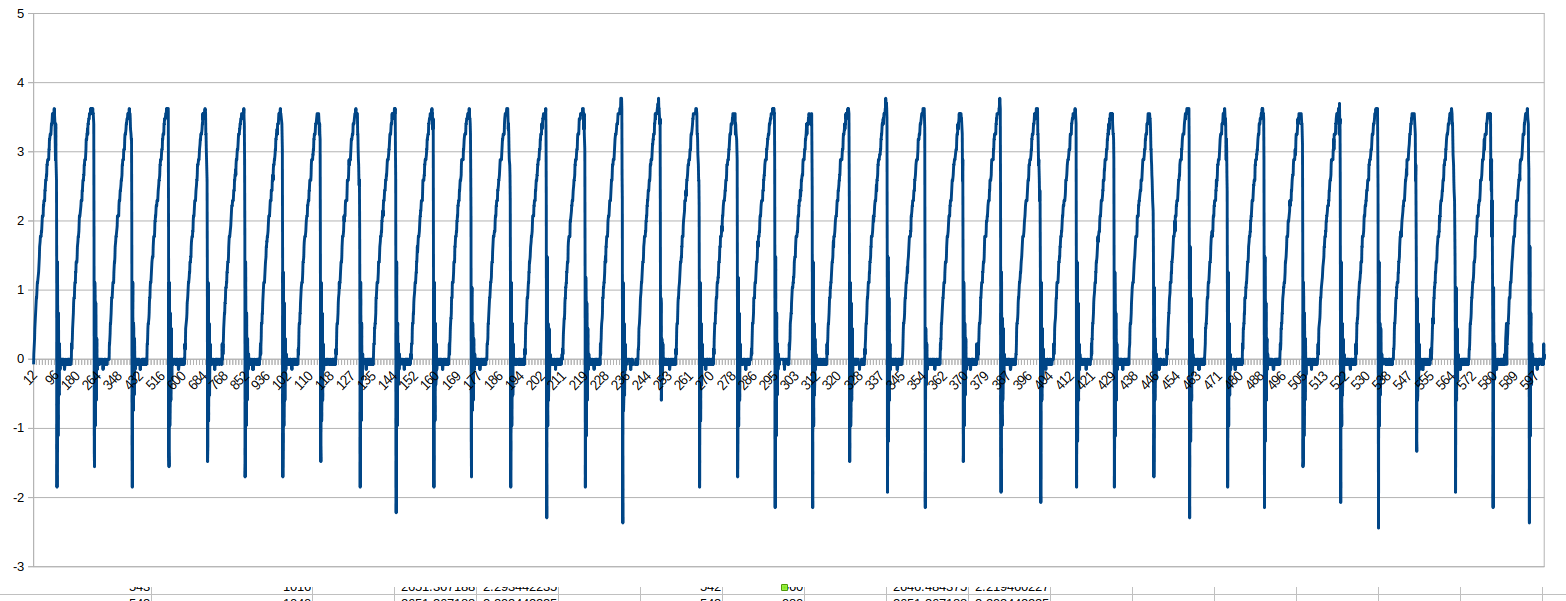

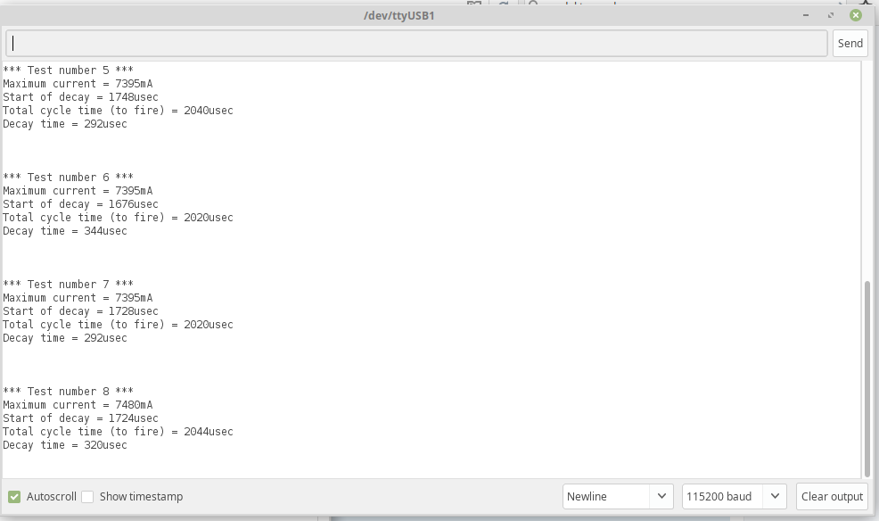

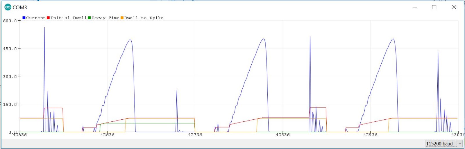

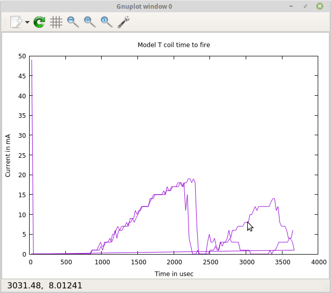

The caputred data is taken from the array with the peak current, the time ‘till initial decay, and time to total decay being calculated and presented in a suitable format. This is then output via a USB cable to a PC and displayed in human-readable form. The only software required on the PC is a standard ‘terminal’ program, so it will work with both Linux and M$ based machines.
It would also be a fairly trivial job to also output the data to a small LCD screen, making the entire operation free from anything else. At this early experimental stage I’ve remained using the PC as I also use that to modify the code and upload to the Arduino.

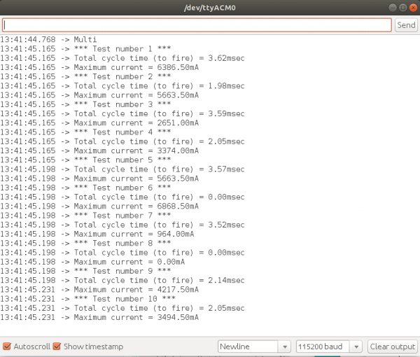

Overcoming issues

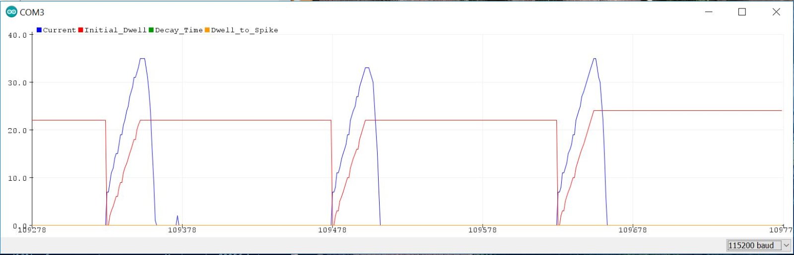

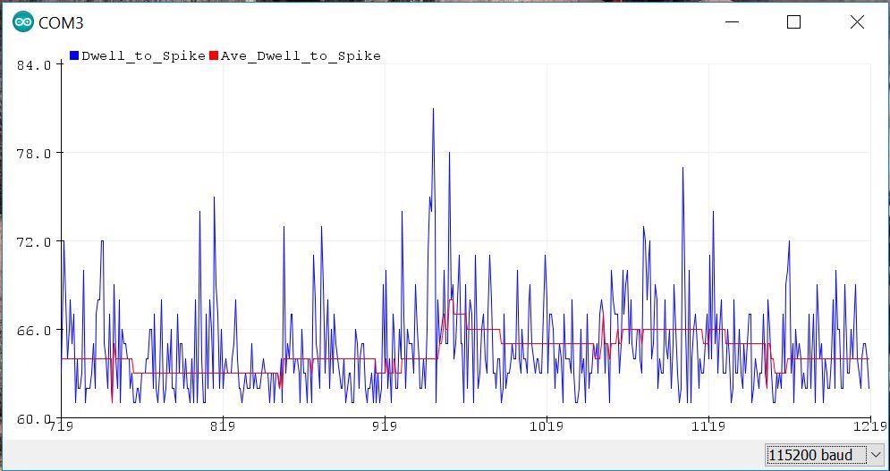

The Arduino is not without its limitations, one of these being the speed at which the ADC (analog to digital converter) operates – how quickly it can read the current measurements. In standard guise the Arduino will make its first read in something over 200usec, and thereafter a little over 100usec.
A 200usec variation would be marginal in terms of measuring and setting coil timing to a reasonably accurate level so the software we’ve written modifies the internal presecaler in a way that gets the typical sample time down to 24usec, which in my view is quite adequate for this task.
It’s possible we could improve this further, particularly if one dropped the 10-bit resolution down to 8-bit, but for the moment it works reasonably well. If this doesn’t make any sense to you there’s no need to worry – I just include it for those that might be interested in such things.

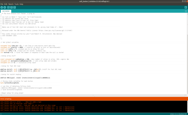

Another issue is personal. Quite simply I’m not a natural programmer; personal computers didn’t really exist when I began my career and I don’t have the best mindset or understanding to produce the best code. Although I did a little programming in the late ‘70’s, and then again in the 90’s, I’ve been fortunate that in more recent times I’ve been able to persuade a friend of mine, who is a very good programmer, to have a look at some of my efforts and ‘fix’ some of the more glaring messups I’ve made. In general I’m good with ideas and directions, and can get something to work initially, but refining things and getting something to work well is Robert’s forte.
Producing the code
Making things work better, or adapting something to make it do something else useful is also where the concept of ‘open source’ plays an important part. Simplistically open-source is when you write some software code and make the source available to everyone to replicate and use, usually free of charge. While this means that the person initially spending their time and skill producing something may not always benefit financially it often helps a lot of other people out and can result in some stunning outcomes as others take the initial design and markedly improve or adapt it to do other unthought of things. A good writeup about open-source is available here https://en.wikipedia.org/wiki/Open-source_software or here https://en.wikipedia.org/wiki/Open-source_software
In my writing of the initial code for this coil tester I’ve utilised information from things that others have done (how to speed up the analog read for example) and, with Robert’s input, this freely given code and information has assisted me to produce something that will hopefully benefit others. As a result, and in further hope that those who are able will be able to refine it further, I will publish the code here, in a separate post, under a license that makes it available to all – but will also require anyone modifying the code to publish their modifications too.
As such I hope this will ultimately produce a good, useful and inexpensive tool that will assist some to keep their Model T’s running well. As a means of differentiating it from other testers I initially called it something cool like “Arduino Coil Tester’ but Robert, who has a certain dry wit, suggested ‘Ford/Arduino Coil Tester’ or ‘FACT’ for short, so that’s been it for the moment, but perhaps you could think of something else.
Having a go
I have written the above in order to, hopefully, provide some explanation of how this works to those that won’t have had much to do with such things before. Those of you that have can just skip to the relevant bits, but if you’ve a mind to ‘tinker’ and would like to give it a try then the code I’ve produced to date should work and should provide you with some useful information and allow you to set your coil timing.
The parts needed are inexpensive and may be obtained from local electronic supply stores, or from mail-order suppliers such as Element14, Aliexpress and the like. Apart from a PC, some hookup wire and a 12V power source, the bits you’ll need are:
Arduino Nano, Uno or similar (with a 328P processor)

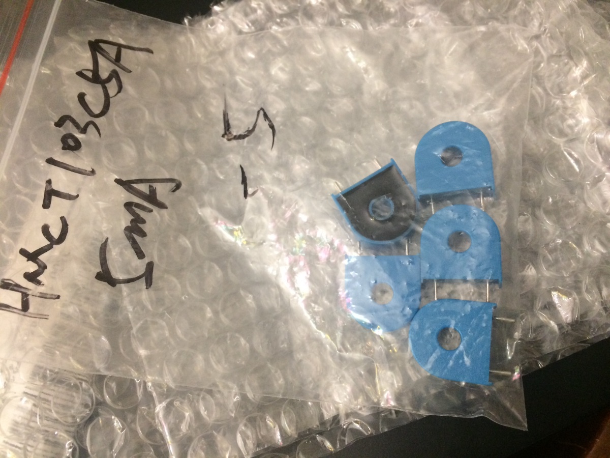

Current transformer (small)
FET, solid-state relay, or other solid-state current switching unit capable of ~10A peak
2 x resistors
1 x switching diode
1 x push-switch
You’ll also need to make a test fixture to fit the coil box into, and which allows you to connect the requisite wires from the tester to the coil. This will also need to provide a spark gap for the coil to operate with. You could just connect a plug but I think something with a gap of around 3/8” is likely to be better and will give better/more useful information around the ‘strength’ and quality of the resultant spark.
How to connect it up
The Arduino may be powered from the PC, the solid-state switch will need a 12V (+ve) supply from one side to the coil upper side contact, this wire also passes through the current transformer. The 12v (-ve) supply is connected to the bottom contact. The spark gap goes between the bottom contact, and the bottom side contact of the coil.
The Arduino pins to be connected are:
Pin A0 and ground to the current transformer via a 1N914 or similar switching diode. The current transformer will need a burden resistor of a suitable value that keeps the pulse voltage below 5V. In my case 100 ohms was about right – you will need to scale the output to current in the current.
Pin D7 and ground to the high-current switching device.
Pin D8 goes to the push switch, and to ground via a 10k or thereabouts resistor. The other side of the push switch connects to the 5V output pin of the Arduino. I’ll probably change this to make it simpler, but for the moment this is how it’s working.

  • Yes, a BOM could be useful, although there's a bit of detail in the diagram. I'll probably post a photo or two later in the day that may help others to understand what it all looks like.

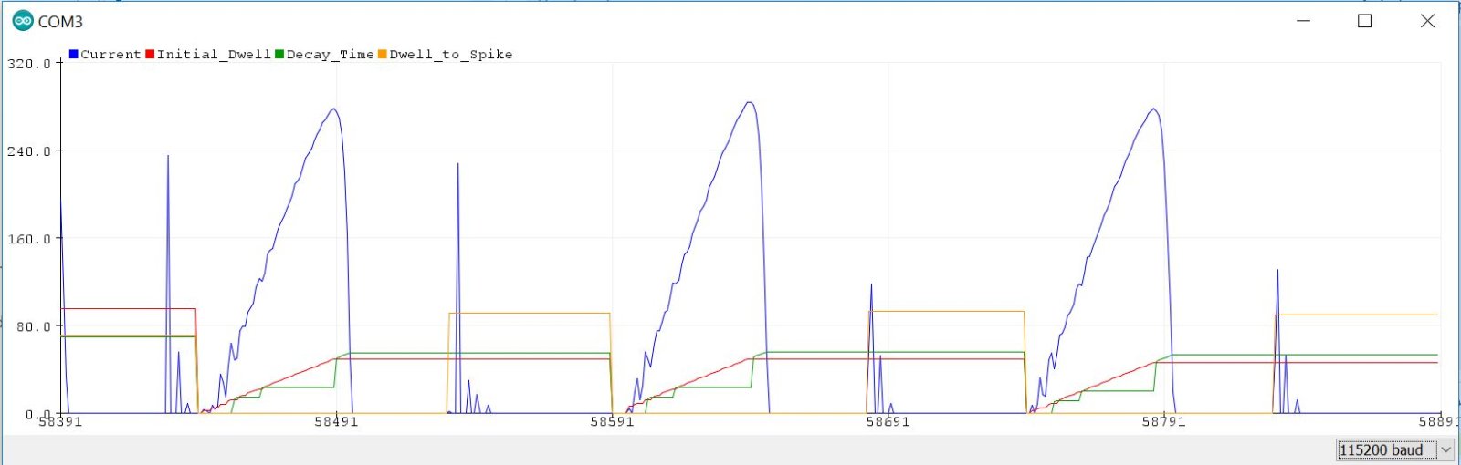

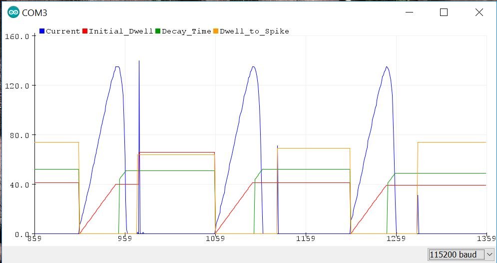

A couple of images.
Post by Luke » Mon Dec 16, 2019 1:54 am
This may be of interest, it's a photo showing the various components of the prototype tester - obviously very experimental at this stage!
The small board in the foreground is the Arduino, the board sitting atop the power supply is the switching module, and the orange thing with a wire passing through it on the way to the coil is the current transformer.
Also, although the angle isn't the best in this photo, you should get an idea of how I've managed the spark gap for the coil:
And this shows what the output to a PC looks like at present, as you'll see that coil appears to be a little variable:

Post by John Housego » Mon Dec 16, 2019 6:15 am
Hello Luke, Im sure you dont want to get in to software questions but would you kindly confirm the code will compile OK as I am getting errors. If it does then I will investigate the code to see whats wrong my end. As I have limited knowledge of C this would be a good starting point before I investigate. I am more used to Python. Thanks in anticipation. John (UK).

John Housego - I don't mind these sort of questions, was just trying to avoid 'how do I connect an Arduino to my computer'! Anyway I'm guessing that when I pasted the code into the forum it's messed up somewhere along the line, certainly it trashed the formatting. As I'm presently updating things I'll post the code again and when I've finished and will copy it back to see if it compiles ok for me. I'll let you know if that works ok.
Farmer J - Down here at the bottom of the world Brent and Ron are a little way away (I presume!), and besides what would we all learn from just sending things away?
Walber, - Fortran/Cobol I suppose? Anyway, in for a penny, in for a pound, how about a full electronic system on that speedster of yours :mrgreen:

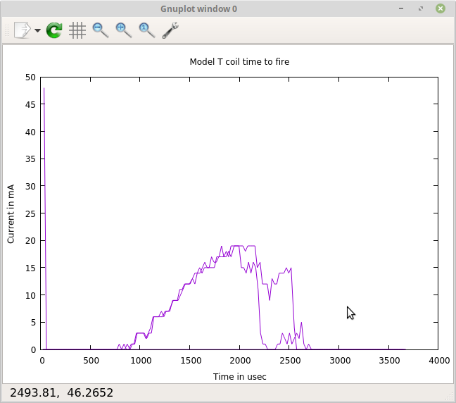

Simple code to plot data on screen.
Post by Luke » Tue Dec 17, 2019 1:36 am
Partly for John Housego I've written a simple Python script that will take the output from the FACT and plot it to your screen.
Here's what it looks like:
This shows time to fire in microseconds on the x-axis, and coil current on the y-axis. Please ignore the current value in this instance, I've not worried about calibrating it - it's more the time-to-fire and the shape of the decay curve that interests me.
The Python script needs to be used in conjunction with the new simplified Arduino code that I'll also include here. All this does is export the collected data via the serial (USB) port specified.
Note that I use Linux and haven't tried the Python code in a Windows machine. You may need to specify the port differently if that's what you're using.
Also I see that phpbb has messed up the formatting again. The C code should work ok as is but the Python code needs indenting after "while 1:"

Luke, I have now managed to compile and load your original code. I was using Ubuntu Linux and I think there is an issue with the IDE install that I need to sort. Now using a Windozzzzz PC and the original code loads OK but your new code will not compile, it has errors unfortunately. I have most components for the hardware just waiting for 1 to arrive. Thanks again for sharing this. John
Luke
Posts: 617
Joined: Fri Dec 13, 2019 1:04 am
First Name: Luke
Last Name: P
* REQUIRED* Type and Year of Model Ts owned: 1926
Location: New Zealand
Re: A new DIY electronic coil tester.
Post by Luke » Wed Dec 18, 2019 2:20 pm
Hi John,
By original code I assume you mean the first post (the, er, 'FACT' code :). If so you'll see that I updated it, which may have been between the two different times you tried - so it may be worth trying Ubuntu again. Normally I'd find that somewhat more reliable than M$.
When you say the new code won't compile - are you meaning the C or Python code, and what are the errors exactly?
Update - I just tried copying the C code from the later (serial data out) post directly into the IDE and tried compiling it. Despite it looking exactly like the code that I copied it from it failed around the Serial.print lines. If I deleted and copied just that from the original it compiled fine.
My conclusion is that (without looking deeply into it) phpBB is perhaps adding some chars somewhere along the link :-(
I think that if you were to delete the Serial.print lines and type them in by hand it should work. Please let me know if it does - I might need to find another way to post the code...

Post by Luke » Wed Dec 18, 2019 2:40 pm
Yesterday I was able to trial the tester out on some other coils, thanks Chris.
What it confirmed was (1) the tester appears to be working ok (2) my only test coil is pretty sad!
With Chris' coils, set up on his hand-crank machine, the tester gave typical ramp+decay times (t.t.fire) of ~2.9ms, whereas my coil was showing a much shorter time. Additionally (and something I knew already) my coil wouldn't arc across much more than 3/16" whereas the others would do a good 1/2" and probably more. Testing my coil on the hand-crank tester showed it was rubbish too.
Anyway it was all very useful. Other than the fact that it's highlighted a small change I should make in the code (around the initial decay detection - something that was a bit of a hack anyway) I was reasonably pleased with the results. Unfortunately I didn't have the 'scope with me (something I'll rectify next time!), however it seemed that the tester was issuing reliable and consistently reproducible output. While I'd like to confirm the absolute times given with the 'scope there's nothing to suggest I should expect anything other than what the tester was saying.
Thus while there's still some more work to do I'm happy with progress at this stage. With a bit more coding, and perhaps the addition of an LCD screen to make it independent of a PC I think it's well on the way to becoming a useable tool for those without anything better.
That said, I'd welcome input from anyone else who might have further insights, or has a go at building one. Hopefully John will have some success shortly and be able to post some results/info.

I found among my electronics an Ardrino Kit that was given to me with other electronics.
Though I have worked with microcontrollers, I have never worked with Ardrinos. But with your code and the fact I really have no excuse with the hardware in front of me I decided to move forward. I copied and pasted the code and found that I got errors on the following lines:
//begin data send to serial port
delay(50);
for(int i = 0; i < numReadings; i++)
Serial.print(analogVals[1]);
Serial.print(" ");
Serial.println(analogVals[0]);
I found an issue with copying and pasting. You use [ i ] in your code (without spaces before and after the "i", but this means start italics on the forum). I was able to fix the issue and experiment with the code. For now I am just lighting LEDs as I need the necessary hardware to connect with a Ford coil.
Also, could you please describe how you are displaying the results from the array. (Perhaps I just need to learn how to use the Ardrino IDE.) How are you using the Python Script?
Thanks,
Matt

Matt,
Well done on sorting that out, I think I'll need to figure out a better way to put up the code.
Great you've found a use for that kit! If you're using the first C code (entitled "The Ford Arduino Coil Tester") then if you open a 'serial monitor' window in the Arduino IDE it should receive and display data from the Arduino whenever you press the button. You'll need to make sure the serial monitor is looking at the correct USB port, and has the data rate set to 115200.
BTW I meant to mention that with the later code I posted you just need to take the press switch from pin 8 on one side and ground to the other (no longer need the resistor and 5V).
If you're using the second lot of code then you could run the serial monitor in the IDE again and when you press the button you'll get two columns of data scrolling down the screen. If that works you could then run the Python script and (if you've got the port set correctly) it would plot that data when you press the switch. With a coil and CT etc you should get a plot roughly like the one I posted (but hopefully a longer ramp time), without a coil etc it'll just be horizontal line.
The way it's done at present if you did have the coil connected etc then each press of the switch would effectively superimpose a new plot over the old one - thus showing you the consistency (or otherwise!) of your coil.

Thanks for your response! Now that I got the monitor open I can see the data.

Do you have the specifications the part number on the current transformer. Maybe you listed it, but I can't seem to find it.

Hi Matt, the current transformer I used is on Ebay item number 191931608115 description HMCT103C 5A/5MA Precision Micro Current Transformer Sensor Module, if you search that description I'm sure you will find a seller locally (this one is a UK seller). Regards John

Post by MKossor » Sat Dec 21, 2019 4:30 pm
Good progress, superimposing coil firings with each press of the switch. Displaying coil firing current history is an excellent metric to gauge coil firing consistency as you stated. Coil firing consistency ultimately equates to engine ignition performance. Here are two examples of coil firing history. The first coil was professionally adjusted using the HCCT by an very experienced coil rebuilder using the average coil current as an approximation of firing Time. The second coil was adjusted for equal and consistent firing Time by actually measuring coil firing Time using another tool I cannot mention. Its very easy to see which coil fires with superior consistency and explains why 4 coils adjusted using for equal and consistent firing Time result in superior engine performance on the road.

Does it really say a 1" spark on your result pictures?
I have always understood that asking a coil to jump more than about 10mm risks an internal arc.
Thanks for your contributions - and of course Luke's. I am following them avidly here in the UK and if -sorry, when - John Housego gets his system working I may have a go.

Post by MKossor » Sun Dec 22, 2019 11:43 am
Chris, good catch. the caption should have read "1" (meaning single) spark Not 1" (1 inch) spark.

I'm trying to understand your 'scope images.
Why do the steeper 20v ramps appear to start later than the slower 5v ramps? Have you adjusted (offset) the x axis for each voltage?
If not, does the time-to-fire variation correlate with current - so higher rpm giving more mag output will advance the timing?
If so, as long as all 4 coils do the same, it will be fine.
I would like to see the TTF variations between several coils carefully set up using an HCCT or equivalent - so the criteria would have been just the absence of double sparks, and the average amps.

FWIW I was interested to try the Arduino tester out on some other coils (I only have one to trial) and was fortunate in that another local T owner had several that he'd set up on his hand-cranked tester. When we used the Arduino tester it showed all his coils were generally within some tens of microseconds of each other. I don't recall any of them being much over 100usec apart. My coil had a much shorter ramp time than his - not much more than half in fact.
Probably I should have written the times down but I hope to be able to do another test in the future, when I've made some further changes/refinements to the tester and will record the differences then (indeed it will be part of the code).
Incidentally I don't see such technical discussion as straying from the subject at all!

Thanks George.
I've been a bit distracted by other things as I've got the pan off my T right now :( , but in the process of dealing with that Chris, whose coils we tested last week, has given me a coil to try that double-sparks on his hand crank tester.
It's interesting to look at the plot when I try it in the 'FACT'.
Clearly very different from my other (admittedly faulty) coil. This one has a great spark output but the current rise is haphazard, it's not consistent where it fires (there are two superimposed firings on this plot) and it appears to start with a very high current draw for some reason. The latter may be an artifact of the tester however, and as I don't have the 'scope on it at present I'm not getting too excited about that.
Out of interest if I give the coil a bit more points gap this is what I get now (also two separate firings superimposed):
Cleaning the points improve it a little but it's still quite erratic so clearly there's more that needs to be done. What is good is that the results I get with this modest electronic tester seem not inconsistent with those from the hand-cranked device - and if we were just using an LCD it would most likely report a quite variable time to fire (and thus a faulty coil).

Luke: Thanks for sharing all this. I do have a couple questions.
Is the coil really firing at a current of only 15-20 mA or is there a scale error on the graph?
On the double spark coil, have you checked the cushion spring function? If sticking, it's sometimes possible to free it up to improve coil performance.
Best, jb

Thanks for posting your results. I think there are two reasons that a less than smooth current curve comes up: cushion spring not working, contacts dirty/pitted. But I think your goal at the moment is not to fix the problem, but rather compare one coil to another.
I have done more testing with my version of the FACT and ran in trouble. I used a N-Channel MOSFET and connected it first to a LED to verify it was working. When I connected it with the coil it fried output 7 of the Arduino. Not a big deal I have 11 more outputs to burn out:) But it caused me to look at the picture of your setup above. I see that my Arduino is on a different board (no big deal) and you seem to have a different board (red one) switching the coil. I think we may need to consider optoisolators (also known as optical coupler) if we use a MOSFET. But I defiantly need a flyback diode. Or does my MOSFET have that protection built in? The biggest pain these days is that Radio Shack and all the private electronic stores locally shut down. I hate to go online to buy a diode! For now I will try just using a relay. But as I mentioned earlier the electromagnetic noise is a concern.
Please post more info on the red board you have in your setup.
Post by Luke » Mon Dec 23, 2019 2:28 pm
James - no it's not 15-20mA, sorry I should have made it clear that I've not calibrated the current draw (I did say so for the previous plot but that was a few posts ago!).
As Matt has noted the point here wasn't necessarily to repair the coil so much as see if this tester would identify a faulty coil similarly to the hand-crank tester. That said once I've done some more testing it will be interesting to see how it looks if I follow the process to adjust it correctly, so thanks for your advice.
Matt, that's a bummer. I'd just used the motor-control H-bridge board that you see in the photo. It's something that I'd got when I was making a 'segway' a few years ago and this board was a prototype for a smaller unit. It uses an L298N switching IC which, strictly speaking, isn't capable of the current draw from the coil but as it's for an extremely short time I thought it might handle it (and it has). FWIW my recollection is that the board was $2 or so from China.
I was going to use a 2N3055 bipolar transistor I had to switch the coil but as the board had nice screw terminals I used in in preference (marginally less fiddly). However I may well have driven that with another smaller transistor and/or diode, much as you mention. A FET and possibly opto would be fine too and probably recommended. The ubiquitous washing machine parts bin I mentioned some posts ago has several of them in it - perhaps you've got something similar over there?
Otherwise if I was purchasing new parts for this I'd probably just go for a solid-state relay. Having said that I should test one first perhaps! I've got a 50A module here somewhere so might fish that out and give it a go. If I do so I'll post up the results, right now I need to craw under my T again...
Matt in California
Posts: 823
Joined: Sun Jan 06, 2019 5:42 pm
First Name: Matt
Last Name: G
Location: California
Post by Matt in California » Tue Dec 24, 2019 3:16 am
I received the current transformers in the mail 5 (qty) for $10.
Here is my setup:
I decided to connect it with my MCCT (Motor Control Coil Tester:
I used the MCCT because I had issues getting the Arduino switching the coil. This could be used with a running car... For more info on the MCCT see: https://www.mtfca.com/phpBB3/viewtopic.php?t=3153
I used the Arduino Serial Plotter to display the current and dwell time:
In this case the dwell is fairly consistent. I am not so concerned about the actual current and time, but rather the relative values of current and dwell from each coil.
I need to clean up the code. In simplicity the code detects a rise in the current slightly above zero. The dwell time is calculated by counting each sample until the max current is determined. The plot runs for about 50 or so more samples then stops. The display restarts when the next sample is detected.
Matt

Great stuff Matt, gosh you get parts much more quickly than we do here!
Interesting you should comment on using your system on a running car. I'd had some idea of creating an engine ignition analyser for the T (prob using an Arduino Mega, or maybe Leonardo); it would work similarly to what you're doing there, but include several other tests. Perhaps that's something to explore in the future.
It's good to see your plot. It's not too different from what I get, including the odd section of increased/different ringing after the initial current collapse. FYI I think you'll find that's the point at which it actually fires - not peak current.
To that end I think it's probably important to include that time as well as the peak time in your code as there could be several things that might affect the decay curve? I'm not sure if you've got a big range of coils to test (and/or if you have a mix of faulty/good coils) but I'd be interested to know if you find any that differ in the decay.
Since you're running it with the MCCT It'd be very useful to see what correlation you find between the two - have you any feel on that at present?

Post by Matt in California » Wed Dec 25, 2019 10:35 pm
Luke,
It took me some time to figure out what we have here. The current transformer is intended to measure a changing current (i.e. AC). The reality is that as we switch on the power to a coil the inductor resists the current flow and slowly allows full current to flow. When the current is constant a current transformer will not measure anything. So if I understand things correctly the current curve shown is just current initially flowing into the coil as it stabilizes we get the first curve (hump) in blue. This is what I called Initial_Dwell and Decay_Time.
But as you mentioned the follow-up spike is actually when the spark occurs. I believe that this spike is caused by the large electromagnetic energy radiating back through the coil (even though the contacts on the coil are open to the primary).
In reality I think the only thing we really care about the time from charging the coil to the the spike. So I went ahead and plotted this.
I then compared a few coils:
Coil MCCT (degrees) FACT (dwell)
A 38 64
B 41 71
C 42 74
D 42 74
E 45 90 (This one had a double spark)
As you can see from the results the scale is different, but relative time to fire is correlated.
I believe two improvements I could make is actually switch the coil (rather than just have my MCCT turn on and off the coil) and put a current transformer on the the high voltage wire. I am a little concerned that a current transformer would spike at much too high of voltage on the high voltage wire and burn out the microchip.
Matt

Post by Luke » Thu Dec 26, 2019 4:12 pm
Matt,
Great to see you're experimenting with things there. I was very interested to see the correlation between the mechanical tester and your electronic version - it's pleasing to see that that they roughly track each other, and that the double-spark coil showed up as the odd one out in both testers.
The thing with the CT is that although you get a related output voltage it's primarily a current device. As the Model T spark system is effectively an inductor and mechanical oscillator a CT placed in a feed wire should reliably track the current change draw as the system operates. While there may appear to be a plateau of sorts there's still likely to be a variation - remember we're using a ADC which is limited in resolution so we wouldn't necessarily see it (and it doesn't really matter as we're not interesting in such minute changes anyway).
Harking back to my days in the classroom there's a whole lot more one could talk about with inductances, magnetic flux, leading voltage lagging current etc but in this case all we really need to know, IMV, is that the collapsing magnetic field in the primary (when the points open) induces a corresponding output from the secondary that leads to the spark. Thus it's the time from applying the power to the system and either the no-current draw or the full output that matters to us for the T timing.
Between the two, to my mind it's easier and safer (for the Arduino amongst other things!) to measure the input current. The transformer specs are fixed, but the points settings/condition are variable and as they're in the primary cct we should get fairly clear results, just as if we measured the output of the transformer (coil). The only thing we wouldn't see perhaps is if there was a shorted turn in the secondary of the transformer - although that should be evident in the spark gap.
Bear in mind also that if you wanted to measure the output there's very, very, little current so a current transformer may not be the best thing to use.
Anyway that's my take on it; it's important for me to say that much of this comes from my theory classes many many years ago (and some useful discussion with Robert) and that as it's not really my day job these days I would be happy for someone with more experience to chip in and let us know if I'm wildly wrong. Perhaps Mike may have a view?
I'm not sure if any of that was useful, nevertheless I think you've got something there that's giving some good results and probably doesn't need a lot more work in the physical circuit side of things (other than being able to fire the system directly from the Arduino).
Just one more aside. To my mind when the time from when the points open to the no-draw point is also useful to know. This is what I term 'initial decay' to 'complete decay'. The reason for this, as I see it, is that if the points were faulty in some way (a whisker in them, pitted contacts etc) then that could affect the resultant arc/plasma and thus the time or 'shape' of the latter decay. Now this is just my surmise, I could be completely off-base here, but until one's tested hundreds of coils and proved it unnecessary I think it may be useful to record this - what do you think?

MKossor
Posts: 546
Last Name: Kossor
Post by MKossor » Thu Dec 26, 2019 11:55 pm
Very interesting, some might even say eye opening.
Matt, Luke is spot on; Stick to monitoring the primary coil current. It provides all the information you need without risk or exposure to dangerous High Voltage.

Post by John Housego » Fri Dec 27, 2019 9:54 am
Hi Luke,
Have had some success, in the serial screen max current displayed but start of decay, total to fire and decay time all read zero. I am sure its something silly and have spent some time trying to work out what! Any ideas?
Chris Barker

Post by Matt in California » Fri Dec 27, 2019 4:40 pm
Thanks everyone for all the input!
Following the theme. The last time I was in a basic electronics course was Fall 2019! The final was the same week Luke made his first post on this thread!
I never worked with current transformers, so I decided to look at things a bit. I figured that I should look at the burden resistor on the current transformer. I was using 330 ohm. I only had handy the 330 ohm supplied with the kit, so I did multiples of this value of the burden resistor:
165 ohms
330 ohms
660 ohms
990 ohms
1320 ohms
I also tried 1650 ohms, but that saturated.
Clearly the burden resistor is filtering out the high frequency components of the measurement. I believe doubling the value that I had to 660 ohms will give better results. The main reason I am making a change is because the spike (i.e. the spark firing). If we go too high with the resistance it allows too much noise, so I am hoping that 660 ohms will be a sweet spot.
Stay tuned for an update.
Matt
John,
Have you looked at the raw data and verified the test for each calculation? Perhaps your system will need the test parameters tweaked.
Matt

Post by Luke » Sat Dec 28, 2019 4:57 am
John,
Matt's quite right - it'd be good to see the raw data in order to assist in fault-finding.
Firstly we need to see that it has measured something reasonable at each data point, and secondly we need to see what the actual max value is. The reason for the latter particularly is that I've used a fairly clunky methodology for determining initial decay time (note to self - need to fix this) and I guess that, depending on what you're getting in terms of read values elsewhere, it may need some adjustment.

void single_test()
    int maxv, ttf, test; // declare variables to use
    collect_data(&maxv, &ttf, &test);  // get data from collect_data function
    // write results to serial port
    Serial.print ("*** Test number ");
    Serial.print (test);
    Serial.println (" ***");
    Serial.print ("Total cycle time (to fire) = ");
    Serial.print (float(ttf)/1000.00); // convert to ms
    Serial.println ("msec");
    Serial.print ("Maximum current = ");
    Serial.print (long(maxv) * 120.5);
    Serial.println ("mA");
    Serial.println();

Here is my code. The set-up is basically the same as yours. Here are the differences:
  • Coil is not triggered from micro controller, I am using the MCCT, but a HCCT or car could be used.
  • The code triggers from current when coil is switched on.
  • Option of two display modes by grounding either pin 12 or pin 13.
  • The main difference is that this is made to display using the Arduino serial plotter.
Here is the code, it is not clean. Just a work in progress.

Here are the plots showing raw data and calculations:
Here is the average dwell plot:

Matt,
Responding to your earlier post re the CT. I discussed this with Robert last night and he wondered if the diode I'd put in the cct (to avoid reversing biasing the analog input pin of the Arduino) could have some effect.
Today I repeated some of my earlier experiments, but this time with the tester involved. I include an image from my 'scope below for one of the tests. I used the two coils I have (thanks Chris!) and in both cases the 'time to fire' reported by the tester exactly matched that displayed by the 'scope (1.6 and 2.15msec respectively - as roughly expected since the two coils are quite different). The scope was connected directly to the current transformer before the diode.
FWIW my burden resistor is ~300ohms, the vagueness of the value is due to having three resistors in parallel as part of previous testing and not being able to see the colours well...
Although this is just a brief test, with no changing of any variables, I feel the result is reasonable and tends to suggest the diode doesn't affect output greatly. I could replace it with a 10k resistor as I understand the Arduino inputs are reverse protected already, and the current flowing through a 10k resistor in the reverse direction would be minute - also the inputs are meant to be driven at 10k or less impedance - but I'm not sure it'd alter anything much.

I've given this some thought during the day, and have made some further enhancements to the code around presenting results.
At this stage, I've concluded - somewhat tentatively - that range is potentially the most important measure, closely followed by the mode and/or mean (yes Matt, I've come back towards your way of thinking!).
My reasoning around this is that, at the end of the day what we're concerned about it the affect on the spark timing per cylinder. A good coil should fire at the same time, each time, and show little variance in ttf (ipso facto it would demonstrate a low range, and therefore minimal variance in terms of degrees of rotation). Additionally the four coils in a set should also be close to each other in terms of the mode and/or median.
After re-reading a couple of the references I cited earlier in this thread I'm reminded that the apparent ideal ttf is ~2.15 - 2.2msec for a coil being supplied at 12V (and longer, say ~3.5msec, at 6V). Assuming this to be correct one would therefore want the mode and mean of each coil under test to be close to this number.
Having put some stats in place I was interested to run some multi-fire tests on the two [faulty] coils I have. The coils are switched at 13.8V for 40 samples at a 'engine speed' of 600RPM, here's an example from the most faulty one:
Mean time to fire = 1.43mSec
Variance = 11.67mSec
Standard deviation = 0.54mSec
Results Max = 1.69mSec
Results Min = 0.00mSec *** MISFIRE ***
Range = 1.69mSec
Degrees of variation at 600 RPM = 13.21 degree
And here's another example from the less faulty coil:
Mean time to fire = 2.00mSec
Variance = 0.05mSec
Standard deviation = 0.04mSec
Results Max = 2.05mSec
Results Min = 1.92mSec
Range = 0.13mSec
Degrees of variation at 600 RPM = 1.00 degree
The first coil has a mean ttf quite a long way from ideal, it also quite often misfires, and has a weak spark - the example above is fairly typical. I've written the code to report a misfire, as you will see; this would equate to a miss on the power stroke of the cylinder that coil is responsible for and is clearly not desirable. All in all this coil is obviously ill.
The second coil has a much stronger spark and seems to vary in terms of mean ttf between 1.96 - 2.04 msec (much closer to the ideal, and may in fact be ok given the slightly higher voltage I'm using), and variation across firings in terms of degrees of rotation at 600RPM of between 1.0 - 2.2 degrees. The particular example I show happens to have a low range in ttf (and therefore low variation in degrees/rotation). I note that the code automatically adjusts to give the variation in degrees of rotation for whatever RPM it's set to. I should also note that I've not gone back to check the veracity of my results/code calcs, this is fairly rough 'n ready, so please yell out if you see anything obviously awry - maths is not my strong point!
Because it's useful to have faulty coils I've not as yet tried to fix these two, nor have I tried a good coil with the updated code to see how it performs. It will be interesting to compare results when I'm able to do this (Chris, more choccy biccy's coming your way :-).

Errata
Post by Luke » Sun Dec 29, 2019 5:23 am
Replying to my own post re some calculations I'd been doing ..
After some testing I'd decided that the first two or three readings from the multi-fire test usually showed somewhat higher values of ttf than the following, which tended to be more closely grouped. I think this is to be expected (rather crudely put the coil is 'at rest' initially and needs to 'warm up') and could unreasonably skew any stats one ran on the results. To counter this I've introduced a 'discard' variable to discard the first so many readings from subsequent calculations.
I'd also made an error when I was calculating variance in rotational degrees because I used the 'rpmdelay' variable which was in fact 1/2 actual rpm. While in a four-stroke the coil may only fire at 1/2 the rpm the variability in ttf should use crank rpm to give degree variance. Hopefully that makes sense?
Having sorted these two things I now get a typical result from the less faulty coil like this:
Mean time to fire = 2.04mSec
Variance = 0.01mSec
Standard deviation = 0.02mSec
Results Max = 2.08mSec
Results Min = 2.00mSec
Range = 0.08mSec
Degrees of variation at 600 RPM = 0.27 degree(s)
Not all tests are exactly the same, some will show a larger range / great variation in degrees. I think this is due to the inconsistent nature of this particular coil, it will be interesting to see the results when I (or someone else who builds one of these testers!) am able to try some good coils.

As the designer of the CRO based tester you've referred to, I'm glad it has provided useful information. I've been following your design work with interest, although the programming side is totally lost on me, being of the analog world. Nevertheless, it's fascinating to see your tester develop, and you will be impressed with the performance of coils adjusted with it.
Re the HCCT meter, I understand it's moving iron, and therefore measures rms. Moving coil meters provide an average reading on AC - but the meter must be used with a rectifier.
jab35
Posts: 1037
Last Name: Bartsch
Location: Dryden, NY 13053
Post by jab35 » Sun Dec 29, 2019 10:38 am
Luke & John H: Thanks for your information. Regarding Variance and SDev, I feel if you give SDev that is sufficient, and preferable as
the SDev is the square root of the Variance and all that could easily confuse us. Note the units on Variance would be (mSec Squared) so I'm not sure the reported value is correct, not criticizing, just reporting and thanks for sharing.
Regarding the RMS current to fire the coil, I do not know how difficult it would be to calibrate the device to read instantaneous current, integrate the current pulse and make the rms calculation. If that is beyond the scope of the project, I understand. best, jb

jab35
Posts: 1037
Last Name: Bartsch
Post by jab35 » Sun Dec 29, 2019 9:10 pm
Thanks, Luke: Not trying to make extra work, but the SDEV gives more info regarding consistency than range, but both are important. Range is obviously determined from the Hi-Lo values in the sample data. Range would be the same if you had one outlier value with others closely grouped or a scattered noisy data set with the same hi/lo values. The SDEV for the first example would be much smaller than the second even tho the range would be the same. Personally I hope you can provide both Range and SDEV.
I think I can understand the complexity of computing rms Current vs directly presenting dwell time to fire. Current values need calibrated measurements and integration of the current pulse, plus some additional arithmetic. I probably do not appreciate how much extra work that makes for you.
Having both values for each coil is of interest b/c of some discourse it has caused in the forum and puzzlement on my part. Time to fire adjustments are made the same way that rms current is adjusted on the model T coil. You bash the lower bridge or pry or lever the bridge which is attached to a 100 year old maple block to get the desired result. Proponents of each criteria for coil adjustment believe in their preferred methods. Some claim one superior to the other. My limited experience setting coils by current and then checking on an eect show the RMS current method gave results that satisfied all criteria on the ecct. Having one device capable of giving both time to fire and rms current would provide a comparison between the two criteria for each coil tested. Personally, I'm very curious to make such a comparison, as millions of model T's have run for years with coils set on the hcct, and I believe most have run and many continue to run well on coils set by rms current. I do appreciate that there may be benefits to setting coils by dwell time to fire, I get that, but I would like to have the capability to collect data comparing the two methods and if that data could be produced on the same device it would be most helpful in making the comparison. I hope this helps explain where I'm coming from, but it is NOT a plea for you to incorporate that in you software. I applaud your efforts. All the best, jb

JB, thanks for the clarification, I understand now what it is you want to see wrt the RMS current measure methodology of the HCCT vs the 'time to fire' method of an electronic tester.
I'll need to give it some thought. While I can see it'd be interesting to directly compare/correlate the two methodologies I'm not sure if it would tell you much, or capture the subtleties.
By this I mean that the HCCT, as I understand it (bearing in mind I've never laid a hand on one), essentially provides an average reading of current over a period of time in which multiple firings occur. If there's some variability in the initial time to fire (which I think we need to accept is important in terms of motor operation), or in the max current draw, then that may not necessarily show up since it would be 'averaged out'. Absolute dwell time/ramp time/ttf or whatever you want to call it would make difference because I expect a longer dwell time would equate to a higher current.
In contrast a more precise electronic system will note the variability as well as the absolute dwell time / peak current. It could probably also provide a similar RMS measure to the HCCT - but to what end I wonder?
What I've said above is essentially off the top of my head as I've no experience with the HCCT, and I'm not dismissing your enquiry - I can see the attraction - but it's something I've just not thought about a lot. As my original intent was simply to come up with a portable and accurate means of measuring/setting coils for myself and anyone else in the local area I'd not really considered the operational theory of the HCCT in any depth ... it may take a few days to do so given my busy time will start again soon but I'll come back to it for sure.
Incidentally I've no strong leaning towards either system. If I had a HCCT I may well not have gone this way, but since I don't I've come up with this and from a theoretical standpoint at least I do think it's likely to be somewhat more accurate. I find it interesting to pursue technically and if there's anything I can think of either way, or assist with others pursuit of knowledge, I'll gladly help where I can.

A few observations and some new code
Post by Luke » Mon Dec 30, 2019 3:08 am
Given Matt's concern over the CT variation in output, and following on from something I'd been working on, I took the tester over to Robert's place today and we did some comparative measurements.
I had remembered that I had an ACS712 30A current module that was suitable to use with the Arduino and coded that to operate with the tester prior. What we did was put the 'scope on the direct output of the CT, the output of the CT after the diode, and output of the ACS712.
What we found was that the ACS712 and CT tracked each other well in all normal situations in terms of the shape, timing, and amplitude of the trace. Calculating current draw via the CT, given the burden resistor in use and voltage shown on the scope, showed that the two were roughly in agreement.
However we noticed that the trace could be significantly different when measured at the end of the diode. I put the diode there so as to not reverse bias the Arduino and although it's not entirely clear why we're getting the odd result it's probably worth removing it and replacing with a 10k resistor (or thereabouts). Alternatively one could just use the ACS712, which is probably what I'm going to do for a bit.
It's a pity I don't have a 20A module, I'd get a bit more resolution, but it'll do for the moment. I am interested to see that now I've calibrated the output (and we've checked that's reasonably accurate between the two sensors) it seems the current draw on the two coils I have is typically less than 4A. While this isn't too dissimilar to what JohnH noted in his article it appears to be somewhat less than what Mike K has found and reported on in his posts.
One reason for this may simply be that I'm testing two faulty coils, a good one may well be markedly different, but until I (or someone else making this tester ;) ) test a good 'un we won't know for sure what the current draw should be (at least without doing some theoretical calcs and I don't feel like that right now!).
Anyway one thing it did do is prompt me to check the capacitor in my coil with the weak spark, not unexpectedly it's rubbish and should be replaced. That's also given me rise to think about including a simple capacitor tester as part of the 'FACT' since others may well not have the facility to test them, and it's not difficult...
Finally I've taken some of jb's comments on board and the tester now reports the following for a (typical) multi-fire test:
Mean time to fire = 2.13mSec
Standard deviation = 0.07mSec
Results Max = 2.32mSec
Results Min = 1.97mSec
Range = 0.34mSec
Degrees of variation at 600 RPM = 1.24 degree(s)
Here's the updated code as it stands now, with usual disclaimers around tidiness, efficiency, errors, WIP etc. You'll see where you can uncomment sections for either a CT, or ACS712 according to what you're using, or have available. Please let me know how you go with it!
    Serial.print (amps);
    Serial.println ("A");
    Serial.println();
//--- Function to do a multi-fire test on a coil as if running in vehicle ---//
void multi_test()
    // first set desired 'rpm' for multitest - facsimile of single coil running at this speed
    int rpm = 600;
    // do some calcs on rpm as needed for delay (four-stroke, so single cyl ign fires every second cycle therefore div 2)
    int rpmdelay = ((60000 / rpm)/2) - (interval/1000);  // attempts to roughly account for time in data_collect process ('interval')
    y=0;  // reset array
    // begin proper
    for(int i = 0; i < numTests; i++)  // number of test firings
       resultVals[y][0] = (ttf); //1st col of result array gets ttf
       resultVals[y][1] = (maxv); // 2nd col of result array gets max current
       y++; //increment array
/* use for debugging output from collect_data function
    Serial.print ("2Maximum current = ");
    Serial.print ("2Decay time = ");
    Serial.print (ttf);
    Serial.println ("usec");
    Serial.println();
       delay(rpmdelay); // sets 'rpm' delay between each test firing,
   testnum = 0;
   float results_sum = 0;
   float results_std_dev = 0;
   float msec_ttf = 0;
   float results_mean = 0;
   float results_var = 0;
   float results_max = 0;
   float results_min = 10;
   int discard = 2; // first few results from multi-test show higher ttf than normal, discard to give more accurate result
   for(int i = discard; i < numTests; i++) // get results from each test and print to serial
       testnum = (testnum + 1);
       Serial.print (testnum);
//       Serial.print (float((resultVals[i][0])/1000.00)); // convert to ms
       msec_ttf = ((resultVals[i][0])/1000.00); // convert to ms
       results_sum += msec_ttf;
       if (msec_ttf > results_max)
           results_max = msec_ttf;
       if (msec_ttf < results_min)
           results_min = msec_ttf;
       Serial.print (msec_ttf);
// uncomment two lines for ACS712
       mVolts = ((resultVals[i][1]) / 1024.0) * 5000.0; // raw analog read val to millvolts
       amps = ((mVolts - 2500.0)/66.0); // millivolts to amps (utilise scale factor for ACS sensor range
// uncomment for CT
//       amps = (long(resultVals[i][1]) * 0.02222);
//       Serial.println (mVolts);
    results_mean = (results_sum / testnum); //get mean of array results for ttf ***using testnum cost of discard
    for(int i = 2; i < numTests; i++)
        results_var += pow(results_mean - (float((resultVals[i][0])/1000.00)), 2); // get variance
        results_std_dev = sqrt(results_var/testnum); // get std deviation ***using testnum cost of discard instead numTests
    Serial.println ();
    Serial.print ("Mean time to fire = ");
    Serial.print (results_mean);
    Serial.println ("mSec");
    Serial.print ("Standard deviation = ");
    Serial.print (results_std_dev);
    Serial.print ("Results Max = ");
    Serial.print (results_max);
    Serial.print ("Results Min = ");
    Serial.print (results_min);
    Serial.print ("mSec");
    if (results_min ==0)  // if we have a 0 for ttf it suggests firing issues
     Serial.println (" *** MISFIRE ***");
    else
     Serial.println();
    Serial.print ("Range = ");
    Serial.print (results_max - results_min);
    Serial.print ("Degrees of variation at ");
    Serial.print (rpm);
    Serial.print (" RPM = ");
    Serial.print ((results_max - results_min)/(float(60000 / rpm)/360));
    Serial.println (" degree(s)");

On the whole I think I've always had a fairly good relationship between what the scope 'shows and the 'FACT' measurements. There's been a few anomalies along the way but given the different ramps we observed on the 'scope following the diode I suspect that could have introduced some more regular issues - and may have contributed to the variations you were experiencing. Therefore I think that, if one uses a CT, removing the diode and inserting a resistor may well be the way to do.

For anyone else interested here are three plot images of data from the two multi-fire tests conducted via the 'FACT' and the results saved to a PC. The dataset was then put into a LibreOffice spreadsheet and plotted simply to give what you'll see below. The first two are the first and second test respectively.
This last image is a closeup of one of the previous plots, showing a bit more detail of the current ramp curve and resultant collapse, followed by the typically ringing one would expect:

In case you get lost in the discussion. The current is not a sine wave, but looks like this:
Image The details can be found here: https://masteringelectronicsdesign.com/ ... -waveform/
Using the mentioned equations I decided to try it out...
Here was my attempt to connect the RMS values as seen on a HCCT with the variables determined here.
Perhaps someone with a HCCT (JohnH or MKossor?) could inform this with the correct values, but this is at least an attempt to compare HCCT RMS current with the Ramp current variables. I hope that each variable is within a factor of two.

Hi Luke, thanks for your latest latest software version which I have running. I have also used ACS712 but the 20 amp version rather than the CT. Regards John

Post by Luke » Tue Dec 31, 2019 2:12 pm
John,
I'm pleased to see you've got it running and have some results, thanks for posting!
A couple of things to note:
Since you're using a 20A module (which I agree is probably the better of the three) you'll need to make a minor alteration to a couple of lines of the code, if you haven't already. This will affect the calibration, and will be necessary to give you accurate current readings.
There are two places in the current code where line is: amps = ((mVolts - 2500.0)/66.0); If you change the 66.0 to 100.0 that should set your tester for the 20A module.
The other thing is that I see that's the second time you've posted a photo that's suggesting you have some zero current readings (a.k.a. misfire)? Do you know if that's because your coil is faulty? If not, there could be a bug in the code we need to look at, or maybe it's some other local thing (back emf into something perhaps!), but either way it'd be good to know so we can address it if possible, thanks.

Post by John Housego » Tue Dec 31, 2019 4:23 pm
Hi Luke, many thanks for the response, I did change that but could find only one instance of "amps = ((mVolts - 2500.0)/66.0);" in one single line of code, think you indicated there are two, maybe I have misunderstood you. Anyway that line is changed now to "amps = ((mVolts - 2500.0)/100.0);" Have also now eliminated the zero current readings you spotted, I had the coil a little to close to the Aurdino!! Moving it away a little the current readings are there all the time. Just for interest the coil I am using I set up on the StroboSpark for 1.3 amps reading on the meter with single spark and consider this coil good. I have a bunch of other coils in various condition that I will refurbish for use in tests. Thanks again for your input. Regards John

Post by Matt in California » Wed Jan 01, 2020 12:13 am
Luke,
I am trying to calculate the the period of each firing time. When I plug the numbers in, I get around 50 minus 4. I assume that the delay is in milliseconds. Have you verified your period on a oscilloscope? Please confirm that actual period.
Thanks!

Concerning a rising voltage to test coils, it had crossed my mind when I developed my CRO based tester. The reason I only provided a step voltage is because there is no magneto in my car. The object of the design was to simply ensure each coil took an equal amount of time to fire when presented with 6V DC, and at the highest maximum engine rpm likely to be ever encountered (2000rpm). I allowed for 9 and 12V testing as well, because it was very easy to implement, and I wanted to see how the coils would perform when set at one voltage but operated at another. I had also experimented with running the coils at 9V in the car. And of course, some users only ever operate their coils on 12V DC.
It's an interesting question too if coils are set equally at 6V, will they have equal firing time at 12V? While I haven't done extensive testing and tabulating of results, it does seem that firing time is not always exactly equal. Firing time does of course reduce as the voltage is raised, but it seems not necessarily by the same amount for all coils.
For this reason, I use my CRO based tester to set coils where they are only ever run on 6 or 12V. The ECCT with its 12V test (or my own tester switched to 12V) is what I use for magneto equipped cars.

John Housego,
Thanks for the update, I'm pleased the intermittent misfiring issue was easily found and rectified - at least it wasn't a bug in the code!
I'm sorry but I've a few versions of the code floating around however I think the '66' figure should appear in the code twice (once in the single_test, and once in the multi_test section)? It's only current calibration but it'd be nice to get it right.
I was interested to see that your coil showed a significantly longer dwell time than mine. This is the same as I found when I took my tester out to a fellow T owner and checked it with some of his good coils that he'd set up on his hand crank tester. Unfortunately I didn't take my 'scope (and didn't output a dataset) so I remain slightly uncertain whether that was just a function of the 'good' coils, or whether it's a fault in way the code is detecting the initial rise and decay - ie. is it detecting another later one?
To that end if you had a 'scope (or used the earlier code with the python plotter) and could could confirm that your 3.x msec is the main ramp and decay, or something else, I'd be keen to know?
Otherwise I see that coil has a much smaller range (ie. is much better) than the two I've got here. That's the first output I've seen on a good coil from the later tester code and while I was expecting a more consistent result it's good to have that confirmed :-)
Matt,
I present a couple of images below. The first one is a trace from one coil just left to self-oscillate on 13.8V (it's not the cleanest - bear in mind it is a faulty coil). This was why I decided on ~4msec as the on time for the tester (long enough to cover the first ramp/decay and a bit beyond to allow for longer ramp time, but not so long as to start the setup for another cycle). I've tried different values between 3.5msec and 5msec but 4msec is where I left it for the moment.
The second trace is the switched output from the tester as you asked for:

Matt,
My apologies, the screenshot of the tester switched output had some different code in the Arduino, which is why it was showing 100msec period (I'd been away for the day and forgot I'd been messing with it the night before).
Using the code as is up on the site presently the period shows up as 50.4msec (and 4msec pulse width)., I don't see there's any need to replicate the trace image - it looks just the same as previous.
The reason I'd been messing with it is because of a small bug I'd introduced around the rpm calculations! I expect you've already noted that if we look at a motor running at say 600 rpm then at 60sec/min and 1000msec/sec that's equivalent to 60000 msec / 600 = 100msec per crankshaft revolution of the motor. As it's a four-stroke it would then fire at half that speed ie. every second crank cycle) or every 200msec.
My mistake? int rpmdelay = ((60000 / rpm)/2) - (interval/1000); should read int rpmdelay = ((60000 / rpm)*2) - (interval/1000);
When corrected, and the rpm set for 600, this gives a waveform with period 200.6msec. I've not bothered to correct for the < 1msec error (due to the Arduino processing data) because I don't consider it material to the outcome of the test.
