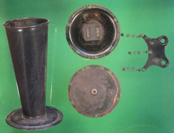

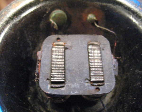

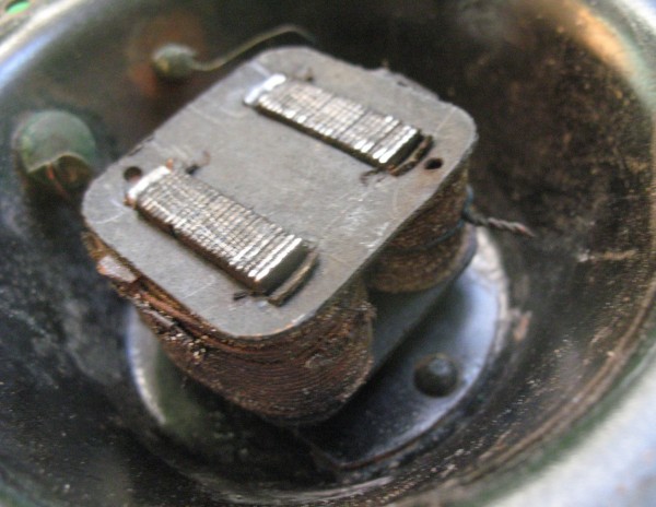

I can only send one photo at a time because it wants to reproduce them in triplicate, these are the innards of a magneto horn that I have.

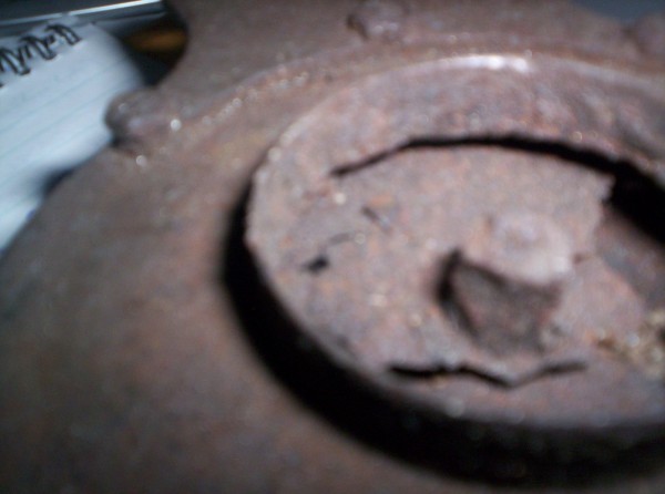

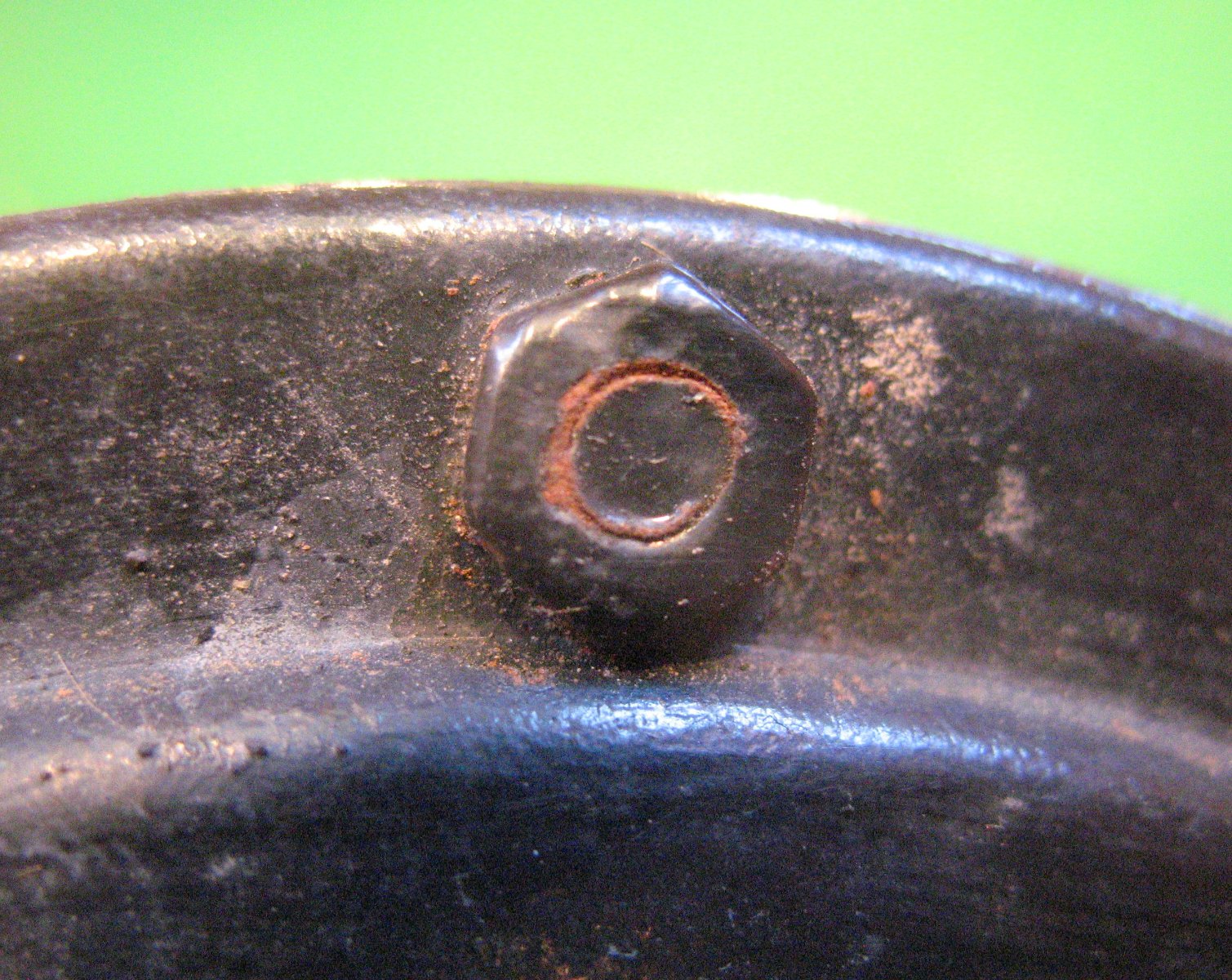

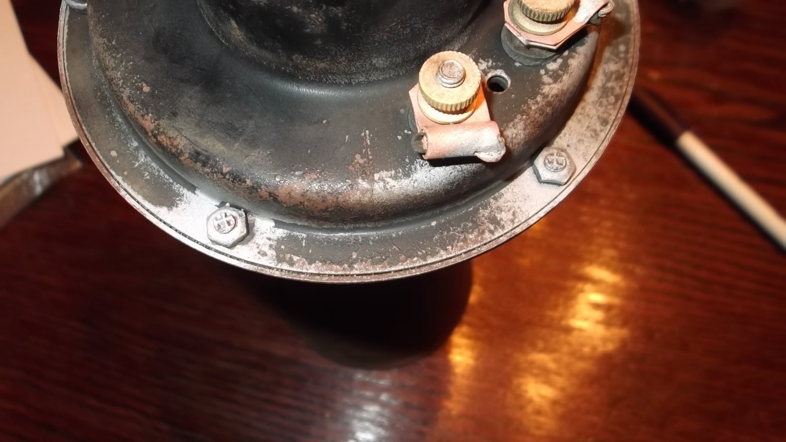

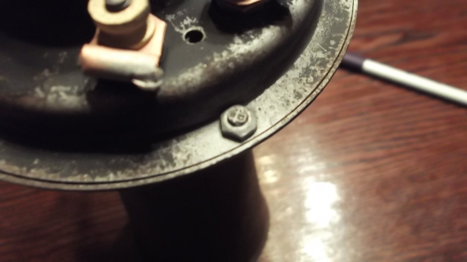

I have not got this one pulled apart yet but notice the staking on the screws. They are all staked the same way with the waffle pattern even the ones holding the bracket on.

I guess they weren't meaning for anybody to take that apart...or the vibration was so great that if unstaked the nuts would back themselves off, as unlikely as that sounds to me...they usually rust in place before they vibrate off.

- Posts: 5507
Re: Magneto Horn...
I don't know if the staking was factory or added later, but seems to be odd that someone would have a waffle pattern setter that was that small. Maybe someone else can chime in on whether it was or not.
- Posts: 5495
Re: Magneto Horn...
That's interesting as that is the same pattern done on the brass magnet clamp screws.

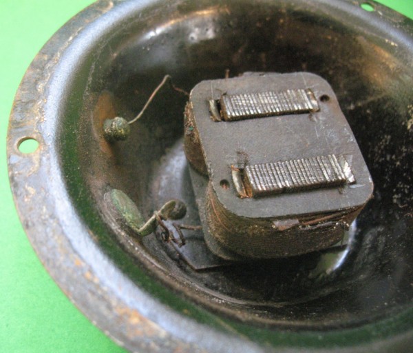

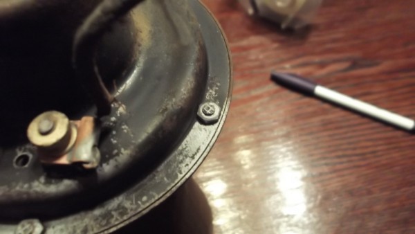

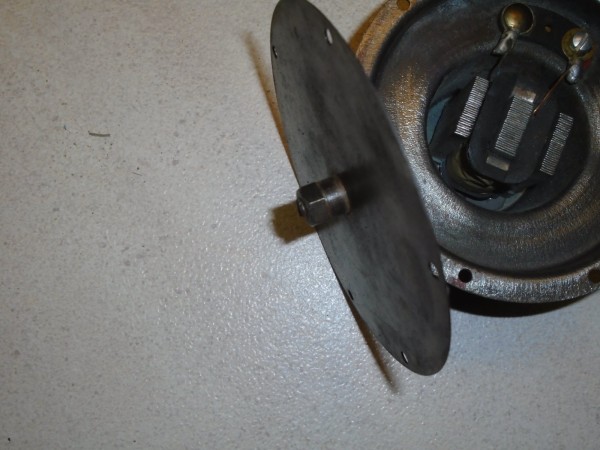

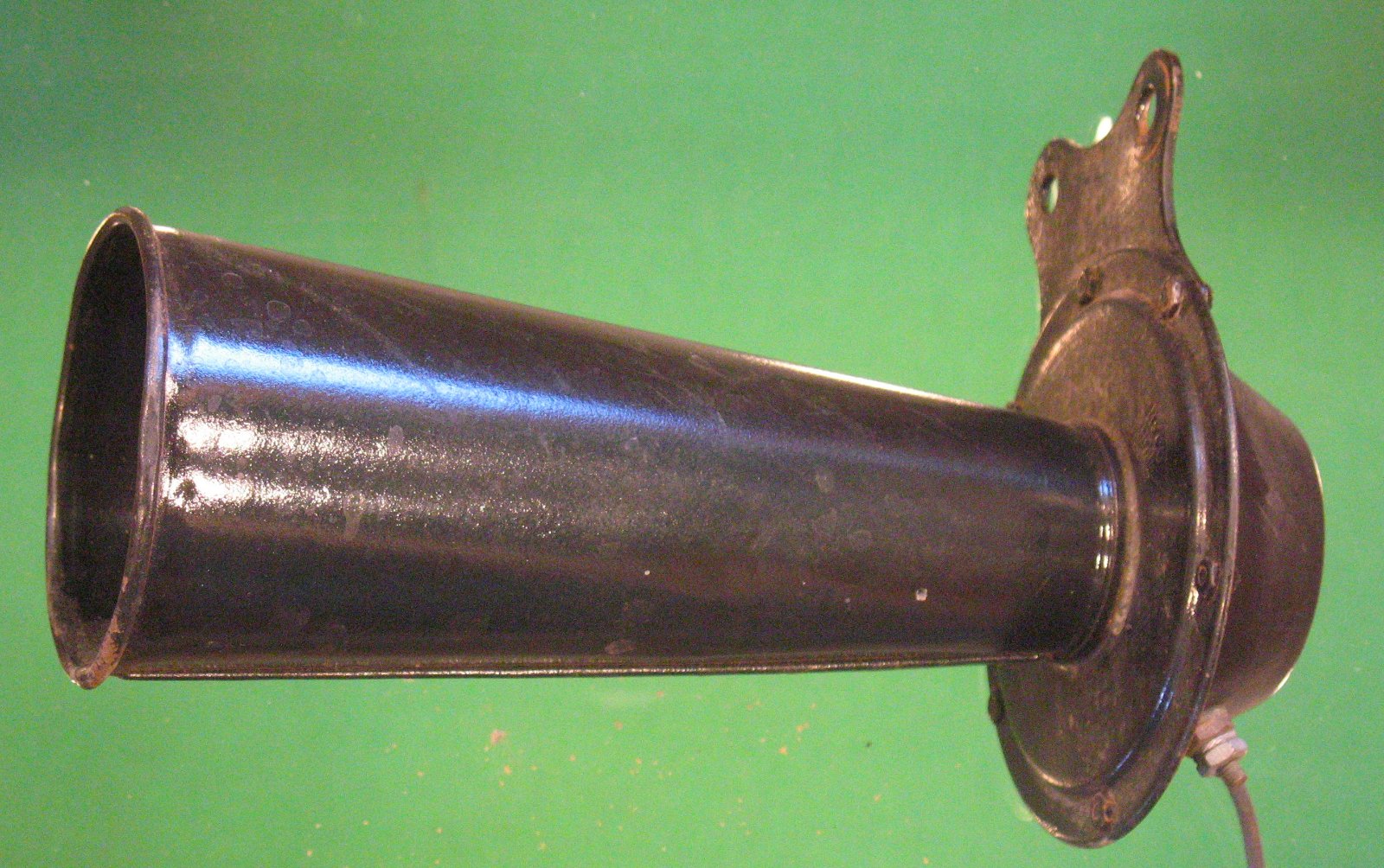

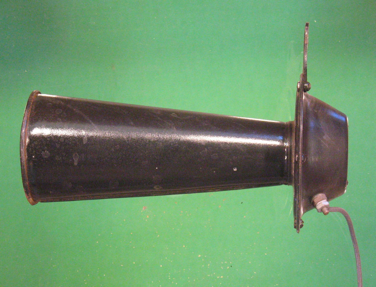

Like many other Ford parts, horns were supplied by several outside manufacturers. All magneto horns can be identified by the adjusting screw in the center of the diaphragm. This is a HECO horn.
The screws are not staked.
I'm working from a laptop that doesn't have the software to remove the reflections.

- Posts: 7399
Re: Magneto Horn...

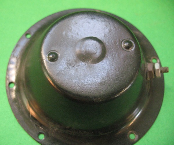

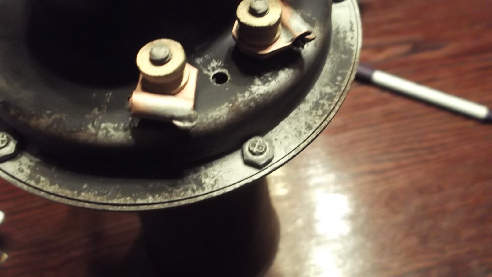

There is a single wire terminal. The other end of the coil is grounded.

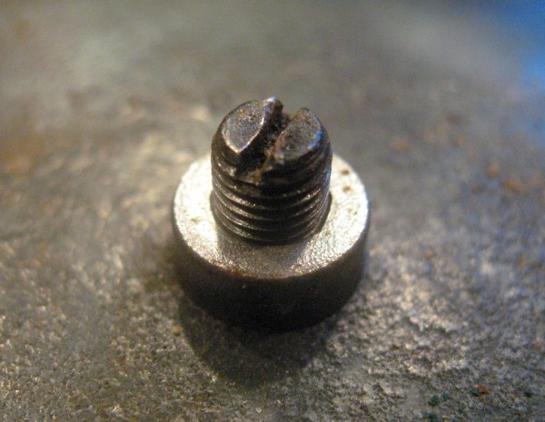

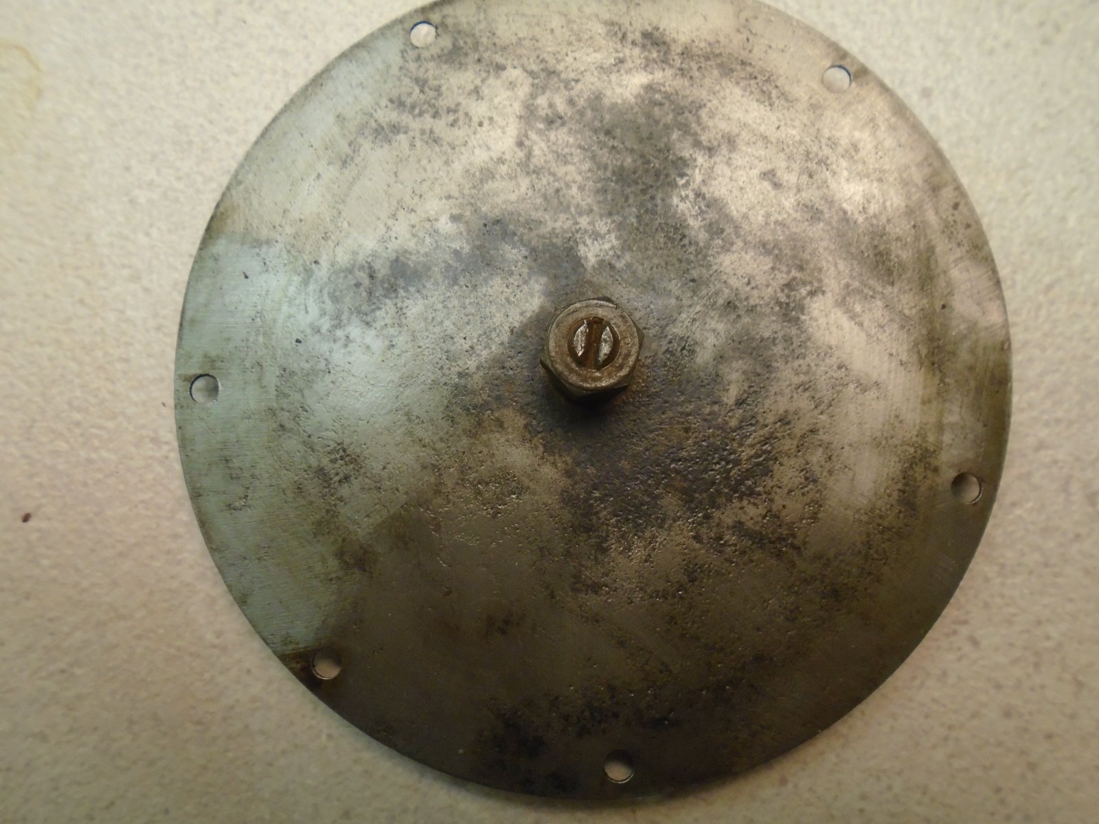

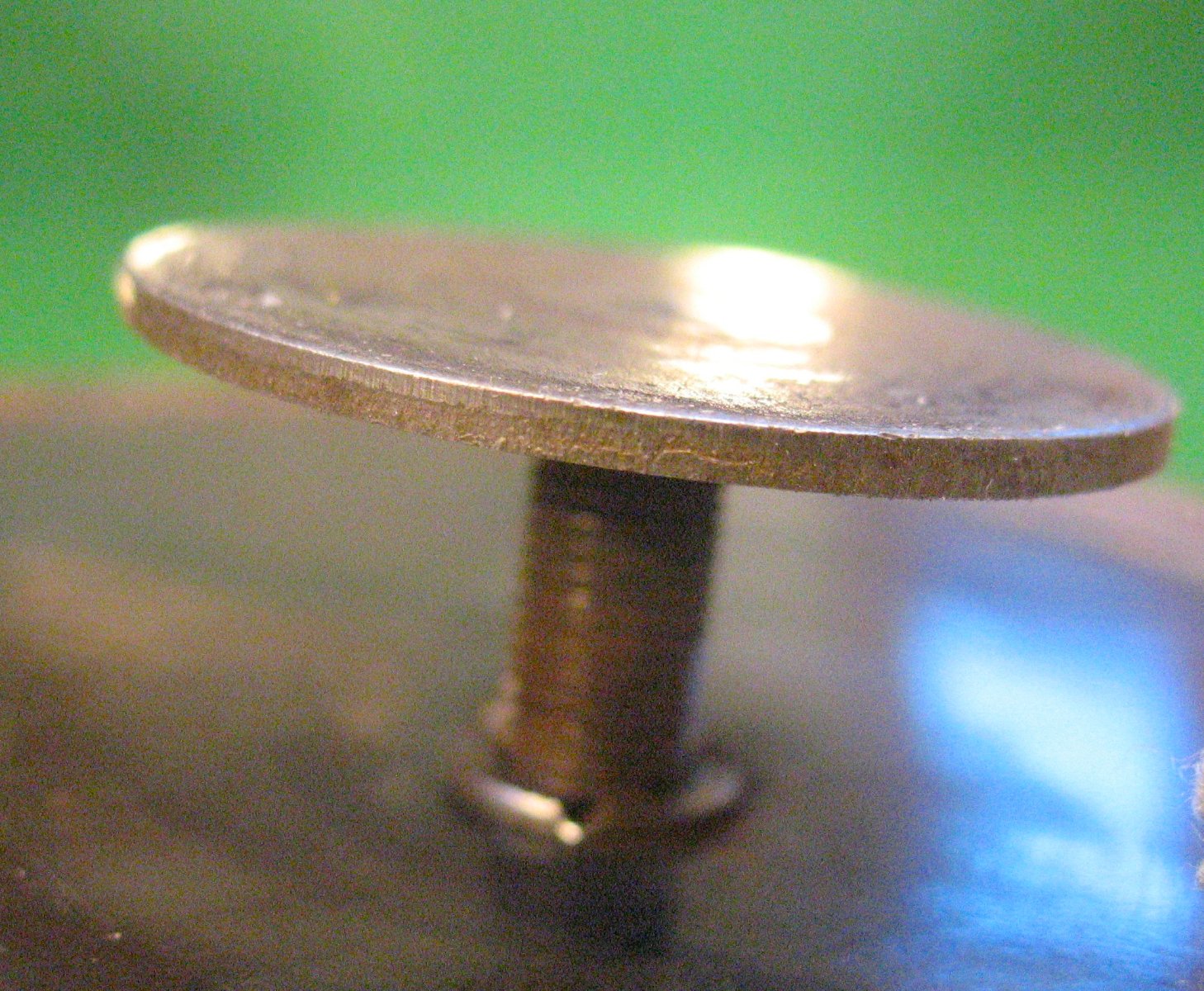

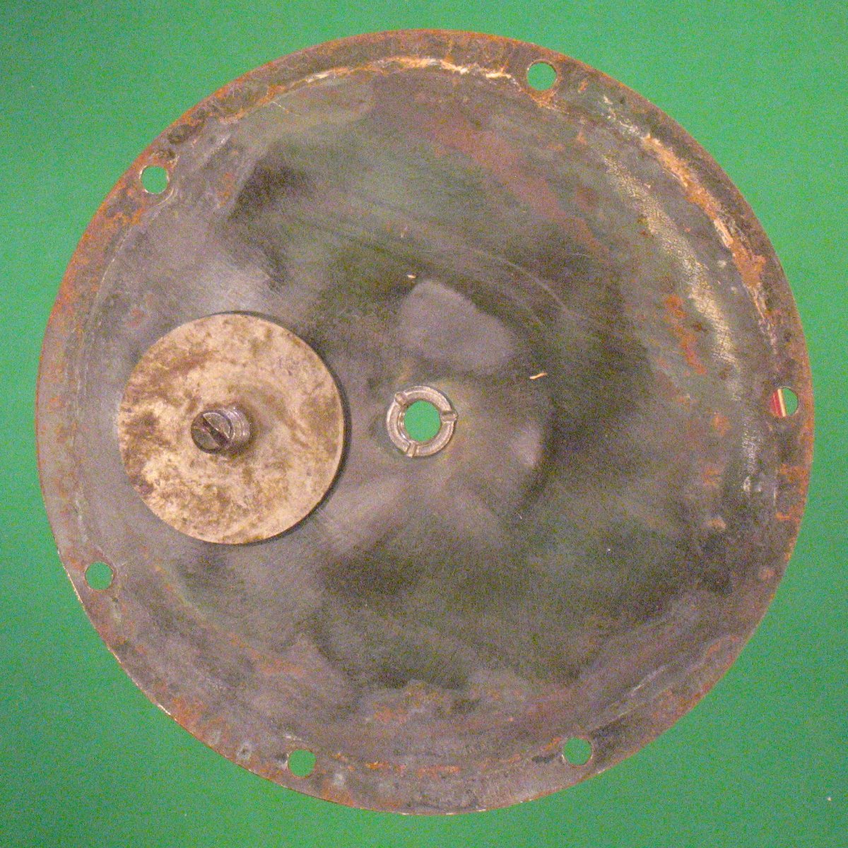

The center adjusting nut is crimped into the diaphragm.

Steve, that center adjusting nut with the noise maker/adjustment screw is really the picture I wanted to see. On the other horn pictures of the square hat style it seems that the noise maker (or whatever it is called) is a machined piece with a screw that threads into it...different manufactures, I guess had different methods for making the strangled duck or goose sound...but on those is the nut swedged to the diaphragm also? Or is there something else there in that large hole and those serrations on the nut are for adjusting (like with the transmission adjustment nut)? Also does anybody ever take those coils out of the cap? Every time I see one of these the coils are always part of the cap. I'm thinking that there are 2 clips riveted to the back of the cap that clamp the coils in place or are there posts on the coil assembly that are peened over to mount it to the cap? I know I'm asking about small details here, but that's where the fun is...has anybody you know of ever had to repair those coils and had to remove them?

Steve, there is a jam nut that goes on that adjustment screw right? Something to keep it from vibrating out of adjustment?

One last question...does the "noise maker" beat against the coils? Is that what is making the sound? Because it does sound like a buzzing sound, so it has to be hitting something, right?

I don't think the "screw" has to beat against the coils. I believe the constantly changing direction of the AC causes the magnets constantly to reverse polarity, pushing and pulling the plate on the end of the screw and vibrating the diaphragm. I don't know if there's supposed to be a jam nut. I didn't find one in this horn.
The coils are held in by two rivets.

So, yours is a 1 post? Does that mean it grounds through the housing and the bracket?

I know there are two different configurations which is mostly about how you'd wire one up. One is a 1 post, the wire from the horns post I think goes directly to the button on the steering column and the second wire from there either goes to the mag post or the mag connection block position.
Then there is the 2 post configuration where the one wire comes off the coils the same as it does on the single post, but the second wire goes to a ground screw either on the engine or the frame...I think, not sure, never bothered to wire on up, my horn is a hand klaxon.
Exactly correct.
