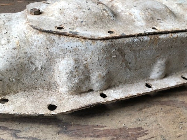

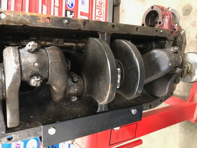

Post by henryford2 » Fri Dec 27, 2019 10:03 am

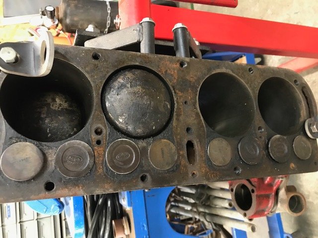

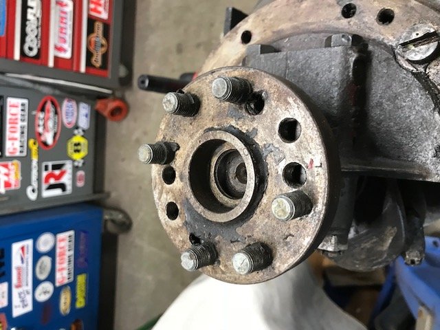

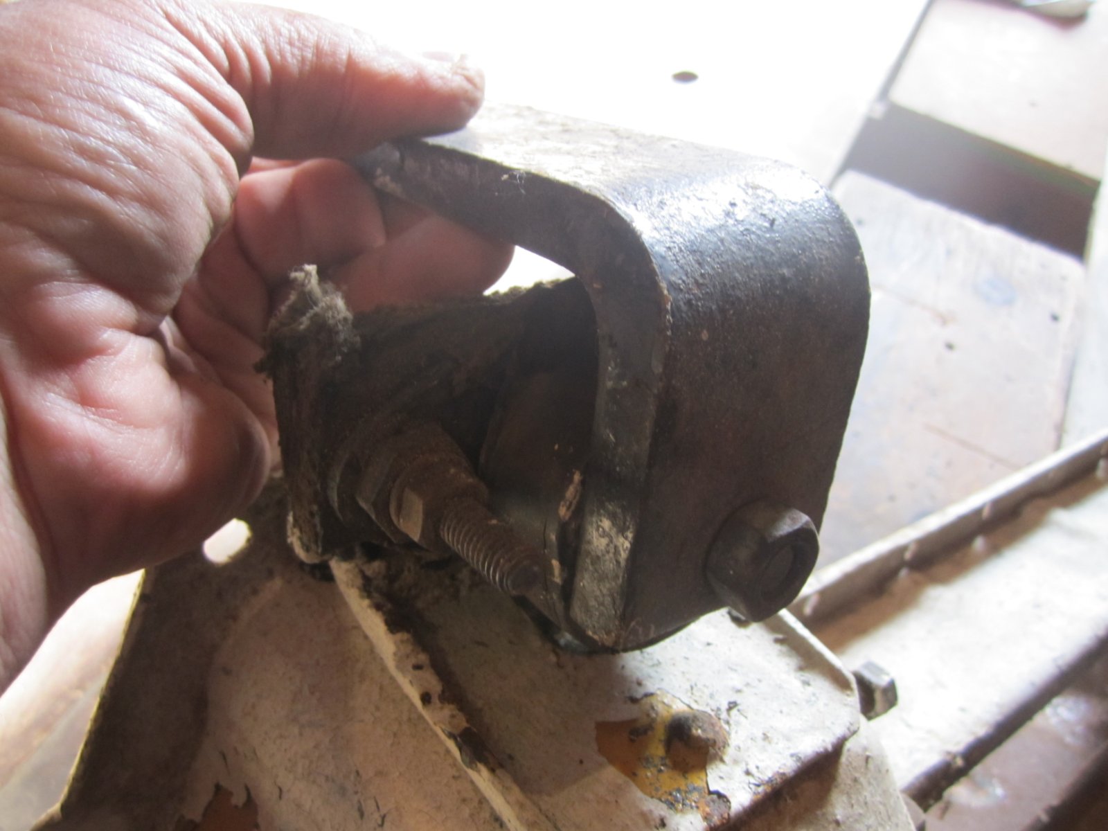

Now that it's much easier to post pictures (although the number posted could be increased) I thought I'd share my next project. It's a T engine with a B crank built by Orville Enyeart in the 70's for Andy Mounce (who I bought it from). From Andy's stories I believe this is the engine that made it up Pikes Pike and class winner at the Newport Hill Climb in his 26/27 Touring. Enjoy

Re: Model T engine with Model B Crank
Post by henryford2 » Fri Dec 27, 2019 10:05 am
More
henryford2
Posts: 823
First Name: Joseph
Last Name: Andulics
Post by henryford2 » Fri Dec 27, 2019 10:07 am
More
henryford2
Posts: 823
First Name: Joseph
Last Name: Andulics

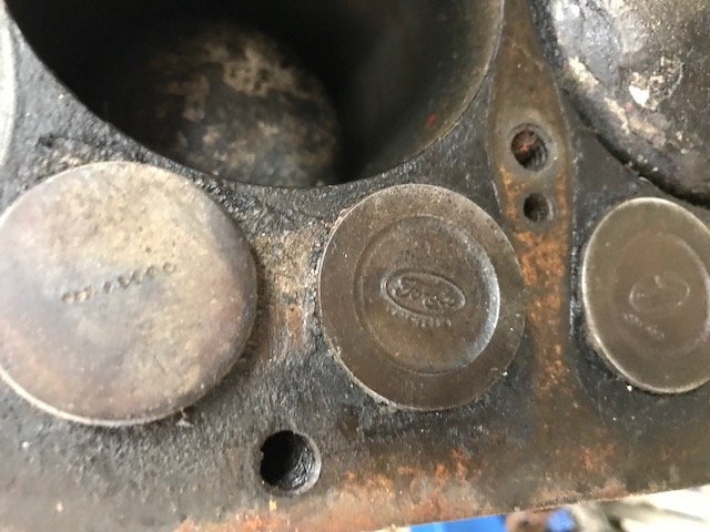

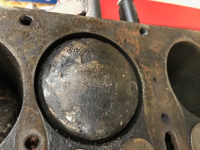

Post by henryford2 » Fri Dec 27, 2019 10:08 am

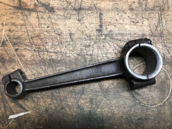

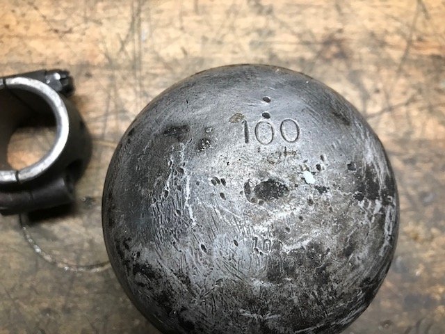

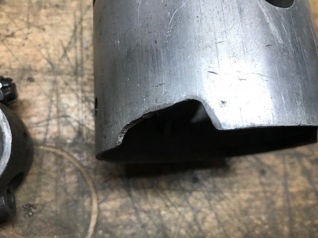

The last ones, it uses connecting rods from a air compressor
Post by John E. Guitar » Fri Dec 27, 2019 10:18 am
Interesting engine.
I wonder if the conrods are off a Smith Motor Compressor?
Post by Erik Barrett » Fri Dec 27, 2019 10:59 am

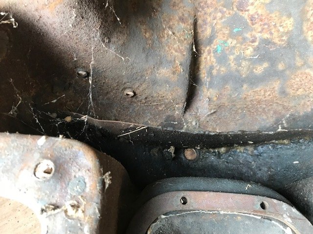

We just worked on an engine similar to this one. It took a whole bunch of work to stuff a model B crankshaft into a T. You have to turn both the rod and main journals down to model A size or it won’t fit. There have been some T’s built with model B rods but they are OHC jobs with no camshaft in the block. Orville was a genius, he made some incredible stuff.
Post by Mark Gregush » Sat Dec 28, 2019 10:53 am

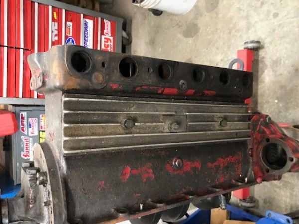

Was the block moved forward on the pan or the flywheel flange moved?

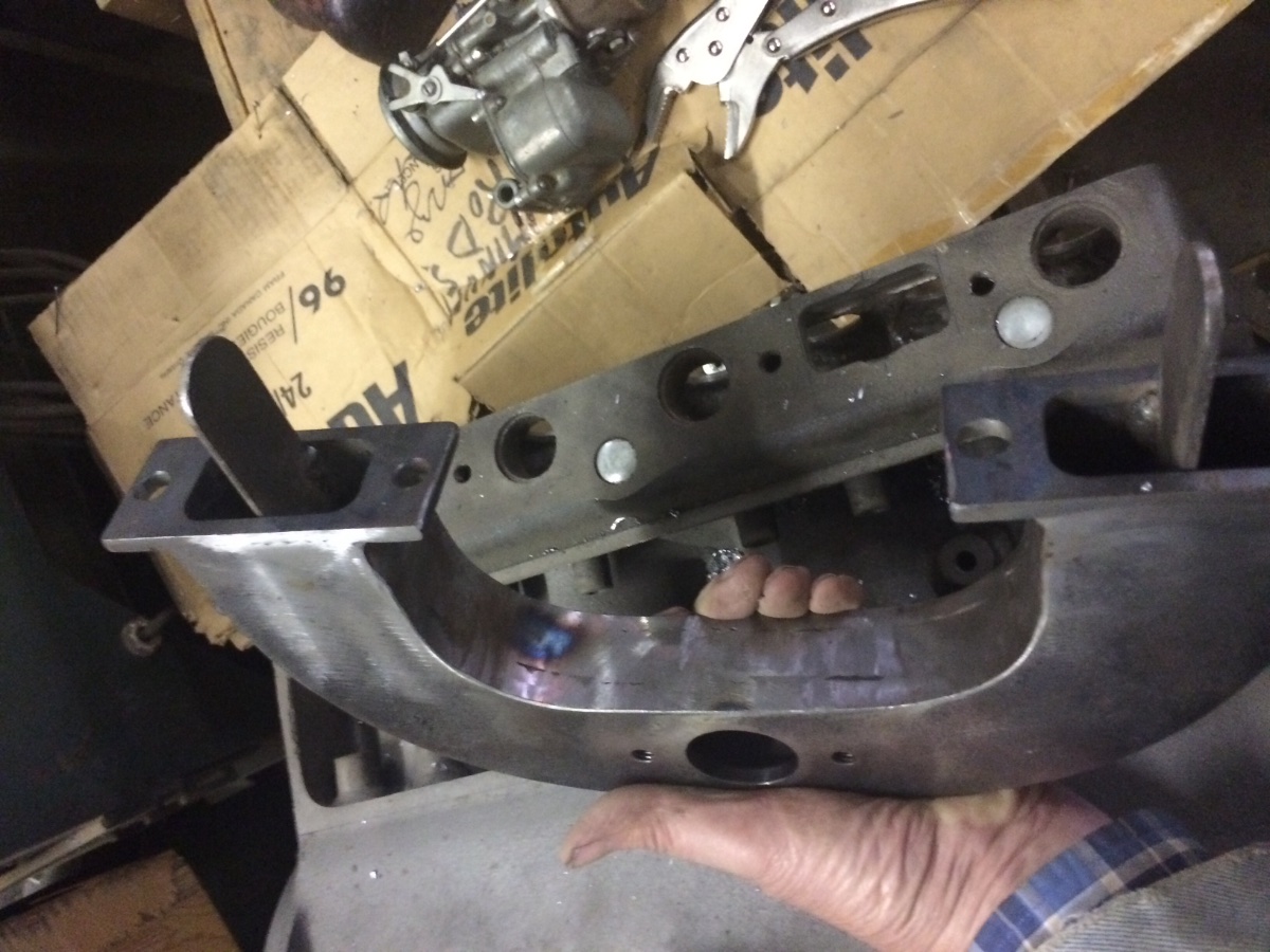

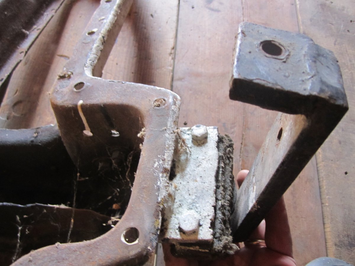

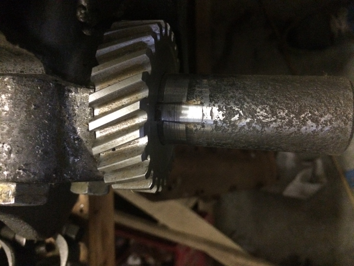

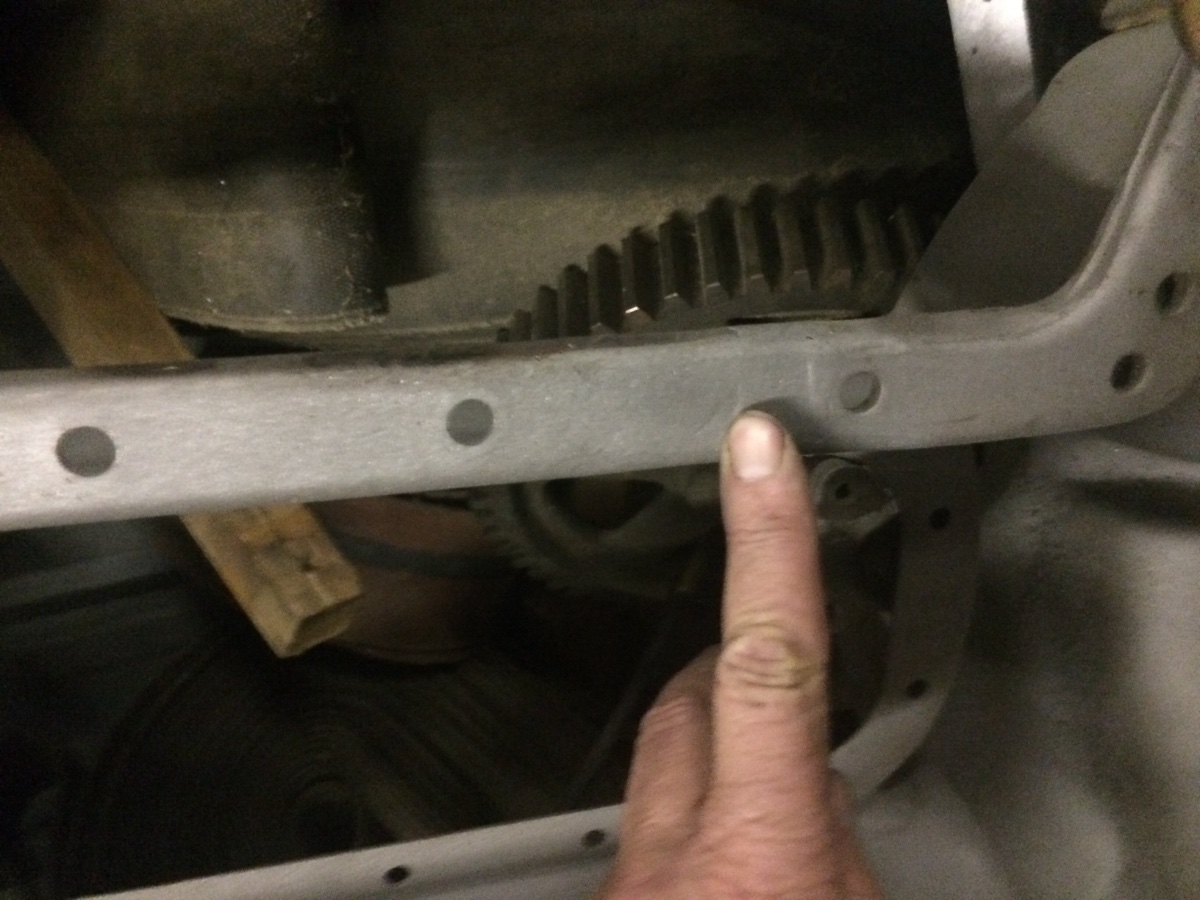

Post by Les Schubert » Sat Dec 28, 2019 11:27 am

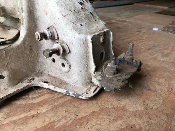

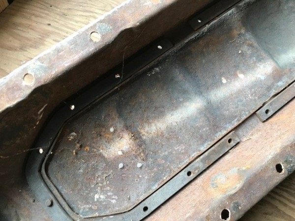

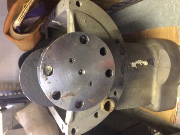

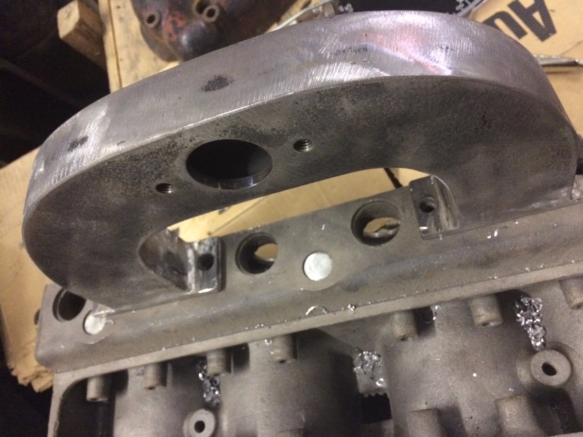

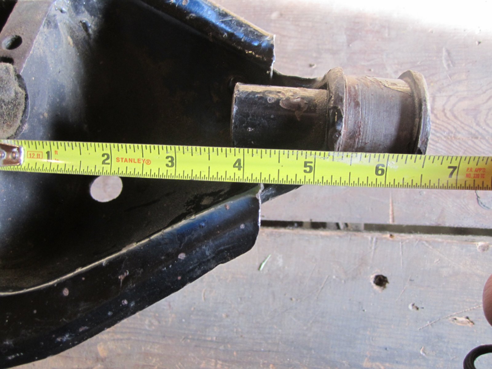

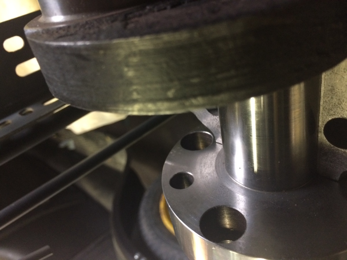

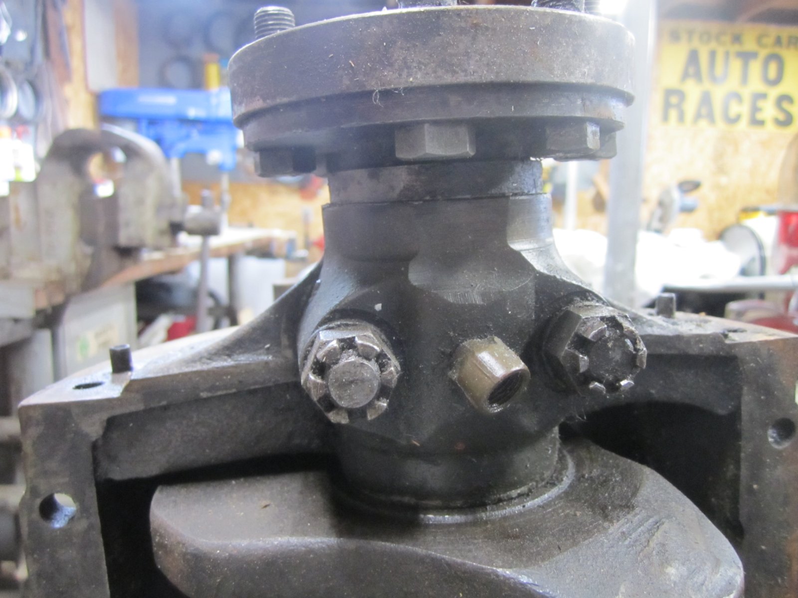

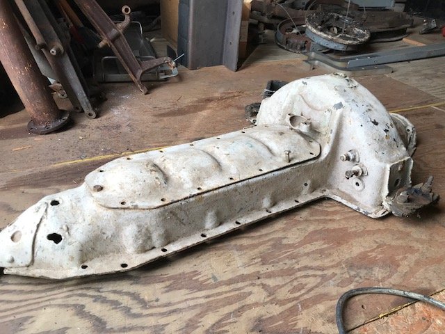

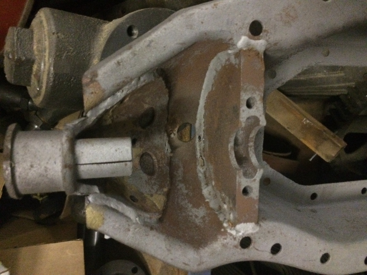

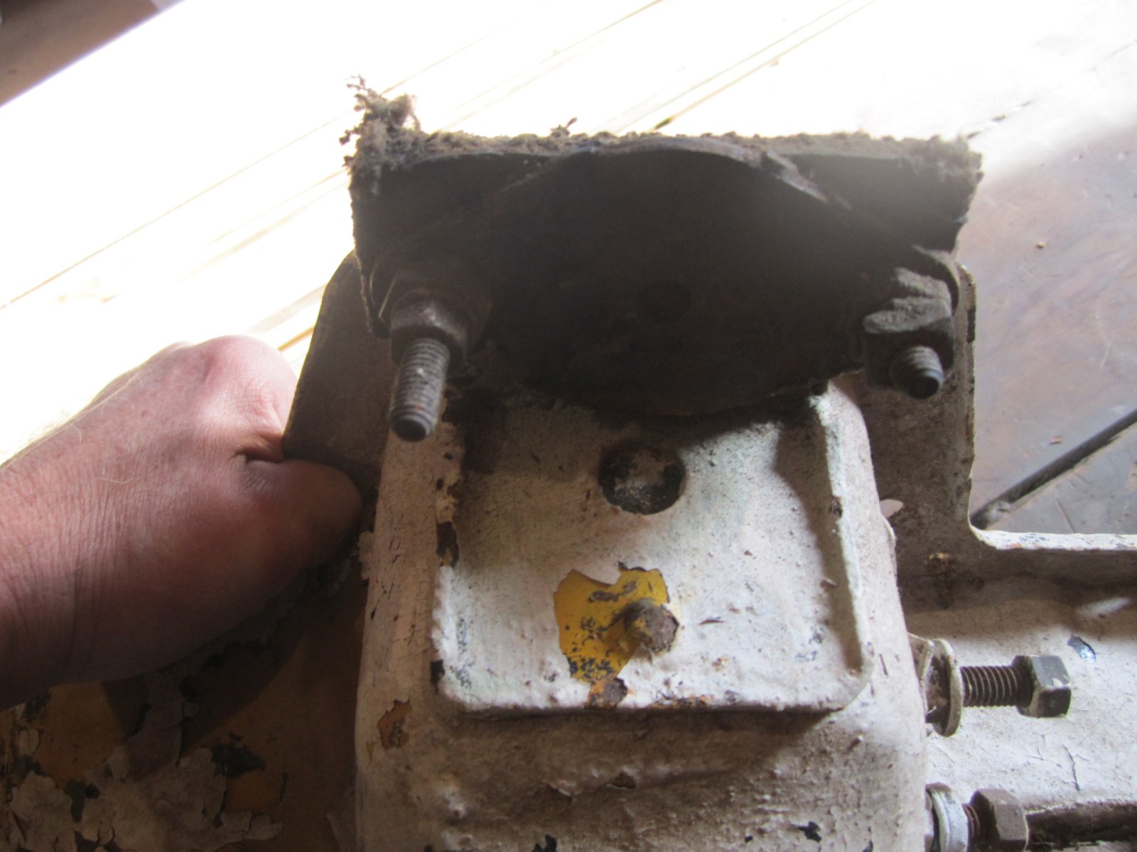

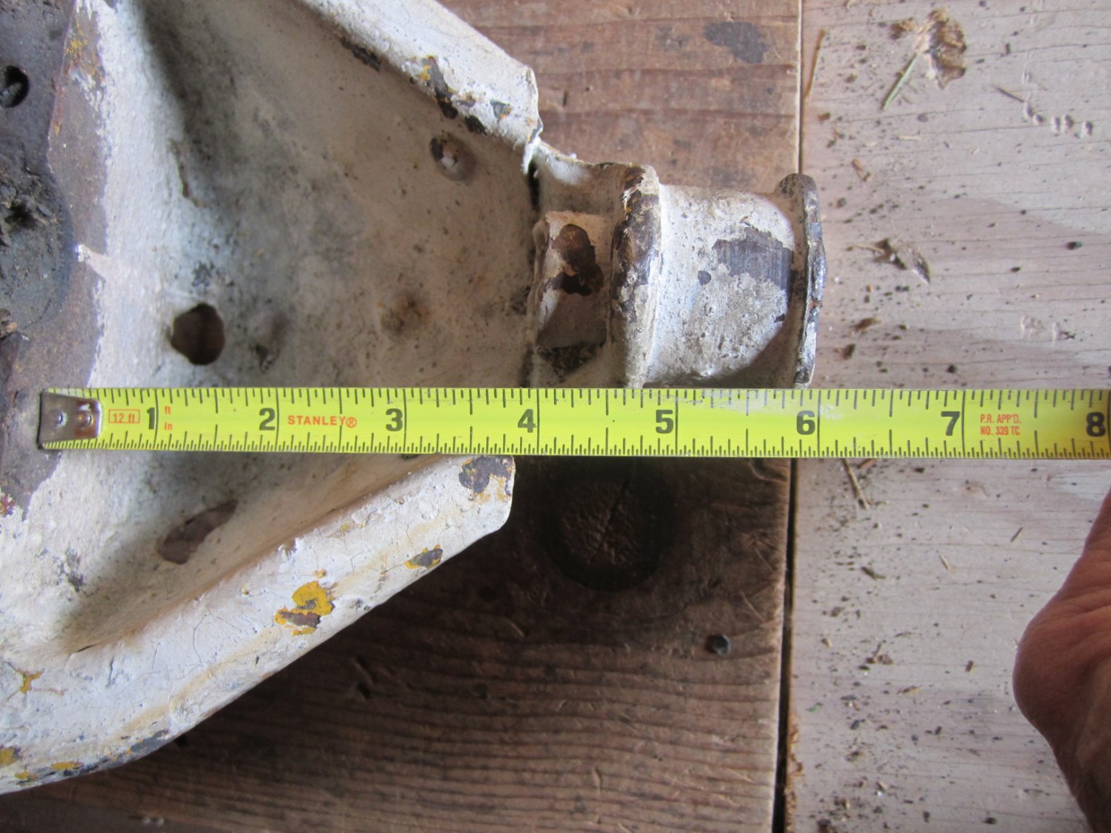

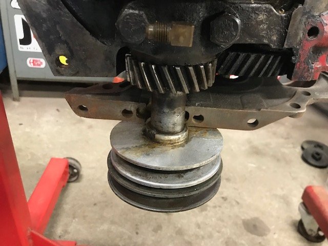

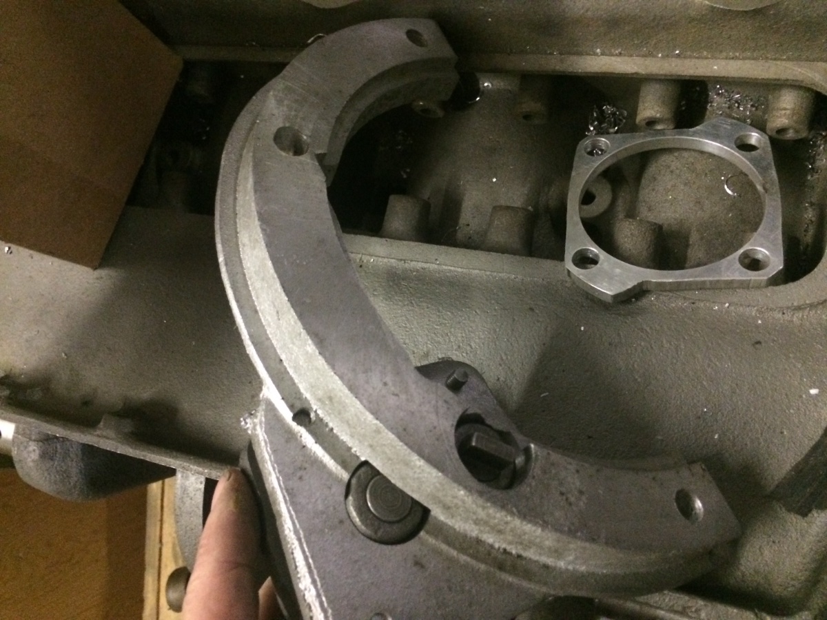

Here are some pictures of what I have done
1. Stretch of pan
2.relocation of front mount
3. Oil pump mount and block “stretcher”
4 SPEEDI SLEEVE for key cover
5 sleeve installed

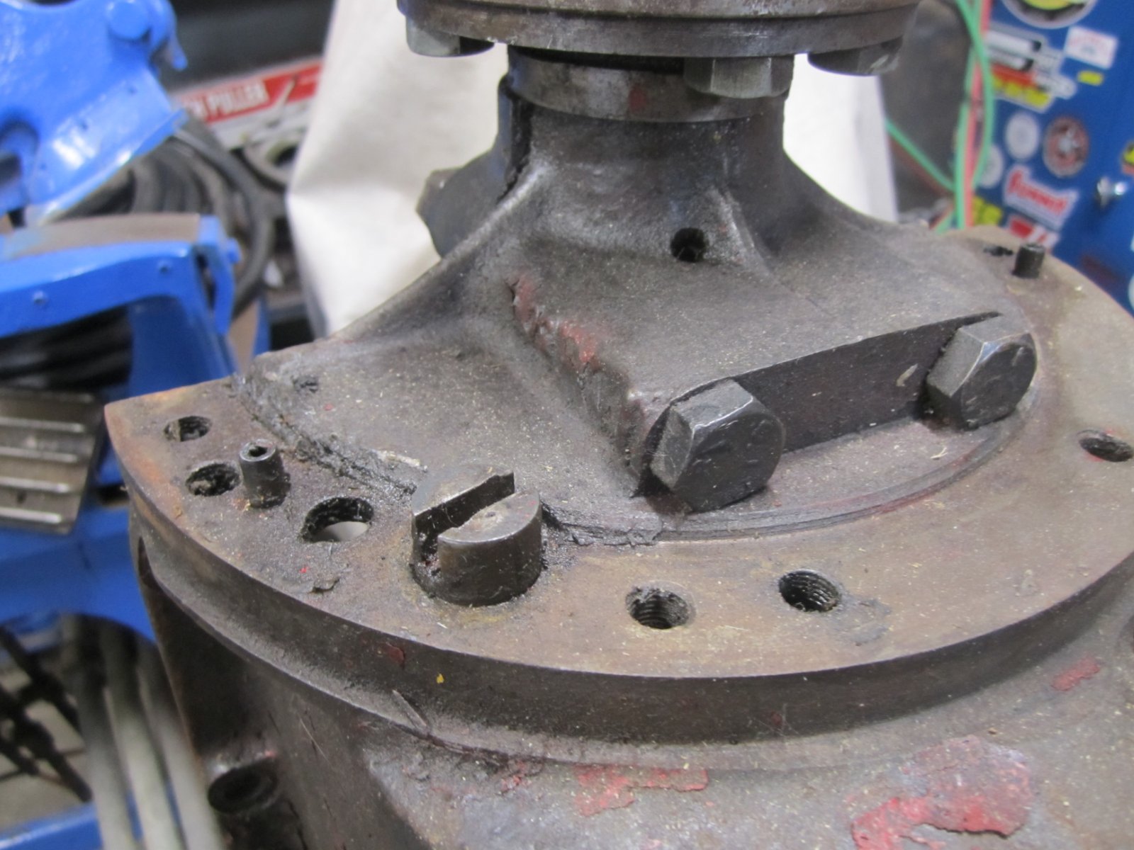

Post by Les Schubert » Sat Dec 28, 2019 11:44 am

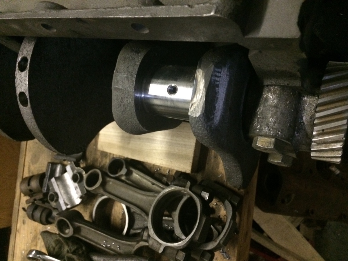

Some crank details

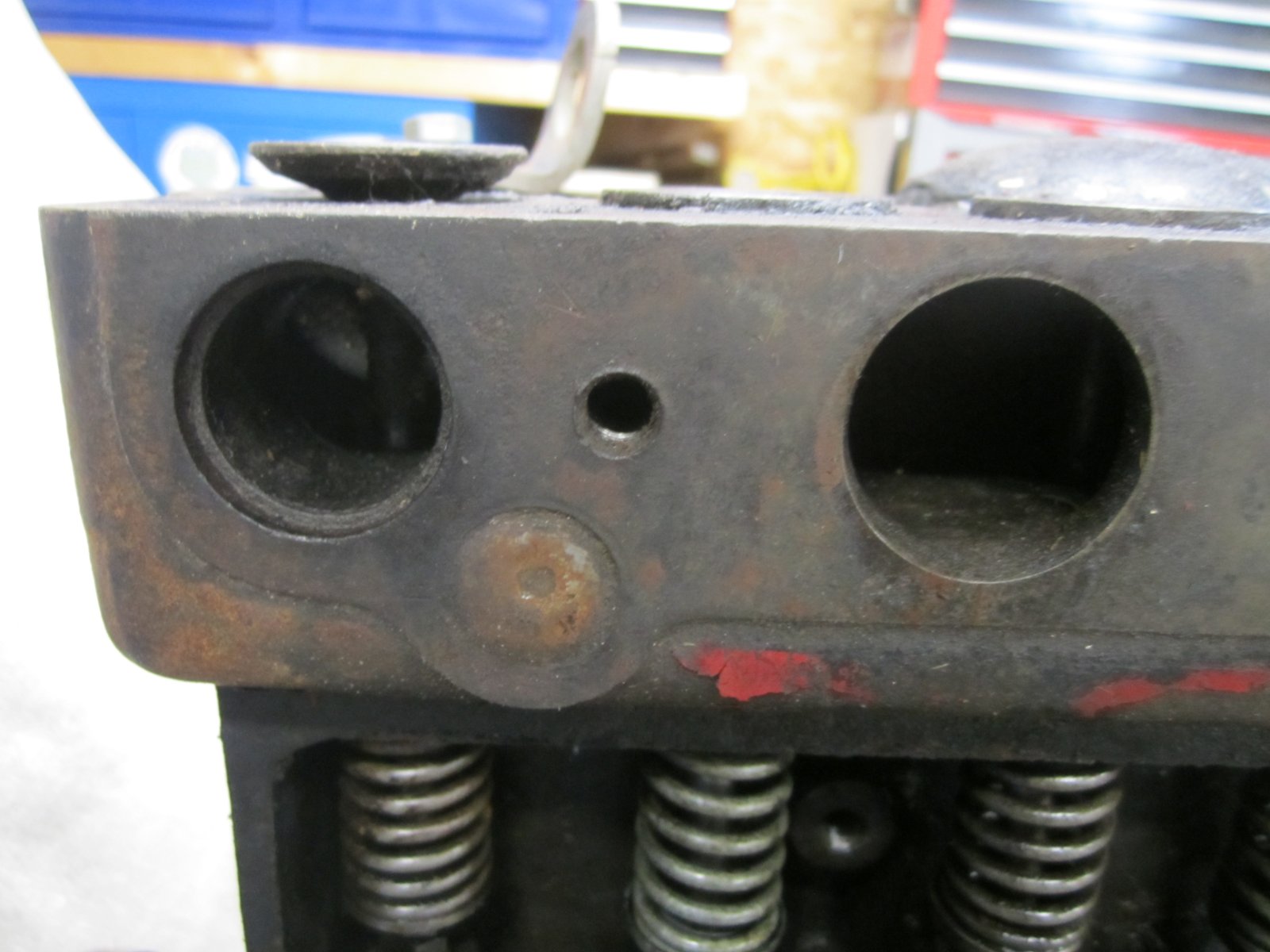

Intake manifold details

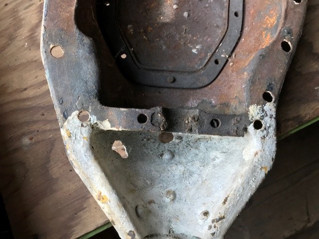

Post by henryford2 » Sat Dec 28, 2019 7:28 pm
Thanks Les, some more pictures. The block is moved forward on the pan. The spacer on the end of the crankshaft I believe is when he ran this engine with the aluminum crankcase and C-4 transmission.
henryford2
Posts: 823
First Name: Joseph
Last Name: Andulics
Post by henryford2 » Sat Dec 28, 2019 7:34 pm

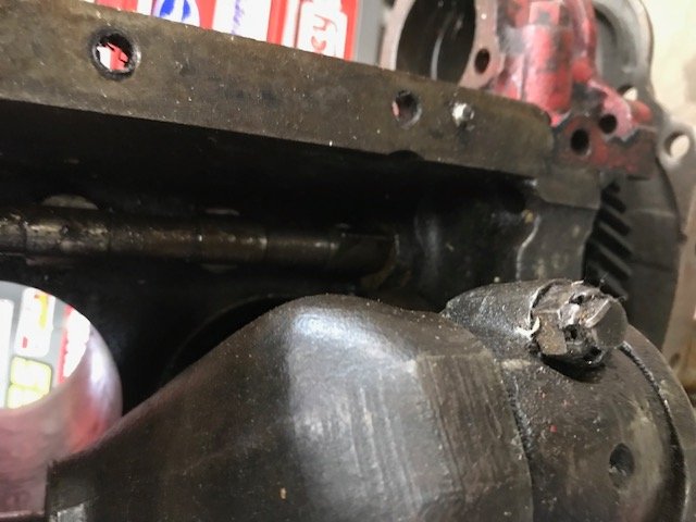

Here's some more pictures. This will get the "straight pan" fanatics squirming. Again the engine was mounted to an aluminum crankcase running an automatic transmission with a Model B crank shaft, so I'm guessing they weren't too concerned with pan misalignment. It appears that the arm may have been a single piece with the rubber bonded to the now two loose pieces of the bracket. Not sure where I'm going with this yet. Summer of 2020 project. Enjoy.
Post by Les Schubert » Mon Dec 30, 2019 11:52 pm
Welding the flange on in the process of shortening the crank is VERY difficult!!
The 2 viable methods “in my opinion”;
1. Move the block forward, which is what is shown in Orville’s engine
2. A taper/press fit THICK flange that I’ve shown a couple of pictures of. The rear main bearing is shortened 3/4”. This method has been successful.
3. I tried the weld approach with the work done using very advanced technology. Ultimately after about 5,000 miles the weld failed. No particular harm from the failure. I have fixed other conversions done by less skilled welding and they only survived a few hundred miles

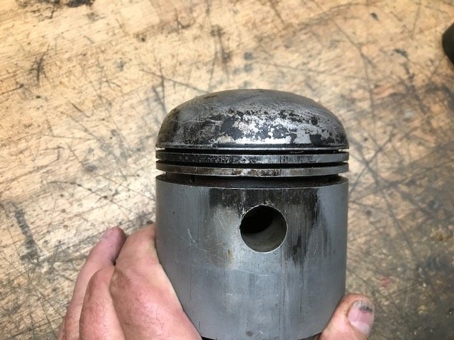

RE;"The last ones, it uses connecting rods from a air compressor "
What compressor? Do they shorten the length so stock T pistons can be used. Is that why the notch is in the skirt in the one photo?
Joe, I found and earlier post that you indicated not knowing what rods were used in this engine, hopefully someone out there knows.

Post by henryford2 » Tue Dec 31, 2019 12:56 pm
I haven't pulled the motor down, but from what I've seen, the compressor rod is the same length as the Model T with the exception that the big end is the same diameter as the Model A. This allows a "standard" Model T high compression piston to be used rather than the style where the wrist pin is moved up on the piston to accommodate the longer Model A rod . The notches in the pistons clear the counterweights on the crank. Hope this answerers your questions

Sure would be nice to know what those rods are and thus where to find them.

I'm guessing that with the passing of Humble Howard trying to identifying what engine the rods came out of will be real difficult.

Post by Kevin Pharis » Tue Dec 31, 2019 6:15 pm
The rods pictured above are compressor rods for sure... can’t confirm the “Smiths Motor” part, as I’ve only ever heard them referred to as “compressor” before.
Most cut and welded “hybrid” rods I have seen, have had reinforcement plates add to stiffen the weld area.
I don’t have any pics to prove it... but I’ve shortened A rods, and also made hybrid T/A rods, by milling the webs out of the rods, cutting to desired length, and then boxed with sheet steel to create rectanglular section tubular rods. And after doing a few sets like this... I swore I would never go thru the effort again!! So happy to see that SCAT has an H beam option, as I had figured on machining my own design for the next motor
