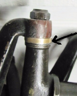

Guys: I am thinking about making a run of washer shims for the Front Axle Spindles Bushings. This will go under the bushings to add height to take up for wear in the front axle “yoke”. That will keep you from having to weld up axle and machine back to size.
Any interest? Thanks Dan
You can post here or email me.

Won't new bushings fill the space? They generally have to be shortened to fit. How many axles are worn enough to need building up or shims?
Topic author - Posts: 5412
- Last Name: Hatch
- Location: Alabama
Re: Need input for new Part
By the time they are faced off where they are square, the space is too wide for the new bushings. I am finding this on most axles now days. Dan

Quite a few used axles could benefit from a shim under the new bushing, especially the top one as the most wear in the yoke is on top from the weight of the car, lack of lubrication and road grime acting as a grinding compound !

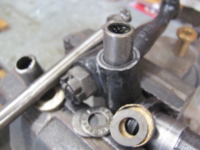

On this spindle, opposite issue, the axle yoke was OK.

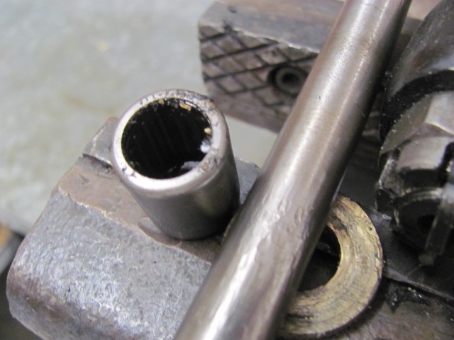

But the spindle body was cut-off short to install useless needle bearing collar and needle bearing bushing.
Removed those worn and junk pieces, even the king pin was wrecked from the needle bearings. But the new brass bushings were too short due to the cut-off body.

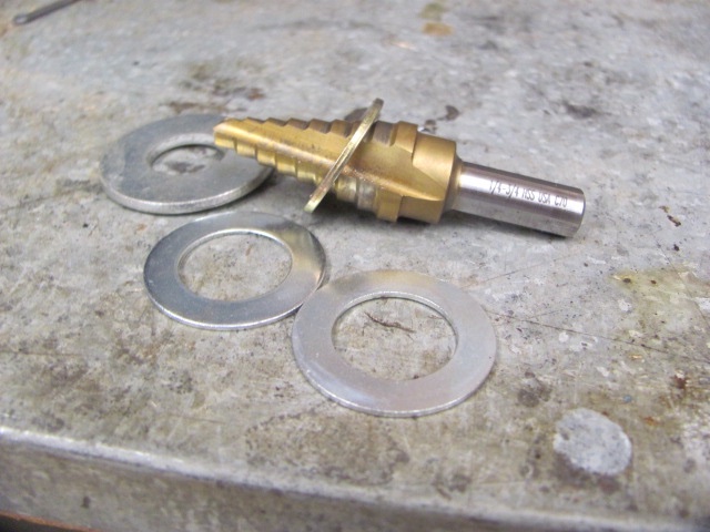

With a new bushing there was gap at the yoke, so a thin washer shim was placed on the neck of the spindle body before setting the new bushing.
Tried different ways of making a shim, found a correct fitting one from hardware store, think it was metric washer.
With the new shim, bushing fit was fine, had enough bushing face to ream for good fit to the axle yoke.

McMaster Carr has "ring shims" available in differing thicknesses that may foot the bill. You might look there.
