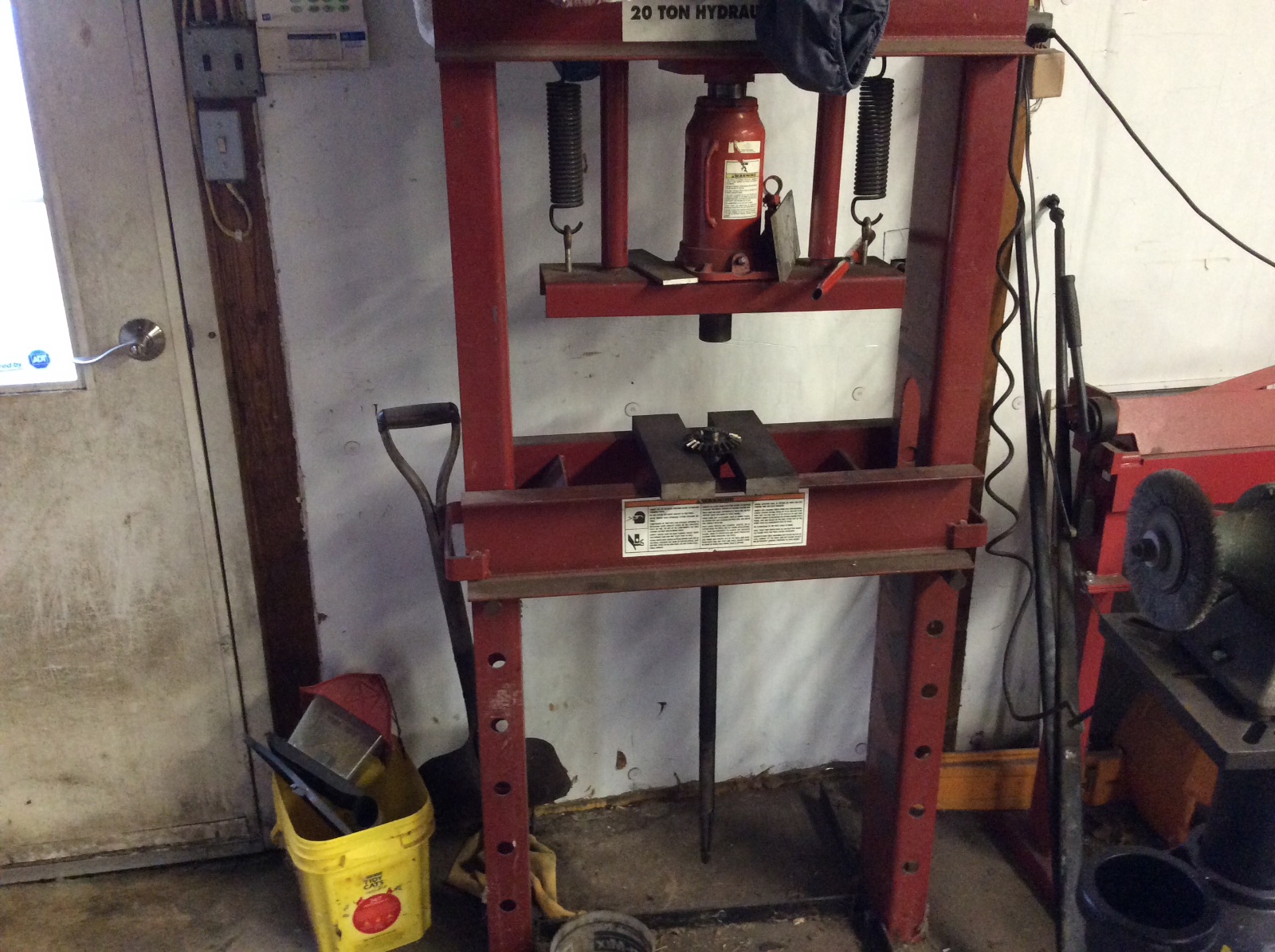

I have new axle shafts and need to install old gears. My press is about 2” too short for the axle between the ram and the press bed. There is room to press the shaft down in the gear. What is a good way to move the gear down. How tight is the interference fit?

I cut the uprights of my press and bolted in very beefy extensions with way oversize grade 8 bolts.
In retrospect, I could have also bolted extensions to the bottoms of the base irons.

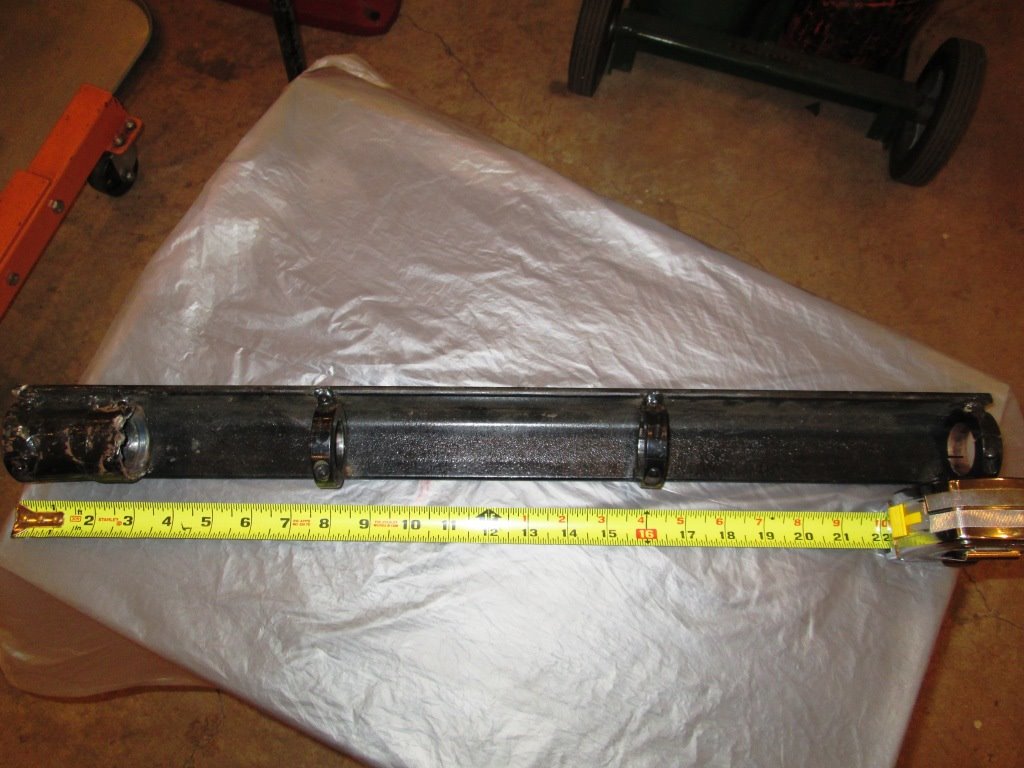

When I did mine I made an axle support using square tubing and some angle iron. I welded a plug in one end of the tube and welded an angle iron 'collar' around the outside of the open end, making the finished tube a couple inches shorter than the distance from the threaded end of the axle to the point the gear needed to be pressed on to remove/insert the half moon keys. I placed an aluminum 'pad' inside the closed end of the tube and rested the threaded end of axle with an axle nut to help carry the load on the aluminum pad. The collar of the tube rested on the press supports, and the whole thing was very stable. Others have described how to load the gear to press it on, and how to support the gear to push the axle out after removing half moon keys. My used Ford gears went on new Snyder's axles with about 1800-2700 pounds force, it may have taken more to break the gears free of the old axles, I didn't check that. I think Ford spec's call for a minimum 0.001" interference and I believe that is a theoretical force of 1000 lbs for clean and greased parts, some are tighter due to tolerances allowed, and as others have cautioned make sure burrs and dings are removed. Took longer to make the fixture than it did to change the gears, but the fixture made it easy and safe (in my view), be safe with this and good luck, jb

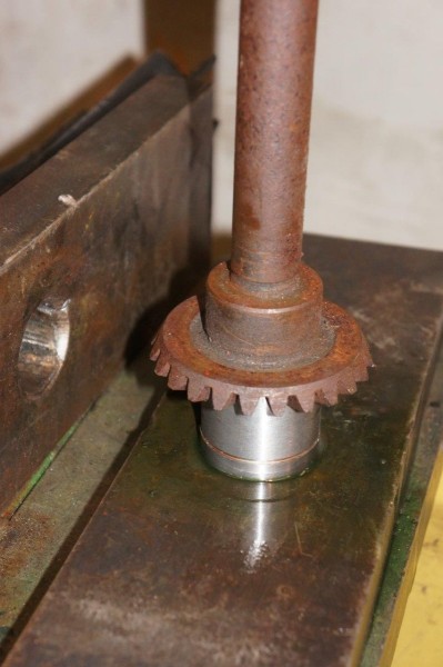

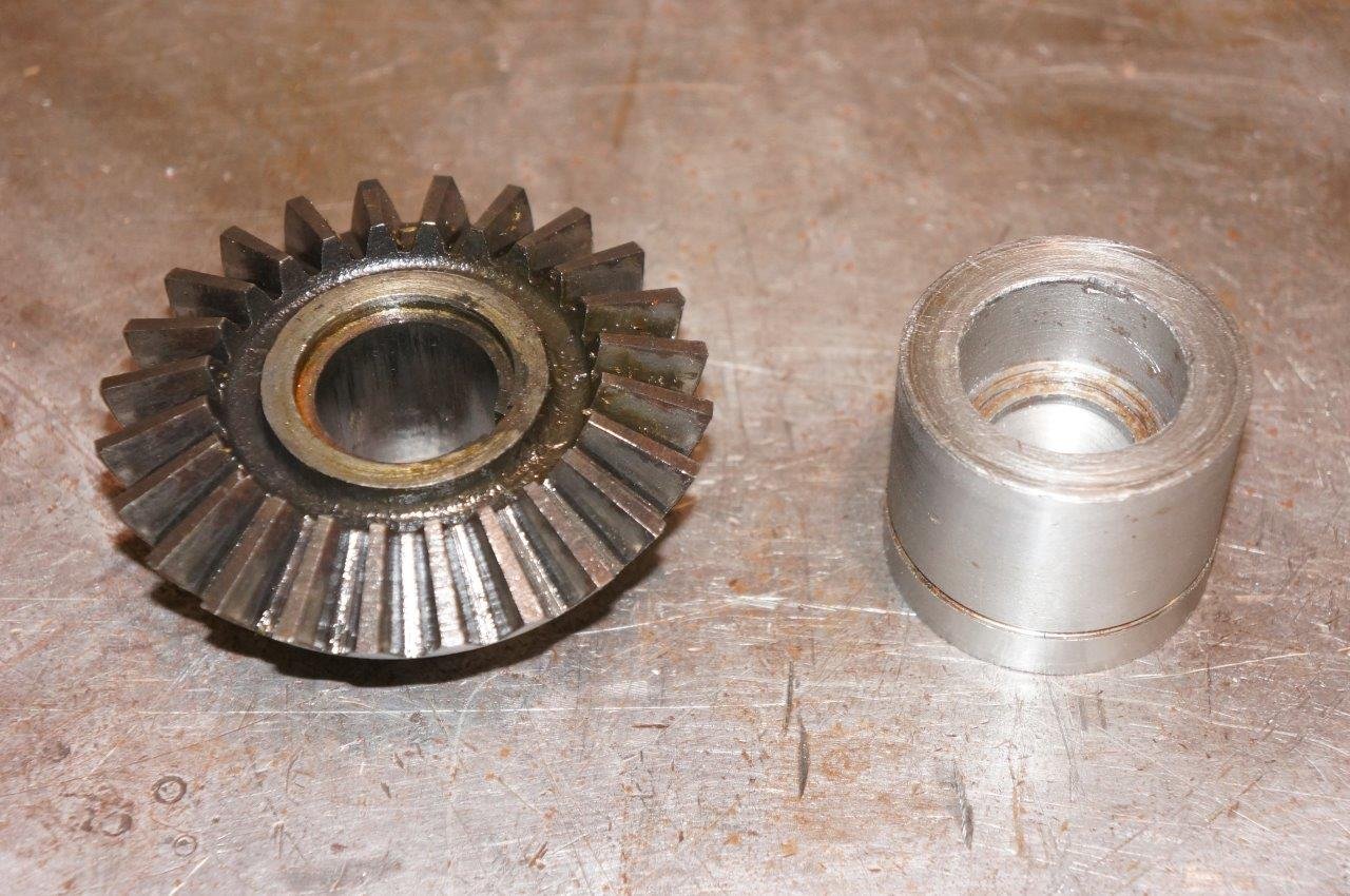

Here's the cage I made up for pressing gears back on.
- Posts: 5471
Re: Removing and replacing rear axle gears.
Forgot to add - I use an old rear wheel hub to press against using a steel axle shim to protect the new taper.

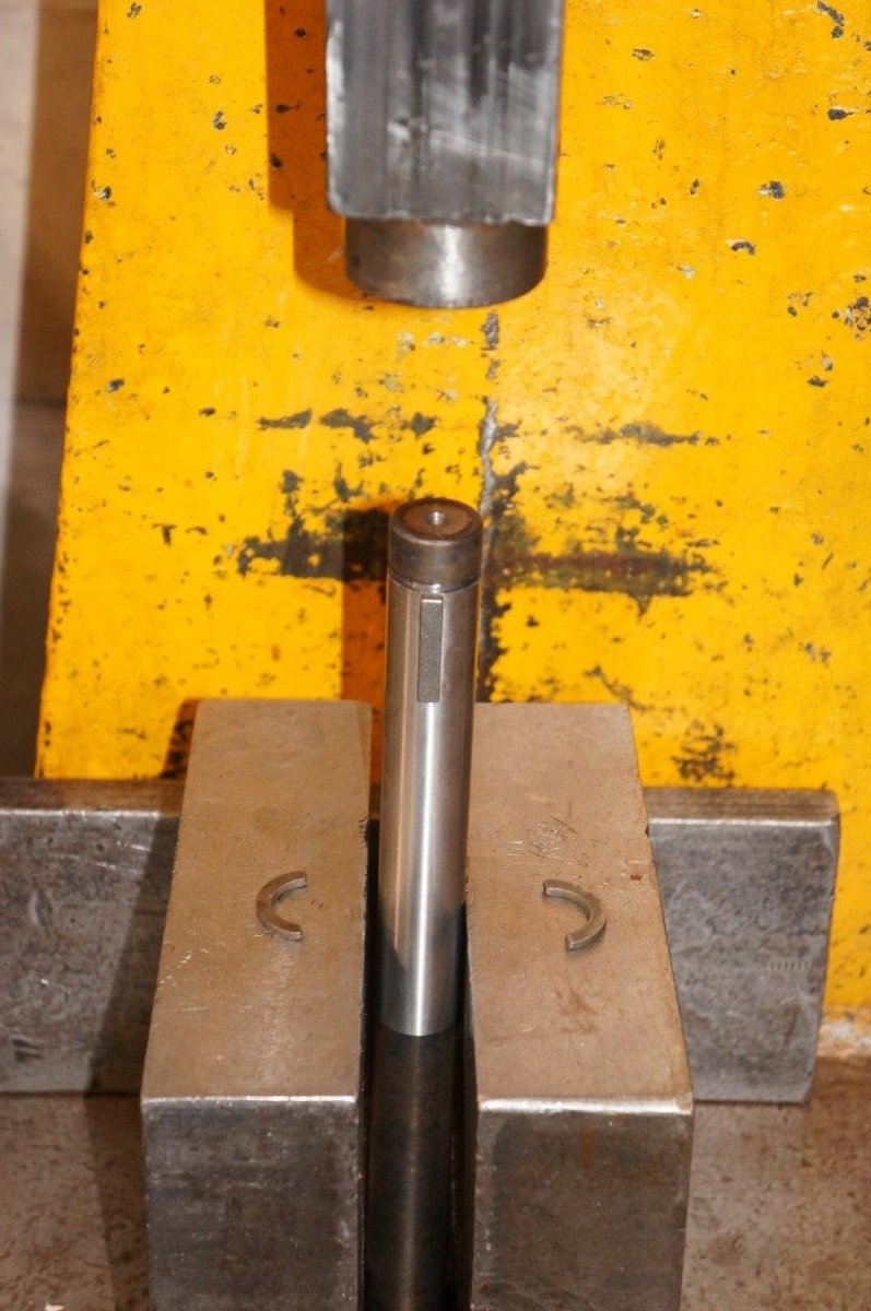

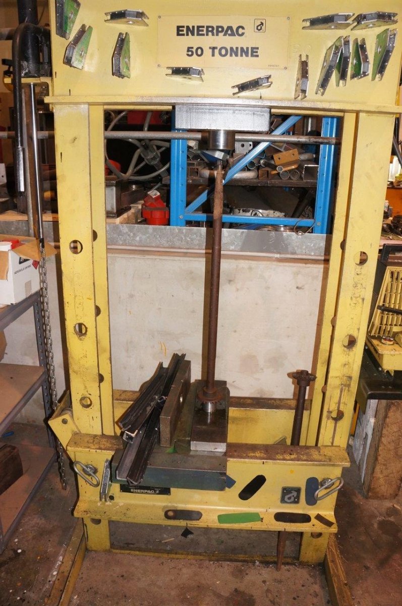

Here's my setup to remove the half moons. You can't see the top of the shaft very clearly but it has a nut on it to protect the thread.
The highest I've had to go is around 15 tonnes.

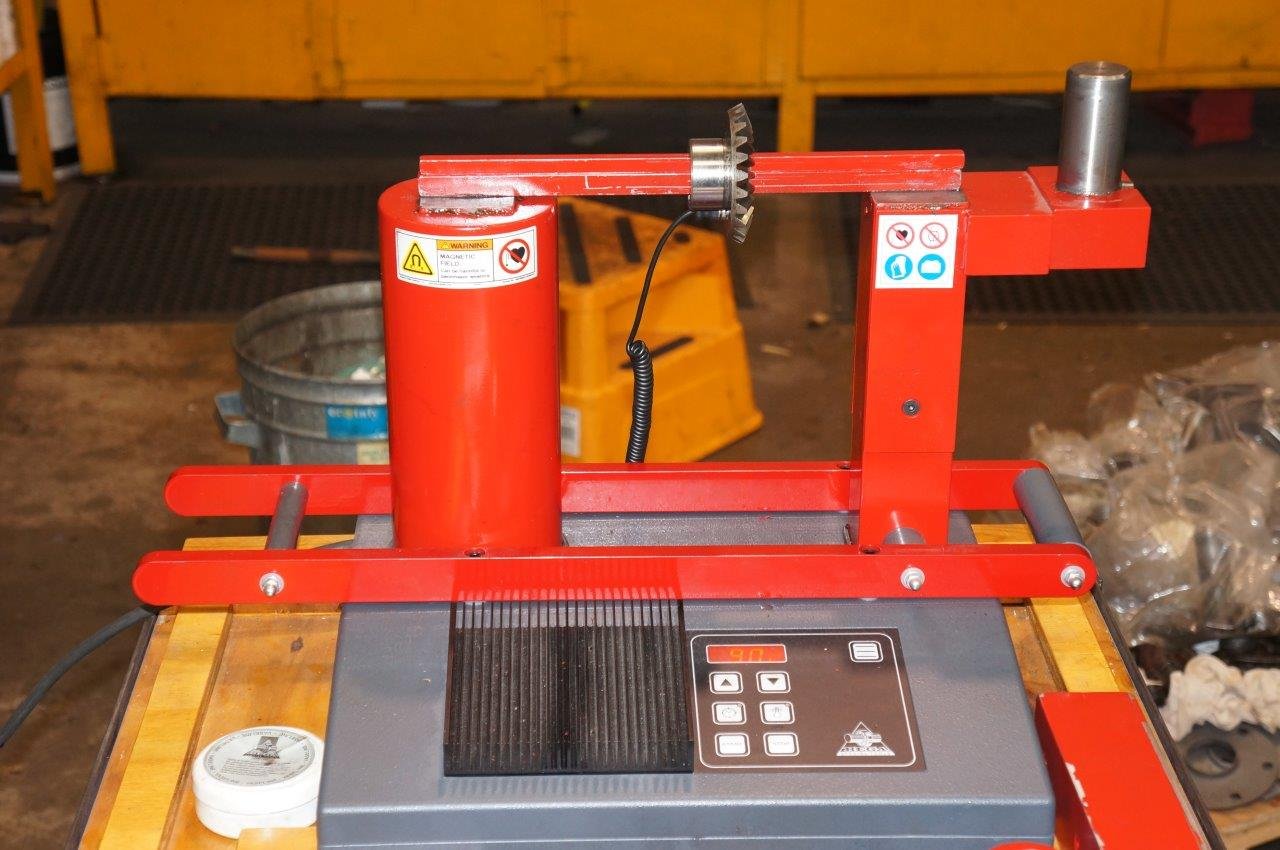

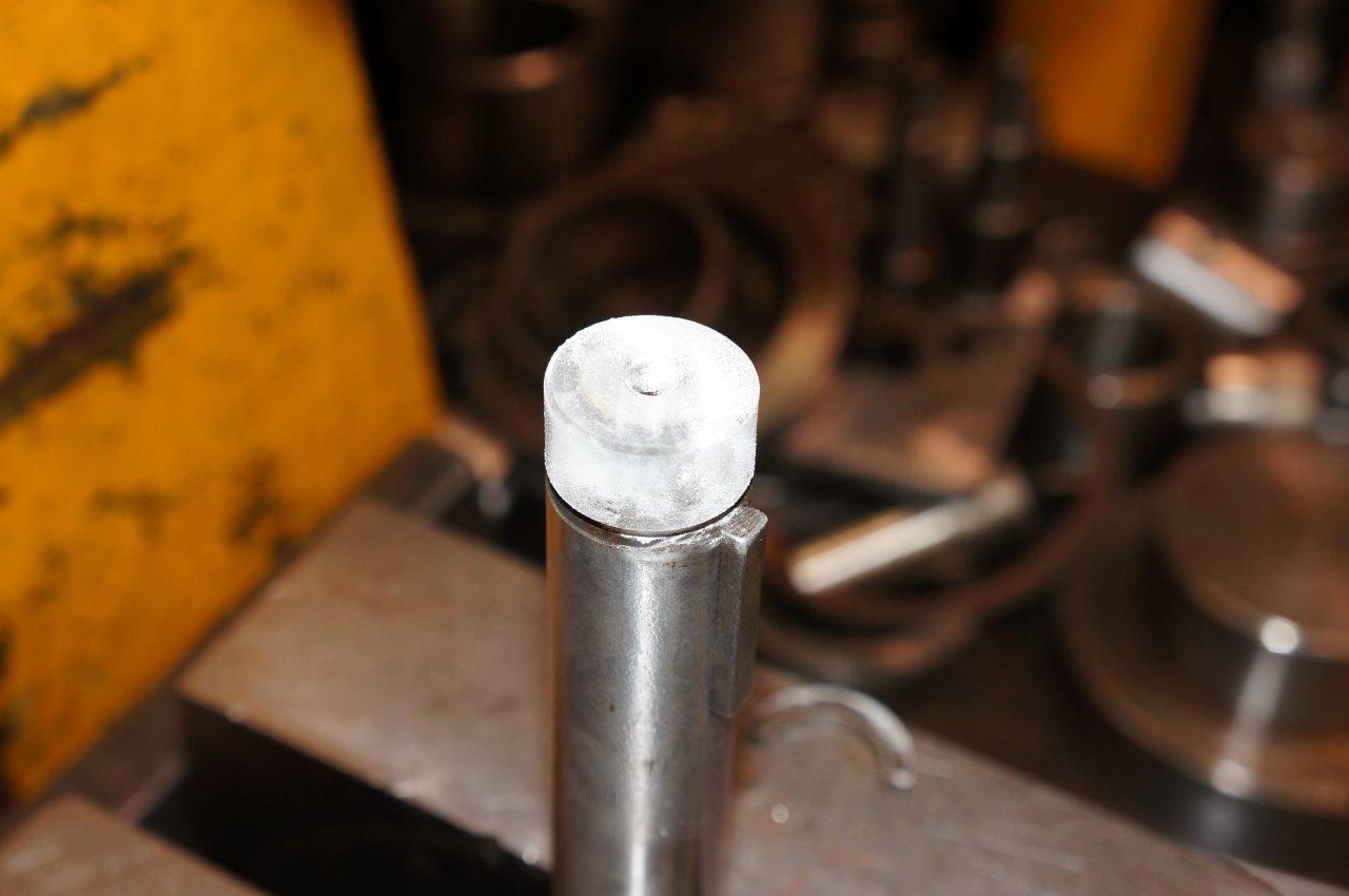

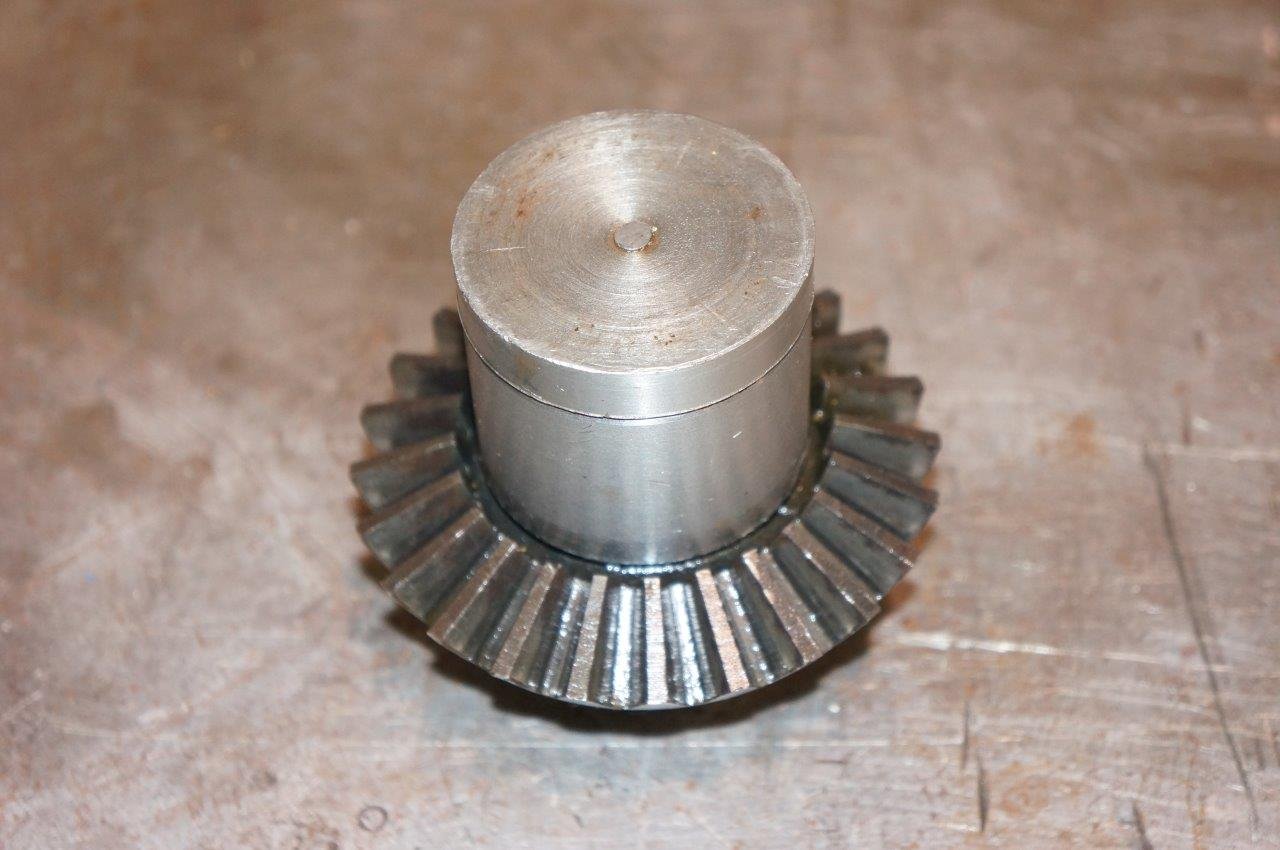

Here's the setup to install the gear on the shaft. I use a bearing heater to heat the gear up to 115°C and a freeze spray to shrink the shaft. The photo of the frosted shaft only shows the top area being cooled. I apply the freeze spray for the full length of the gear location.
