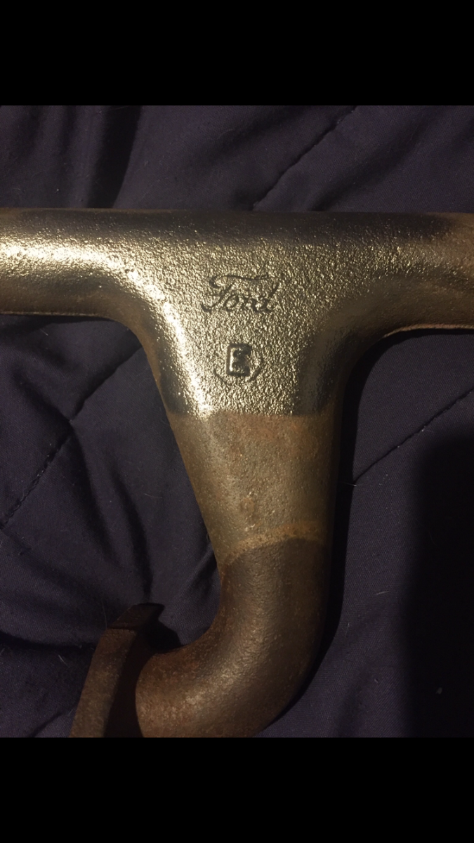

I’ve used Evaporust as well as other harsh chemicals and found out on another forum that citric acid works just as well and is relatively inexpensive to mix up a 5 gallon bucket full. It comes in powdered form and you get it by the Mason jars in the canning department. I partially dipped this intake manifold. The bottom is before, middle is how it looks when removed and the top is after I lightly brushed it with a wire brush or scotch bright.
