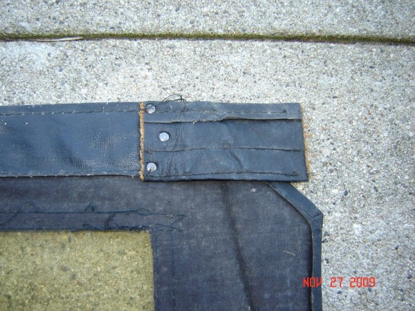

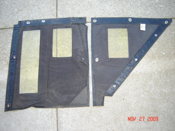

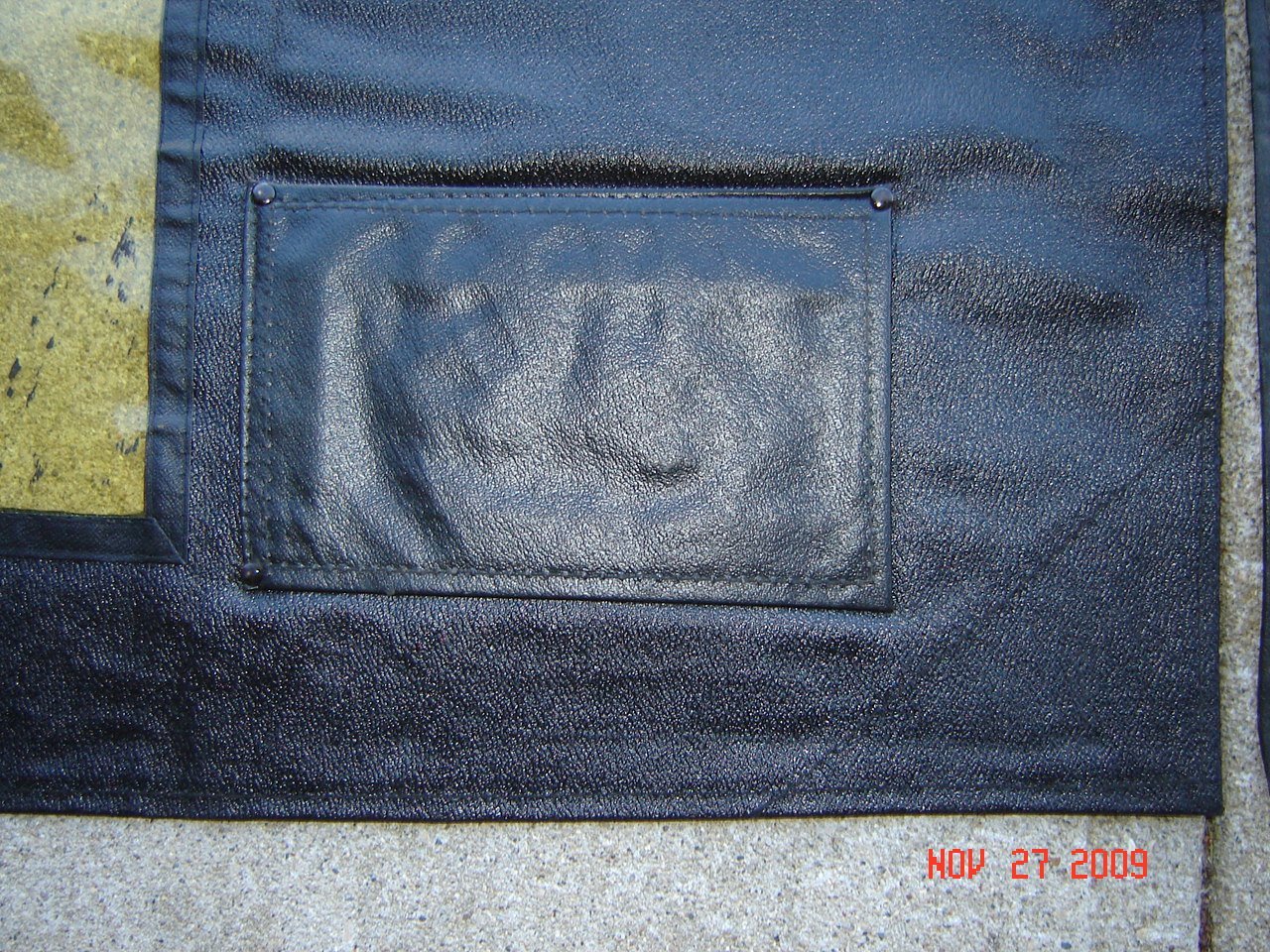

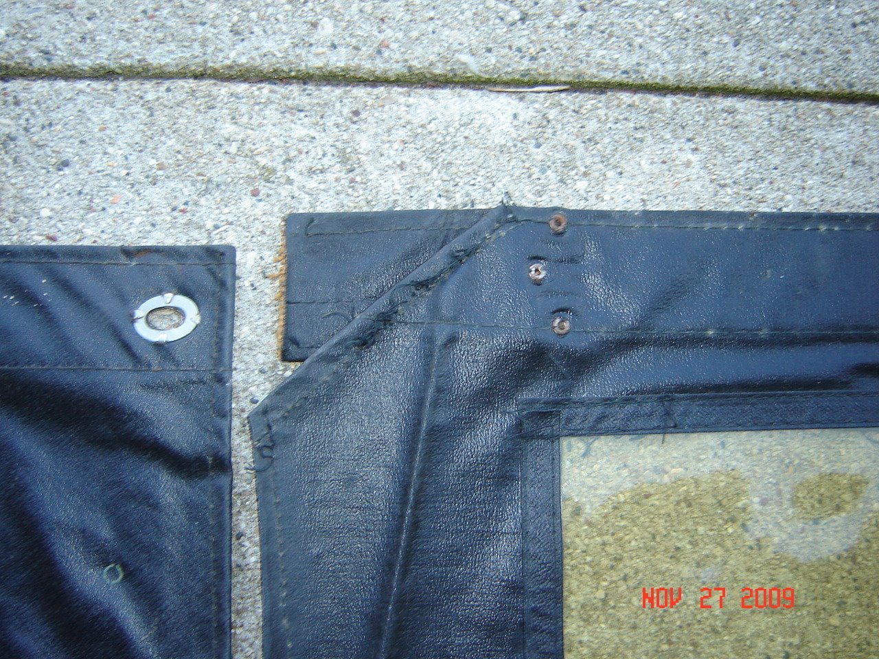

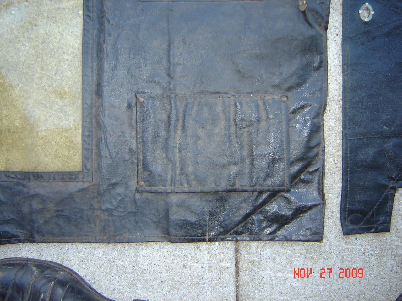

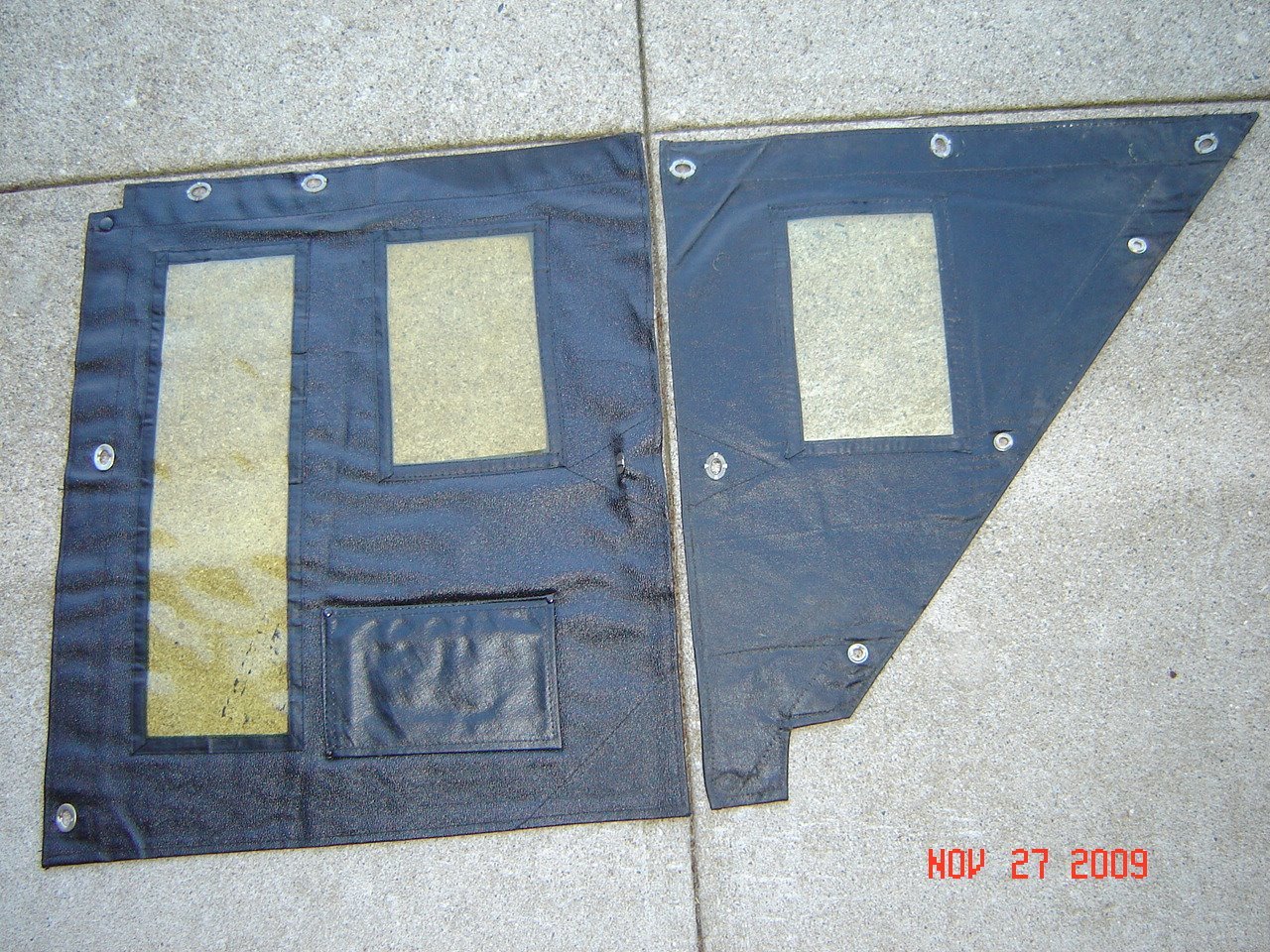

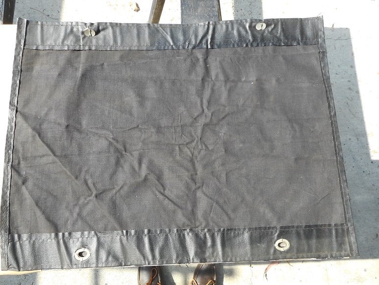

In the meantime, here are some pictures of NOS 1925 roadster side curtains that were posted elsewhere on the forum a while back. There is a limit of 5 pics per post, so I may have to spread the pics over multiple posts.

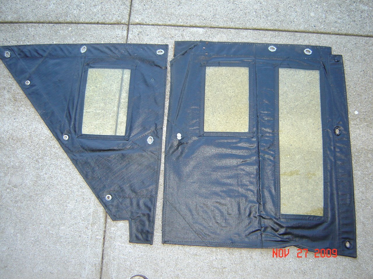

Re: 1925 roadster side curtain fasteners install location

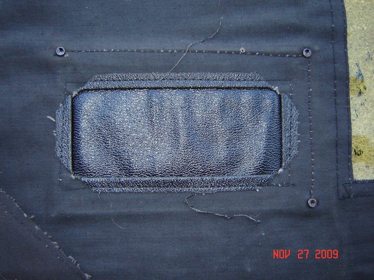

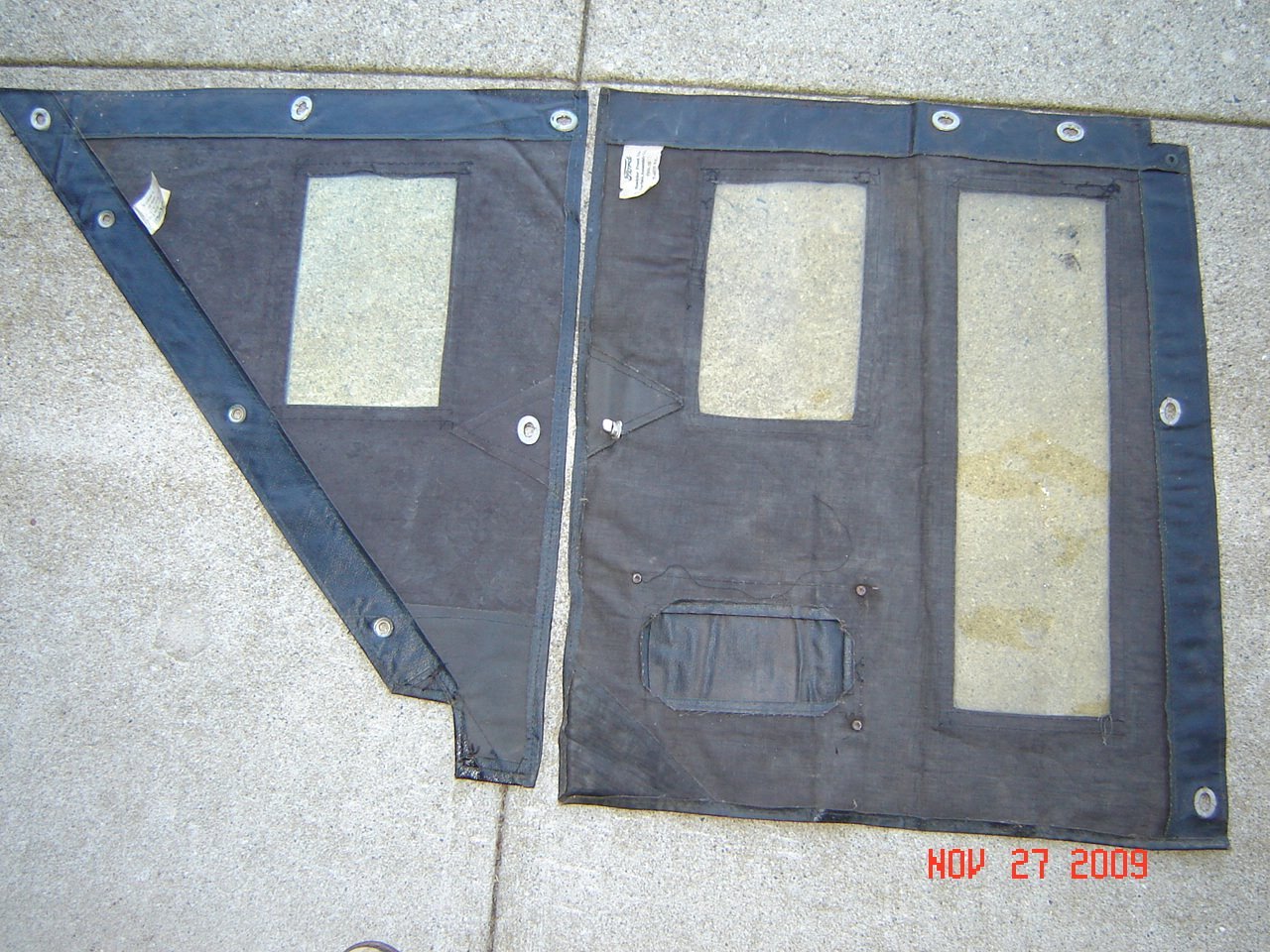

More NOS 1925 roadster side curtain pics:

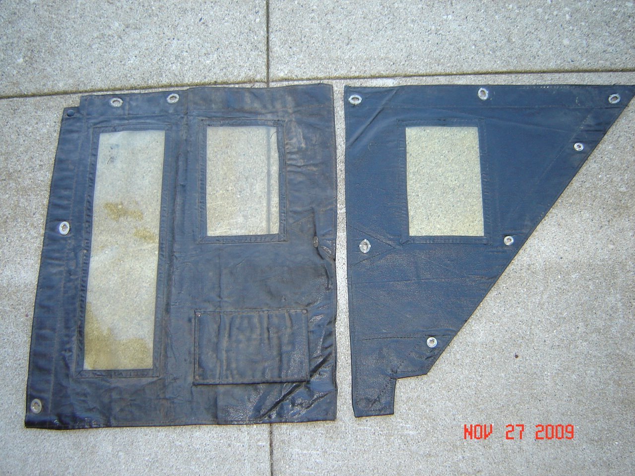

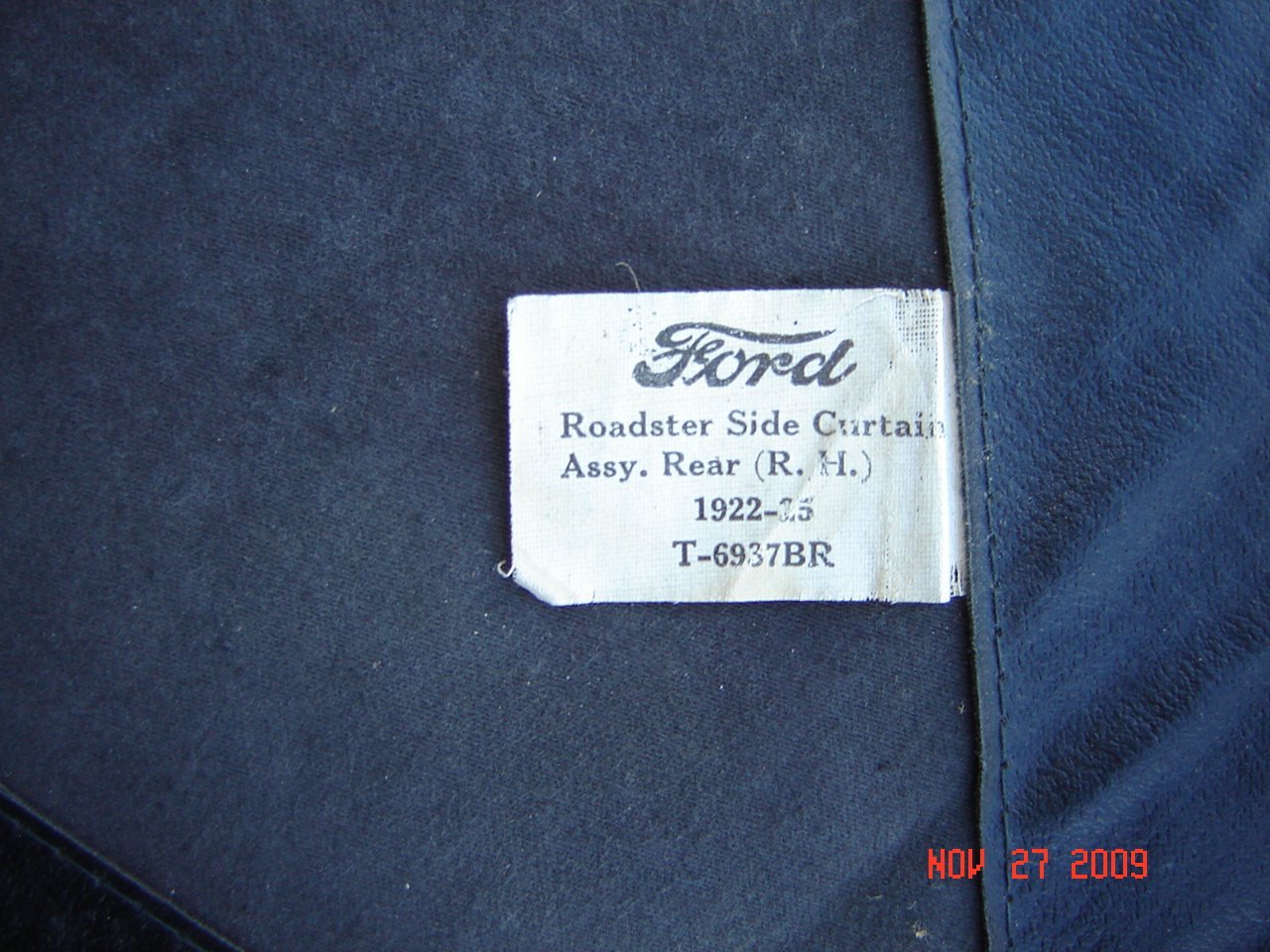

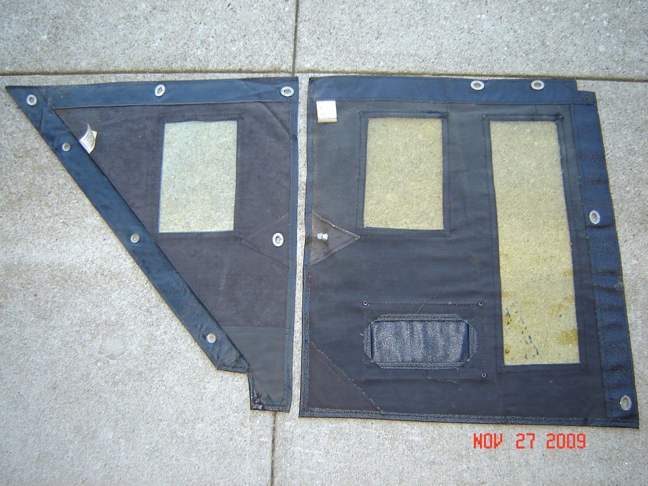

Still more pics of NOS 1925 roadster side curtains:

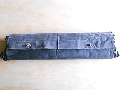

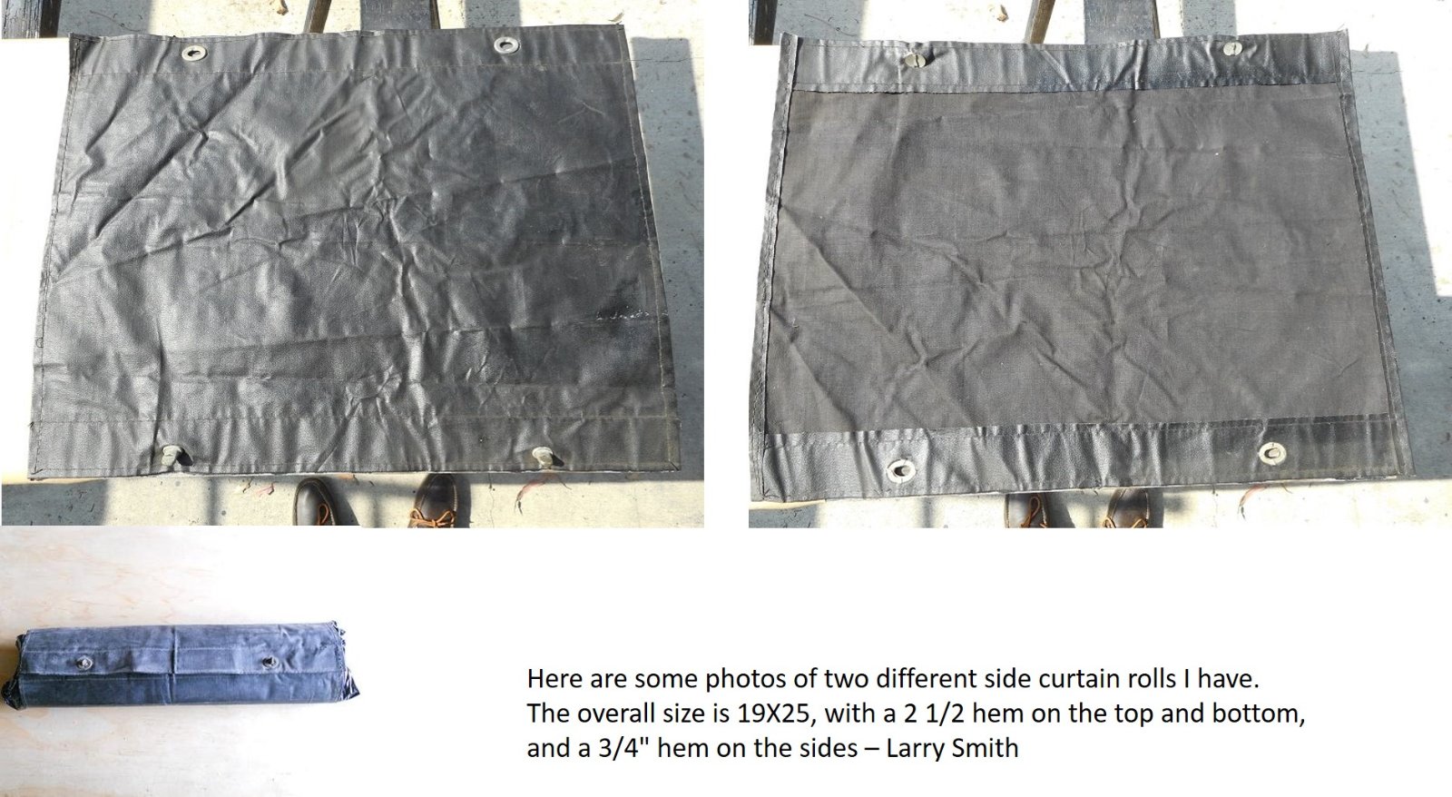

Larry also posted pics of the original roll that the side curtains were wrapped in, the bag that the vendors sell is not correct. I ended up making my own roll using the dimensions that Larry provided. His thread is in the forum somewhere, if I find it I will edit this post and add a link.
Thank you for the pictures. Looks like they used very little snaps. I didn’t have a way to contact Larry and any pictures I seen online were of no help

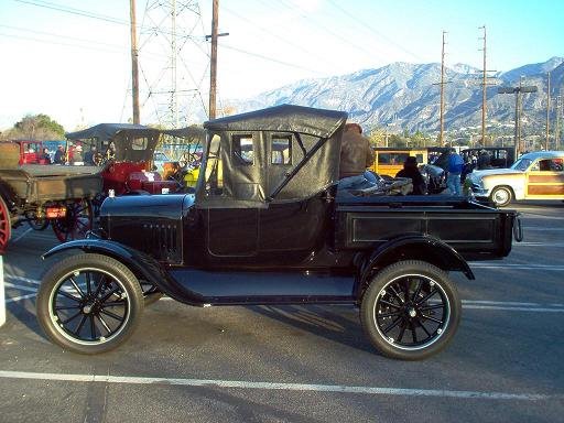

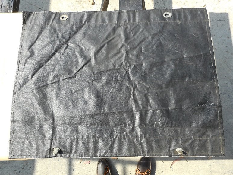

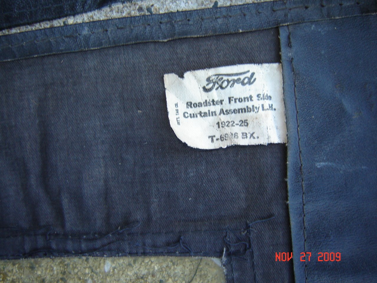

How original do you want to be? I used all NOS common sense fasteners. Yes, they come in different heights, single and double, and sometimes, triple. It is correct the Anzo fasteners are difficult to find, but they do show up. Restoration Specialties in Pennsylvania has some, and I can help you determine where they go. I made all my curtains from Ford prints, and original samples. Be sure to make paper patterns before punching you curtains. That way you can get it right.
- Attachments
- 12-27-09%20Holiday%20Tour%20002[1].jpg (63.59 KiB) Viewed 5967 times

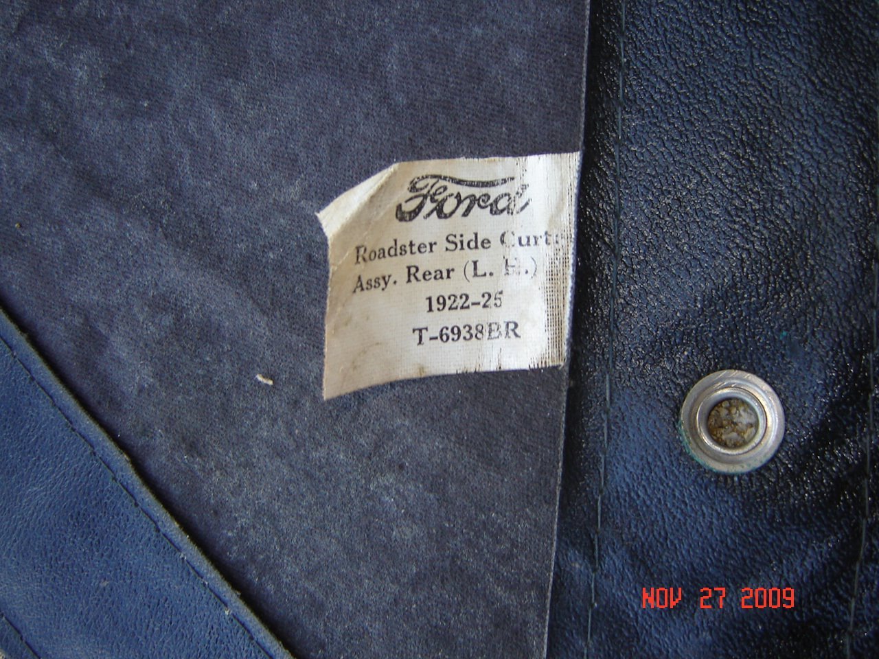

Something to watch for. Should you find NOS side curtains that say 1925 roadster, they are not 1925! They are for 1926-7. They were mislabeled at the factory.
Another thing. If your top sockets are original the rear sockets should already have the three Anzo buttons on each side. The front socket is drilled and tapped for two common sense fasteners, and the middle socket is tapped for one. As I recall, the front bow will need one common sense fastener placed in the flat front wood bow, and will need two #5 oval head wood screws for each side.
