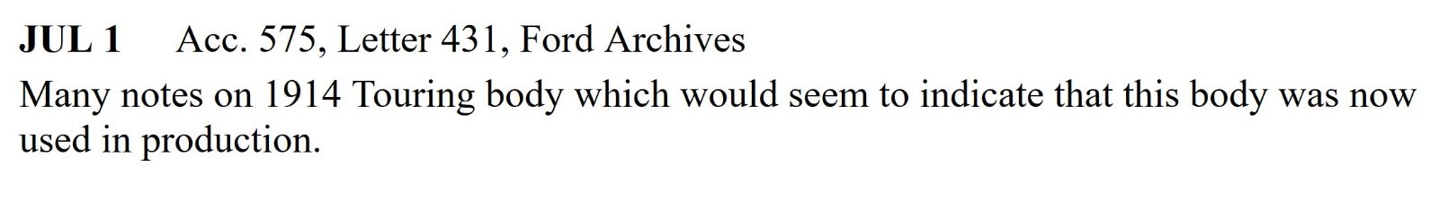

Jeff,
You are probably referring to the note below dated July 1, 1913. It has been a while since we discussed these early 1914 style Touring cars. Most likely brought about by the weak design of the 1913 style Touring bodies.
I have 312,4XX which is a July 1913 and it is a 1914 style Beaudette Touring. The transmission stub shaft is dated 7-11-13, car assembly 7-17-1913.
The factory seems to have been assembling both styles beginning sometime in June 1913 and for about three more months of the 1913 model year. The only difference was which body was dropped on the chassis. Some may have had the 1913 style windshields as well.
Beaudette had built the stronger of the 1913 style Touring bodies and it could very well be that they furnished the earliest "1914" style bodies. A little different beading than the later 1914 bodies.

It seems that not all bodies suffered from the weakness as there is a note:
JUL 14 Acc. 575, Letter 434, Ford Archives
Noted that 1913 Touring bodies were made by Herbert, Fisher, Wilson, and Beaudett. Apparently the Beaudett bodies differed in construction from the others. Beaudett bodies with a filler block on the rear door hinge posts apparently did not need the steel reinforcing pieces.
Previous notes indicate that reinforcing plates are dated May 1913 and make no mention of the various body builders.

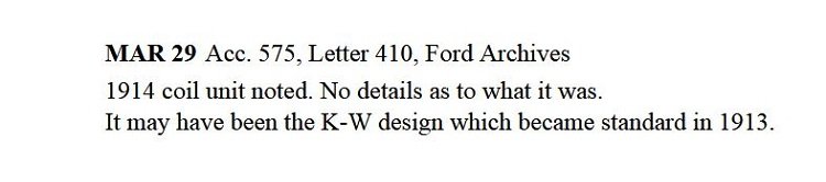

Ed,
Thanks for the June 9, 1913, early date. I assume you have the metal coil box? If so, pretty well confirms the switch to the new coil begun in March 1913 was over by June 1913. The new coil won't fit the wood coil box.
Same here on the '13 fenders, pipe plug engine, two piece drive shaft housing, etc. Mine just happens to have mostly DB furnished parts.
