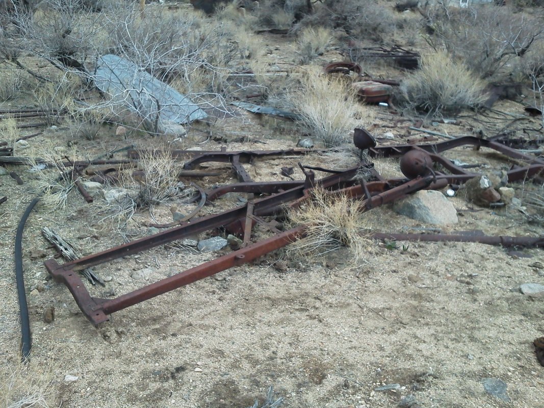

This is how it all started!

Then this and many more like it.

Then a Rancher Friend had this stuff.

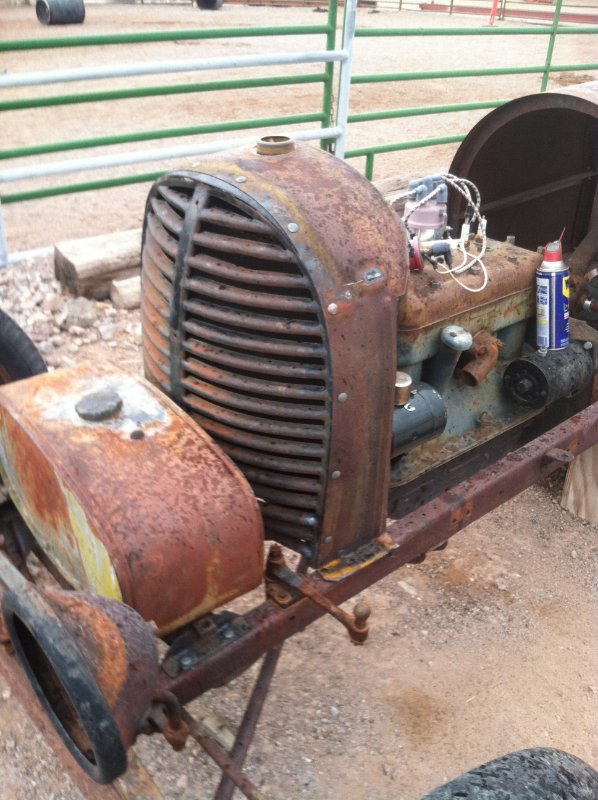

then I saw this

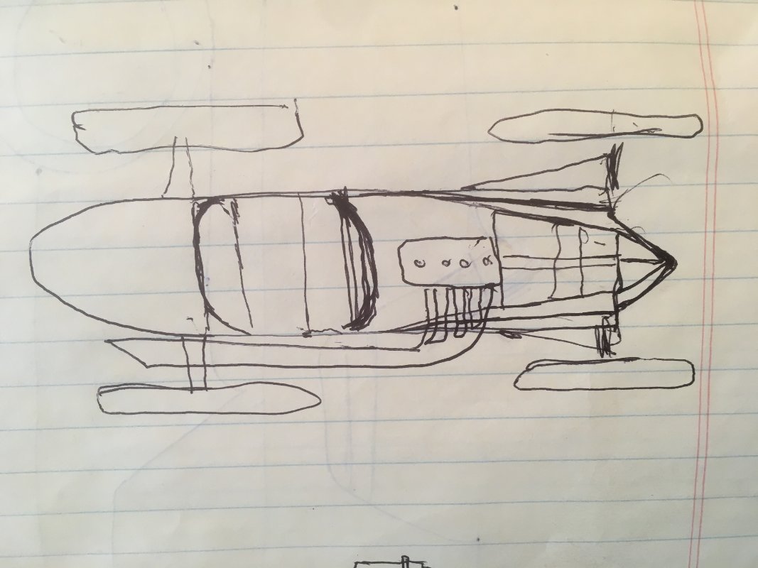

Time to start thinking about this.

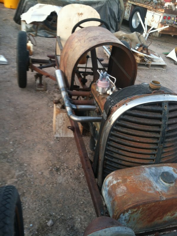

Re: Race Car Project
OK , I have to have an engine! Where on earth can I find a model t engine? I start looking on craigs list and finally find this after a couple of months. I better get it because I haven't seen anything else closer to a model t engine. Wanted $700 so I offered $500 and he took it, so I guess this is close enough for now.
John Warren
Topic author - Posts: 1071
- Last Name: Warren
- Location: Henderson, Nevada

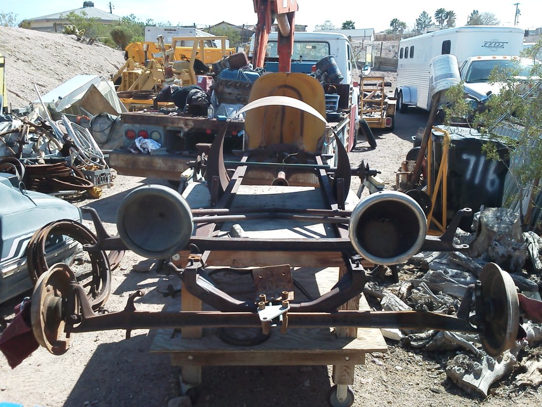

Time to start building.
Now to start laying it out.

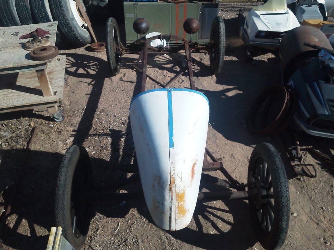

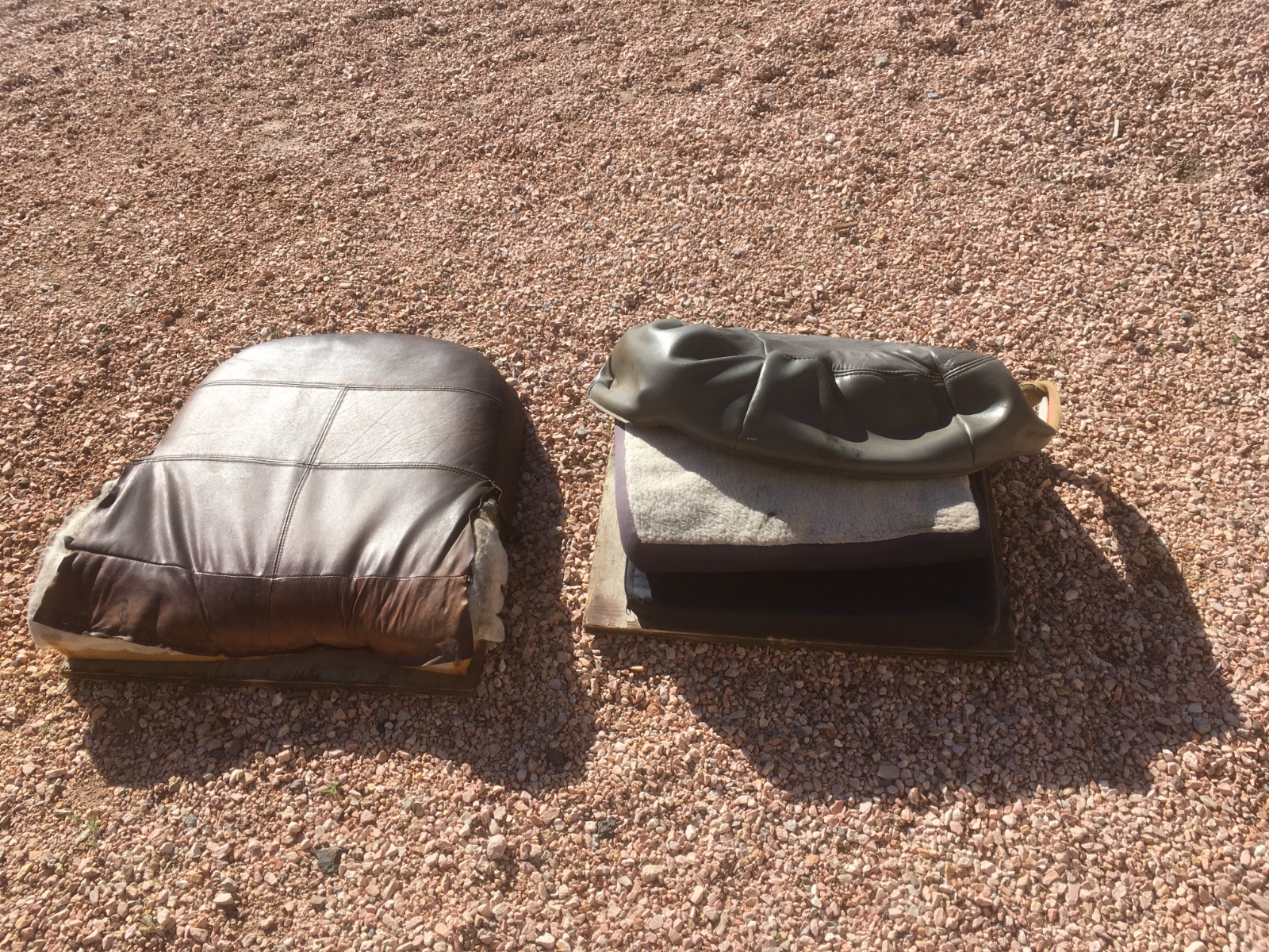

Now I need to build the tail hmmm...
Many of you may recognize this, it made a fine race car tail!

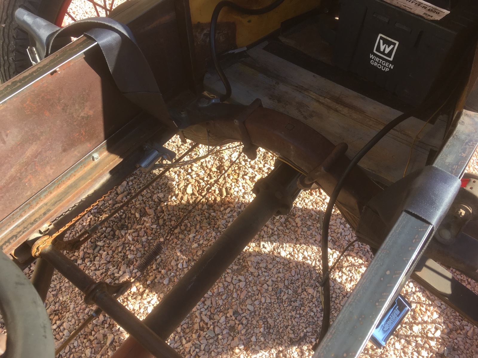

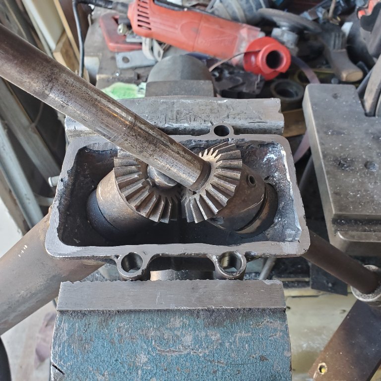

The rear end is a hybrid , Large drum model t with the model A tube grafted where they were the same size and I used a model A drive shaft and cut it to fit the model t pinion and it has opposing timken bearings for the pinion.
John Warren
- Last Name: Warren
It has McGill needle roller bearings and a seal for the axle shaft bearings fitted into a machined bushing.

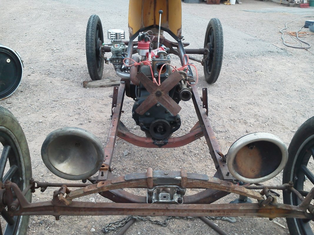

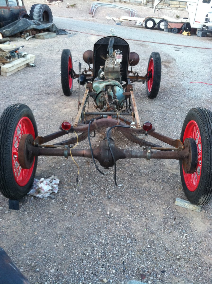

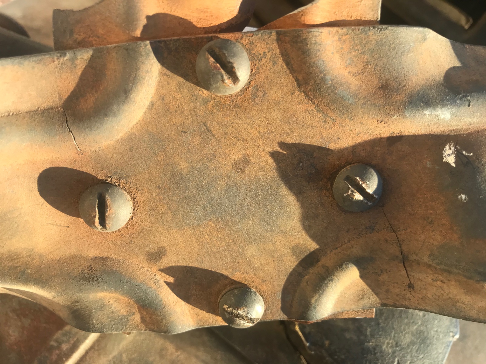

On the previous photos you can see the new mount plates for the radius rods and spring perch. The drive shaft is short because I moved the engine towards rear about a foot. The next photos are of the drop mount for the front end.
- Posts: 4394
Do the McGill needle bearings ride directly on the axle shafts? If so, you may not like the result...
I am concerned with your front lowering system as it is like a step ladder with no steps. That is a big drop and even if the welds hold there will be constant stress with each bump and turn. Eventually it may fold over left or right. You could plate or box the lowering bracket in the rear or both front and rear for MUCH more strength. I am no engineer but have been down this road and the front end will take lots of abuse constantly being pushed with any forward movement and trying to sway side to side. The period correct lowering brackets were always a full plate in the vertical axis. The horizontal axis should be stabilized by the wishbone or radius rods if in double configuration (recommended so it can't fold over). That looks a little scary too me.
I am afraid one big bump on a turn or a curb and the axle will fold over to the side.
Jerry, the needle bearings have a inner race pressed on the shaft. Tim they may look flimsy , but they are very strong. 1/2 T1 steel welded to 100%.

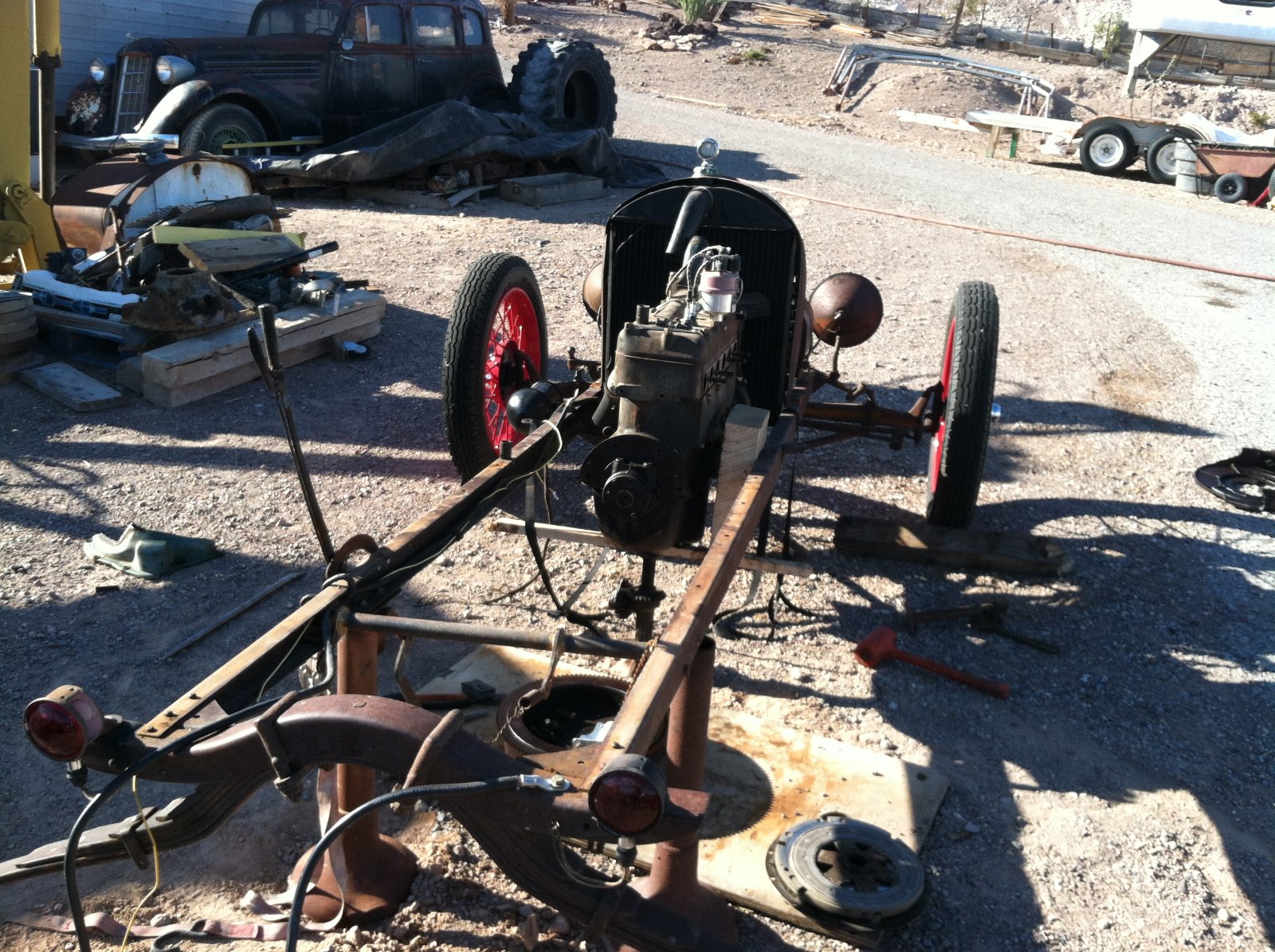

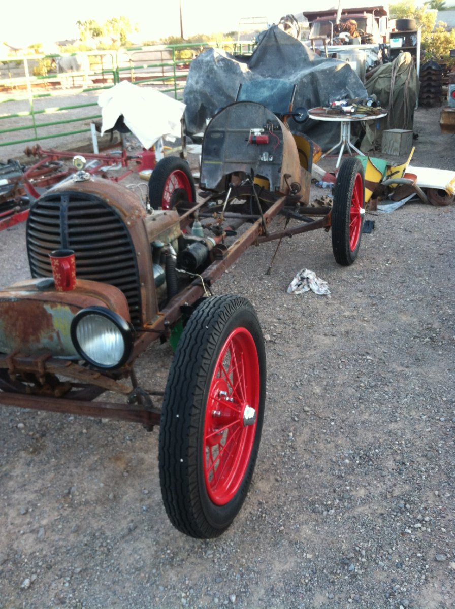

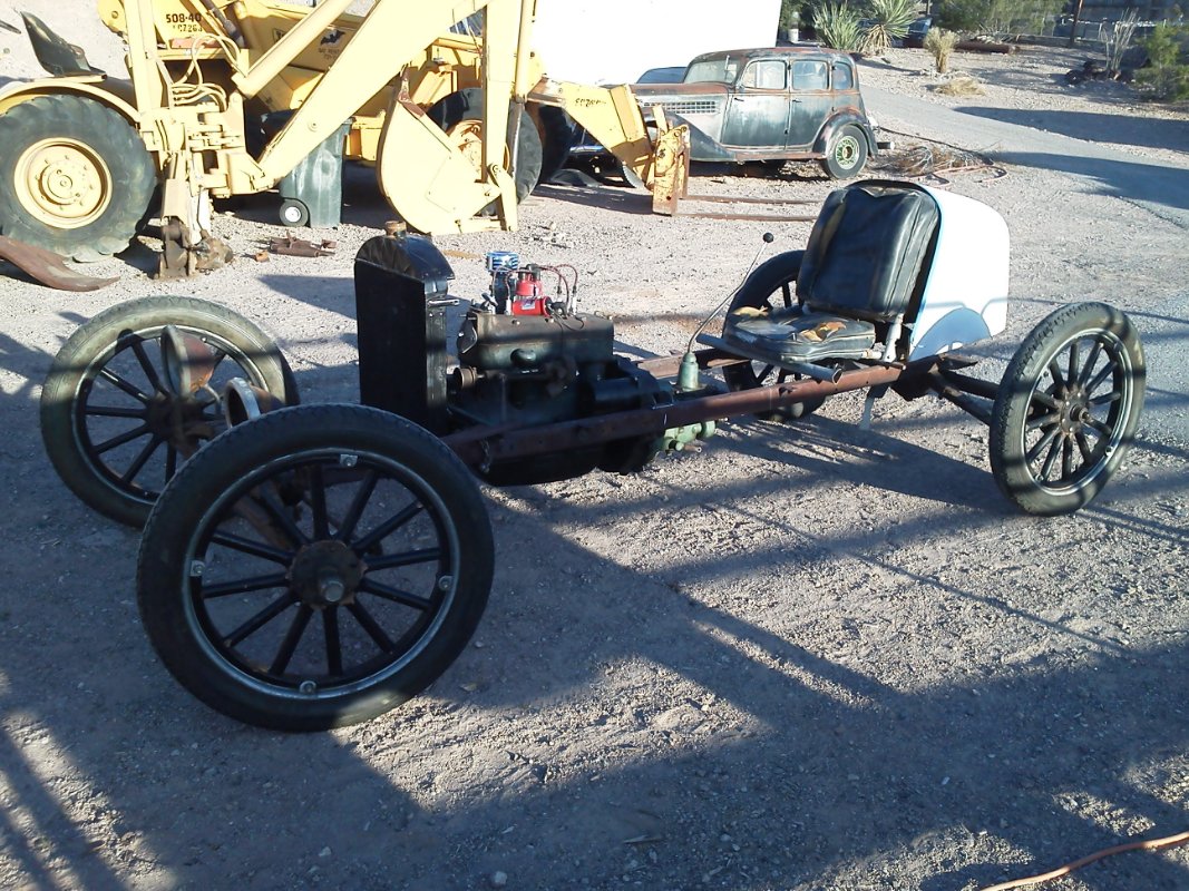

Time to put some tires and wheels on it so I can roll it around. The rear axle (small drum)in these photos was just to mock it up. The grafted torque tube is the one I used.
John Warren
- Last Name: Warren

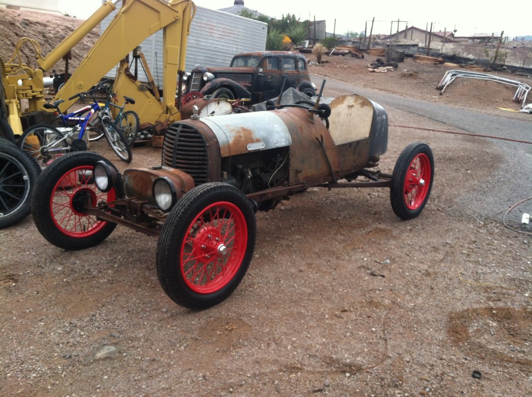

With the engine set in place, she is starting to look like something.

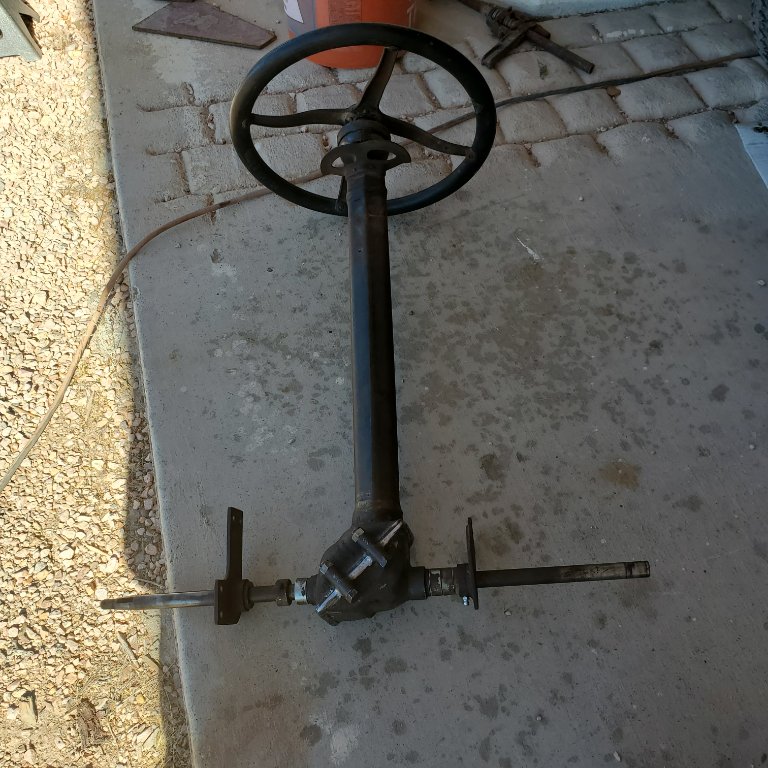

Now to start building a frame for the body. I used 1-1/4 X 1/8 angle iron.
The hoop is for the firewall. It is heat formed to a circle that was drawn on a piece of plywood.
I agree with Tim, your suicide front end may truly be a suicide front end. Looks neat but I think you need some gussets or bracing of some type.
Ruxstel24
- Posts: 2386
- Last Name: Hanlon
- Location: NE Ohio
I hear what you guys are saying, but I don't see a big issue with the front spring. It doesn't contact all that much in the center, when mounted stock up in the frame...

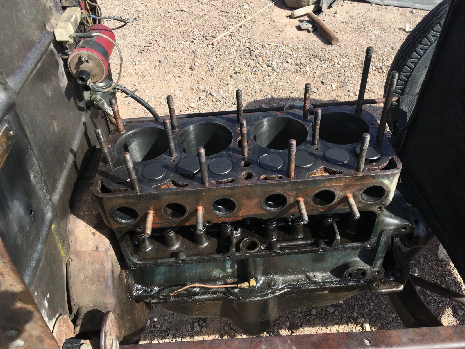

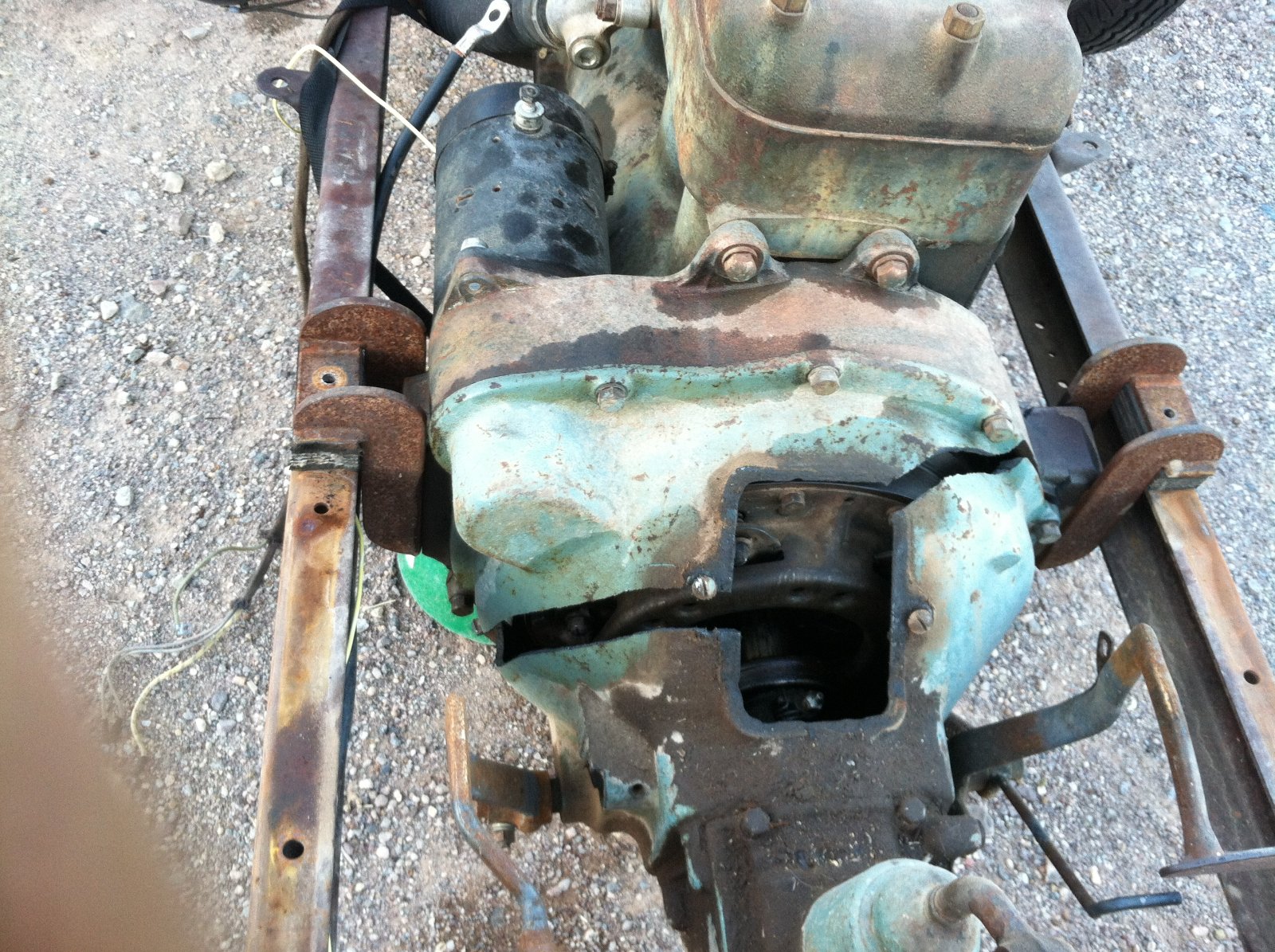

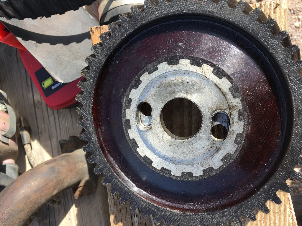

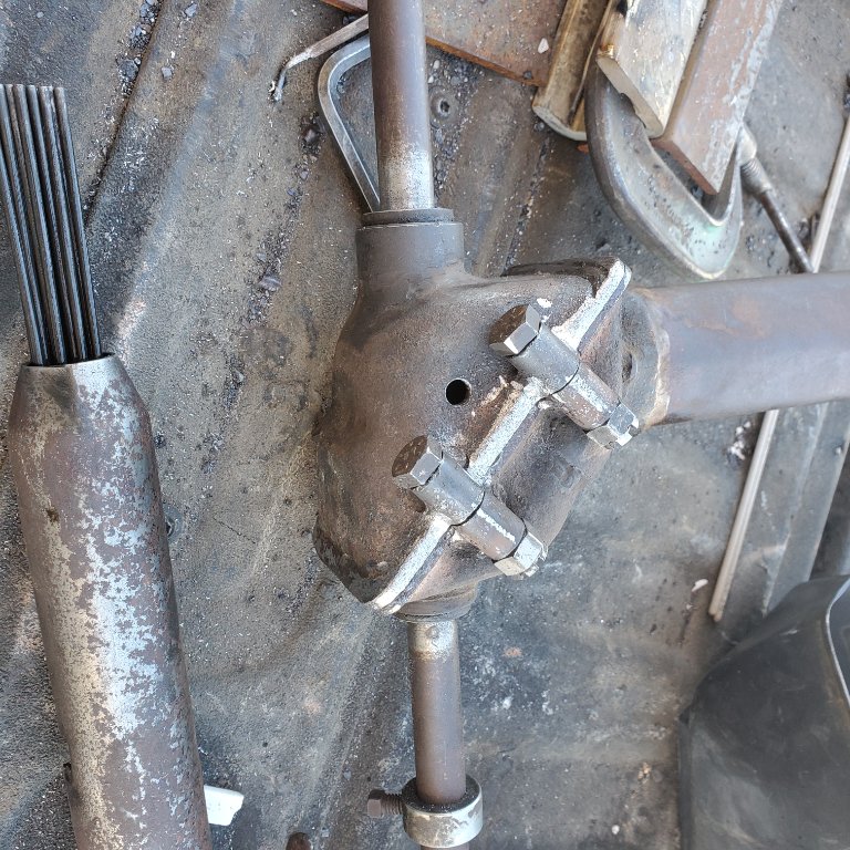

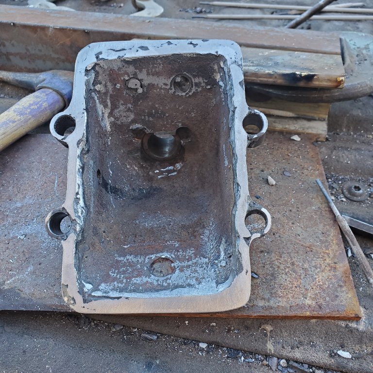

The engine wasn't running well, This is what I discovered, someone installed the valve guides from top instead from the bottom. It is a two piece valve guide that the spring keeps shouldered up in the valve cover, it is not suppose to be in the port held down by gravity and the valve banging it back down.

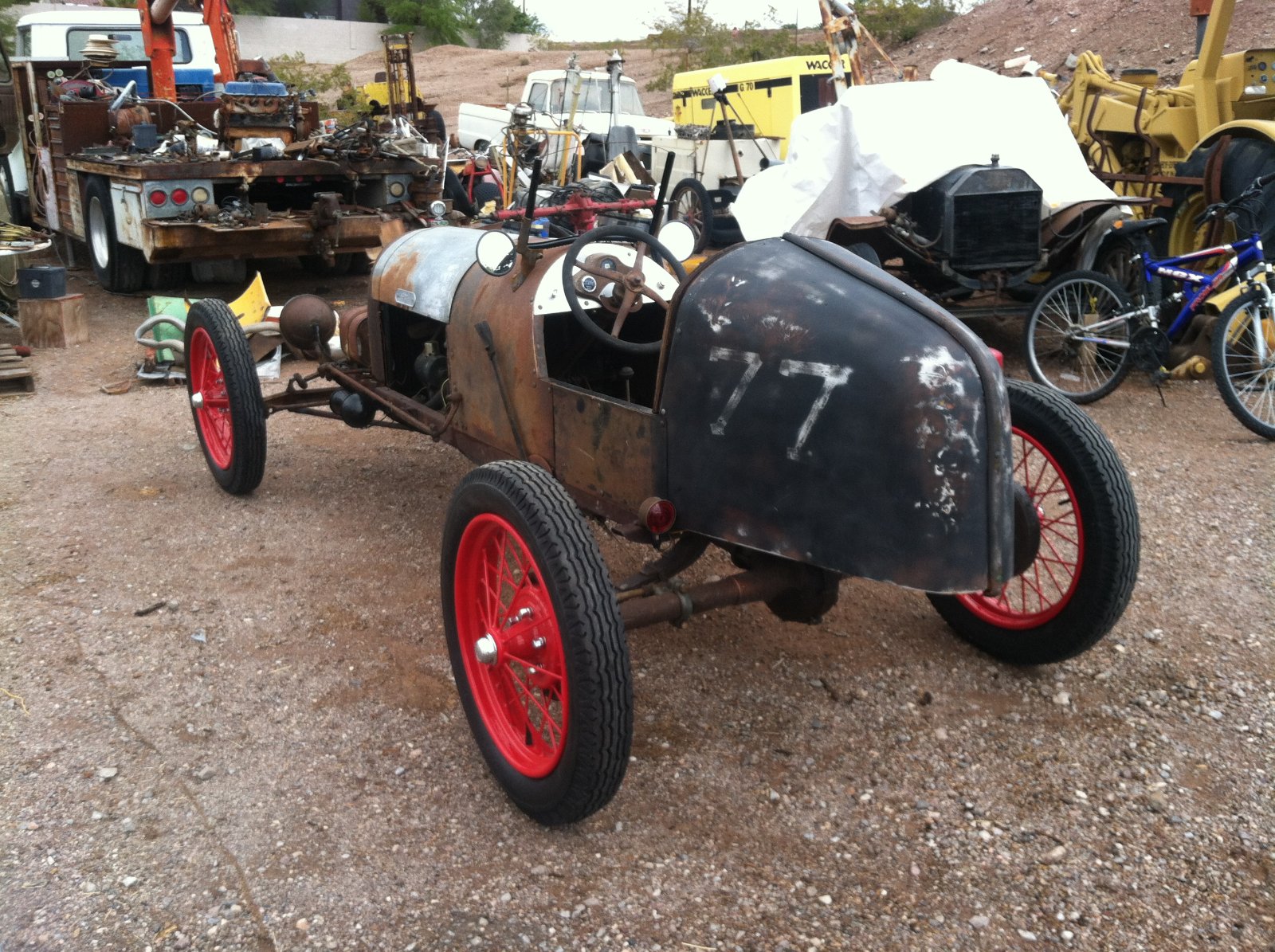

Well much closer to tour time. It has taken me three years to get it to this. New tires, wheels blasted and powder coated, new caps and lugs. [/b]

I have been asked a few questions about the racer. I set the engine back about a foot to help handling, and it did work out well, I am mostly pleased on how it handles. The steering could be better, but is way better than my other t's. I think it has more to do with the speed that I can travel, it is great below 60. I still want to add shocks and see if that helps. It is currently apart having sent the engine to Ron Kelley for a rebuild. It will get a new crank, bearing inserts, bored and a valve job. I hope to have it back together for the Nebraska Speedster reunion. I have an engine that I know nothing about that I was going to install so I can go to Laughlin speedster run.

Great assembly of assorted bits and pieces. How it would have been done back in the day. It's always nice to see that people still do this kind of stuff today. Innovation lives!

Thanks Thomas for the kind reply, I loved building the car. The thought always was, could they have built it like this with the tools they had ? I tried to use period correct parts where possible. I am still tweeking. I need to install better upholstery. Some things are better left to a professional.

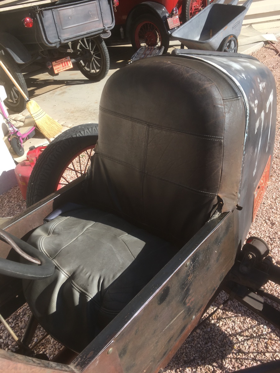

Send me some pics of your seat, that was my first apprenticeship at 14. You would problem want an old style tuck pleat with snaps, correct?
Email hankpattylee at bellsouth dot net
All the Best,
Hank
All the Best,
Hank

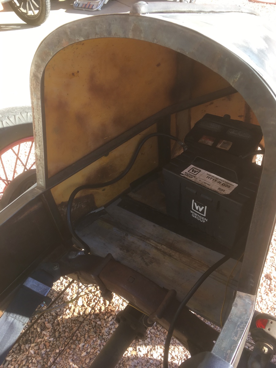

Here is what I currently have. The back is also pulled forward to access the battery and storage. The bottom just sits on the frame. I know there is a better and nicer way to do this. One original thought was to do a drop in with snaps kinda like we use to buy for our sandrails. Any help would be greatly appreciated. Thanks

I will have you make some templates later when I am done with Dave’s baby. That one is pretty straight forward. The bottom will be a drop in with cleat and the top snap attachment on the outer edge as seen. How about 1 1/2” verticals pleats? Black good? Looks
Cool!
Hank
Hank

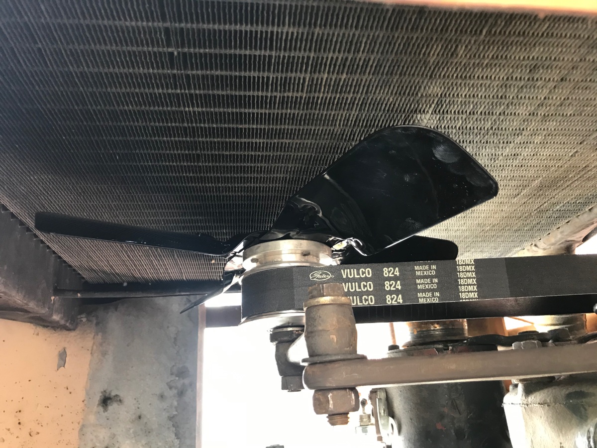

John Warren
- Last Name: Warren
Threw a blade off my fan then broke the opposite one off to get back home. Just a heads up guys. I was very lucky that it didn’t go through the radiator. This fan was looked at very carefully when I built the car. I had one come close on my 26 touring. When I checked on a new one I almost fell off my chair. $12.50 whattttt!!!! I purchased three, one for all three cars.
- Posts: 4385
Twelve fifty for THOSE!? Sounds like a bargain.
Glad the damage wasn't severe.
John Warren
- Last Name: Warren
Like I said Wow Cheep no reason to not get a new one. Thanks Wayne I should have started a new post about fans.

The inspiration appears to be from "Ford:The Dust and the Glory". But you must have a different version than I do, I can't find that illustration anywhere but the cover.
Cool project! I hope to start on one soon myself.

I have had many questions about my car lately. Just came home from a 275 mile Joshua Tree tour! I was able to photograph my car with a P51 Mustang Once in a lifetime opportunity!

I recently took my steering sector apart for inspection and I always wanted to seal it up better so I could fill it with grease. Here are a few photos of how it is built
using some miter gears. The housing is made from some forged engine frame mounts, they looked the part. The shaft was cut and the left over piece was used as the cross shaft. Side support bearings added. I used a brass back up plate during the welding process to make a sealing surface ( shiny part) the bolts are fitted like dowel pins to locate the two halfs. Just sharing for those that may be interested.

Things that make an engine run bad!
Kevin Pharis
- Posts: 1644
- First Name: Kevin
- Last Name: Pharis
- Location: Sacramento CA
Wow! That’s more than a few degrees retarded...! You must have noticed it running and sounding more and more like a tractor as this was happening...? Was the cause a loose cam gear nut...?
ivaldes1
- Posts: 960
- Joined: Mon Jan 07, 2019 1:32 am
- First Name: Ignacio
- Last Name: Valdes
- Location: Houston, Tx
I thought some rest and maybe Viagra was the proper back up?
John Warren wrote: ↑Sun Feb 14, 2021 10:00 pmI used a brass back up plate during the wedding process...
John Warren
- Last Name: Warren
HAHAHAHA, good catch. Agree!
John Warren
- Last Name: Warren
Kevin, Oh ya, It wasn't running very well, Clattering like you said obviously running retarded.... The cam nut was loose and it was missing the cam thrust bearing and spring. I talked to God that day and assured him that I would overhaul it before I would drive it again if he would let me make it back home. True to my word, it came apart and was repaired!
