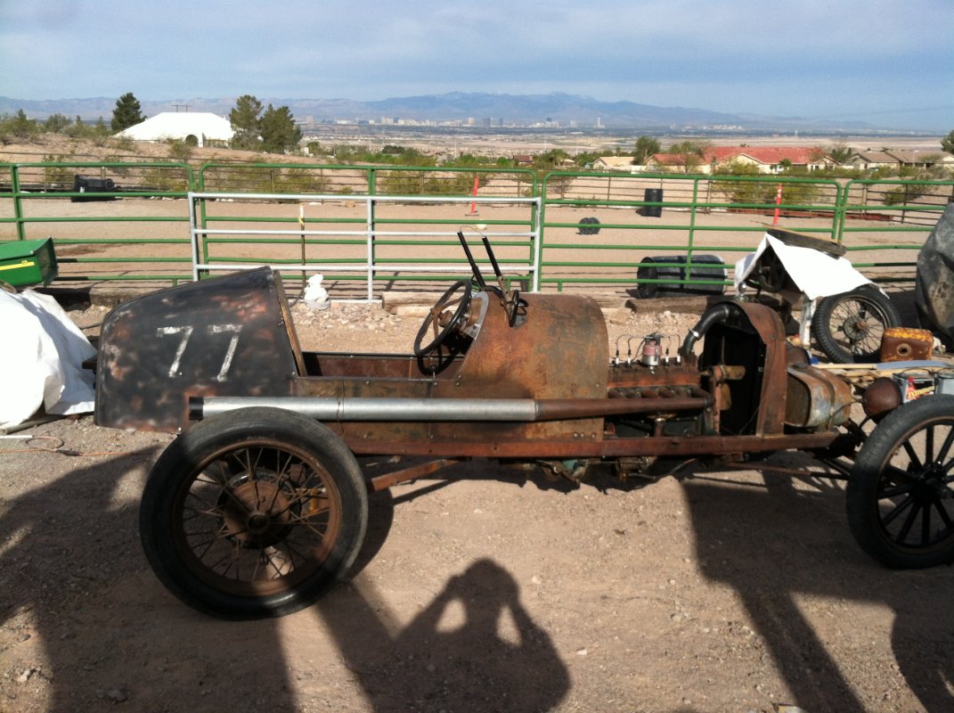

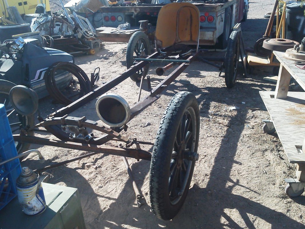

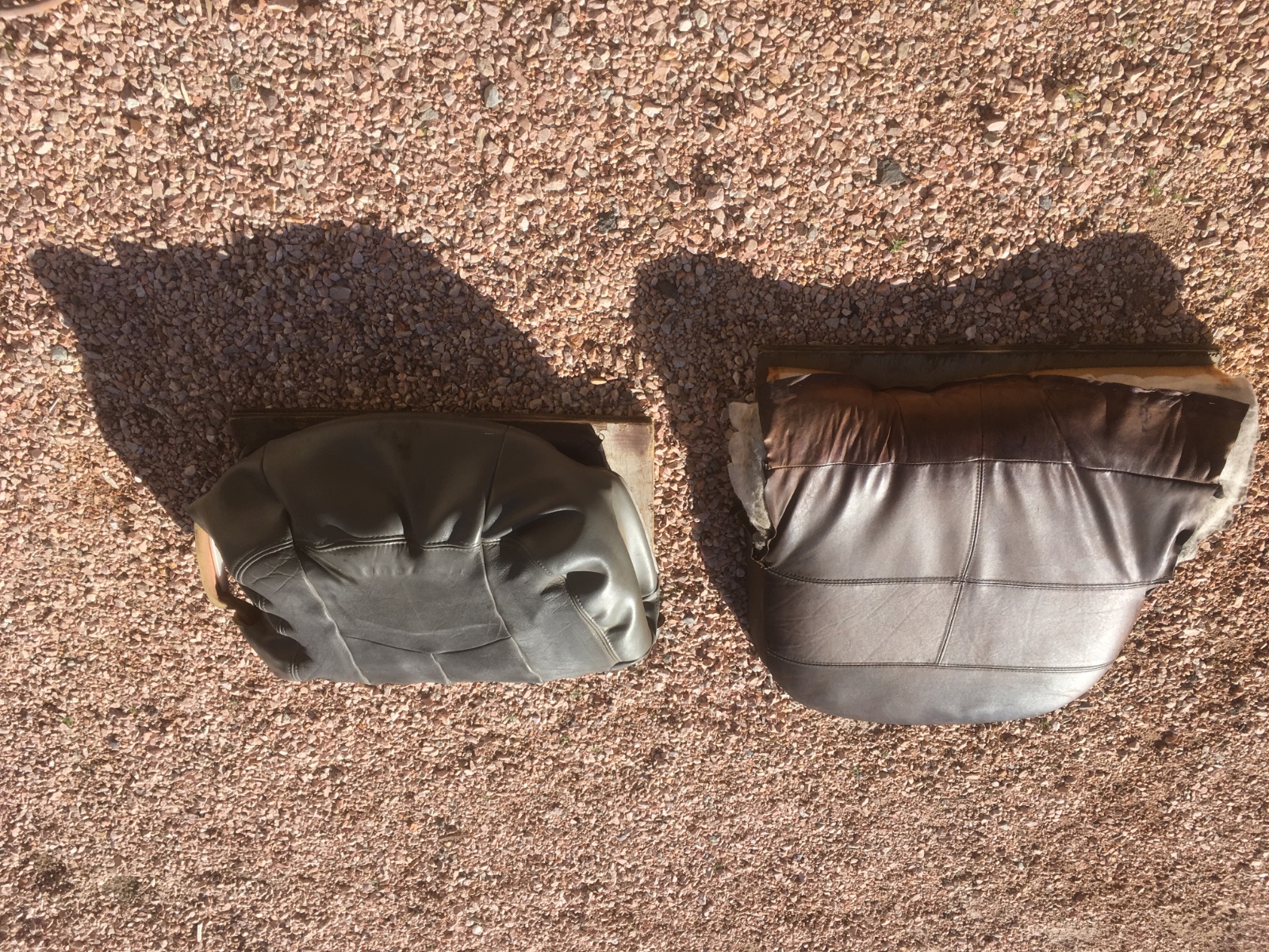

Post by John Warren » Sun Jan 06, 2019 6:08 pm
This is how it all started!

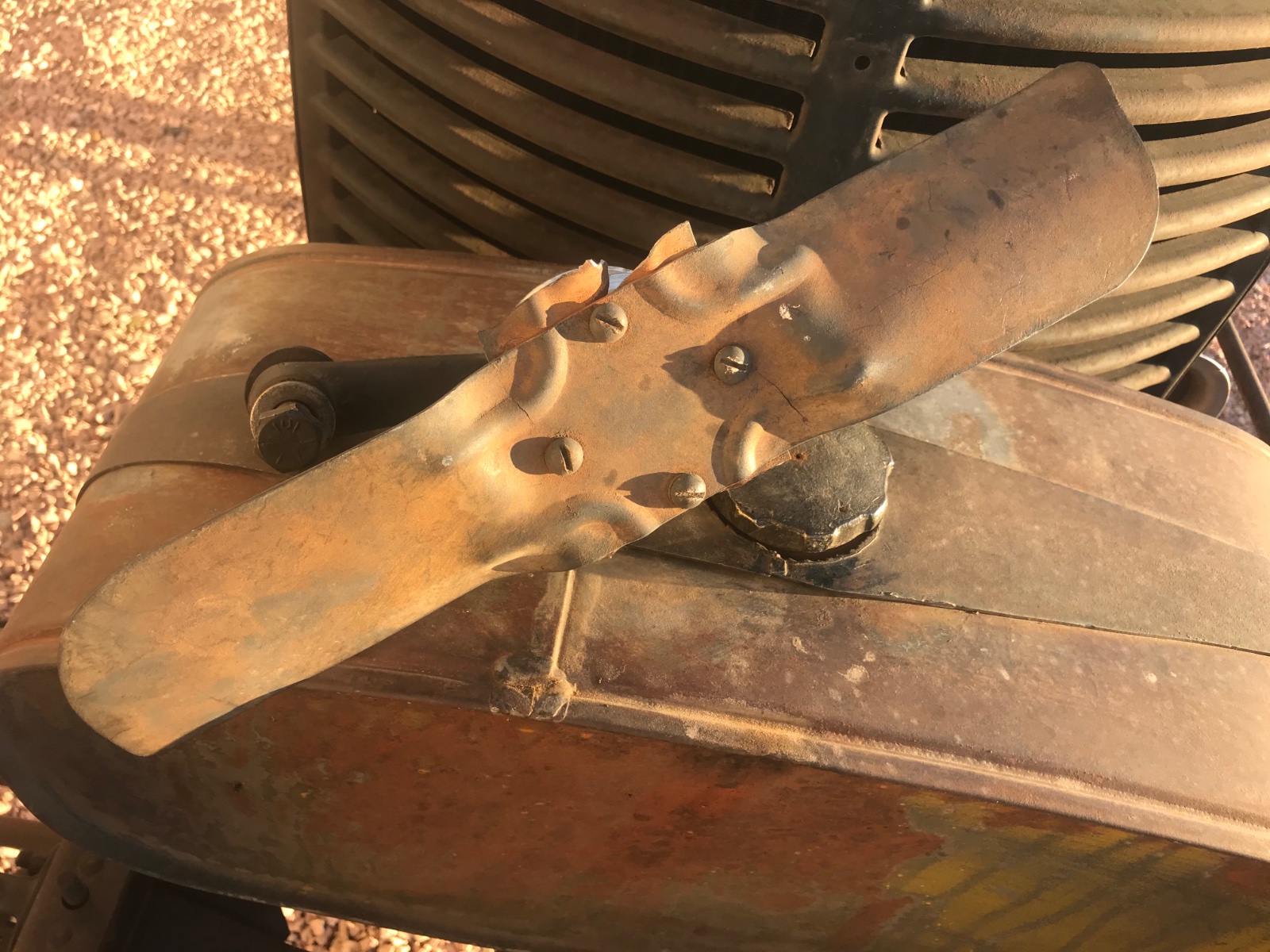

Post by John Warren » Sun Jan 06, 2019 6:37 pm

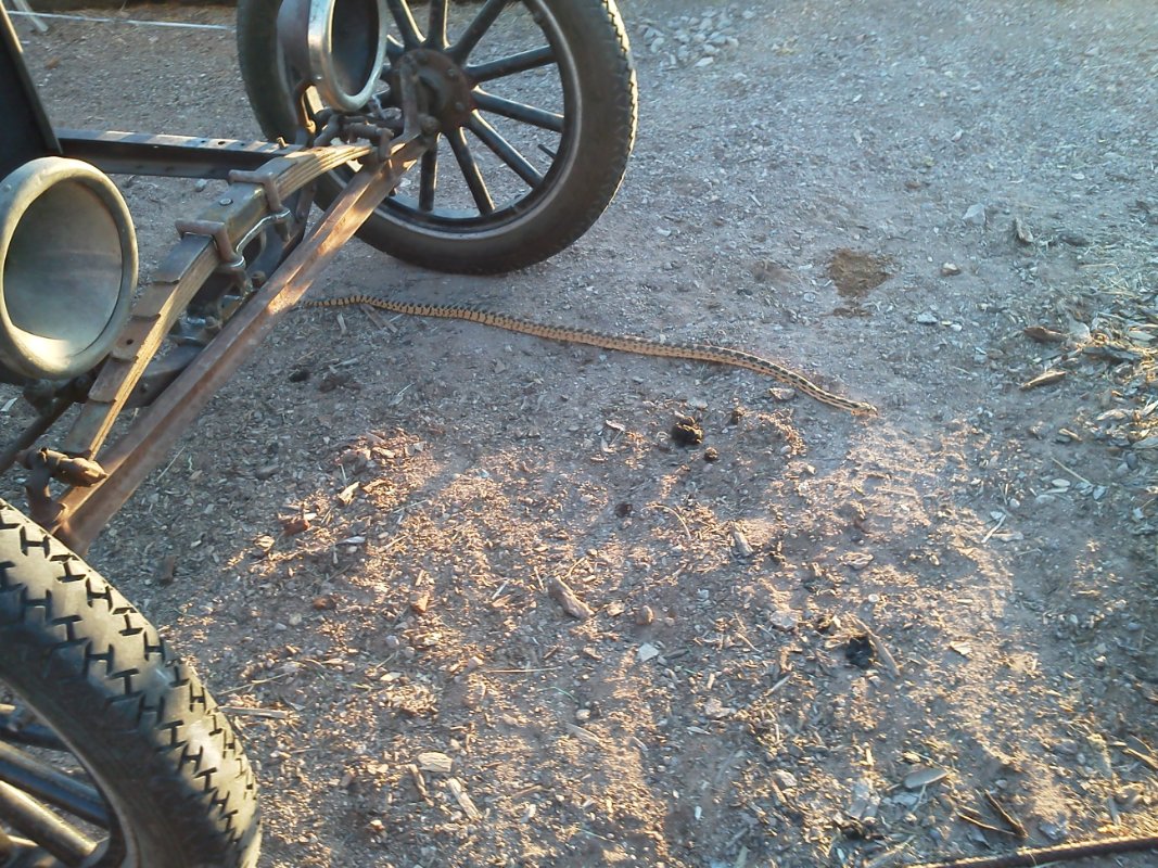

Then this and many more like it.

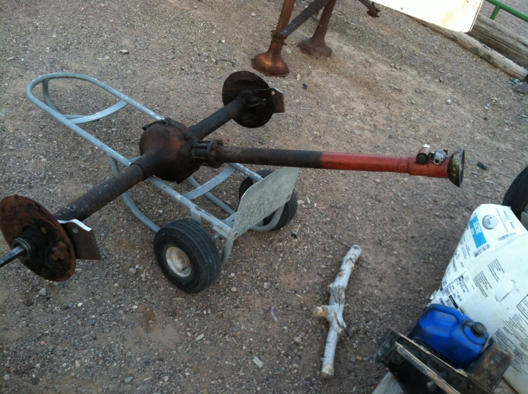

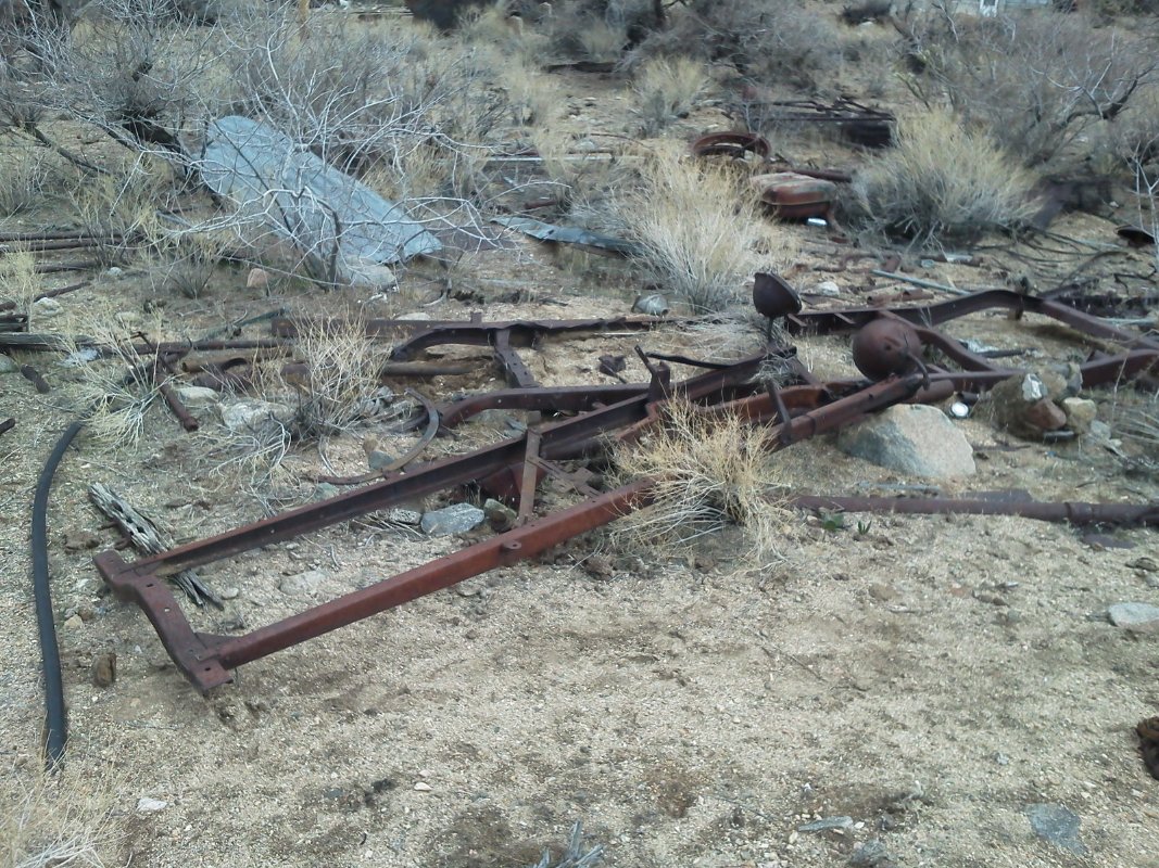

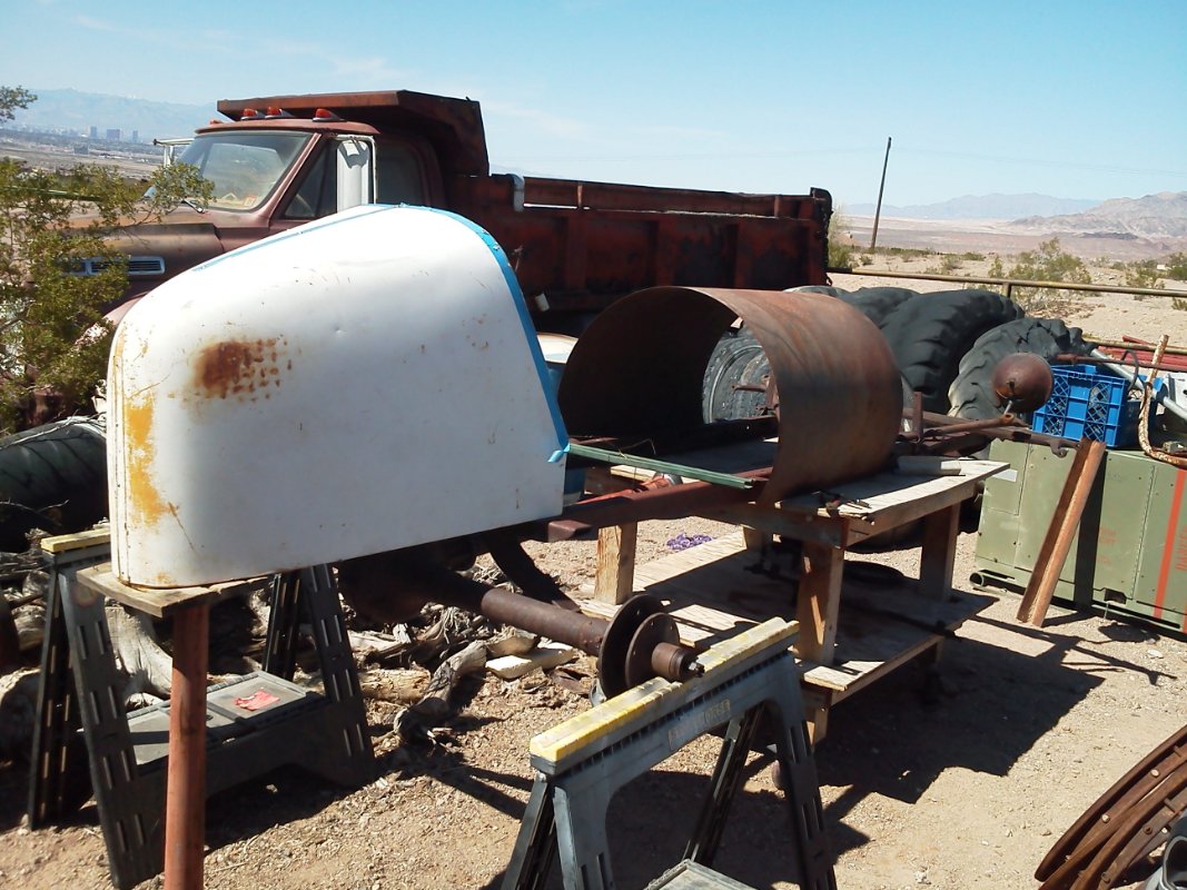

Then a Rancher Friend had this stuff.

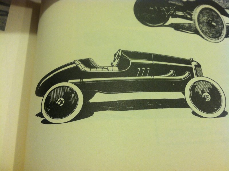

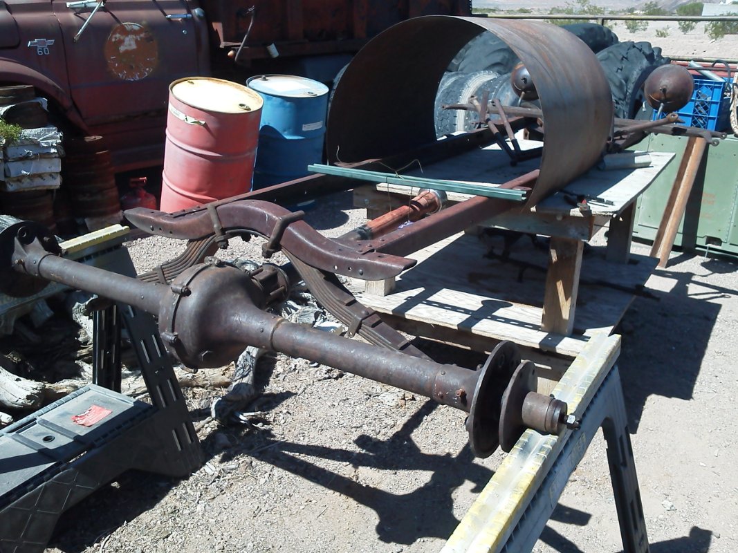

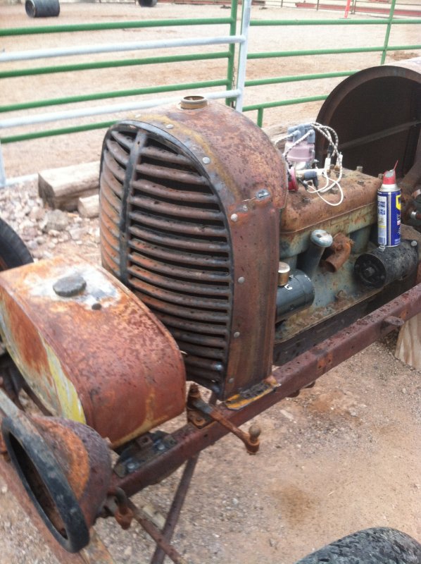

then I saw this

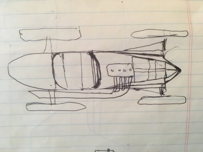

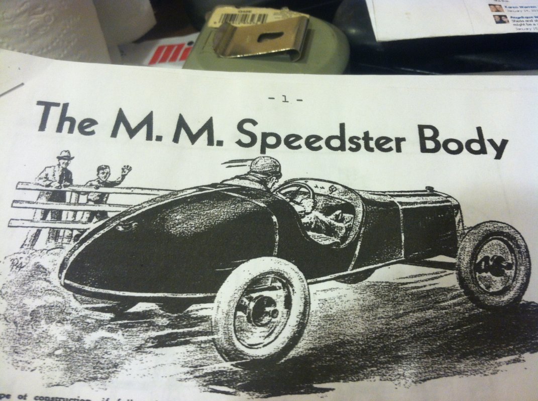

Post by John Warren » Sun Jan 06, 2019 7:55 pm

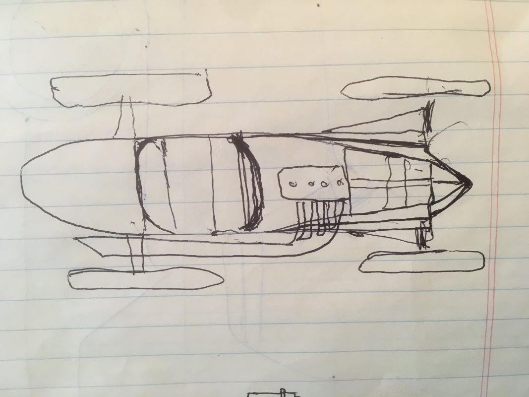

Time to start thinking about this.

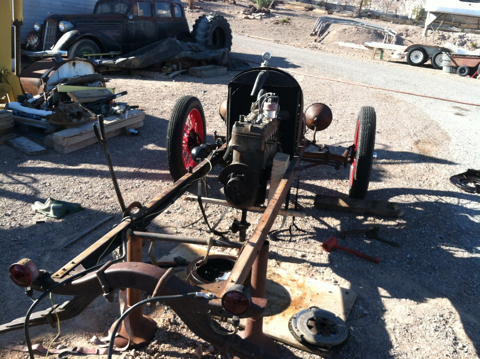

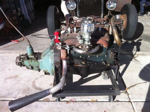

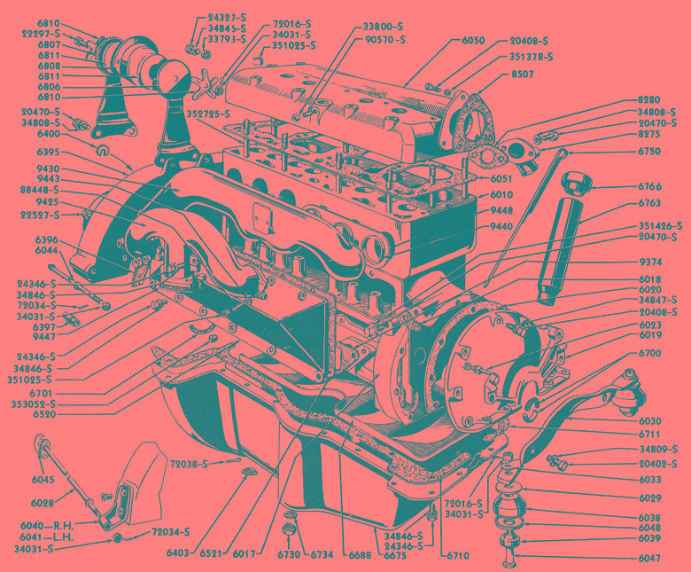

Post by John Warren » Sun Jan 06, 2019 8:04 pm

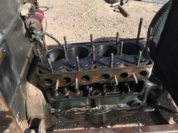

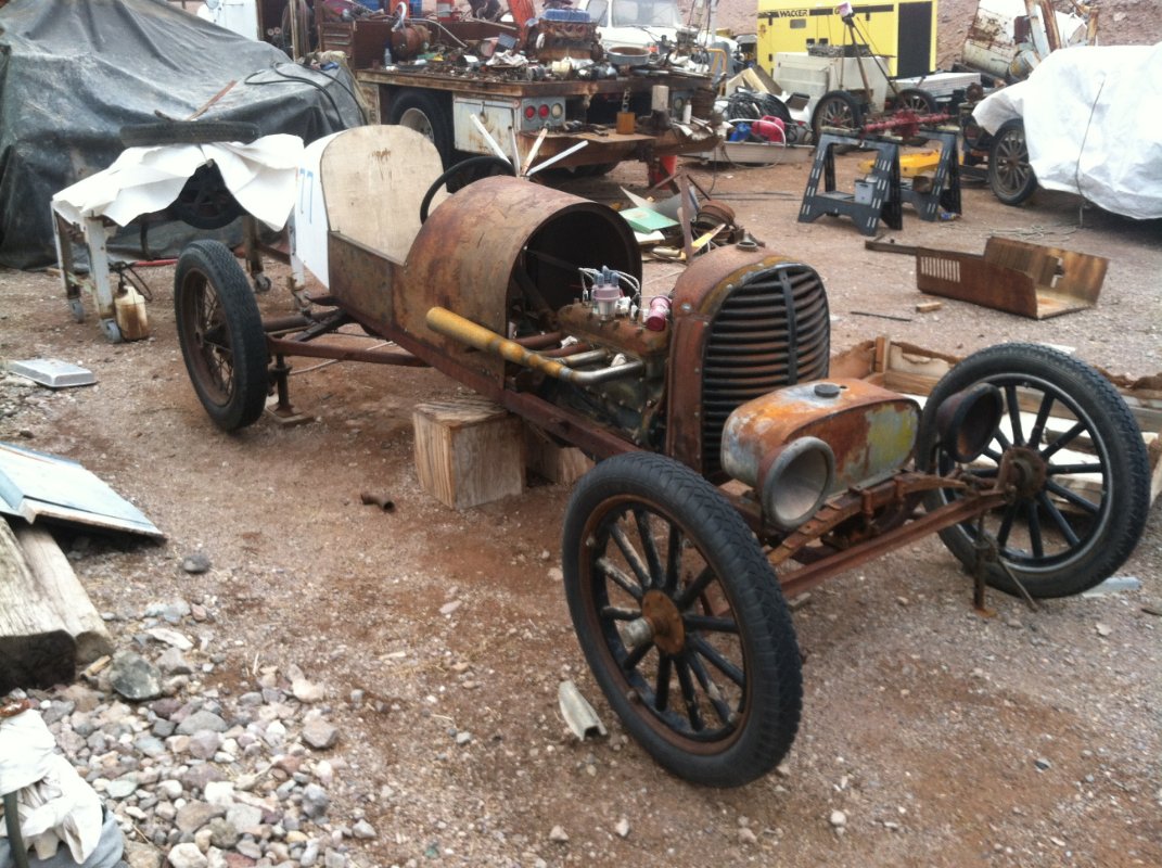

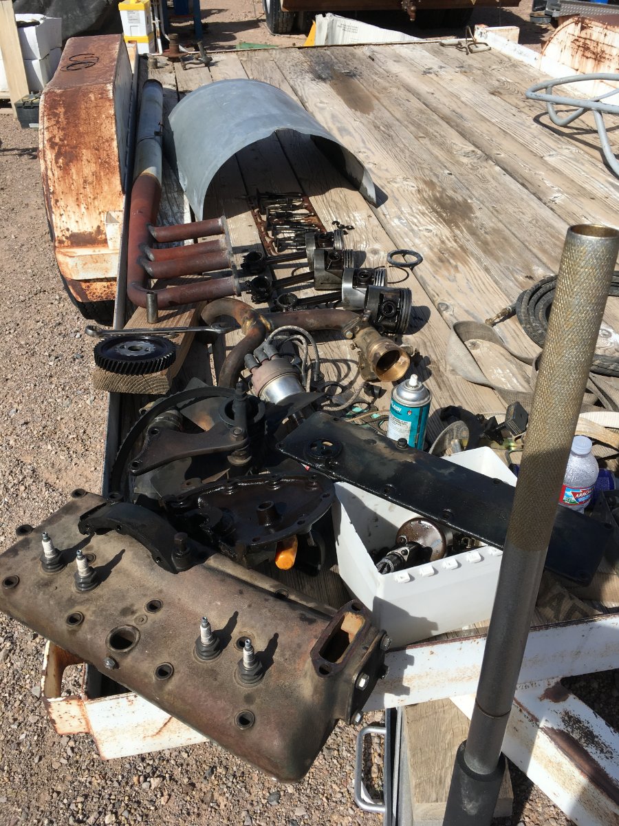

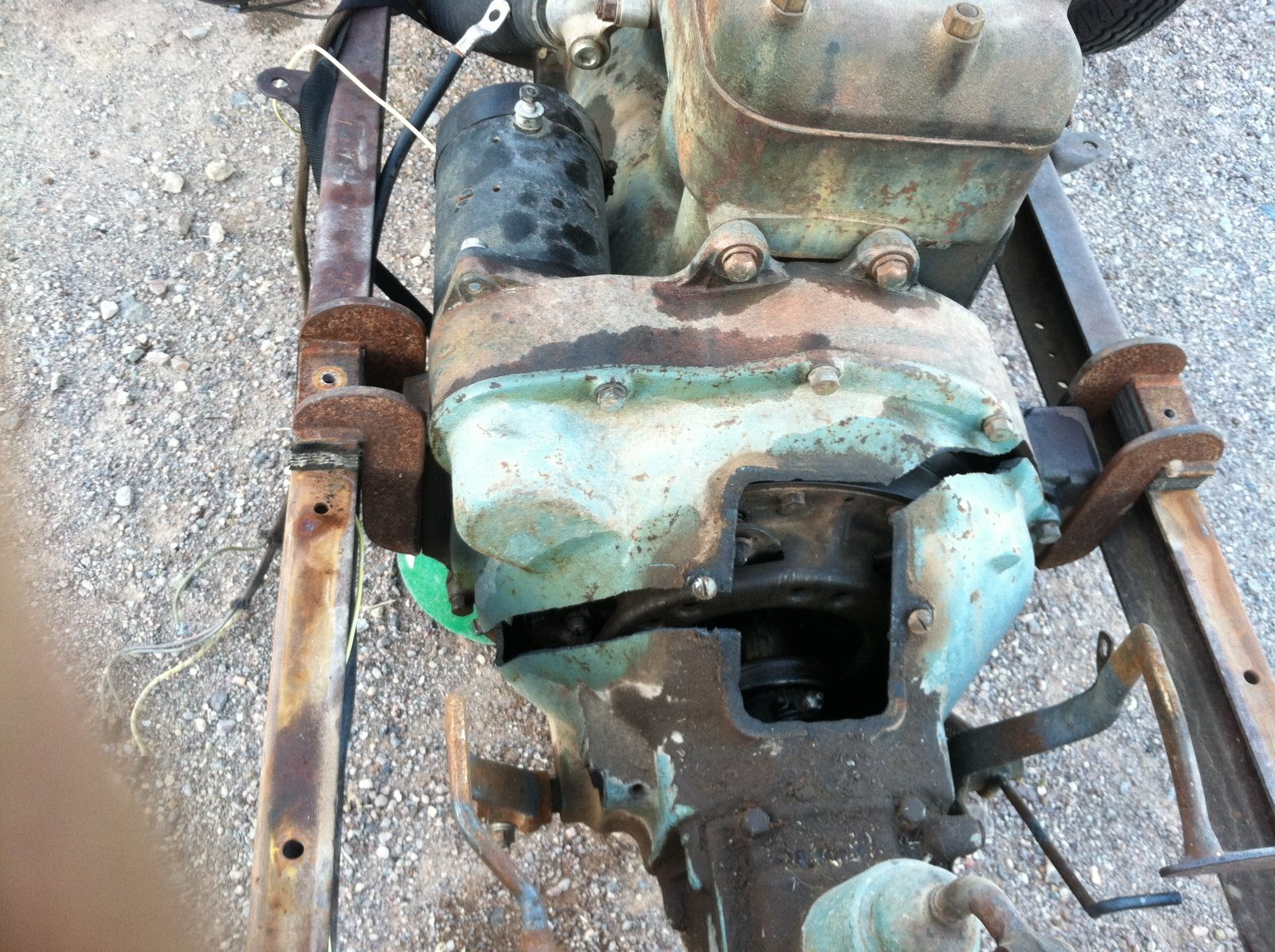

OK , I have to have an engine! Where on earth can I find a model t engine? I start looking on craigs list and finally find this after a couple of months. I better get it because I haven't seen anything else closer to a model t engine. Wanted $700 so I offered $500 and he took it, so I guess this is close enough for now.

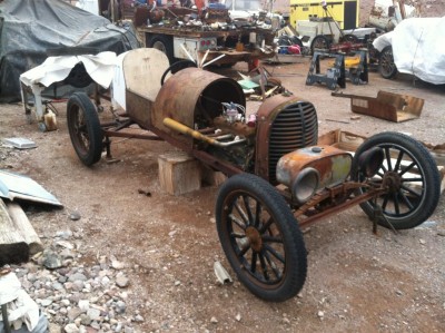

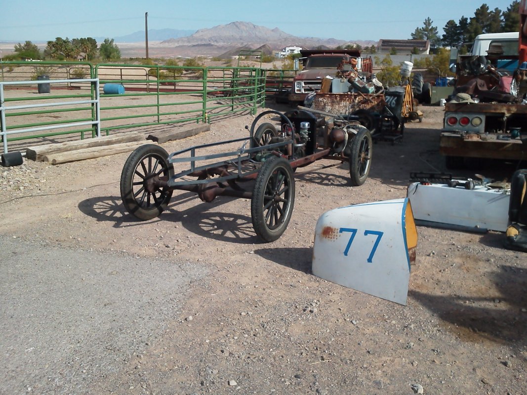

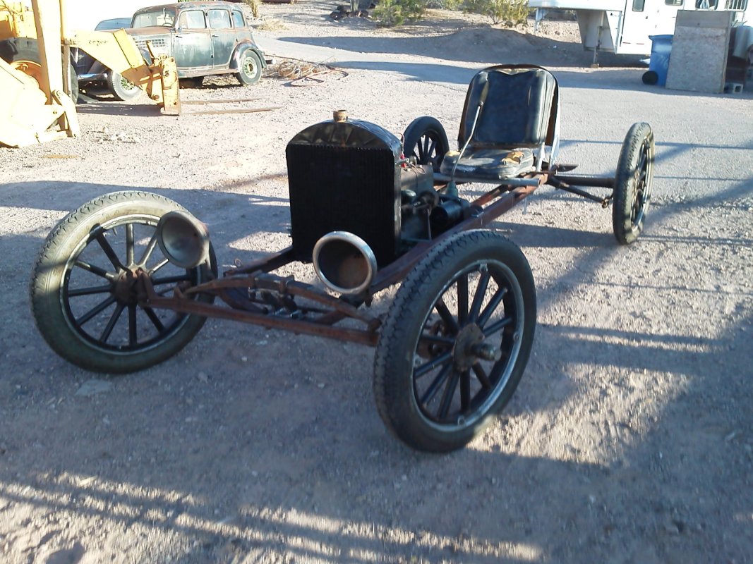

Post by John Warren » Sun Jan 06, 2019 8:12 pm

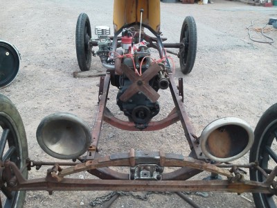

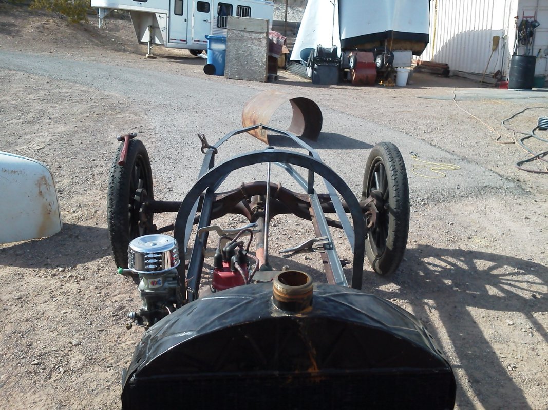

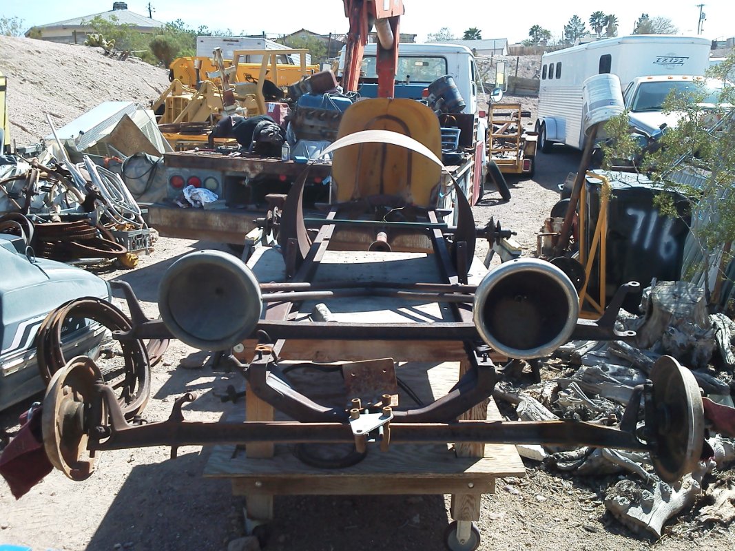

Time to start building.
Now to start laying it out.
John Warren
Posts: 1070
Last Name: Warren
Location: Henderson, Nevada
Re: Race Car Project

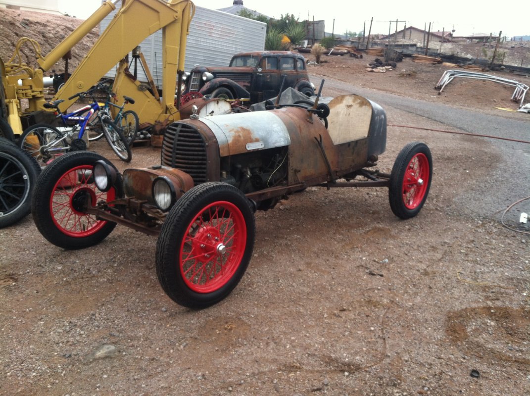

Post by John Warren » Sun Jan 06, 2019 8:41 pm

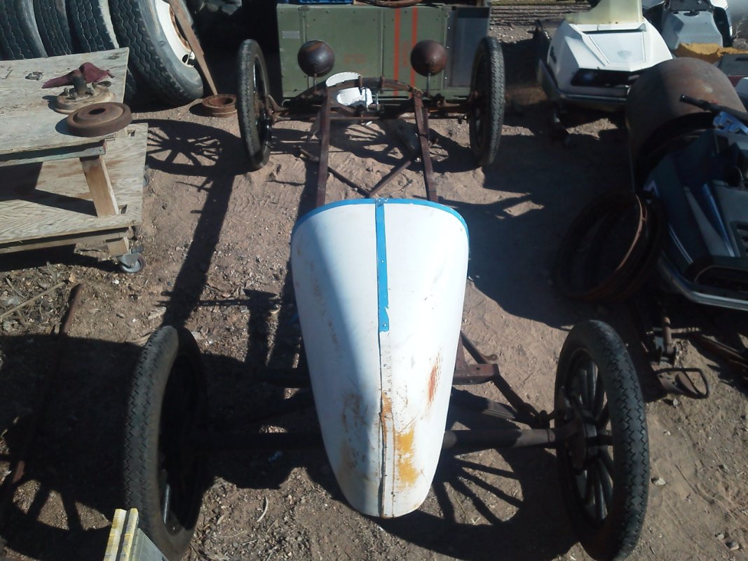

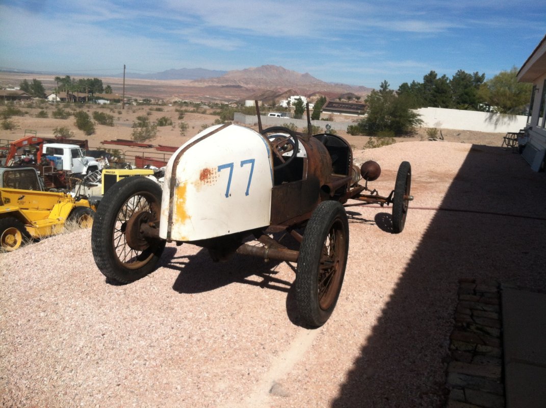

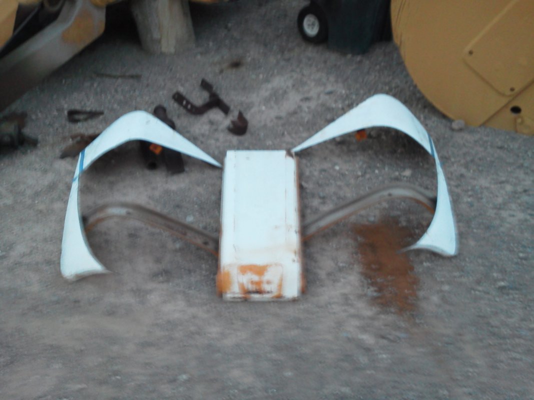

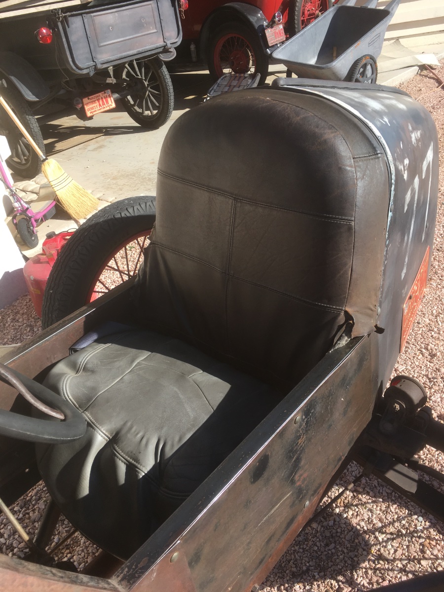

Now I need to build the tail hmmm...
Many of you may recognize this, it made a fine race car tail!
Harry Lillo
Posts: 327
Joined: Fri Jan 04, 2019 10:18 pm
First Name: Harry
Last Name: Lillo
* REQUIRED* Type and Year of Model Ts owned: Speedsters, racers, depot hack, coupe
Location: Calgary
Post by Harry Lillo » Sun Jan 06, 2019 11:32 pm
What year is the engine? Looks a little later than a T engine?
I like your tail section.....

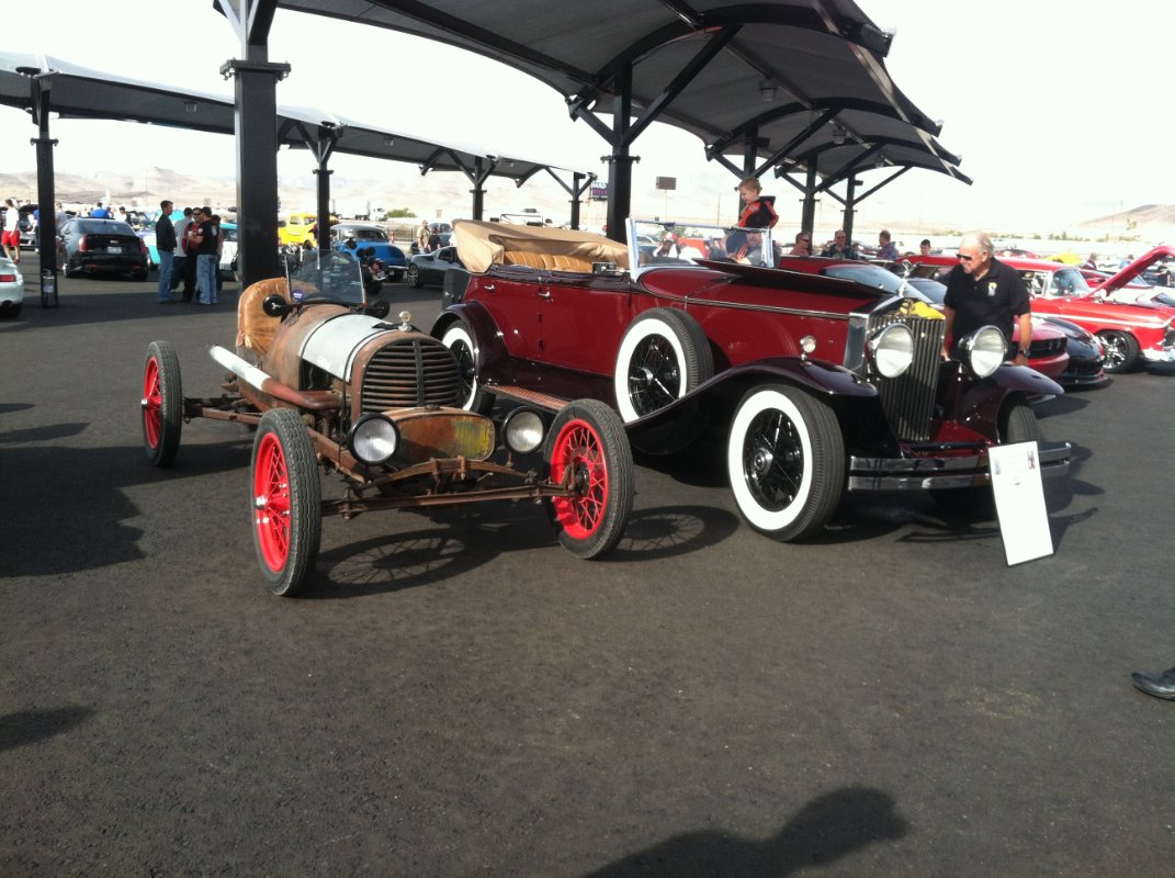

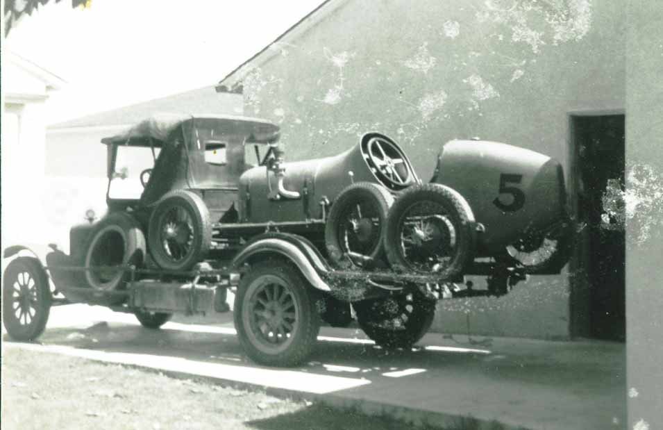

Post by Rich Eagle » Mon Jan 07, 2019 8:37 am
That is a great project. I will enjoy seeing the progress.
The third picture was when it was only a pipe dream. ;O{

Post by John Warren » Mon Jan 07, 2019 8:58 am
Hi Guys, The engine is a ford model A 1928 design. Good one Rich. :lol:

The tires behind the dump truck will add a little class to the project.

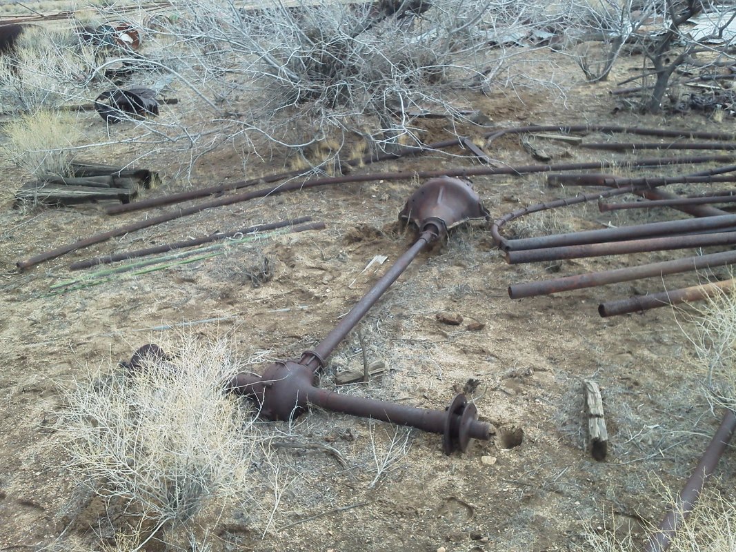

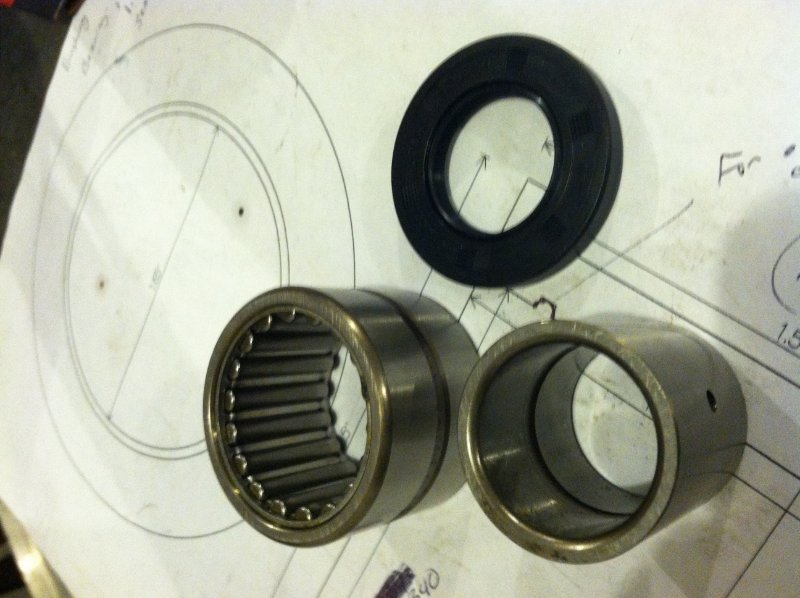

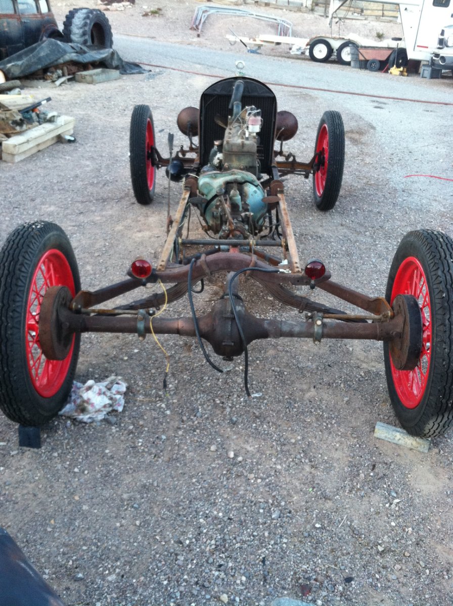

Post by John Warren » Mon Jan 07, 2019 7:38 pm

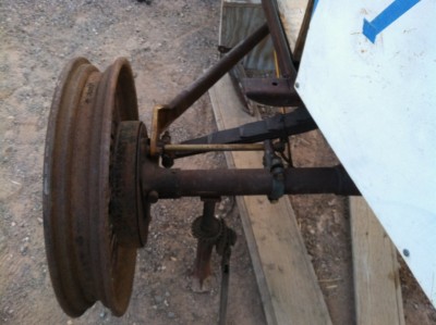

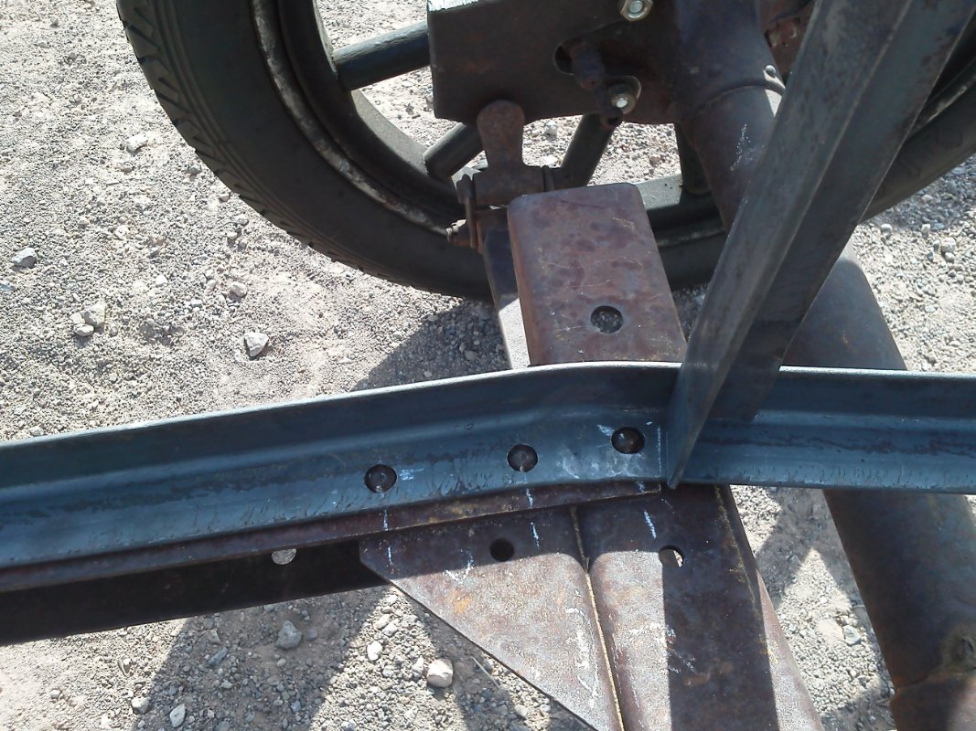

The rear end is a hybrid , Large drum model t with the model A tube grafted where they were the same size and I used a model A drive shaft and cut it to fit the model t pinion and it has opposing timken bearings for the pinion.
John Warren
Posts: 1070
Last Name: Warren

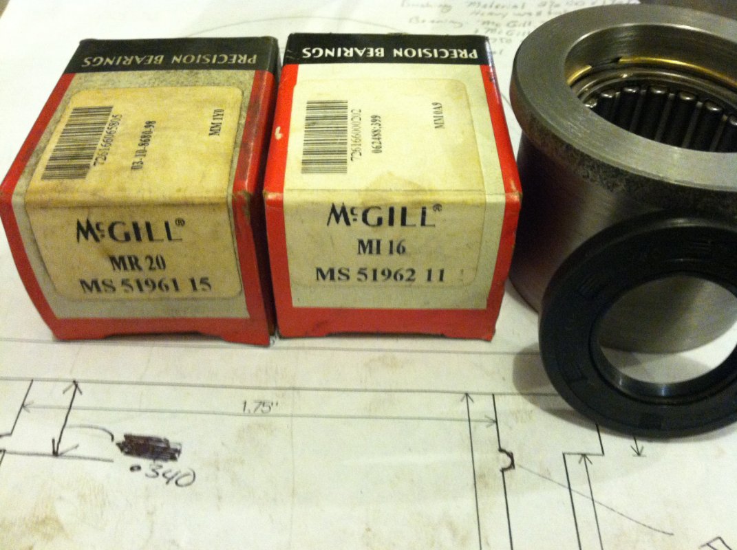

Post by John Warren » Mon Jan 07, 2019 7:48 pm

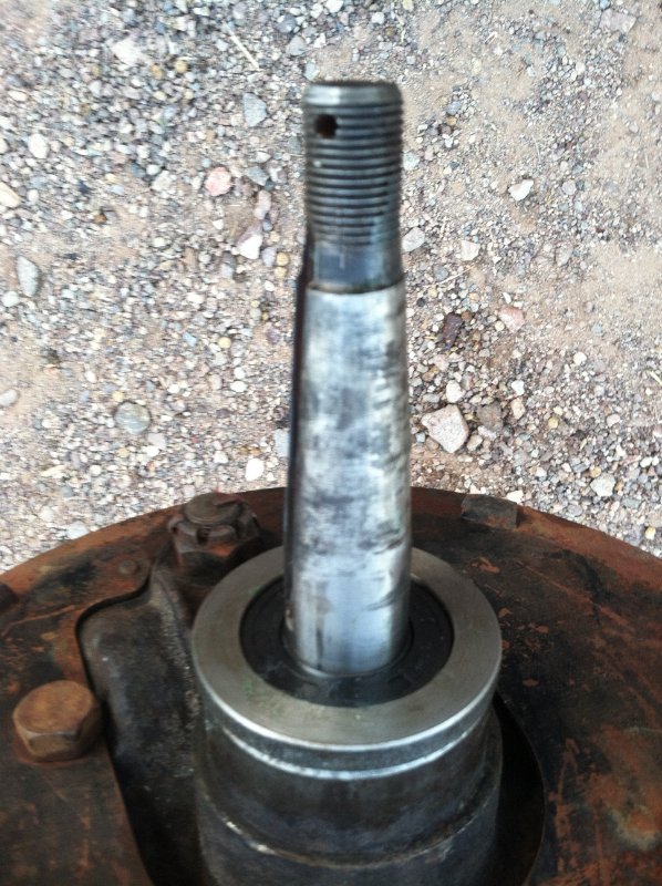

It has McGill needle roller bearings and a seal for the axle shaft bearings fitted into a machined bushing.

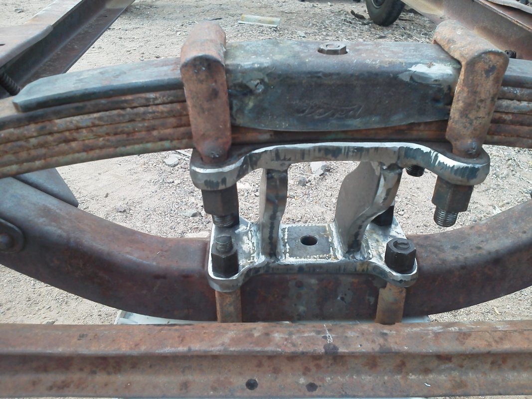

Post by John Warren » Mon Jan 07, 2019 7:56 pm

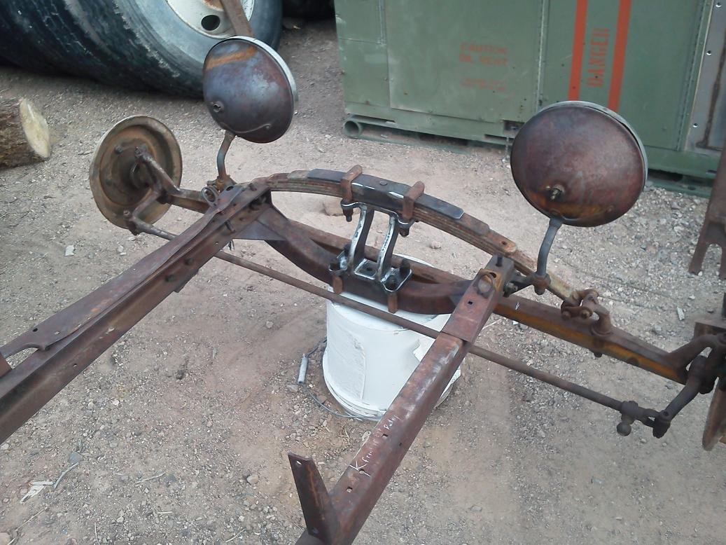

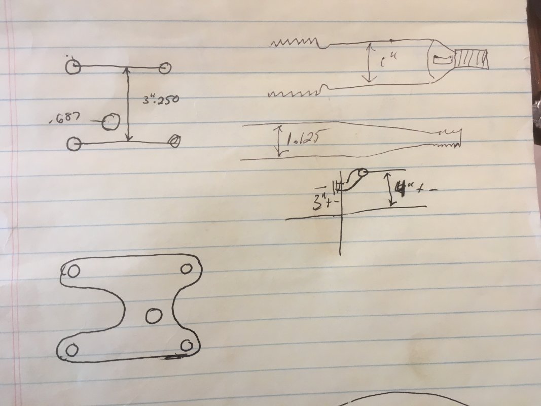

On the previous photos you can see the new mount plates for the radius rods and spring perch. The drive shaft is short because I moved the engine towards rear about a foot. The next photos are of the drop mount for the front end.
Posts: 4082
Post by Jerry VanOoteghem » Mon Jan 07, 2019 8:10 pm
Do the McGill needle bearings ride directly on the axle shafts? If so, you may not like the result...

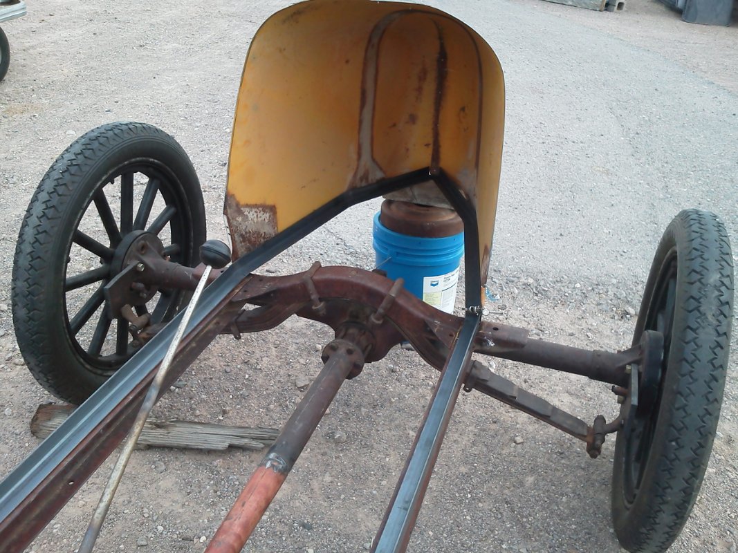

Post by Tim Moore » Mon Jan 07, 2019 8:29 pm
I am concerned with your front lowering system as it is like a step ladder with no steps. That is a big drop and even if the welds hold there will be constant stress with each bump and turn. Eventually it may fold over left or right. You could plate or box the lowering bracket in the rear or both front and rear for MUCH more strength. I am no engineer but have been down this road and the front end will take lots of abuse constantly being pushed with any forward movement and trying to sway side to side. The period correct lowering brackets were always a full plate in the vertical axis. The horizontal axis should be stabilized by the wishbone or radius rods if in double configuration (recommended so it can't fold over). That looks a little scary too me.

Post by Tim Moore » Mon Jan 07, 2019 8:34 pm
I am afraid one big bump on a turn or a curb and the axle will fold over to the side.

Post by John Warren » Mon Jan 07, 2019 8:58 pm
Jerry, the needle bearings have a inner race pressed on the shaft. Tim they may look flimsy , but they are very strong. 1/2 T1 steel welded to 100%.

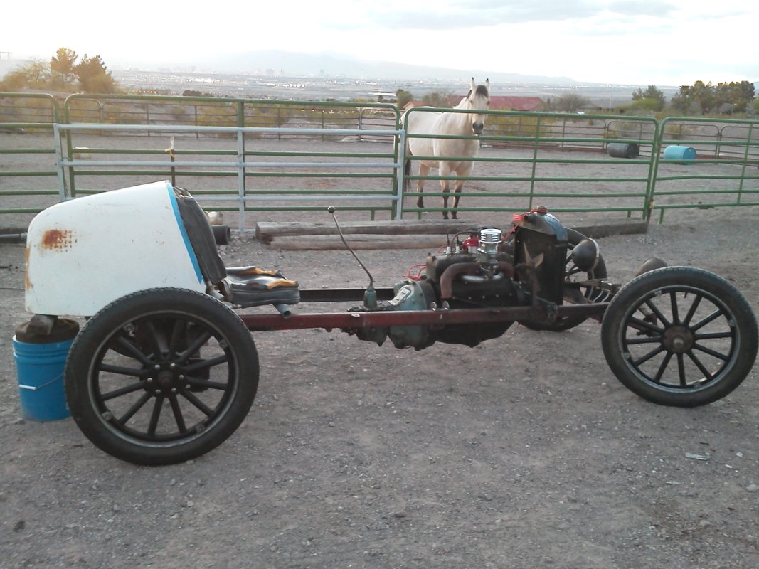

Post by John Warren » Mon Jan 07, 2019 10:11 pm

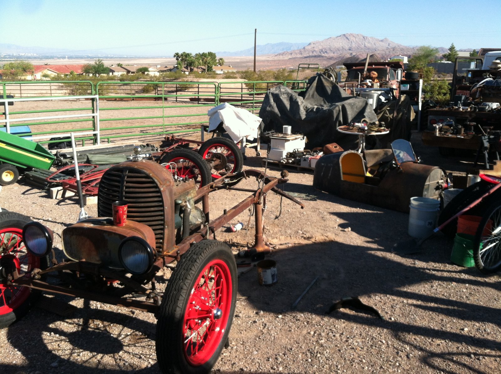

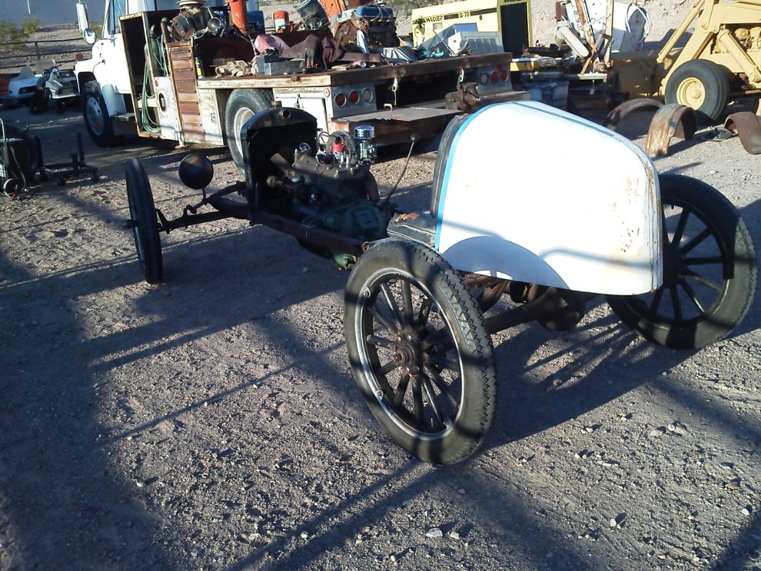

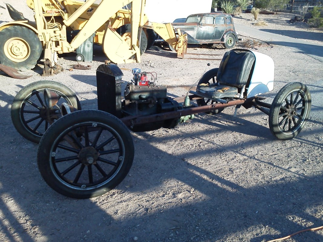

Time to put some tires and wheels on it so I can roll it around. The rear axle (small drum)in these photos was just to mock it up. The grafted torque tube is the one I used.

Post by John Warren » Tue Jan 08, 2019 6:47 pm

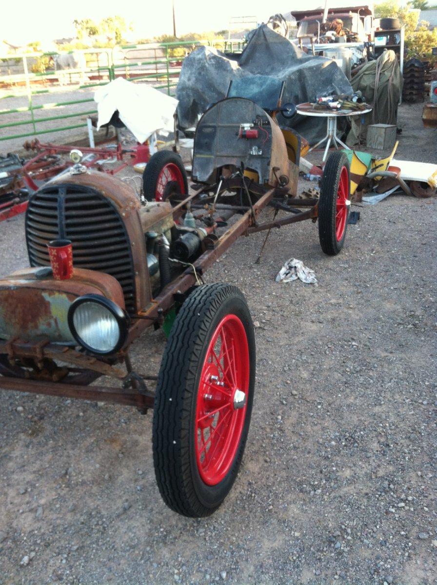

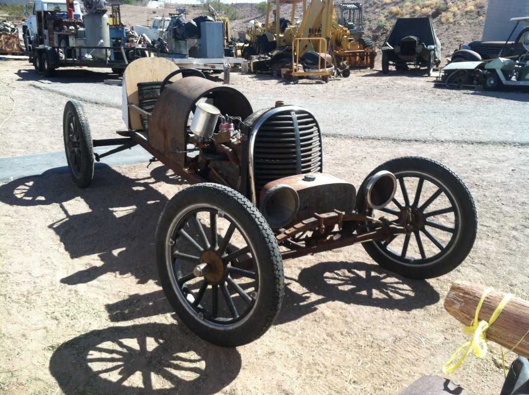

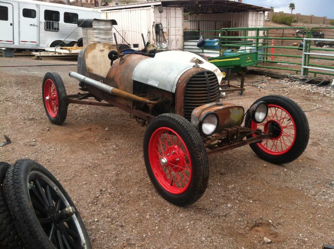

With the engine set in place, she is starting to look like something.

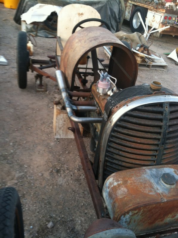

Now to start building a frame for the body. I used 1-1/4 X 1/8 angle iron.
The hoop is for the firewall. It is heat formed to a circle that was drawn on a piece of plywood.

Post by JSteele » Tue Jan 08, 2019 8:09 pm
I agree with Tim, your suicide front end may truly be a suicide front end. Looks neat but I think you need some gussets or bracing of some type.
Ruxstel24
Posts: 2345
Last Name: Hanlon
Location: NE Ohio
Post by Ruxstel24 » Tue Jan 08, 2019 8:15 pm
I hear what you guys are saying, but I don't see a big issue with the front spring. It doesn't contact all that much in the center, when mounted stock up in the frame...

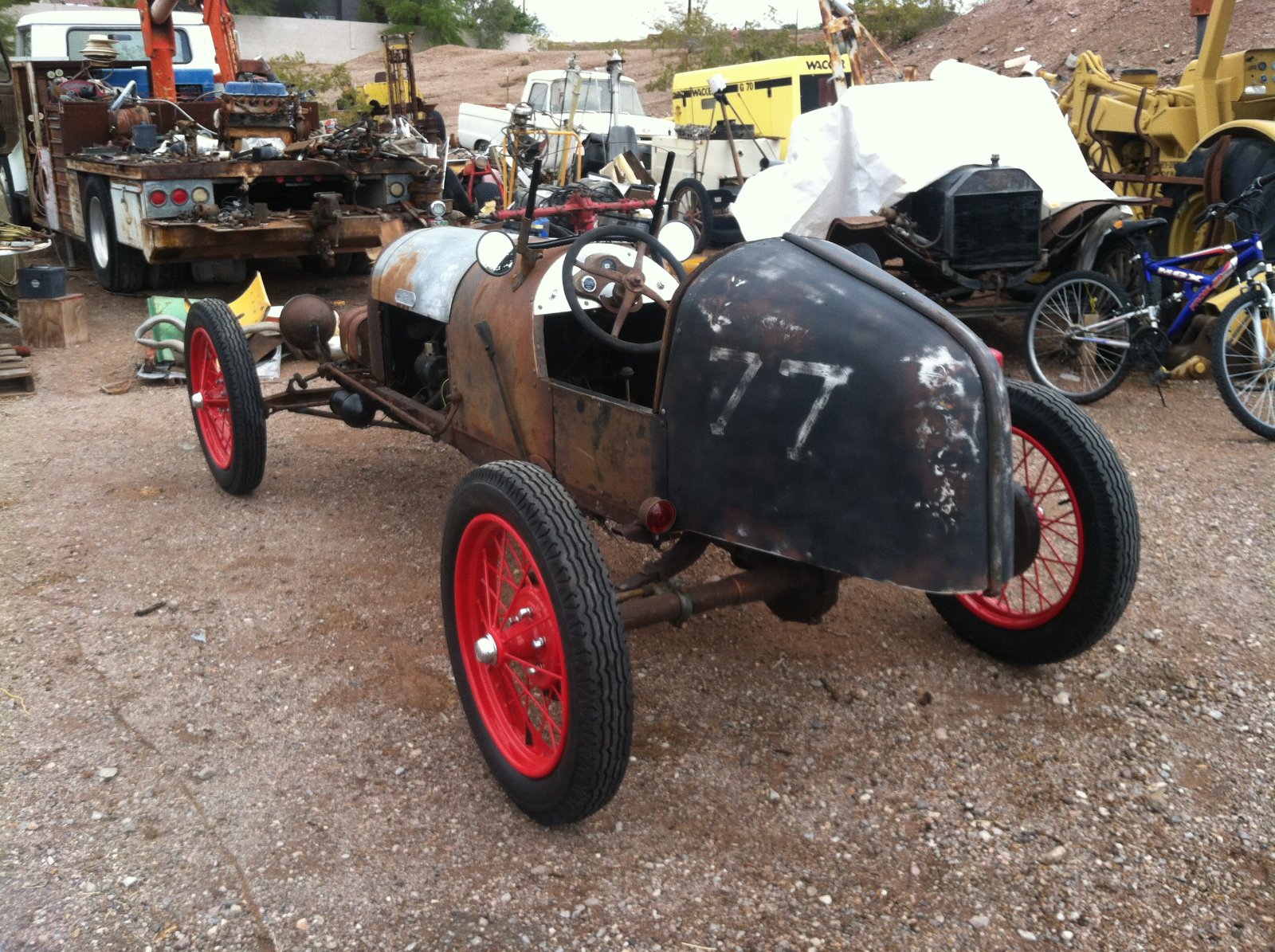

Post by John Warren » Tue Jan 08, 2019 8:30 pm

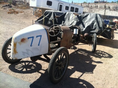

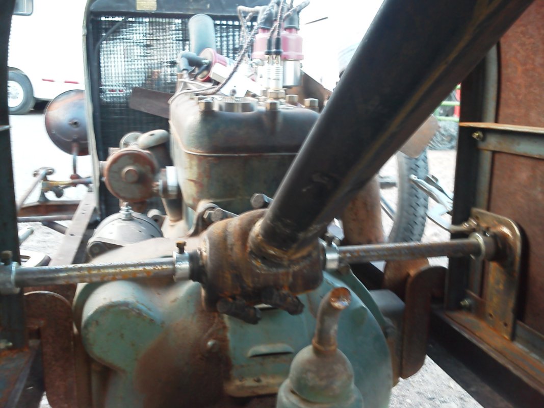

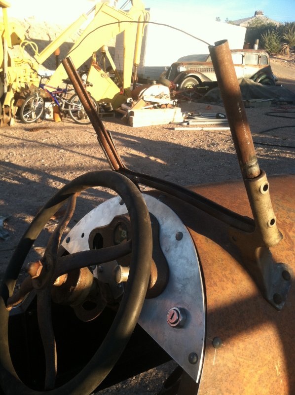

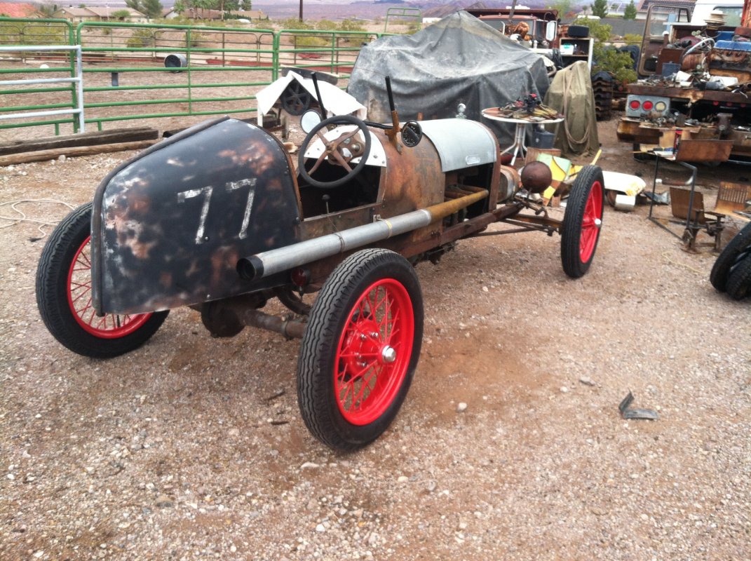

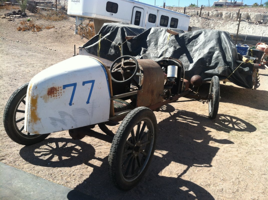

I couldn't help my self, It had to have a number.
I added the cowling former and steering system.

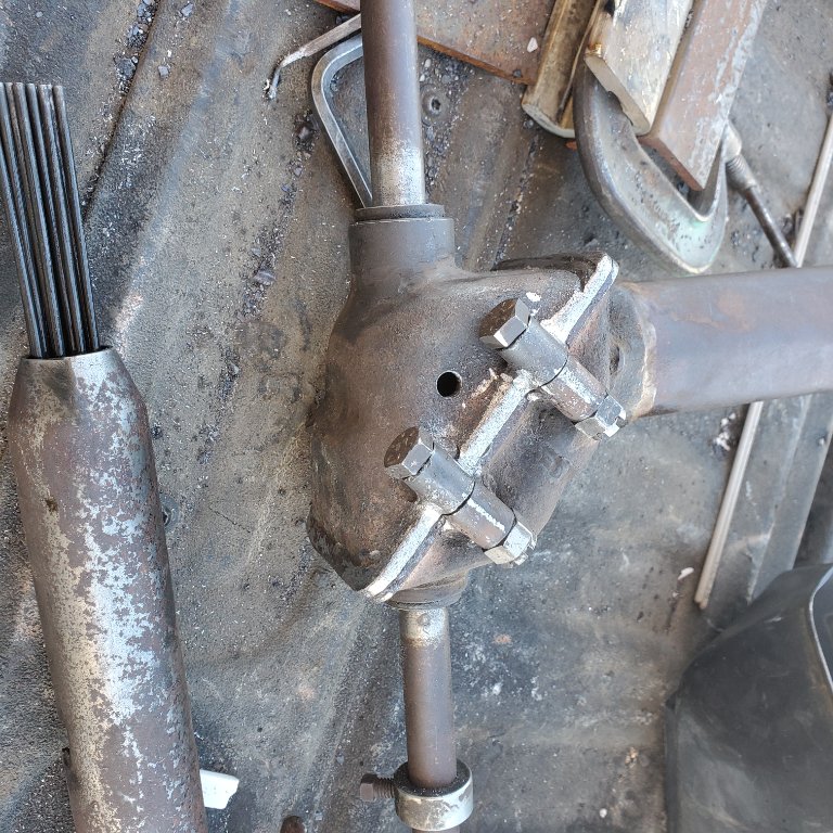

Post by John Warren » Wed Jan 09, 2019 1:01 am
[/attachment]

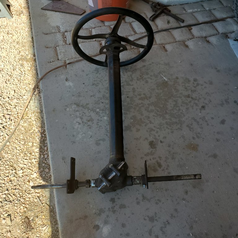

The steering sector was made from a model T column.

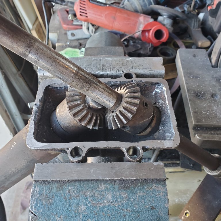

I built a right angle gearbox using miter gears.

I found a gas tank and a grill that I like.
Started working on the brakes. Built long S cams and pivot bearing brackets, and installed model A radius rods

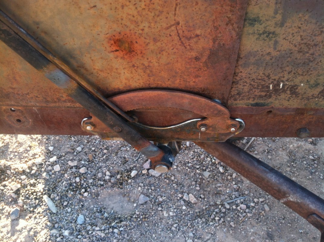

This is how I mounted the emergency brake, it is tied into the service brakes with a slotted arm.

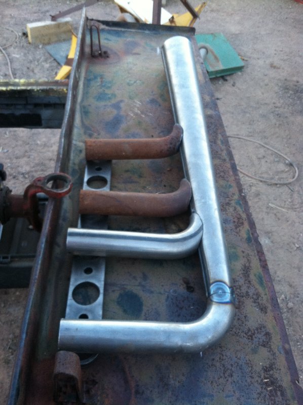

Post by John Warren » Wed Jan 09, 2019 8:37 pm

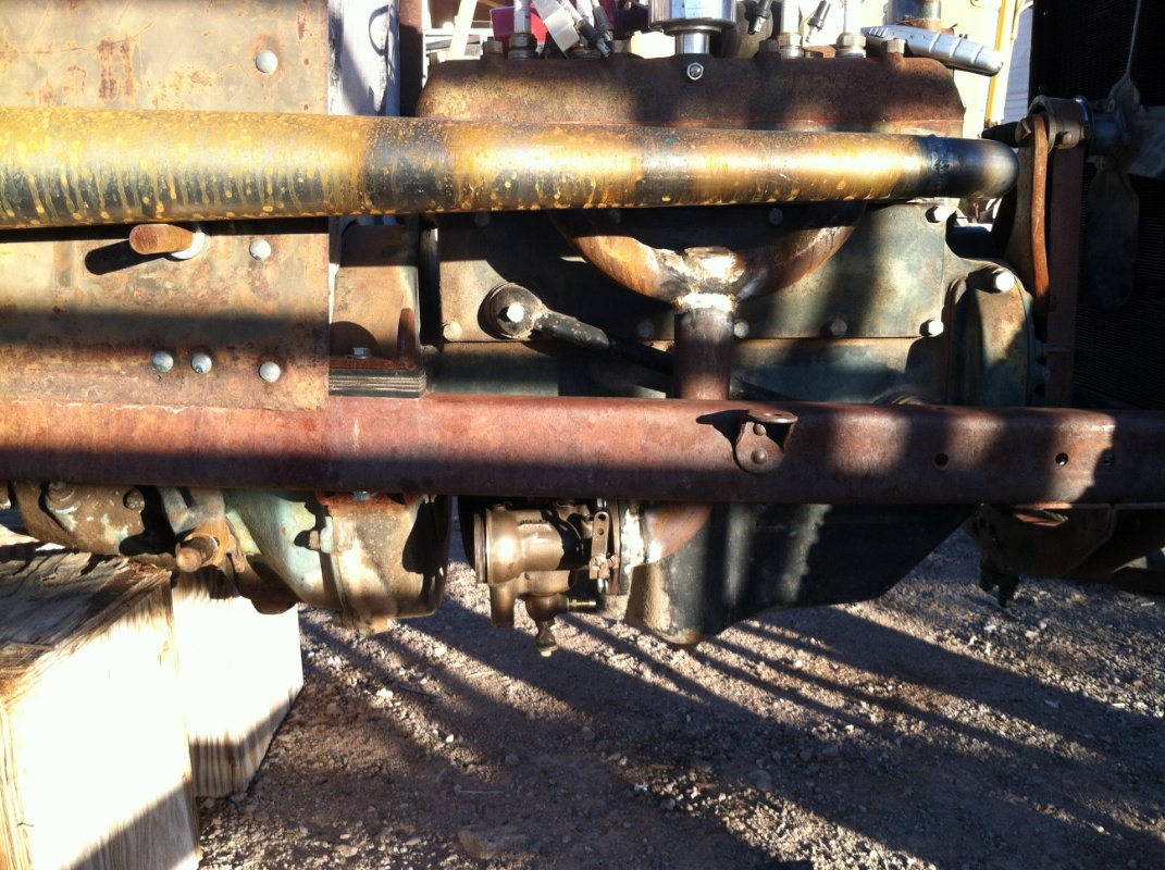

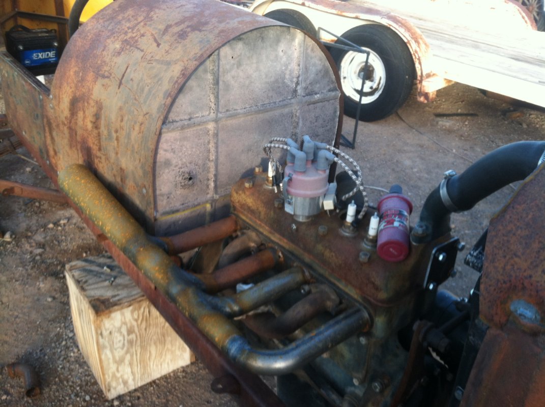

Started building the exhaust header.

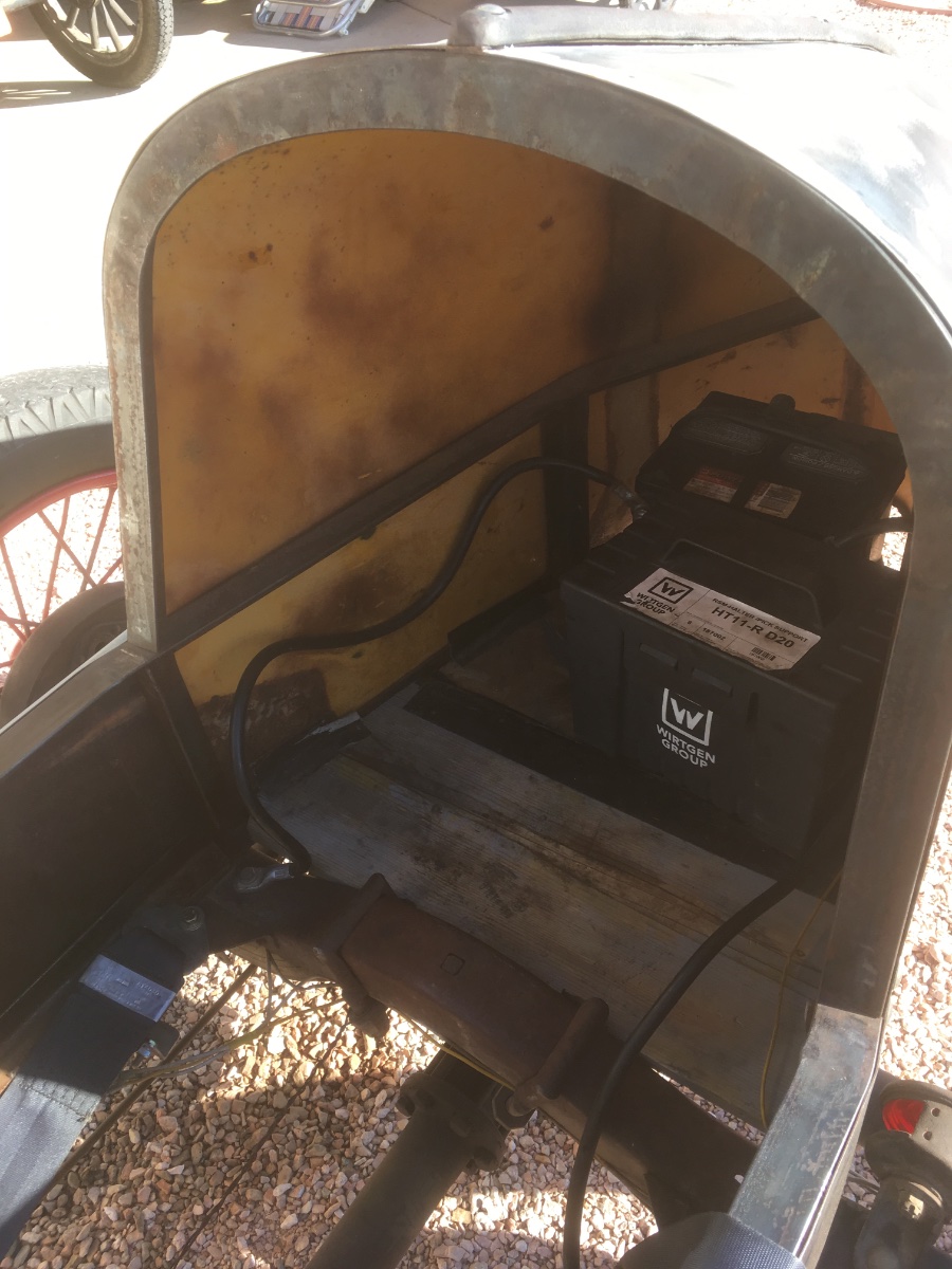

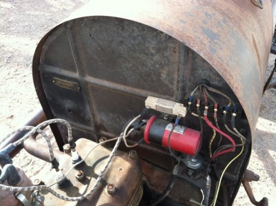

Post by John Warren » Wed Jan 09, 2019 8:53 pm
fabricated a firewall and installed the  carburetor

Post by John Warren » Wed Jan 09, 2019 9:16 pm
Wiring and vin numbers

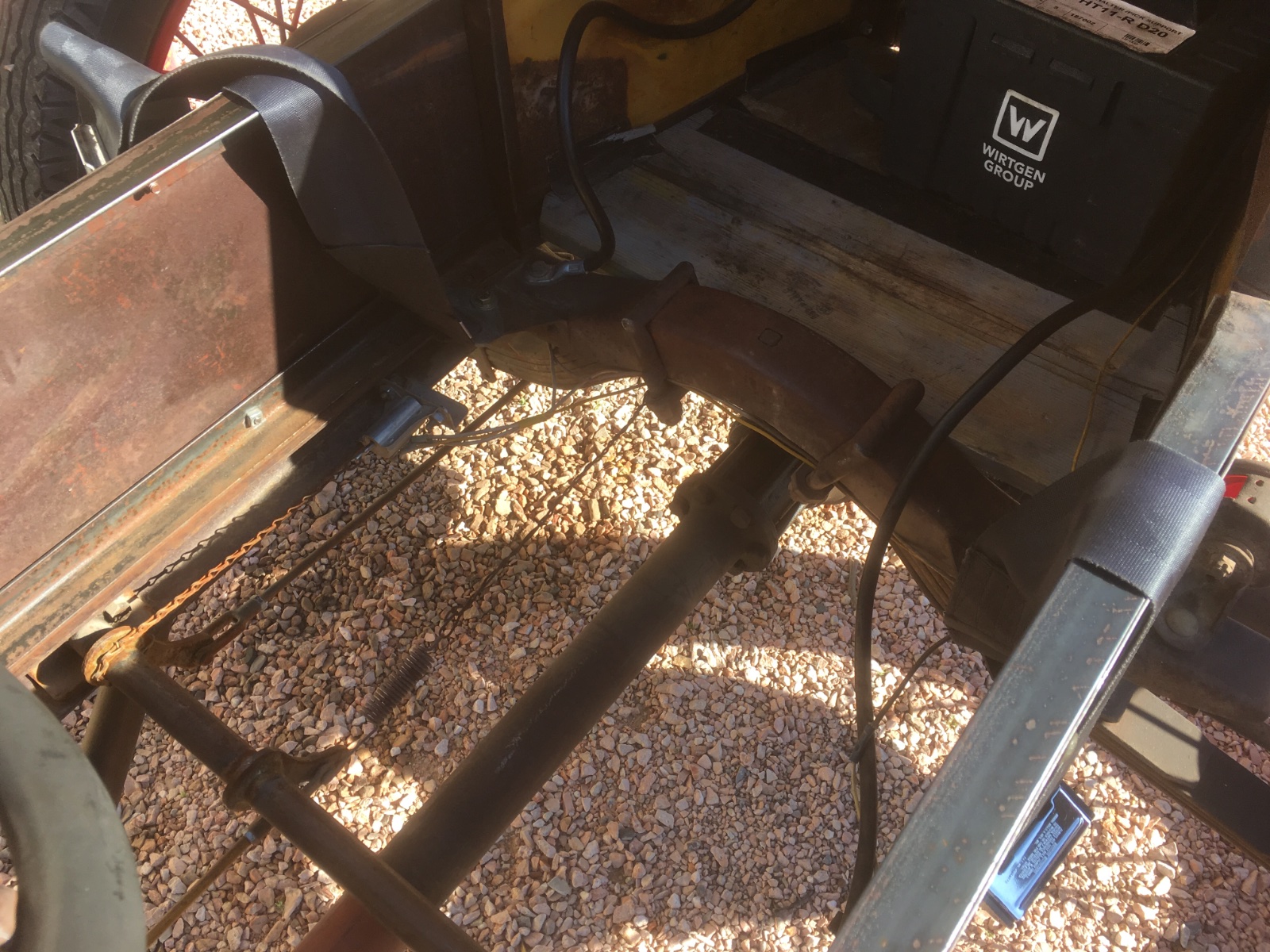

Post by John Warren » Wed Jan 09, 2019 9:23 pm

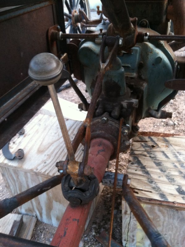

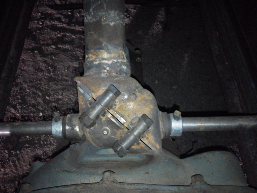

This is how I moved the shifter back. Here is a use for loose u-joints

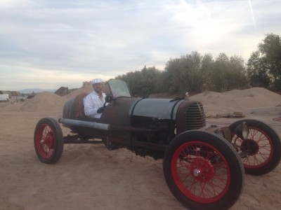

Post by John Warren » Wed Jan 09, 2019 10:04 pm
Dash panel and windshield
A visit from the local wildlife :0

Post by John Warren » Wed Jan 09, 2019 10:12 pm
Well It runs and it is loud!!
Added the pipe and small silencer plus painted (sorta) the back.

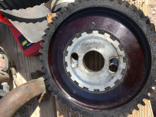

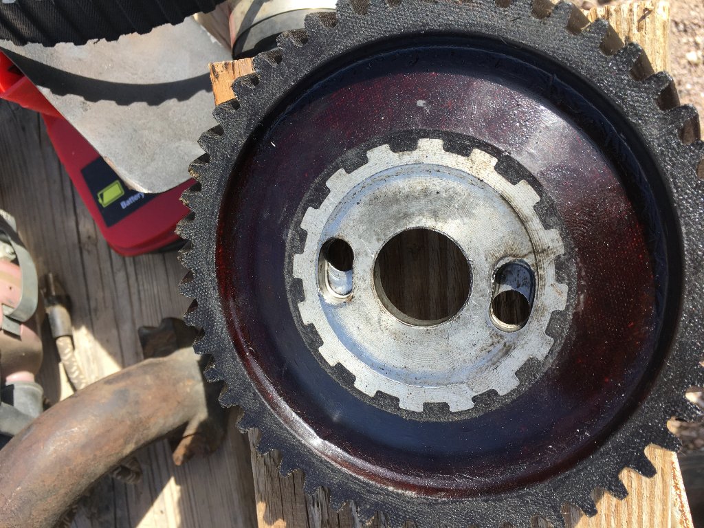

The engine wasn't running well, This is what I discovered, someone installed the valve guides from top instead from the bottom. It is a two piece valve guide that the spring keeps shouldered up in the valve cover, it is not suppose to be in the port held down by gravity and the valve banging it back down. :(
Not really showing how they are suppose to be, but a good  photo.

Well much closer to tour time. It has taken me three years to get it to this. New tires, wheels blasted and powder coated, new caps and lugs.
[/b]

Have any of you had any trouble loading your speedsters/race cars because they are lowered?

Post by katmankingkat » Tue Feb 26, 2019 9:58 am
Looks like a couple of Polaris sleds in the background. 75 TX? Maybe a cat in foreground.

Post by Shane Lach » Tue Feb 26, 2019 2:10 pm
Use a straight ball mount vs a drop mount. also, drive the rear wheels of the tow vehicle onto ramps and it will lower the loading height. Backing up to a hill also helps.

Post by John Warren » Tue Feb 26, 2019 8:31 pm
Well this is what happened to me the second time I loaded it( are grown men allowed to cry?). The first time I was in a small dip that flattened out the ramps and all went well and it looked to have plenty of clearance, the second time the ramps were steeper and holly shi_. The car bottomed out on the transmission best I can figure and when the bell housings broke in half, it went full throttle and things got quite exciting for a few micro seconds. Some how I was able to stop it before it ended up in the truck. Whewww. This happned a couple of years ago and now I use several ways to flatten out the ramps. I have pulled the back of the truck up on blocks that works well (my wife's idea) otherwise I find a dip to pull in. I like the curved ramps Idea, as far as changing the tow height, I do use a higher tow ball. That happened on Saturday on the first tour. Bill Mitchell in our club had some spare pieces and by Sunday it was back together. It was a very long day. Denny Rutkoskie, in our club has had a few woes because his speedster is low also. Any body else?
Rob, I do have to do some work on it, the engine is pretty tired and I have a few loose bearings that I am currently adjusting. Two years ago, just before I left for Lincoln, I did a quick inframe. I need to fork out the $$ and have Ron Kelly go through it. One way or another I'm planning on coming, gota see the new racer you know. :o

I needed to work on the engine to be able to go to the speedster reunion in Lincoln Nebraska in 2017. So I did a quick inframe. I adjusted the bearings, honed the cylinders, new valves and pistons, cam and lifters and a better head. As you can see I had to do the work in the back yard. Some day a Shop!!

Send me some pics of your seat, that was my first apprenticeship at 14. You would problem want an old style tuck pleat with snaps, correct?
Email hankpattylee at bellsouth dot net

Post by John Warren » Sat Mar 16, 2019 7:41 pm
Hank
Here is what I currently have. The back is also pulled forward to access the battery and storage. The bottom just sits on the frame. I know there is a better and nicer way to do this. One original thought was to do a drop in with snaps kinda like we use to buy for our sandrails. Any help would be greatly appreciated. Thanks

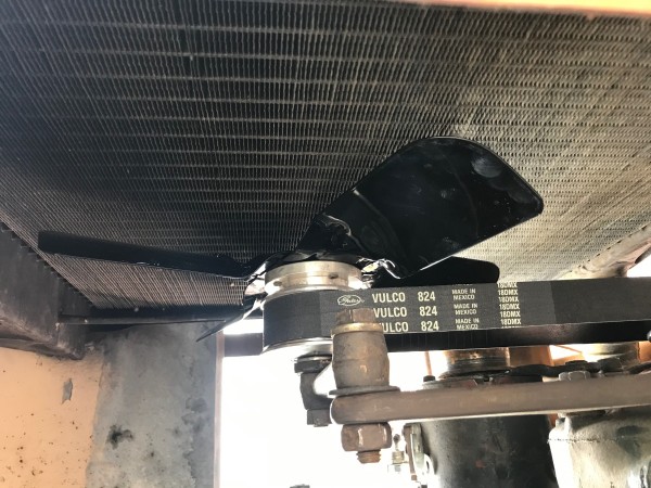

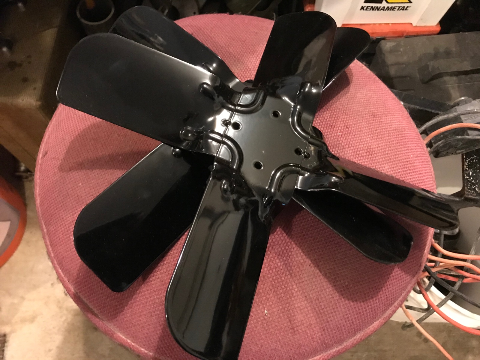

Post by John Warren » Fri Mar 13, 2020 8:11 pm
Threw a blade off my fan then broke the opposite one off to get back home. Just a heads up guys. I was very lucky that it didn’t go through the radiator. This fan was looked at very carefully when I built the car. I had one come close on my 26 touring. When I checked on a new one I almost fell off my chair. $12.50 whattttt!!!! I purchased three, one for all three cars. 😎
Posts: 4249
Post by Wayne Sheldon » Fri Mar 13, 2020 8:57 pm
Twelve fifty for THOSE!? Sounds like a bargain.
Glad the damage wasn't severe.

Post by John Warren » Sat Mar 14, 2020 8:47 am
Like I said Wow Cheep no reason to not get a new one. Thanks Wayne I should have started a new post about fans.

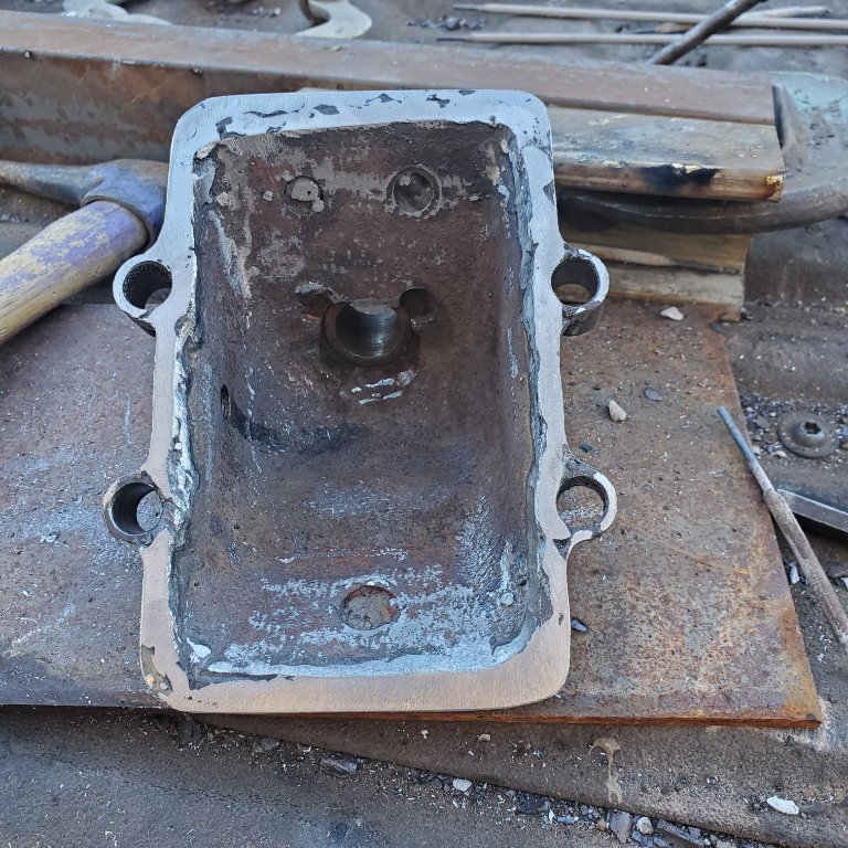

Post by John Warren » Sun Feb 14, 2021 10:00 pm
I recently took my steering sector apart for inspection and I always wanted to seal it up better so I could fill it with grease. Here are a few photos of how it is built
using some miter gears. The housing is made from some forged engine frame mounts, they looked the part. The shaft was cut and the left over piece was used as the cross shaft. Side support bearings added. I used a brass back up plate during the welding process to make a sealing surface ( shiny part) the bolts are fitted like dowel pins to locate the two halfs.
Just sharing for those that may be interested.

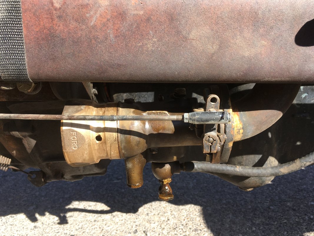

Post by John Warren » Mon Feb 15, 2021 10:46 am

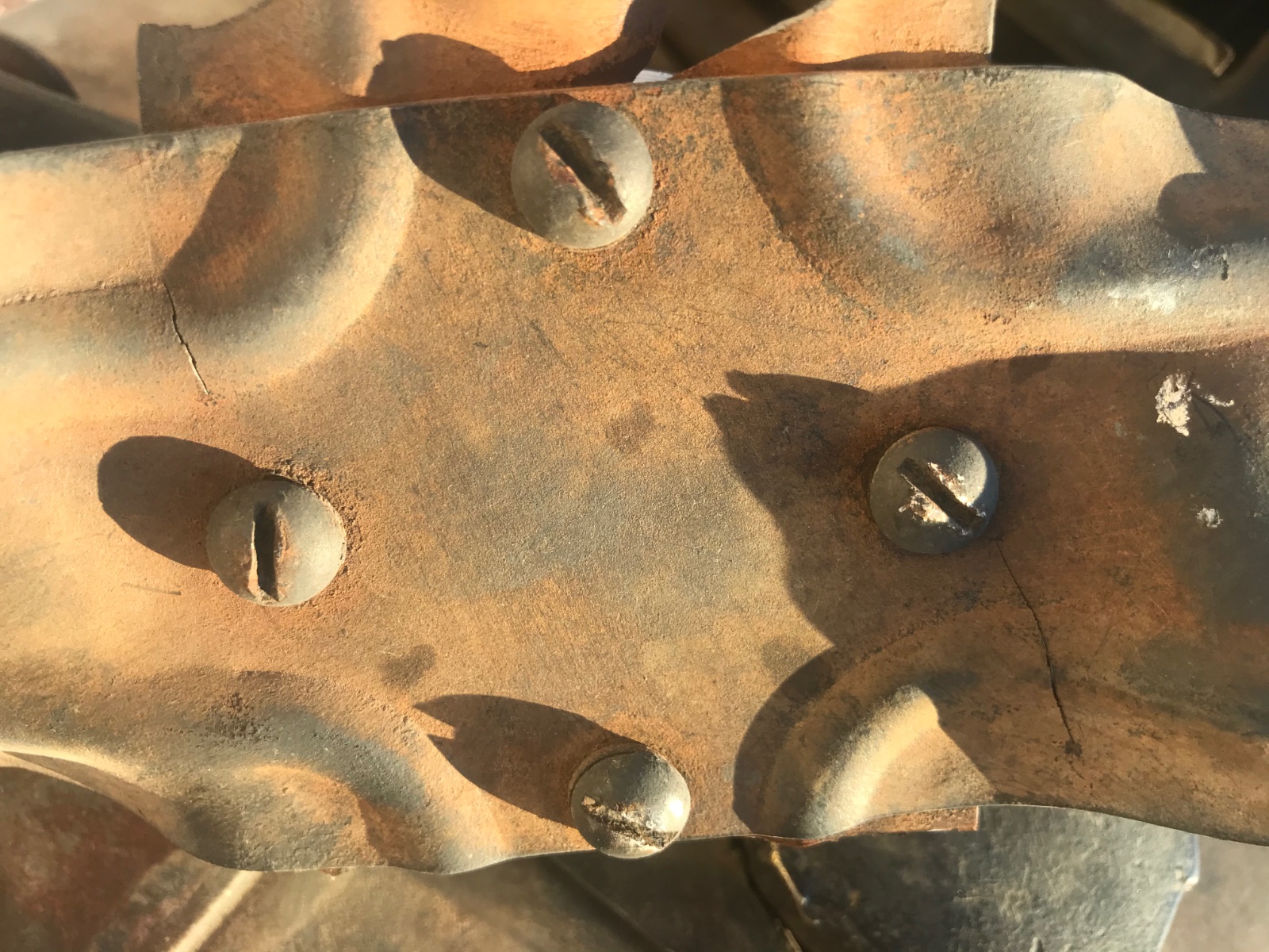

Things that make an engine run bad!

Post by Kevin Pharis » Mon Feb 15, 2021 1:41 pm
Wow! That’s more than a few degrees retarded...! You must have noticed it running and sounding more and more like a tractor as this was happening...? Was the cause a loose cam gear nut...?
I used a brass back up plate during the wedding process...

Post by John Warren » Mon Feb 15, 2021 5:03 pm
Kevin, Oh ya, It wasn't running very well, Clattering like you said obviously running retarded.... The cam nut was loose and it was missing the cam thrust bearing and spring. I talked to God that day and assured him that I would overhaul it before I would drive it again if he would let me make it back home. True to my word, it came apart and was repaired!
