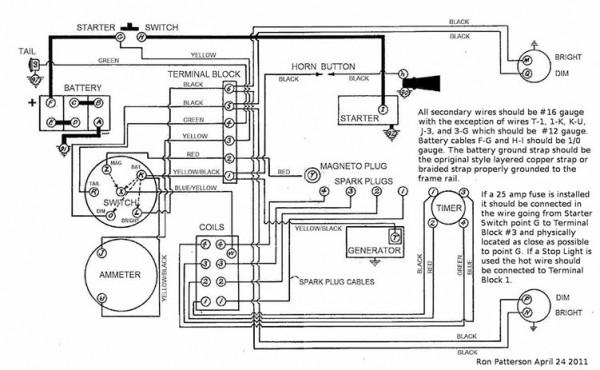

I got a wiring diagram and a complete wiring kit from Lang’s, it arrived today!

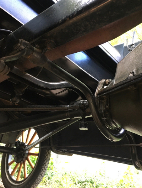

And yup, there are two grease cups on the driveshaft! I got a big tub of grease from Lang’s (also arrived today!) and I’m going to take the old grease out of the cups and put in fresh grease then push in as much as I can then repack them! Can’t wait to get my T registered with vintage plates and road legal! For oil I’m using Pennzoil 5W-30 Multi-Viscosity Detergent Oil. I didn’t get a fuse kit, guess that’ll be another order to Lang’s! I have my grandpa’s class ABC dry chemical Fire extinguisher from his ‘41 Continental (recharged) and I’m going to mount it on the running board for easy access in case of a fire! My grandpa was a huge car guy and I think he’d like that. 🔧🤗

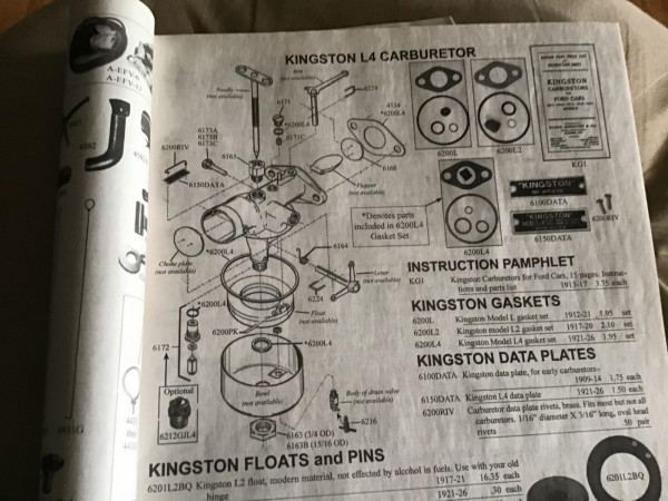

I ordered a catalog from Lang’s, the previous owner showed me his and it is invaluable for its exploded view of things! I also ordered a service manual and owners manual, as well as every MTFCA book about the T (axle book electrical book etc.). As for coils, my car came with 4 in the box and 1 spare in the under seat trunk, I got a coil/plug tester from Lang’s, and I’ll test them to see if they are working properly, it should be here next week.

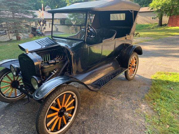

Attached is a picture of the car. Engine #6,484,060

A very nice looking Touring!!!

That car looks like a 23. It has a slant windshield and one man top. The change came somewhere toward the end of the year 1922. I have seen cars with a straight windshield called a 23 and some with a slant windshield called a 22. The year model was introduced in the fall for next year, but sometimes the cars were dated from the date forst sold so you will find 22's which were first sold in 23, and 23's which were first sold in the fall of 22.

Your car looks very good.

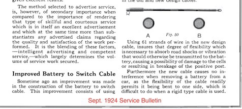

If you need new battery leads, with a 6 volt system it is essential that the correct heavy leads are used. Modern car leads available from the usual suspects are not up to the task. Others will be able to point you in the right direction for US sources.

Allan brought up something I meant to mention. With a 6 volt system you want the cables in the battery to starter circuit to be very heavy to reduce resistance loss - 0 or 00 gauge is common. Some guys even use cables designed for an arc welder. If you use what is available at the autoparts your starter performance will be sub-par.

Post by DanTreace » Mon Jul 20, 2020 12:16 pm
Correct on the heavy cables needed for good 6v storage battery function. Besides clean terminals and super clean contact point for the negative ground on the frame, be sure to use proper cables.
Even Ford realized the importance!

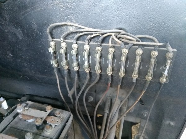

FUSE HOLDER LOCATION
Post by Novice » Tue Jul 21, 2020 5:00 pm
Install black in line fuse holder at or near fire wall electrical block. insert in the power wire going from terminal block to the foot switch battery side post. This gives easy access without crawling under the car to check or replace fuse. and a convenient place to disconnect power if You are working on the car. and the chance of a short in the heavy gauge three foot wire going between the terminal block to foot switch are slim and none. some folks don't use fuses since Henry didn't. I didn't either until first night I had the car turned on the headlight's and sparks flew out of the ignition switch could have started a fire but managed to turn switch back to off position and sparks stopped. But it got my attention! some use a fuse block and fuse several circuits others fuse everything with ten fuses like the modern cars do but I don't think that is needed the one fuse will protect in most situations. be sure electrical block screws are tight but not too tight are You will strip them out. If loose terminal will can get hot and fry wire end and discolor terminal lug. Don't fix it if it aint broke and then one item at a time so You don;t wind up with several alligators biting Your BUTT at the same time.
My 2 cents worth maybe less.

How would I find out what timer I have? I’ll remove it and maybe post a picture of it here and someone can tell me which one it is? I know there are roller timers and different ones like Anderson and new day timers.
I also turned the nuts on the bottom of my Kingston L4 carb and now the engine is backfiring. I thought the carb was flooded and I tried to drain it after removing the fuel line and the nuts just kept turning. What does the big nut and little but do on the bottom of the carb? I read the MTFCA book about the carbs and I can’t seem to find out about the little nut on the Kingston carb.

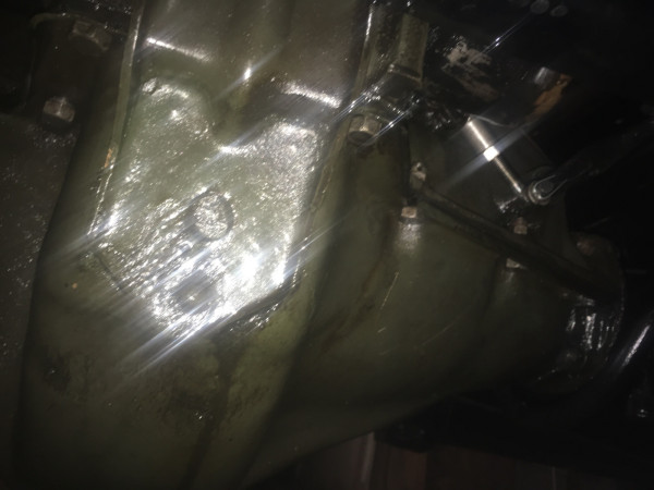

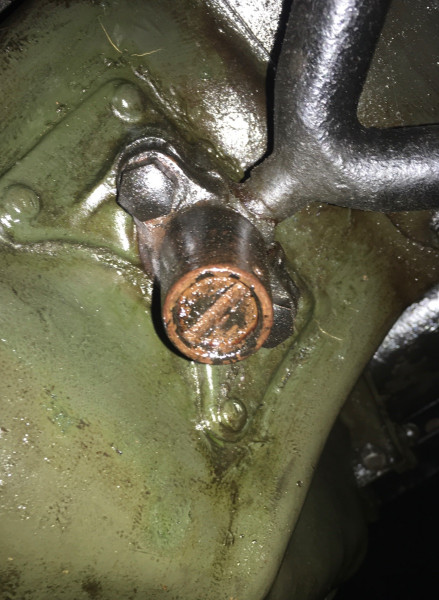

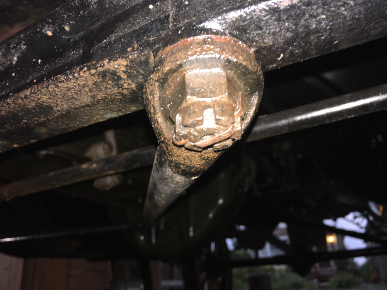

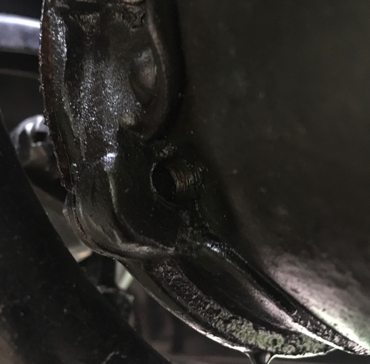

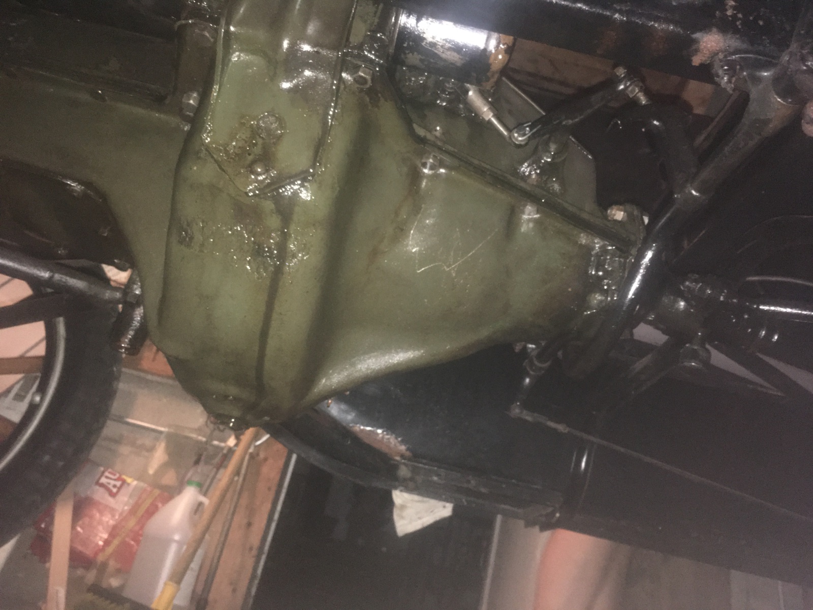

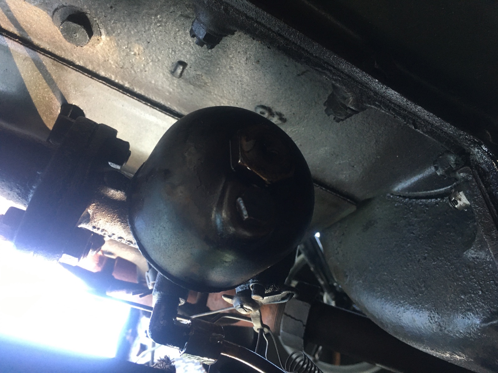

I’m also missing a bolt under my engine, which specific bolt do I replace it with?
Having trouble uploading pictures. :/ I’ll try and get some uploaded soon.

Here’s an exploded view of a Kingston L4. It may give you an idea of what the parts are for. Click on the pic for larger clear view. It’s from Lang’s catalog.

The bolt that’s missing is exactly the same kind that’s right above it. Not trying to be a smart ***** but the bolt is a fine thread like most of the other engine pan bolts. That paticular one is an all thread 3/8 24 x 1 1/2“ length but not exactly sure about the length.
Be sure when you replace it and be careful not to cross thread or strip out the threads that are in the pan that it screws into. The pan bolt holes can be stripped when putting the engine and drive shaft together if they aren’t lined up correctly.
You can see pans at swap meets that it’s happed to.

Post by RajoRacer » Tue Jul 21, 2020 7:59 pm
The "small" bolt on your Kingston SHOULD be a drain petcock - the large nut holds the bowl on.

Post by Jerry VanOoteghem » Tue Jul 21, 2020 9:18 pm
Its_Always_T_Time wrote:
Tue Jul 21, 2020 6:15 pm
You are NOT missing a bolt. I can see the the edge of the bolt head. What you photographed is a bolt hole that goes all the way through the flange. The bolt is installed from the backside and simply does not go all the way through.
I know you're excited about your car and that's really great, but slow down a bit and tackle one thing at a time!

Post by Oldav8tor » Tue Jul 21, 2020 9:21 pm
Looking at one of your photos it looks like the big grease cup on the drive shaft where the ball of the shaft tube meets the transmission hangs down which is opposite the way Ford did it. Some guys did this so they could access the grease cups without taking the floor boards up, but it does create a potential problem. If you flip the tube you need to remove a little material from the mouth of the ball or there may be some interference. Others can explain it better and it was discussed on the forum not that long ago. Hopefully the person who flipped it was aware of the issue and took care of it.
I don't see the smaller grease cup at all. It greases the bushing that the driveshaft runs thru. If it is missing you might want to replace it. More pictures would tell the story better.
If you remove the timer cover (you can leave the wires attached) and take a photo of the inside and another of the brush it will tell us what you've got. I have a New Day and it should not be oiled or greased. Some timers you do, some you don't. Timer problems can lead to sputtering and the like as can faulty coils, etc., etc.
FWIW - you're never done working on a Model T... you'll get everything running good and then something else will pop up... you learn to just smile and deal with it.

I’m going to take more pictures of my U joint from top and bottom then post them here to see how I can replace the missing grease cup. I plan on changing the thrust washers this winter (if they don’t decide to force me to change them sooner!) so when I do that job I might pull the driveshaft and see what’s going on inside it and flip it back the way it’s supposed to be. I thought that’s not how it’s supposed to go.
I’ll take a picture of my timer open and find out which one she has.
Also inspecting and taking a picture of the wishbone to see what you guys think of it.

Post by RajoRacer » Wed Jul 22, 2020 10:53 am
The grease cup pointing down IS the d.s. bushing greaser albeit a large one - can't see the u.j. grease cup.

Post by Its_Always_T_Time » Wed Jul 22, 2020 11:41 am
I only see one grease cup near there, I’ll take more pictures of it after work when I get home.

Post by Steve Jelf » Wed Jul 22, 2020 12:44 pm
Some folks use grease cups with Zerks inside so they can use a grease gun. I haven't done that with the small cups because using them as designed is no problem for me. The giant u-joint cup is another story. Arthur Itis told me to put a Zerk in that one. :D
I did the same thing. All of my grease cups and oil cups are factory stock because I think they're the cool old-school way of doing things. People at gas stations and car gatherings comment on them. They're neat.
But the big one for the u-joint....I replaced that with one with a hidden grease zerk in it because of the volume of grease involved. It still looks stock on the outside but it's way easier to use.

Not only should the cap on the ball of the wishbone be safety wired, the ball itself should not be loose in it's socket. They make shims for it but sometimes if it is badly worn, you may need to replace the ball and maybe the socket that is attached to the oil pan. Another subject to google :-)
If you're going to go thru the rear end then you'll be pulling the driveshaft at the same time. You'll want to look at the condition of all the moving parts. On mine, I replaced the driveshaft (it was scored) the brass bushing (mine was babbitt) the pinion bearing (with a new, modern pinion bearing from Birdhaven - strongly recommended) both axles (again, they were scored) changed to a 10-tooth pinion gear, replaced the outer hyatt bearings with floating safety hubs (won't lose a wheel if the axle breaks....less likely to break an axle) and added disc brakes for better stopping power. Whew.... Originally I just wanted to see if I had brass thrust washers but one thing led to another....... At least I know what I've got and can trust it.

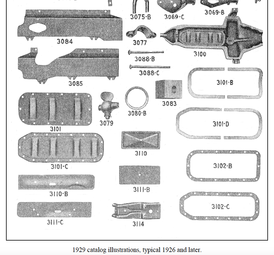

So I see in the most recent issue of Vintage Ford an article about overheating, and it mentions how to test if the oil line is clogged. It says to remove the front right bolt on the crankcase cover plate and turn the engine on, then wait 15 seconds to see if oil flows out. If oil flows out the oil line is fine, if oil doesn’t flow out it’s clogged and needs to be cleaned. My question is, what is the crankcase cover plate? The plate on the bottom of the engine? Isn’t that the oil pan?
The Little Ford Will Ramble Right Along!
22 Touring
Posts: 7401
Re: Just Got My First T, Need Some Advice
Post by Steve Jelf » Thu Jul 23, 2020 9:53 am
I think that would be #3101, officially called the crank case lower cover. It bolts onto the bottom of the pan.

Post by Its_Always_T_Time » Thu Jul 23, 2020 9:57 am
Thank you! I’ll unbolt that one front right bolt and wait for oil to flow out, if none does I’ll have to blow out the oil line.

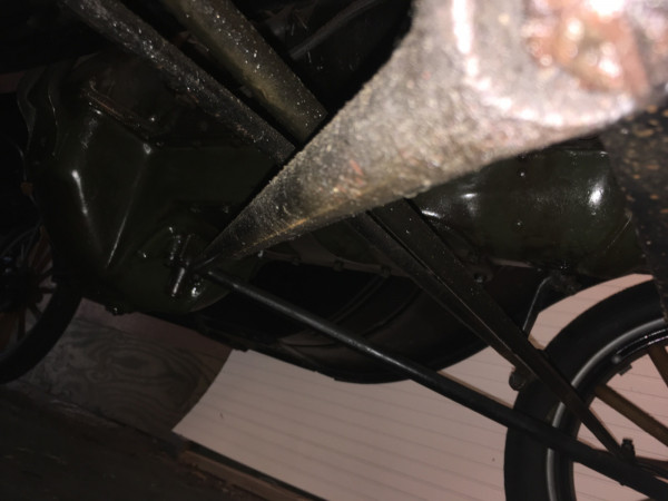

The photo of the wishbone attachment to the engine scares me. Those are bolts that could unscrew themselves from the engine. It is possible that someone has put Loc-tite (thread locker) on the capscrew threads, but there's a reason why Henry made the T with studs and castellated nuts. When installed as Ford intended the wishbone cannot come loose from the engine; as it is installed in your photo, it can. Ask me how I know...

Post by Dallas Landers » Thu Jul 23, 2020 12:06 pm
Re crankcase cover would be 3100 re Steve's chart. Right front bolt on that should be where oil comes out. 3101 is inspection cover.

Post by Steve Jelf » Thu Jul 23, 2020 3:47 pm
After reading that I had to take a look at the VF piece Brendan mentioned. It's in the May/June 2020 issue, and is an article written by Murray Fahnestock in 1918 and updated this year by Mike Vaughn. Fahnestock refers to the crankcase cover plate. I believe this is #3101, which the Ford book calls the crank case lower cover. Ford calls the engine pan (#3100) simply the crank case. If you look at the right front bolt on the engine pan (crank case) you see that it's just one of the bolts attaching the pan to the block with a castle nut. There's no way that oil could get to it.

Post by Dallas Landers » Thu Jul 23, 2020 4:59 pm
Which bolt should oil come out of if removed ?
Posts: 7401
Post by Steve Jelf » Thu Jul 23, 2020 5:49 pm
I believe it would be this one down on the bottom. The oil tube empties in that vicinity.

Post by Its_Always_T_Time » Thu Jul 23, 2020 6:23 pm
You guys are amazing. I’m in the garage with Lizzie and I’m going to loosen that bolt right now! Just adjusted the low output intermittent spark coil to ~1.3amp and much better spark, if oil comes out of that bolt hole when the engine is running I’m going to install the oil screen and change the oil!

Post by Its_Always_T_Time » Thu Jul 23, 2020 7:01 pm
OIL LINE IS NOT CLOGGED! HOORAY!🔧🤗

Thats good news. Check that one off the list.
Thank you Steve. Still learning here also.

I replaced the cracked pack nut, and with the adjusted coils and fixed exhaust leak, the engine no longer misses! Hooray!
Now there seems to be a large leak of oil coming out of the left side of the hogshead where the upper and lower halves meet just below the pedals. It doesn’t seem to be from the pedals. Hmmm...🤔

I think I‘ll tighten all the bolts on the hogshead starting from the center and work my way out. Looks like it’s coming out of the bolt near the engine. 🔧🤗

I haven't tried it, but I've read about this cure for a leak between the hogshead and the pan.
1 Wash the leaking crack thoroughly with lacquer thinner. You want it to get into the crack, not just on the outside.
2 Run a bead of Ultra Black along the crack and squeeze it in with your finger.
3 Add another small bead along the crack.
4 Hook up a shop vac to the oil intake and suck the Ultra Black into the crack. Be careful to suck only air, not oil.
Maybe somebody who has actually done this can tell us how it worked.

I don’t see any cracks on the hogshead, just looks like she’s leaking near the bolt by the engine. I’ll see how that fix works.

I don't think he means "crack", as in a fracture. I think he's just referring to a gap between the pan and hogshead where the gasket may be bad.
However, there is the possibility of there being a crack, (as in fracture), in the pan, where the motor mount bracket attaches. That's not so uncommon and will cause a stream of oil like you're getting. Clean up the whole area really well, then run the engine while looking to see where the oil begins to emerge.

I wasn't thinking of an actual crack in the hogshead. I was thinking of a leak between the hogshead and the pan. Maybe I should have called it a gap or an opening.
