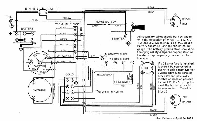

I got a wiring diagram and a complete wiring kit from Lang’s, it arrived today!

Allan brought up something I meant to mention. With a 6 volt system you want the cables in the battery to starter circuit to be very heavy to reduce resistance loss - 0 or 00 gauge is common. Some guys even use cables designed for an arc welder. If you use what is available at the autoparts your starter performance will be sub-par.
Posts: 4089
Re: Just Got My First T, Need Some Advice
Post by DanTreace » Mon Jul 20, 2020 12:16 pm
Correct on the heavy cables needed for good 6v storage battery function. Besides clean terminals and super clean contact point for the negative ground on the frame, be sure to use proper cables.
Even Ford realized the importance!

FUSE HOLDER LOCATION
Post by Novice » Tue Jul 21, 2020 5:00 pm
Install black in line fuse holder at or near fire wall electrical block. insert in the power wire going from terminal block to the foot switch battery side post. This gives easy access without crawling under the car to check or replace fuse. and a convenient place to disconnect power if You are working on the car. and the chance of a short in the heavy gauge three foot wire going between the terminal block to foot switch are slim and none. some folks don't use fuses since Henry didn't. I didn't either until first night I had the car turned on the headlight's and sparks flew out of the ignition switch could have started a fire but managed to turn switch back to off position and sparks stopped. But it got my attention! some use a fuse block and fuse several circuits others fuse everything with ten fuses like the modern cars do but I don't think that is needed the one fuse will protect in most situations. be sure electrical block screws are tight but not too tight are You will strip them out. If loose terminal will can get hot and fry wire end and discolor terminal lug. Don't fix it if it aint broke and then one item at a time so You don;t wind up with several alligators biting Your BUTT at the same time.
My 2 cents worth maybe less.

How would I find out what timer I have? I’ll remove it and maybe post a picture of it here and someone can tell me which one it is? I know there are roller timers and different ones like Anderson and new day timers.
I also turned the nuts on the bottom of my Kingston L4 carb and now the engine is backfiring. I thought the carb was flooded and I tried to drain it after removing the fuel line and the nuts just kept turning. What does the big nut and little but do on the bottom of the carb? I read the MTFCA book about the carbs and I can’t seem to find out about the little nut on the Kingston carb.

She still runs and drives fine, just sputters at idle and higher revs. Guessing it’s an electrical issue.

Just tested the coils, one of them is weak and producing very intermittent spark. This might be the source of my intermittent missing issues.
I replaced the plugs and that didn’t fix the intermittent missing. The plugs were quite fouled and inside of the cylinders was quite dirty so a head-off deep cleaning is in order soon. New plugs won’t hurt I’m sure, the old ones were so fouled I’m amazed the car ran at all. I’ll post a picture of the old plugs soon.
The new oil screen arrived today. I’ll install it and change the oil after checking for oil line clogging.
