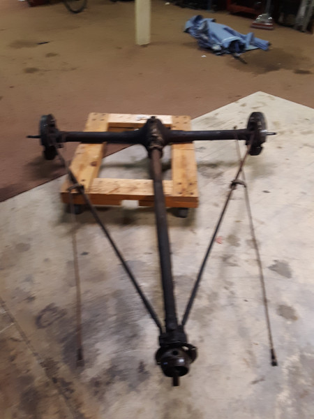

So when I yank on the rear wheels I have about a quarter inch play on the right side and eighth inch on the left side... I guess I found my problem... now I need to decide if I want to tackle it myself or pay someone to rebuild my rear end..I consider my self a pretty good shade tree mechanic LOL...I'm sure i could take it apart, i have a good vise grips, a hammer and a torch..LOL. what for special tools would I need to put new parts in my rear ?

There are two things which could cause the play. One is the thrust washers on each end between the carrier and the inner bearing. There are steel disks with a babbit washer between. In all cases, whether or not the babbit seems good, it should be replaced with bronze. The other place where you could have play would be the fiber washer between the ends of the axles which is inside the carrier.
It is relatively to replace these, and if nothing else is worn, you can use common tools and even sandpaper to surface the washers to get the correct clearance. If the gears or bearings need to be replaced, you at least need a puller to remove the pinion gear.
The club publishes a very good step by step manual on the rear axle. Very good for do it yourself workers. You can do the work yourself or with one helper. You don't need a machine shop to do the work. Just follow the instructions. And parts are available from the suppliers.

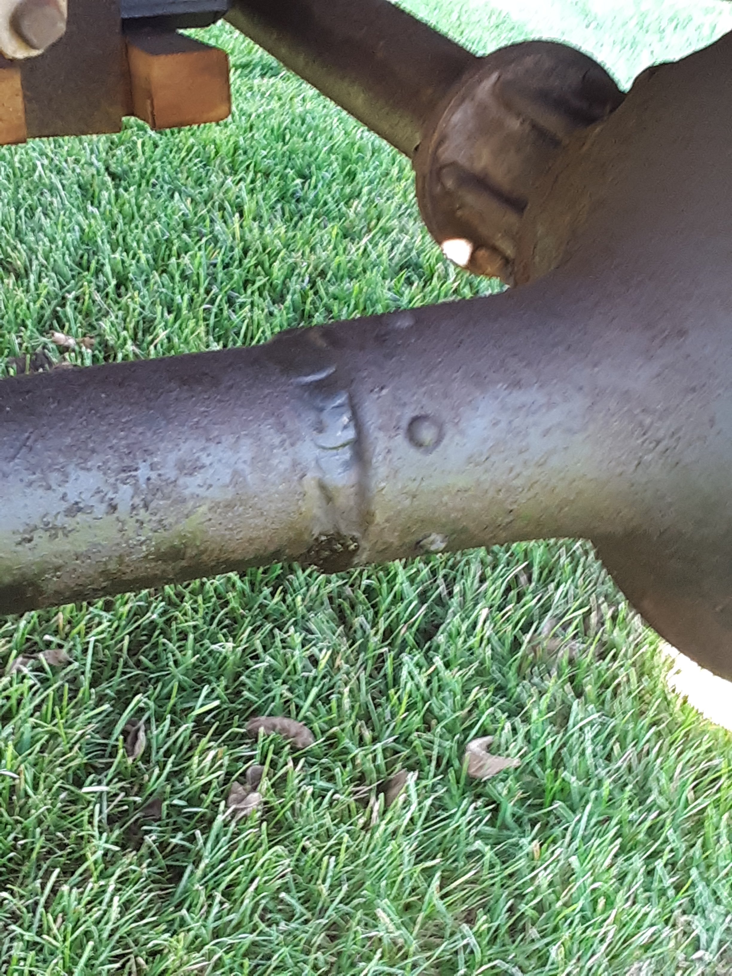

Does this mean my rear end will no longer be able to come apart to rebuild ??
- Posts: 3990
Re: Rubbing noise???
No, the axle tube isn’t to be removed in repairs.
But yours is welded so was loose due to loose rivets or maybe a crack, so that housing has had a rough life.
May indicate the internal parts are well used too. Finding a good used replacement housing is easy.

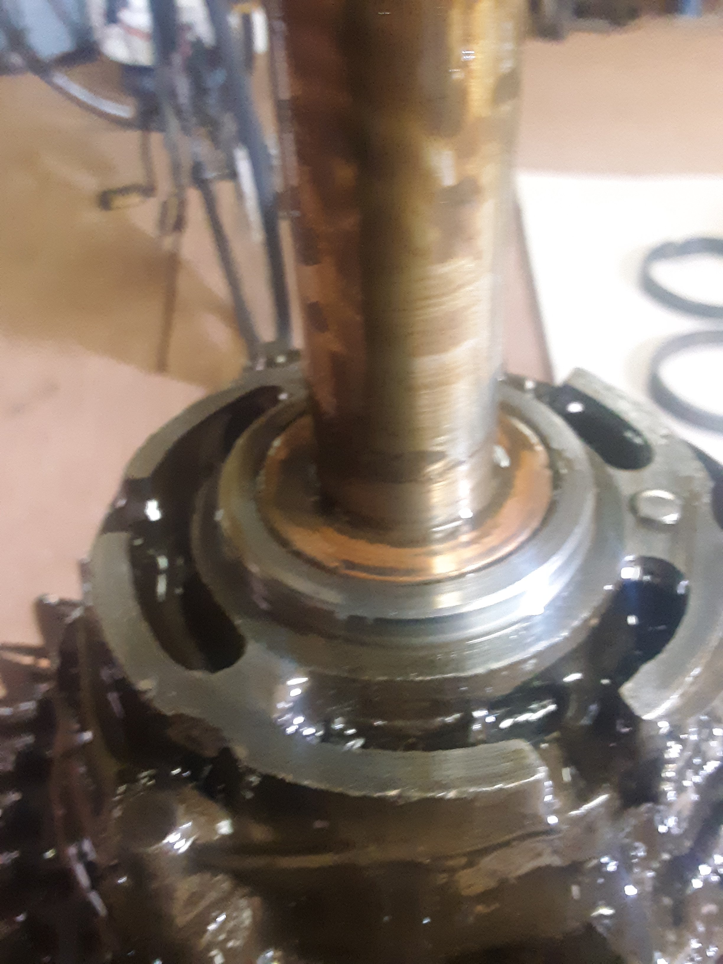

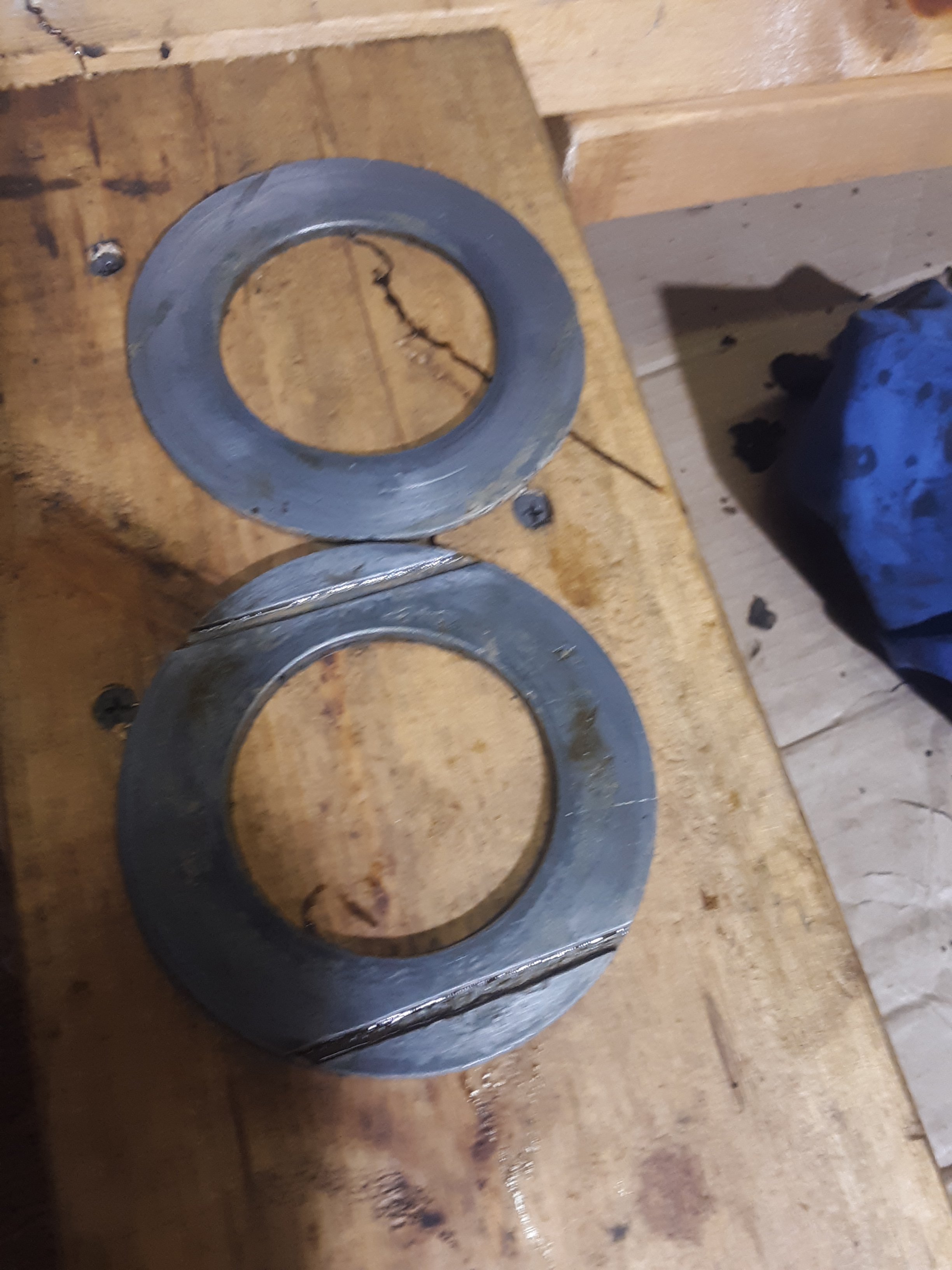

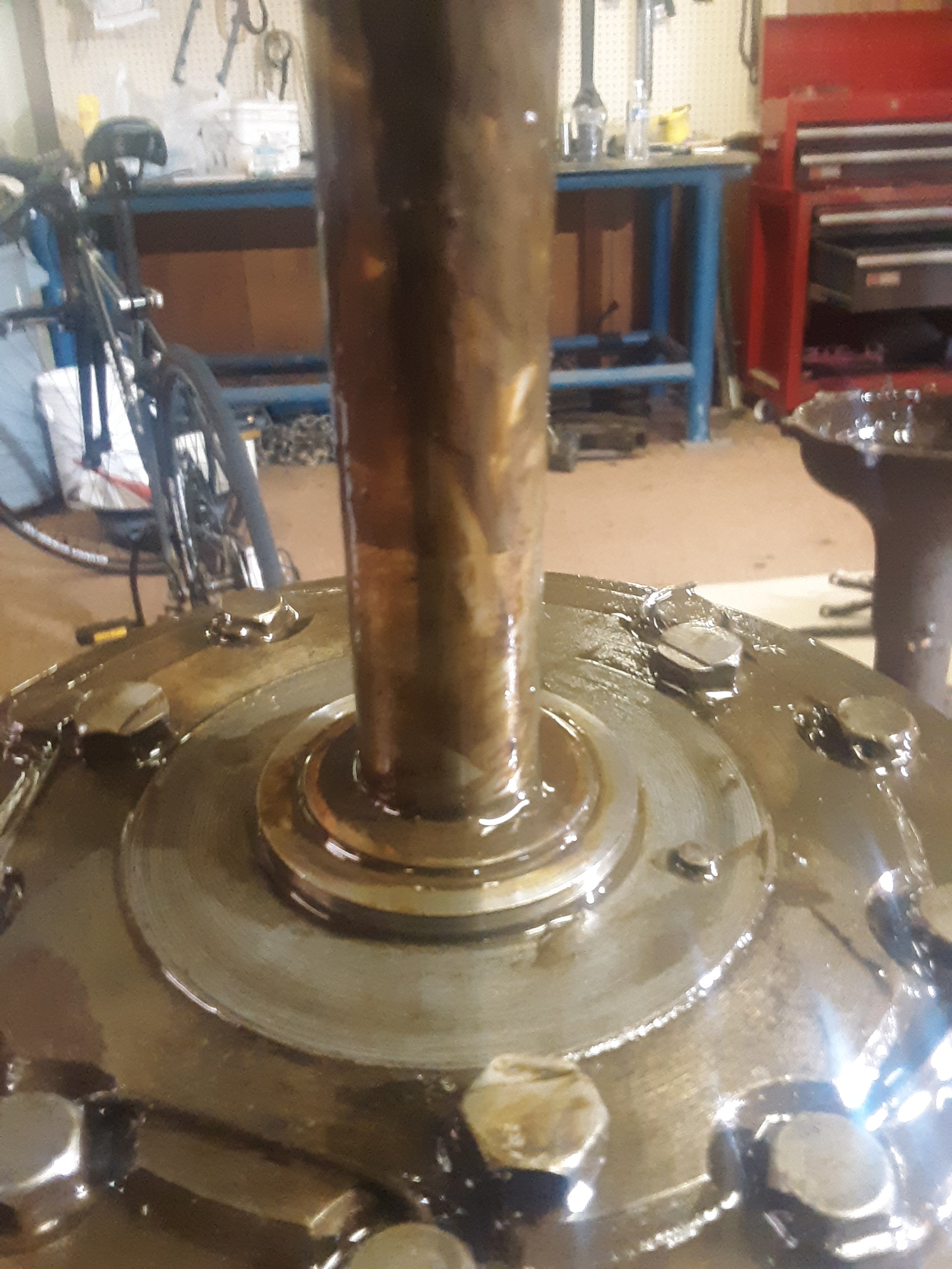

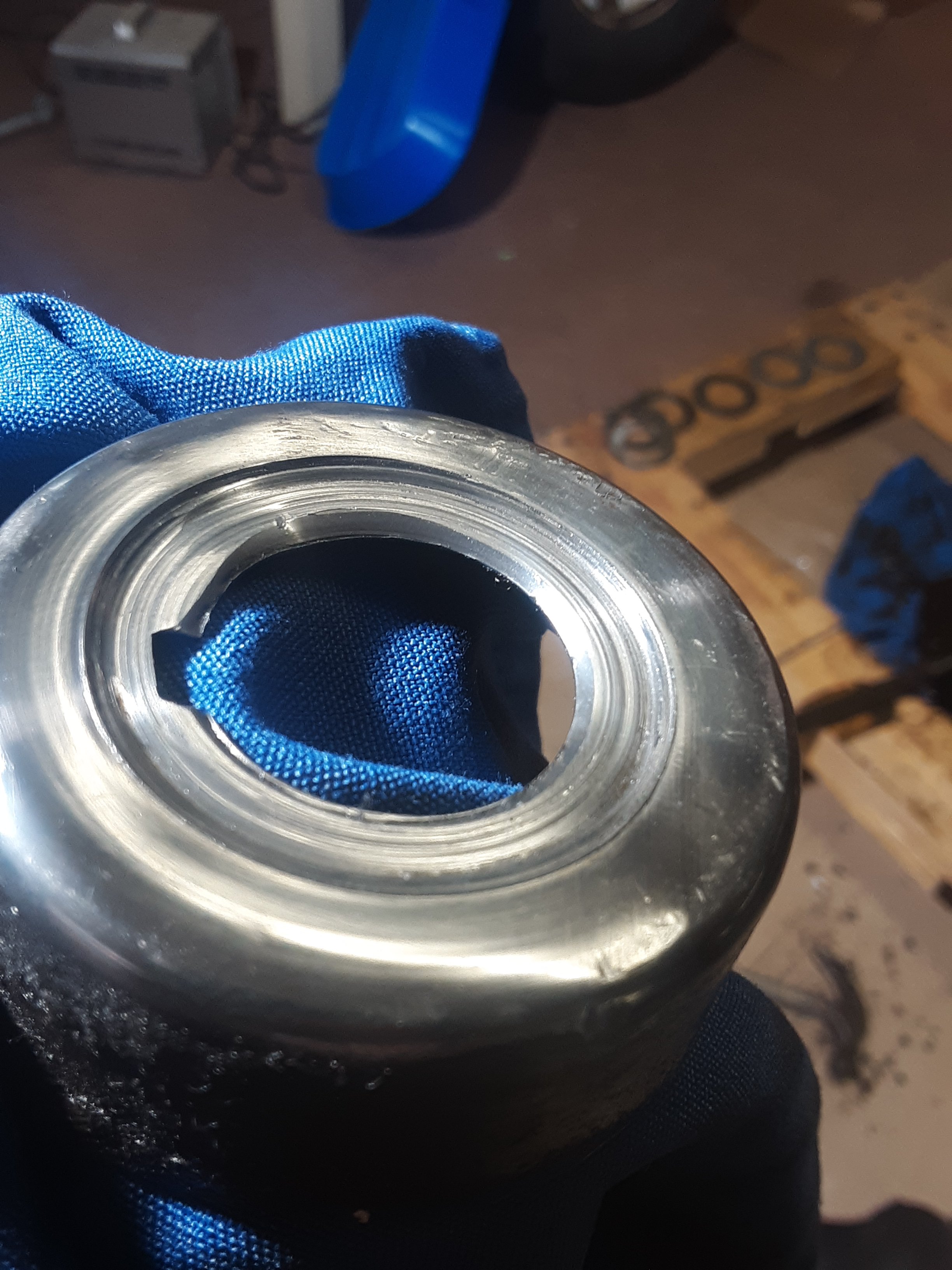

So I see a few issues... scraping on the felt cap, scraping on the bolt heads, pins are gone. My question is, is this all a result of the thrust washers being shot ?
- Posts: 4692
If you have end play in the axle, your scraping could be caused by the thrust washers being worn out. Another thing which will cause a similar problem would be the tapers on the ends of the axles or inside the hubs or a combination of both. That problem is caused by the hub being too close to the seal cap.
- Posts: 7376
It's amazing to me that the old Babbitt thrust washers are as intact as they appear in the photo. The wear on the three bolt heads shows that they have been rubbing on the housing, maybe the source of your unhappy sounds.
I agree that you should have the MTFCA Axle book for this job. It gives you step-by-step what to measure, what to replace, etc., etc. I have just one quibble with the book. Glen is impartial on whether to use the stock pinion bearing or the fun Projects replacement. I will go with the FP every time. The adjustable version is to comfort the guys who need something to adjust. I have used the non-adjustable version and it is fine.
Obviously all this has nothing to do with steering. If you have any problem there, it's unrelated.
- Posts: 5563
- First Name: Henry
- Last Name: Lee
The noise is due to the left side being held back by contact with the hub bolts, resulting in the right side trying to drive, equaling to a poor mans posi-track. This condition makes the steering act like a vehicle with a locked up differential.
The center disc in the gear carriers are shot as well. No center thrust.
