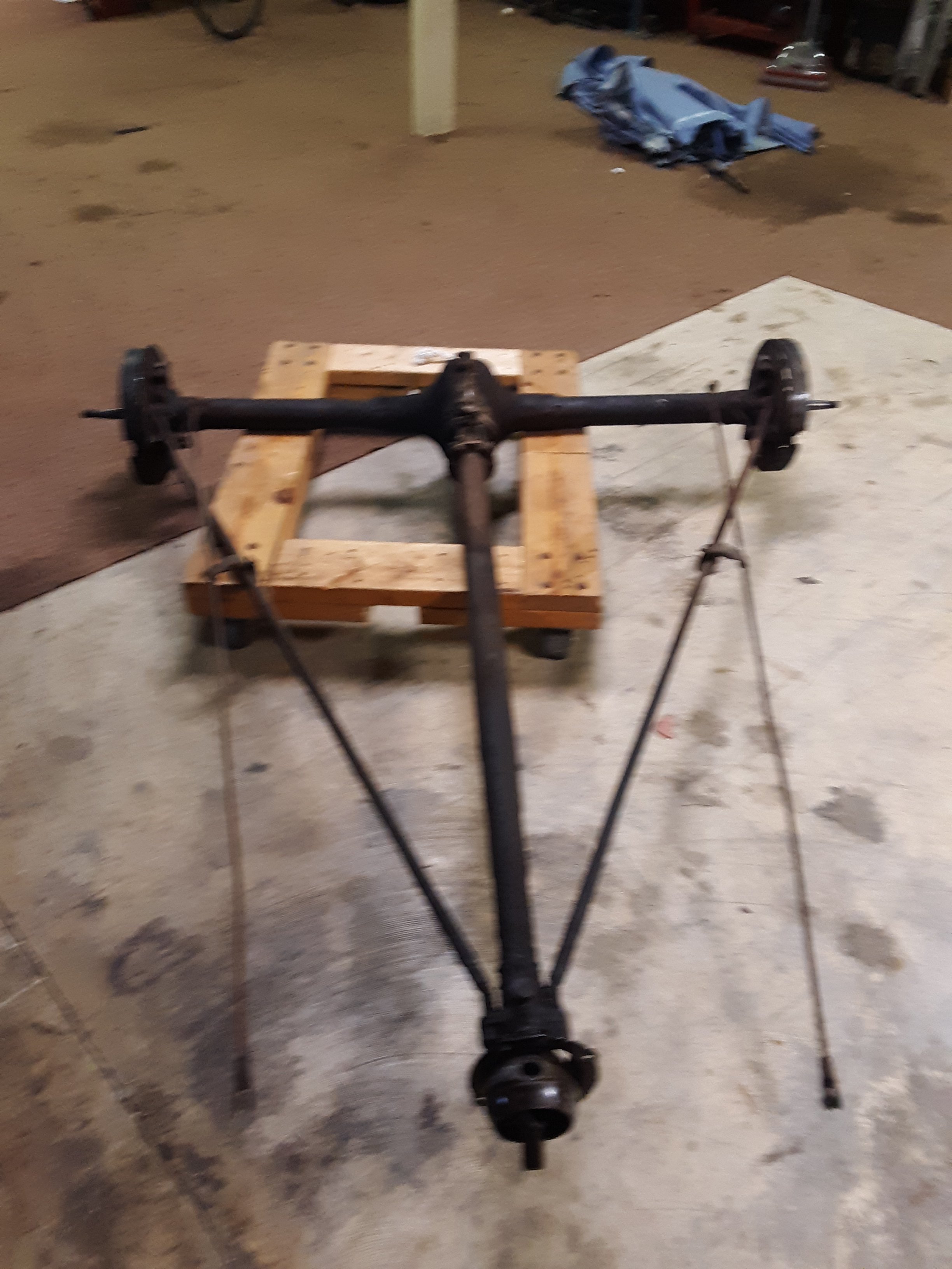

Post by Larry e rutt » Sat Dec 26, 2020 12:34 pm
Let the fun begin

Post by Larry e rutt » Sat Dec 26, 2020 3:48 pm
So I see a few issues... scraping on the felt cap, scraping on the bolt heads, pins are gone. My question is, is this all a result of the thrust washers being shot ?

If you have end play in the axle, your scraping could be caused by the thrust washers being worn out. Another thing which will cause a similar problem would be the tapers on the ends of the axles or inside the hubs or a combination of both. That problem is caused by the hub being too close to the seal cap.
Posts: 7239
Re: Rubbing noise???
Post by Steve Jelf » Mon Dec 28, 2020 9:36 pm
It's amazing to me that the old Babbitt thrust washers are as intact as they appear in the photo. The wear on the three bolt heads shows that they have been rubbing on the housing, maybe the source of your unhappy sounds.
I agree that you should have the MTFCA Axle book for this job. It gives you step-by-step what to measure, what to replace, etc., etc. I have just one quibble with the book. Glen is impartial on whether to use the stock pinion bearing or the fun Projects replacement. I will go with the FP every time. The adjustable version is to comfort the guys who need something to adjust. I have used the non-adjustable version and it is fine.
Obviously all this has nothing to do with steering. If you have any problem there, it's unrelated.

The noise is due to the left side being held back by contact with the hub bolts, resulting in the right side trying to drive, equaling to a poor mans posi-track. This condition makes the steering act like a vehicle with a locked up differential.
The center disc in the gear carriers are shot as well. No center thrust.
