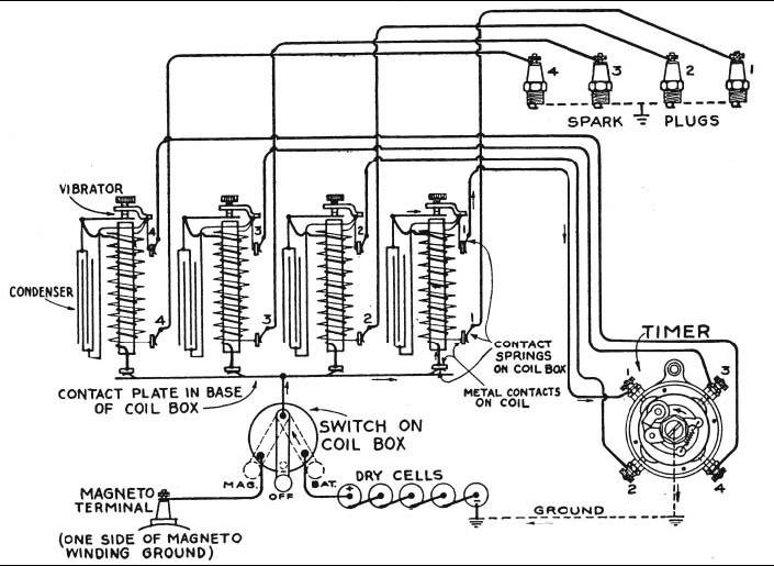

Scott, thanks for the call and the update. Glad to hear that you got your starting issues resolved.
Now that you are talking about getting a larger 12V lead/acid battery, hooking up your one wire 12V alternator, and adding wiring to your TT, here are some diagrams that may be of help. Starter equipped Ts and TTs came from Ford with 6V NEGATIVE ground electrical systems.
The first diagram is for a non-starter car (no starter, battery, or generator). The dry cells shown in the diagram were not supplied by Ford, but could be added by the user. They were the old, large 1.5V telephone batteries.
The second diagram is for a later starter car (starter, 6V battery, 6V generator, negative ground). It includes a firewall terminal block, an ignition switch, and an ammeter. The vendors sell a small bracket to hold the ignition switch and ammeter:
https://www.modeltford.com/item/INST-PAN.aspx

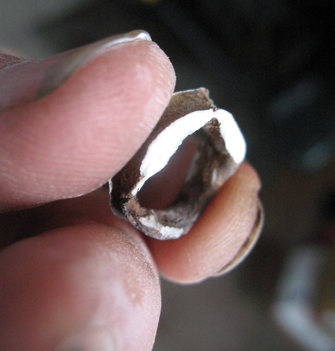

Post by Steve Jelf » Sun Oct 04, 2020 9:36 am
I used some permetex...
I hope it wasn't the original stuff.
I found that a few years of hot coolant turned it hard, brittle, and leaky. After that I used Permatex Ultra Black. So far it has been OK.
Corvette Guy
Posts: 86
Joined: Wed Mar 11, 2020 10:05 pm
Last Name: Jones
Location: Northern IN
Re: Hard starting TT, ugh....
Post by Corvette Guy » Sun Oct 04, 2020 10:18 am
The old freeze plugs were some leaky brass ones put in by the previous owner.
It's worth noting that my neighbor guys truck had a pin hole leak in the middle freeze plug that would shoot water out about 3 feet due to his water pump. He pulled them out yesterday and they were steel and if they weren't leaking at the time, they would have in a short time.
