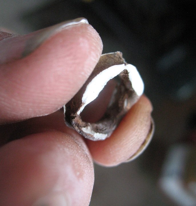

- Posts: 7347
Re: Hard starting TT, ugh....
I used some permetex...
I hope it wasn't the original stuff.
I found that a few years of hot coolant turned it hard, brittle, and leaky. After that I used Permatex Ultra Black. So far it has been OK.
