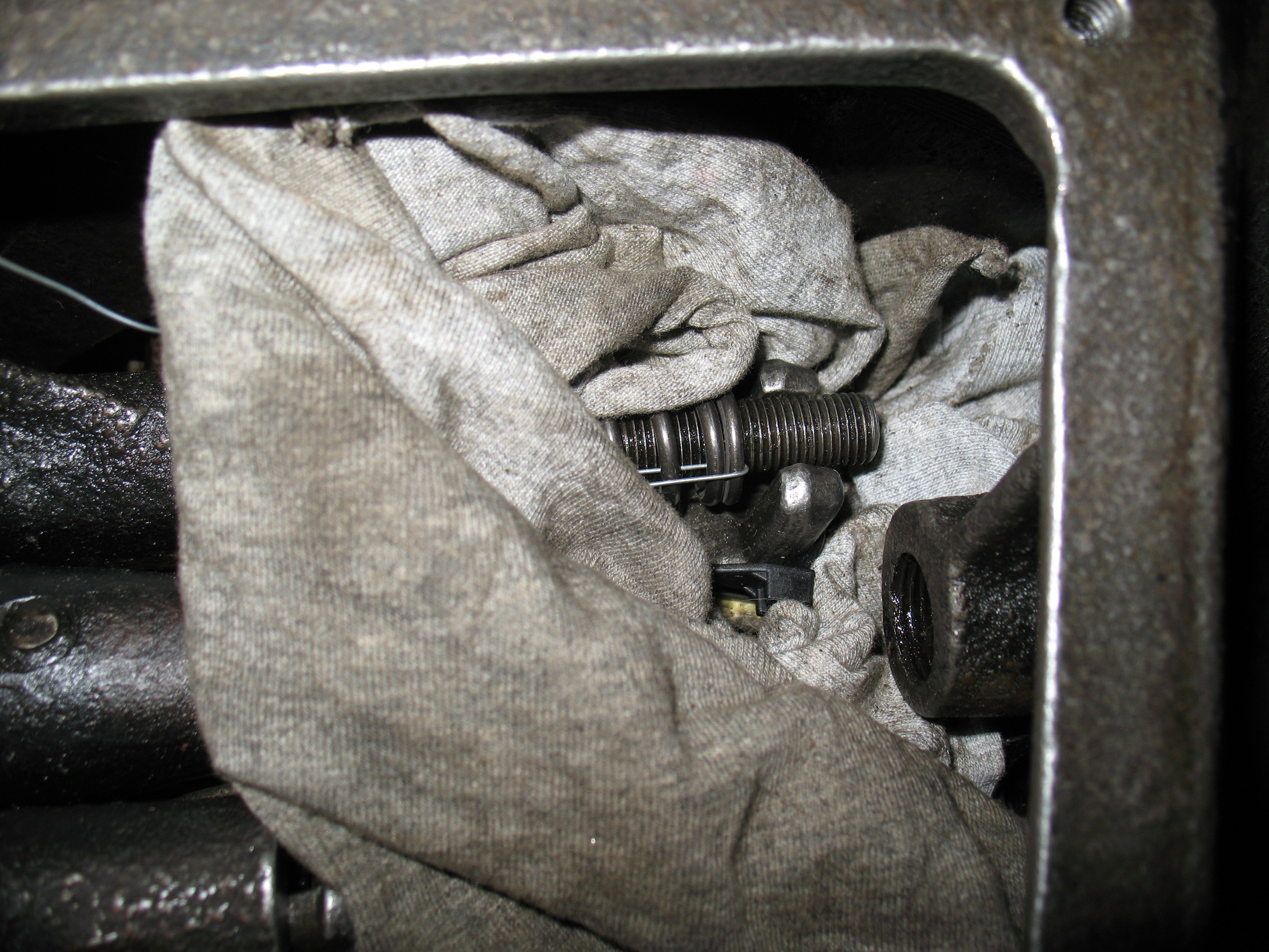

AND DO NOT DROP AN ADJUSTING NUT OR WASHER DOWN INSIDE.
Stuff rags or paper towel down the side of the casing, below the nuts.

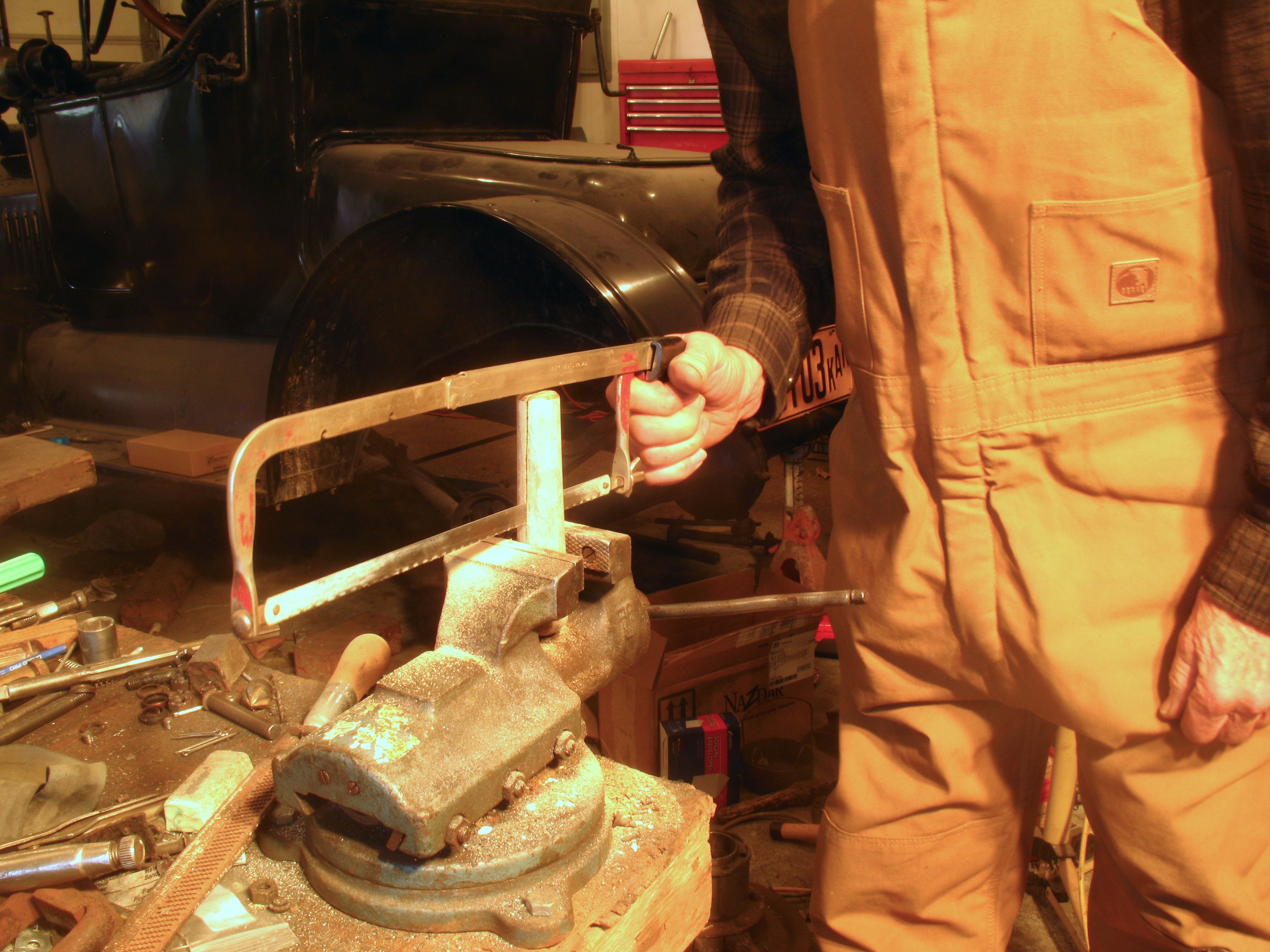

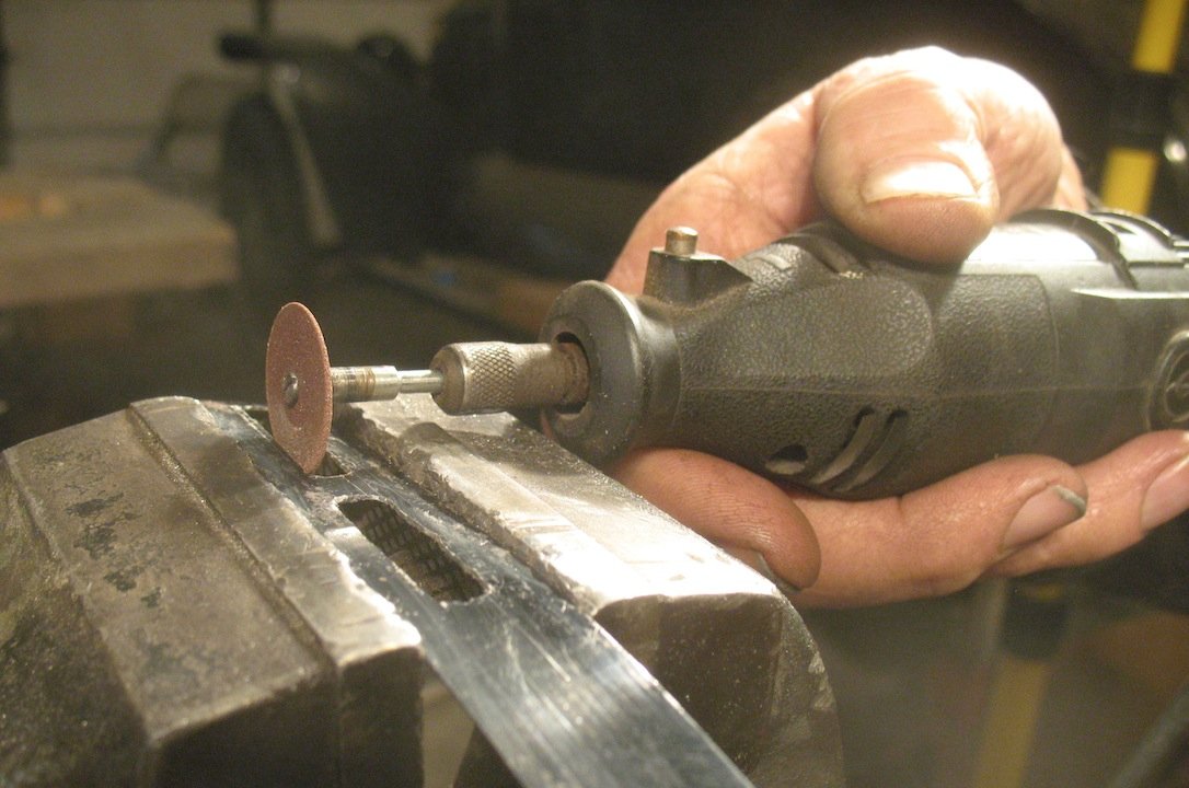

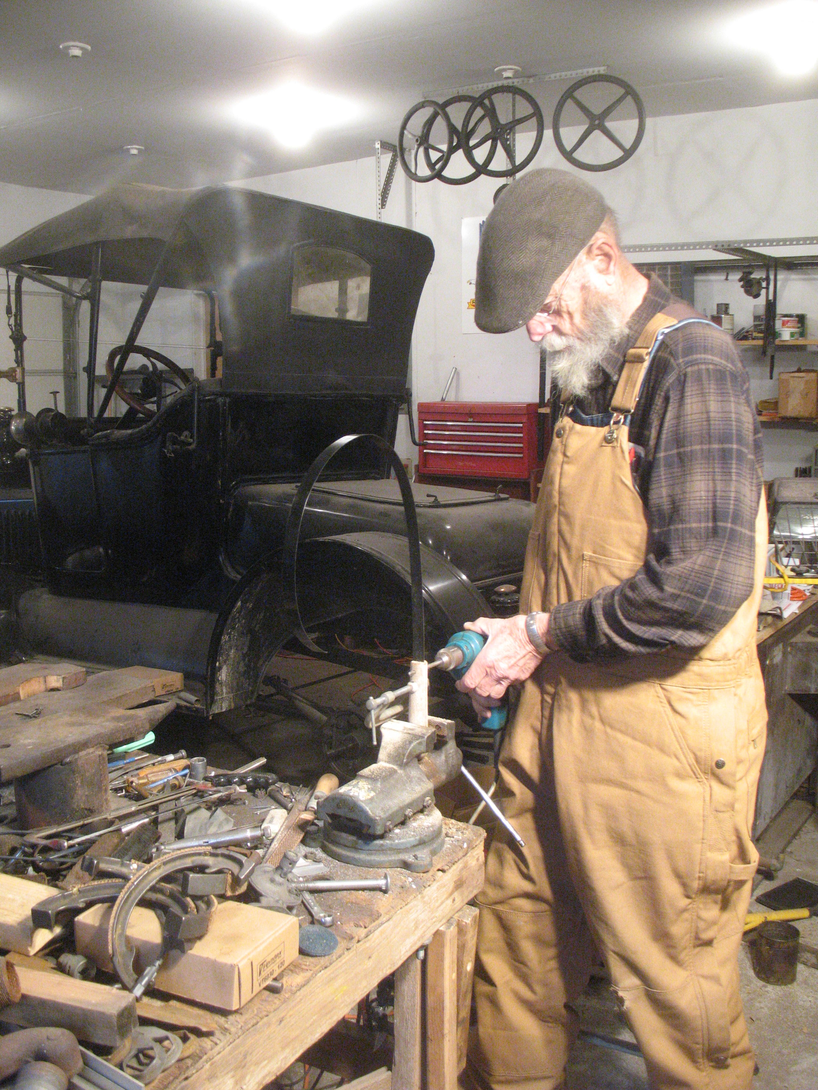

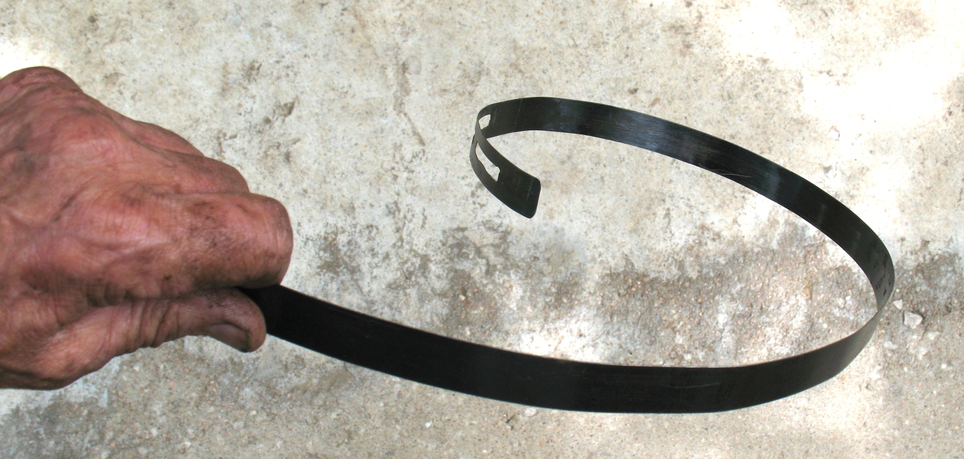

A handy tool is this puller. It pulls the bands around the drums. You can buy it or make it from a piece of pallet strap.
This is what Chris mentioned to avoid dropping nuts and washers into the transmission (a major PITA). Either use one big piece of cloth like a towel, or count the rags going in and coming out.

Yes, I've seen it recommended, so I guess it works. I just stuff rags.

Then use the tool either one you buy or make one such as Steve describes to pull the band around the drum. The detachable end goes toward the side where the shaft goes through the hogs head. That would be the left or drivers side on American cars.
