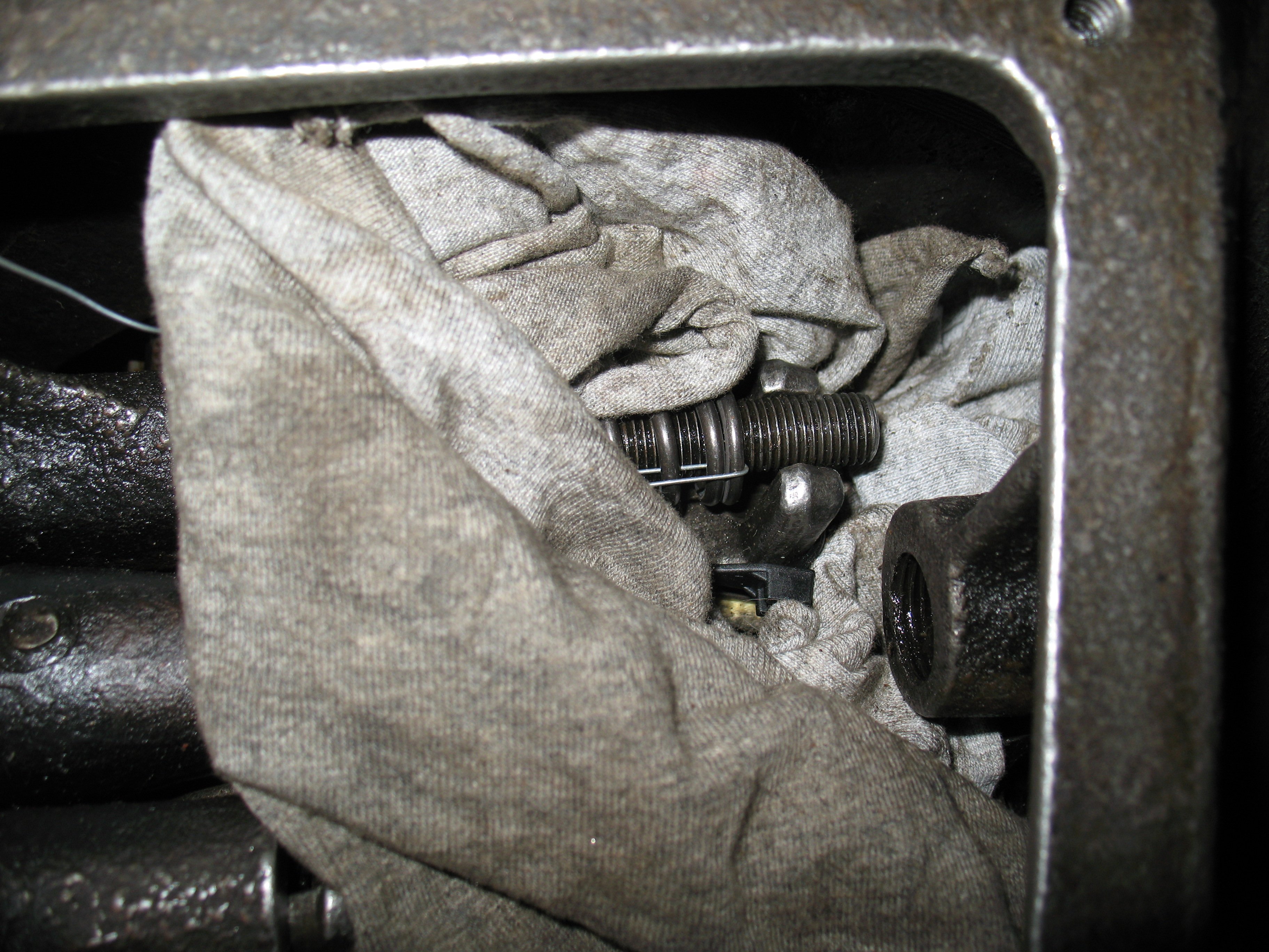

AND DO NOT DROP AN ADJUSTING NUT OR WASHER DOWN INSIDE.
Stuff rags or paper towel down the side of the casing, below the nuts.
Best to tie the ears of each band together with thin wire before you start.
(Or there is a tool)
Then there is no tension on the nuts.
And when you withdraw each band, having removed its detachable ear, pull a cord or wire round to help pull the new band back.

A handy tool is this puller. It pulls the bands around the drums. You can buy it or make it from a piece of pallet strap.
This is what Chris mentioned to avoid dropping nuts and washers into the transmission (a major PITA). Either use one big piece of cloth like a towel, or count the rags going in and coming out.

Has anyone tried to tie dental floss around nut or washer?
Tim
Posts: 7392
Re: 15 YEARS OLD AND ABOUT TO CHANGE BANDS FOR FIRST TIME!
Post by Steve Jelf » Thu Oct 08, 2020 11:07 am
Yes, I've seen it recommended, so I guess it works. I just stuff rags.
