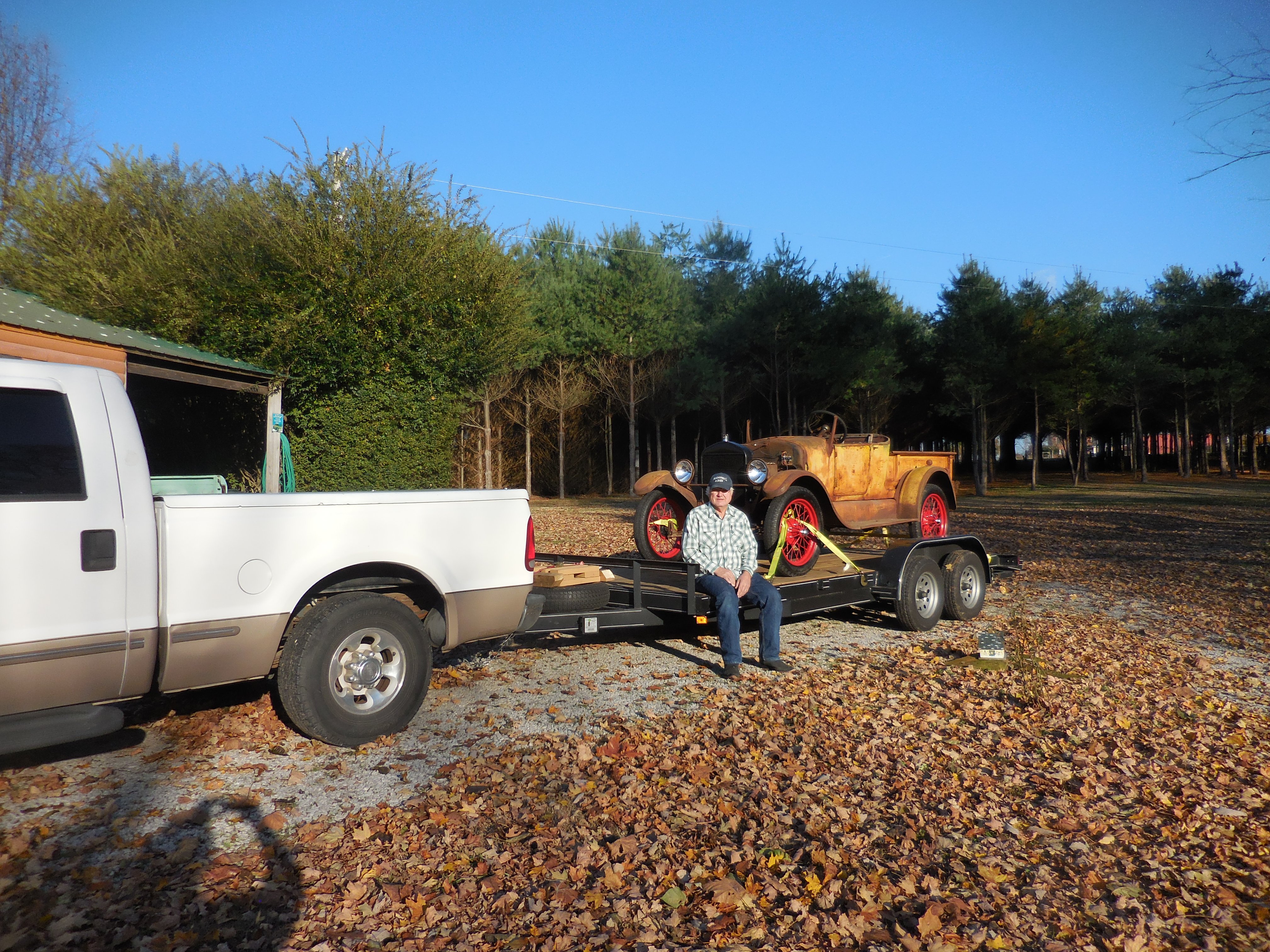

Welcome to the very unique world of the Model Ts. I got my first T almost 2 years ago and that was the first time I had been near a Model T. Read lots, ask lots of questions. The forum has been invaluable to me. Don't get in a hurry to do anything, just enjoy the experience and take to heart the good comments. The biggest thing to me " Take time to learn and enjoy the magnificent world of the Model T."

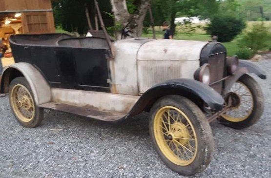

I am 14 and just got my first T. It is a 1926 Touring and I just got it running. Welcome to the awesome hobby!!!

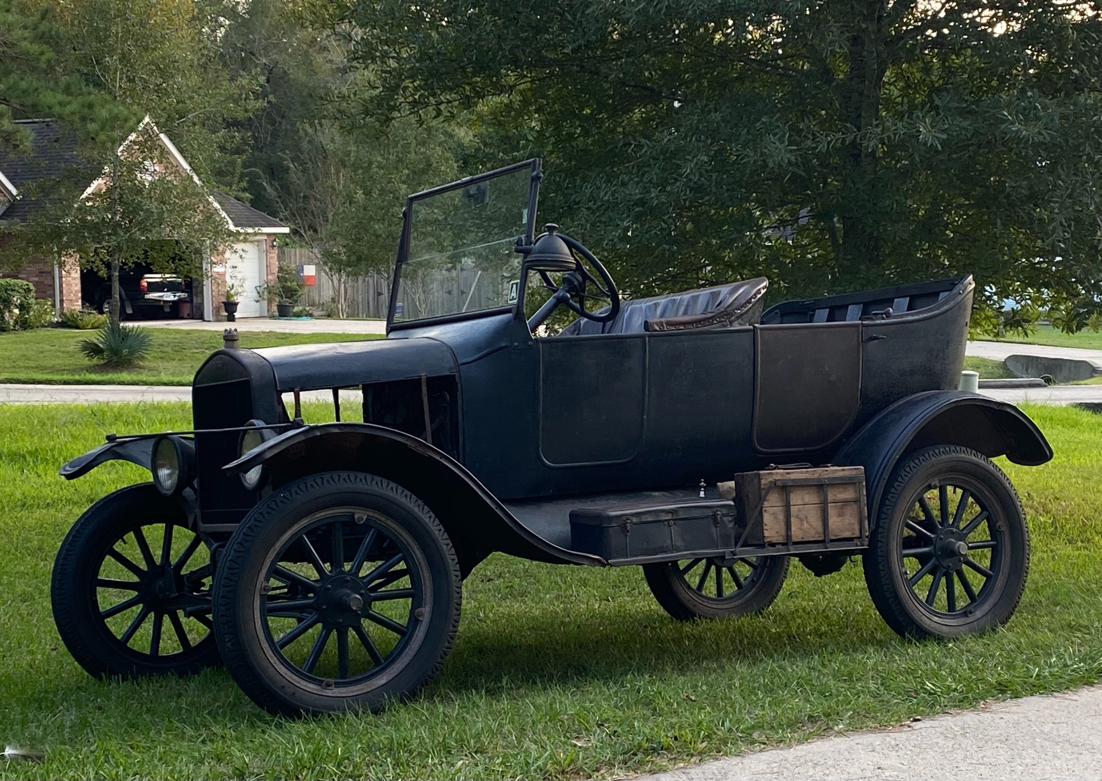

Welcome!
I was new to T's four years ago at this time. All of the above info is great.
I'll add this....I've come to discover that, once the car has been properly revived and is running, my "job" is to be a constant observer and adjuster of lubrication on my T.
Many of the issues I've seen with other's T's have arisen because folks are used to modern cars and drive their T's many different times without checking various lubrication points. I obsessively check mine all the time, probably too often, but this is a car that needs that kind of attention. Add to that the fact that a lot of this metal is nearly 100 years old and I think my obsessiveness is warranted.
On my newer vintage cars, if I have an oil leak at a lubrication point, I consider it a problem and correct it. On my T, the four corners of the suspension and a few other places, are always a bit wet with oil or grease. A T shouldn't be bone dry at those places. I lay under the car a lot and wipe up a lot of this excess oil to try to keep it clean but I also see it as a sign that the old girl is lubricated.
