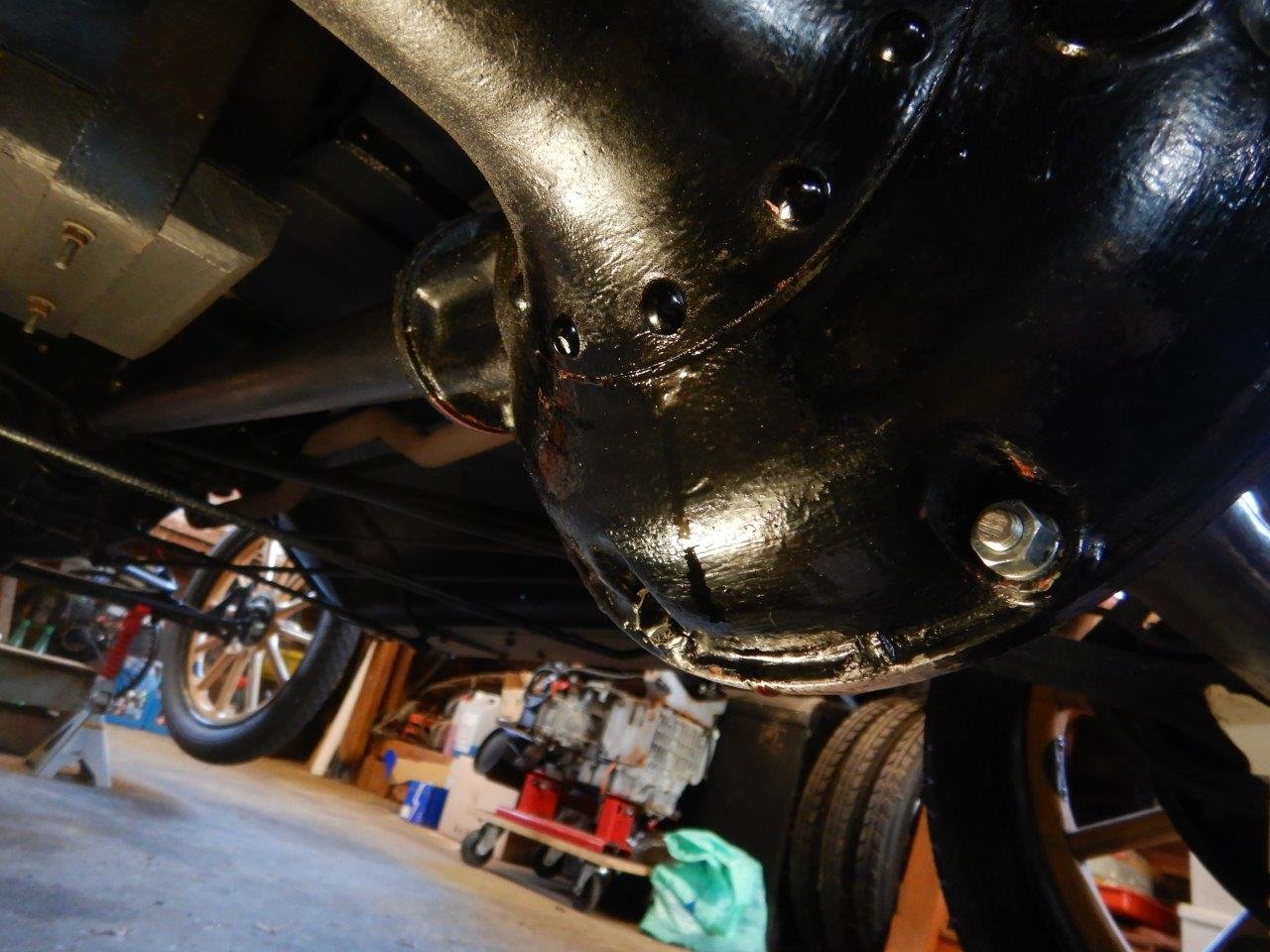

Hi all,
I wonder if you can give me some advice for the repair of the oil leak on this 1912 rear axle?
Is there an easy way to do this or need the rear axle been taken apart?
What is the best way to do it?

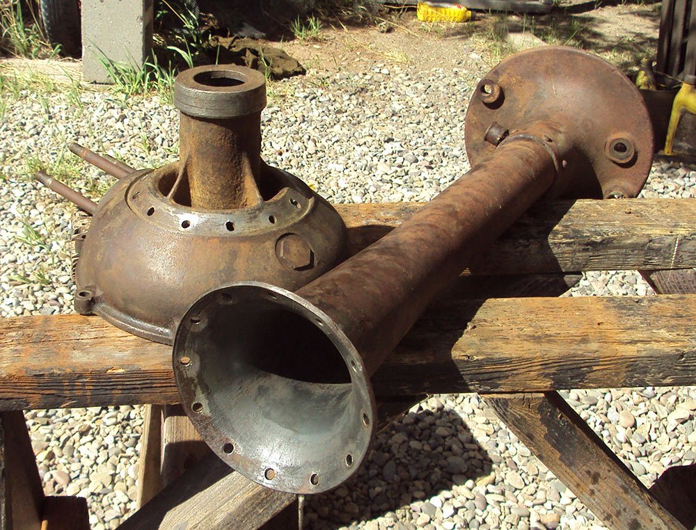

Fixing that leak has been a problem forever. The design was changed with the introduction of the straight axle tubes in 1915 to overcome inherent problems.
I believe it cannot be fixed without stripping the rear axle assembly. A very poor choice of repair is to bronze all the rivets and the circle around the tapered tube. It works, but many a good axle housing has been ruined in doing so, making it very difficult for a correct restoration later on. It is far better to drill out the rivets and remove the centre castings from the tubes. Then the tubes and castings should be hot tanked to remove all traces of grease and crud, so you have absolutely clean components with which to work.
On my 1912 van the castings had weld repairs done first, which warped them, so they needed re-machining to true them. I used 1/4" grade 3 nuts and bolts to hold the pieces together, rather than riveting them. There are two areas on the casting to be sealed against the axle tube, a smaller outer land seats inside the taper in the axle housing and the machined circle which takes the rivets.On these I use another Loctite product, a red flange sealant which does not set hard. The hex head bolts were reshaped to appear as rivets. To hold them while the nuts were tensioned, the inner threaded end was slotted to allow a screwdriver to hold them. Loctite threadlock was used to hold them, and the slit in the bolt gently spread to act as an extra lock.
The van has been on the road now for 25 years and has done heaps of city driving on promotional work. There is still no sign of any leakage, so I consider it fixed.

On my '14's rear axle, I soaked the housings for several days in mineral spirits. To do it, I made a temporary tank by nailing four 2 x 12s together and lining the resulting rim with a sheet of 6 mil plastic. I put a piece of scrap OSB in the bottom so that any sharp edges on the housings wouldn't cause a leak. After removing the housings and letting the drain for a few days I blew them out good with compressed air and let them air dry several more days in the hot summer sun. Then I disassembled the "tank" (nothing to store!) and set the wood and plastic aside for another use.
Once I was satisfied that the housings were hospital clean and dry, I mig'd over the heads of the rivets on the inside to strengthen and seal them. Then I ran some Permatex around the inside of the seam where the tubes joined the halves of the punkins. Finally, making an applicator from a 14" long piece of strap steel with the last inch of one end bent at a 90 degree angle, I reached into and sealed the tube/bearing housing joints with fresh JB Weld. Upon final assembly I installed two paper housing gaskets with more Permatex. No leaks, not a speck, for almost 20 years.
Now I'm getting a few drops from the housing center joint but I think that's caused by the lower housing bolts' stretching. I'm going to replace the LH axle this winter because it's gotten bent out at the end from driving the car on the lunar landscapes that NY calls roads, so when I do I'm going to make a new set of bolts and nuts from Grade 8 steel to help with the stretching issue, along with the added truss rod that I installed last summer.
