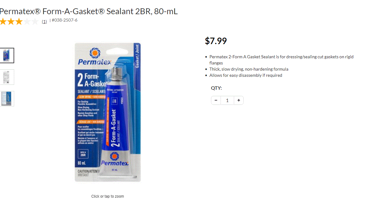

André, I have the same issue than you and I repaired it with this without removing the oil in the rear axle.
I started with this
After a week still have a very little leak so I used on top the Permatex 2-Form A Gasket Sealant is for dressing/sealing cut gaskets on rigid flanges. Usualy I used with my engine Pan and transmission but work really nicely too with my rear axle. Now I drive the car for 6 mounths without any leaks from the axle. Hope that help before removing the rear axle and replace the gasket.
Super Mario Bross ;)
