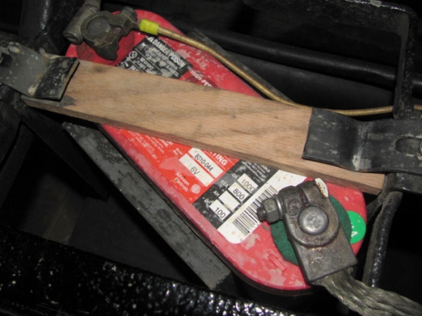

The Optima is an AGM (absorbed glass-mat) battery, with special spiral shaped lead in the 3 cylinders, giving the Optima Red Top 6 v a different shape.
It will fit in the T battery carrier if you make a side board to keep it from rocking. Have installed it too in a metal repro battery T box, and used a spacer board cut like a wedge on two sides to keep it still in the box. Also made a thin plywood liner to the metal battery box top to keep from any contact of the terminals.
What is nice about the Optima is no care. You don't have to check to add distilled water, as it is sealed. Plus you can lay it on its side or upside down!
Any charger will top it off. On mine are placed pigtail quick connect leads from the posts to outside the battery tray, laying under the rubber floor mat. Easy to hook up a charger to top off the battery if needed. For me, don't leave the trickle charger or maintainer on for long times, only to top off the battery.

I tried an Optima in my original Ford battery box, and it fits on an angle like Dan posted. As I recall, I had to put a piece of plywood under it to bring it up to the height of the original Ford Battery.

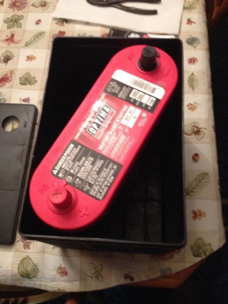

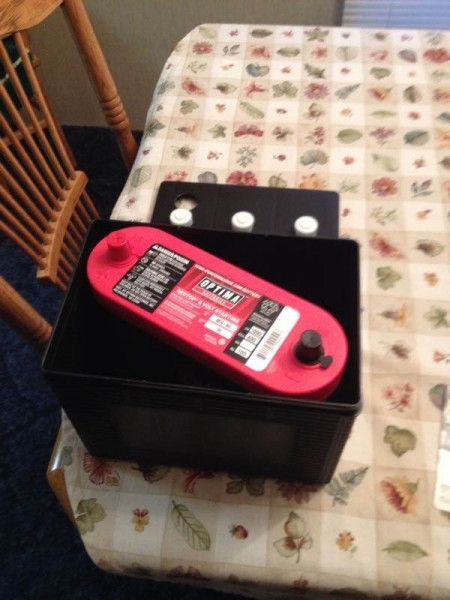

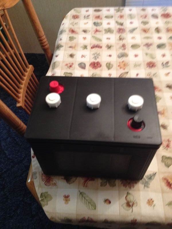

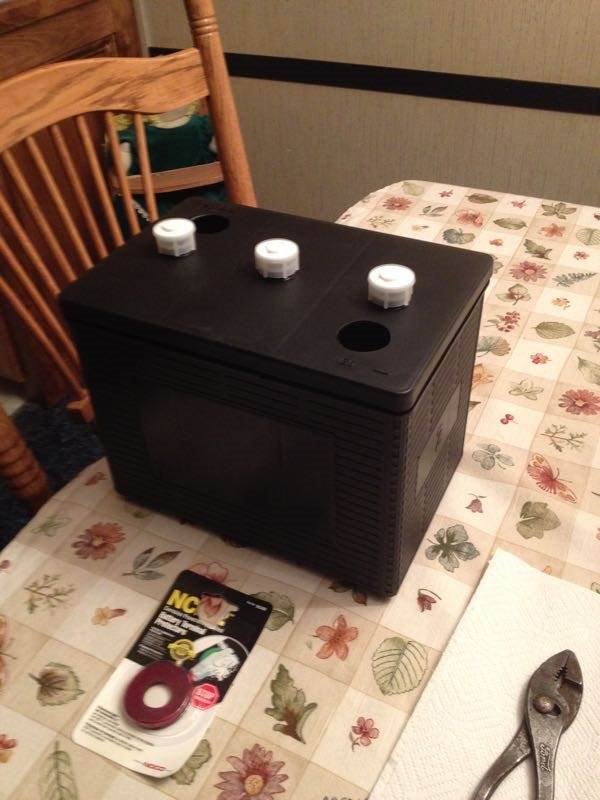

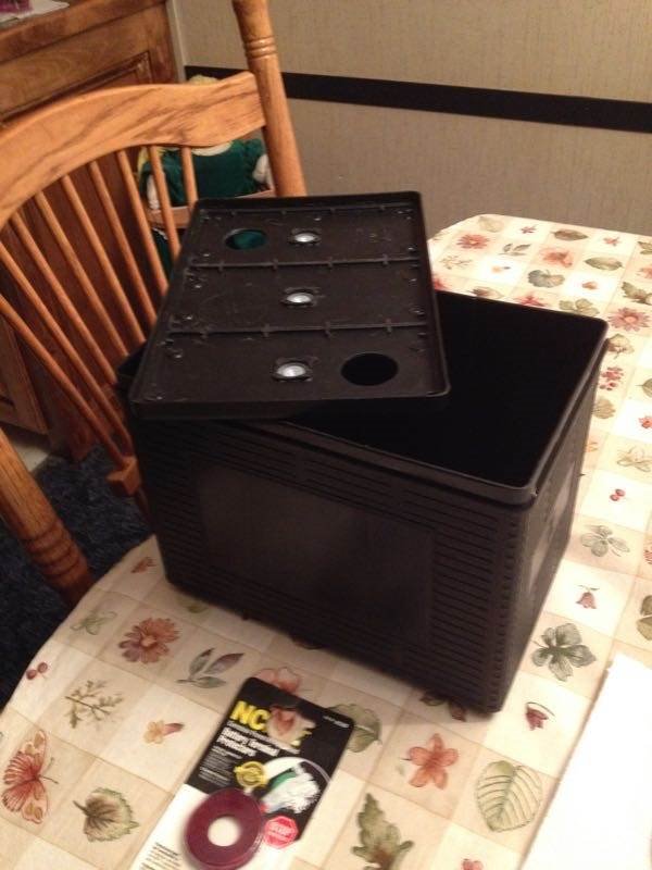

I found this optima battery box to look like an old style battery.
I had to enlarge my battery holder in the car,
Looks original in the car and performs Great,
