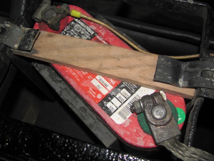

Yes on the 6v Optima. 800 cold cranking amps. Never needs a drink, and lasts for years. This one in the '24 touring is dated 2014 and still gives starts, starts, and starts!

The Optima is an AGM (absorbed glass-mat) battery, with special spiral shaped lead in the 3 cylinders, giving the Optima Red Top 6 v a different shape.
It will fit in the T battery carrier if you make a side board to keep it from rocking. Have installed it too in a metal repro battery T box, and used a spacer board cut like a wedge on two sides to keep it still in the box. Also made a thin plywood liner to the metal battery box top to keep from any contact of the terminals.

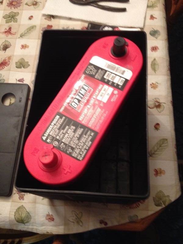

I found this optima battery box to look like an old style battery.
I had to enlarge my battery holder in the car,
Looks original in the car and performs Great,
