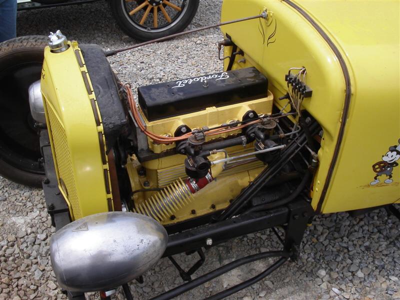

Here is my situation.
Stats on the car.
'26 Speedster
Warford trans
frontenac S head
It was build by my father-in-law.
Speed added by brother-in-law.
I added the electronic points hoping to help the situation.
When I picked it up from a good model T friend it ran quite well.
Now it seems that after driving a little over a mile.
it starts missing and dies.
It blows flames back through the carb and backs fire.
The fuel pump, filter and regulator has been there for a while.
The regulator was set to 5.5, I reduced the fuel pressure to 2.
Leaned the needle about 1/4 turn.
I am hoping to take it on the stroll in the morning.

Steve,. The Fronty single intake port head was designed to take a 1 1/4 inch carburetor that can mount right to the head if a fuel pump is used. The stock NH carb won't flow enought fuel much past half throttle. A side draft Stromberg works good and are around, get in touch with Stan Howe for what model Stromberg to look for, he may even have a Zenith like Fronty originaly used.
If you are on a budget you can use a one barrel downl draft carb off your six calendar 1964 1/2 Mustang and make a manafold.
Check the whole fuel system out, take the fuel line off at the pump inlet and check flow, now remove fuel cap, if flow increases with cap taken off check cap vent. If low flow at pump inlet check inside of fuel tank for blockage and crud. One more thing to check is the ground connection of the electric pump, a bad pump ground could lead to poor pump operation, make sure the pump is correct for your battery choice of 6 or 12 volts.
If you go to a flat head you will have to due valve guides because of the push rods require more room in a overhead rocker swing. If it was me I would find a good carb and enjoy the Fronty, you will be pleased.

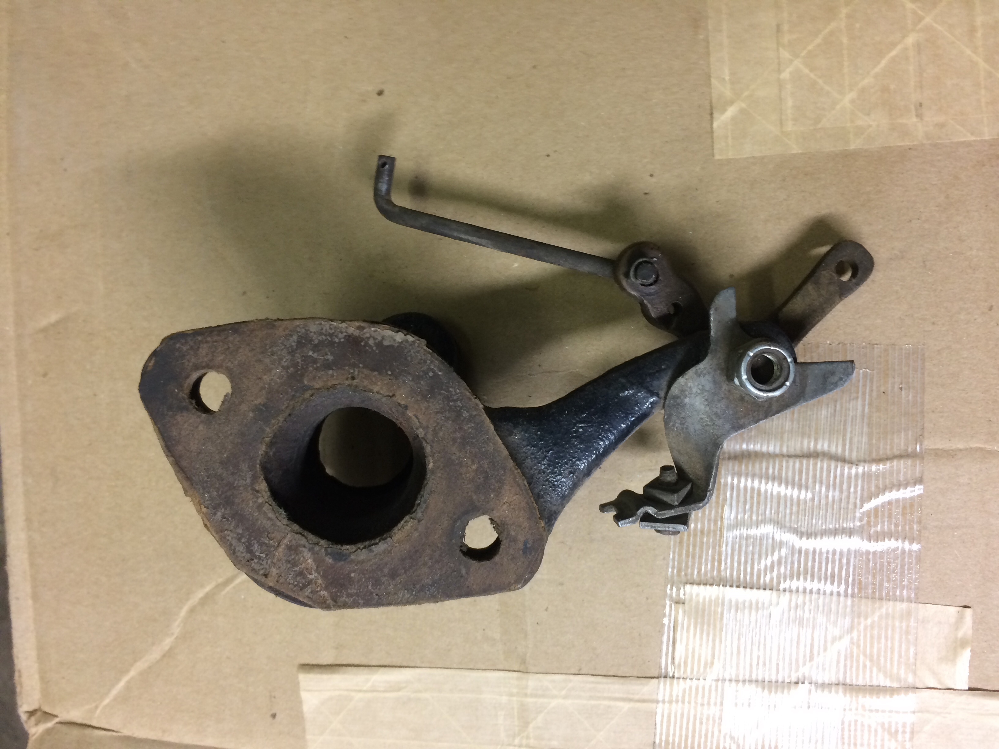

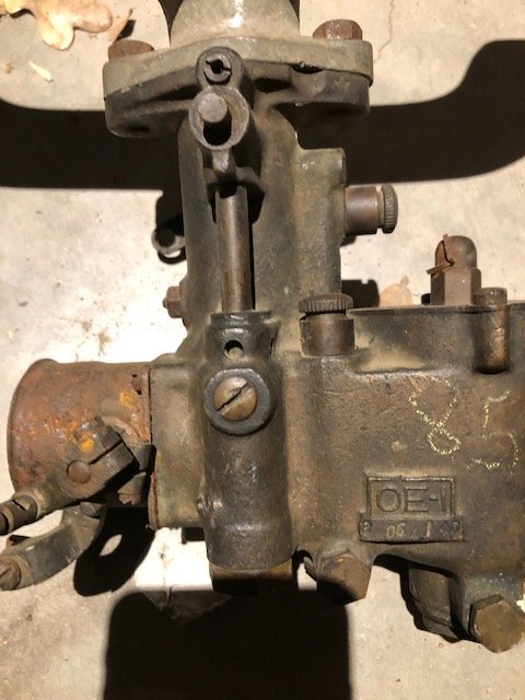

A NH carb will not run a Fronty head correctly. I like the Zenith HP5A if you can find a good one. Stan is your best mentor for choice. The overhead pushrods are the same diameter as stock valves so unless worn guides no problem if you go back to flathead and valve in block unless worn.
Fuel flow and a correctly matched carb and you will be fine. A stock T carb on a Fronty...the same as putting a govenor on it.
Tim Moore
Tim Moore

I run a model A carb on my single stick Fronty.

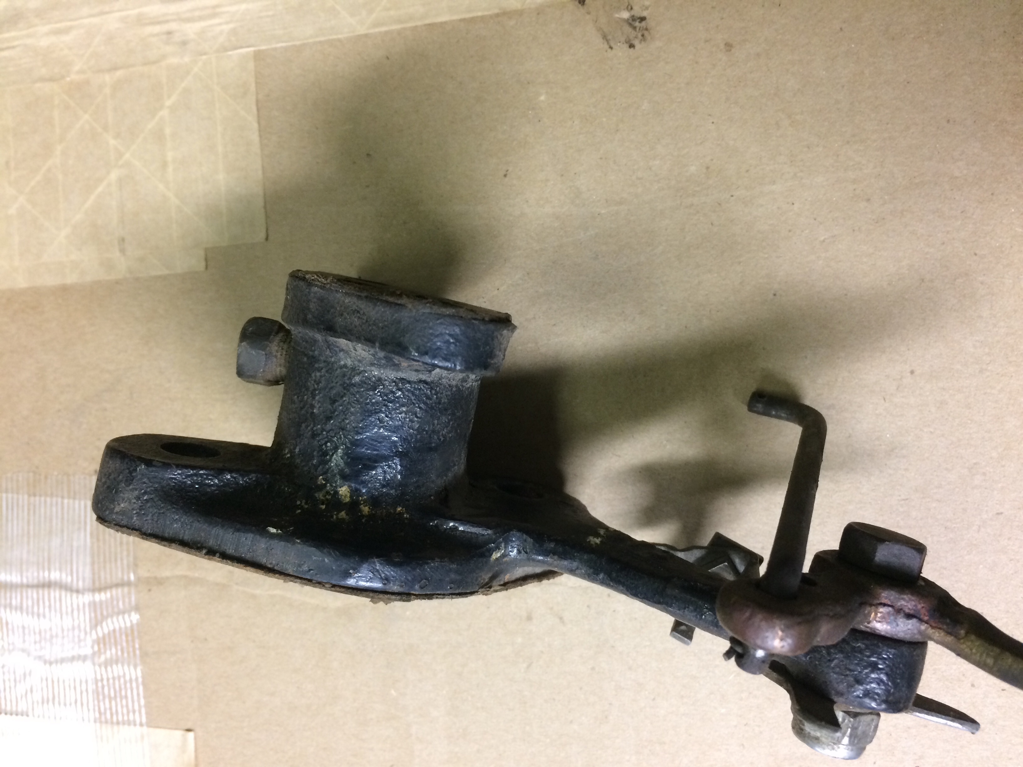

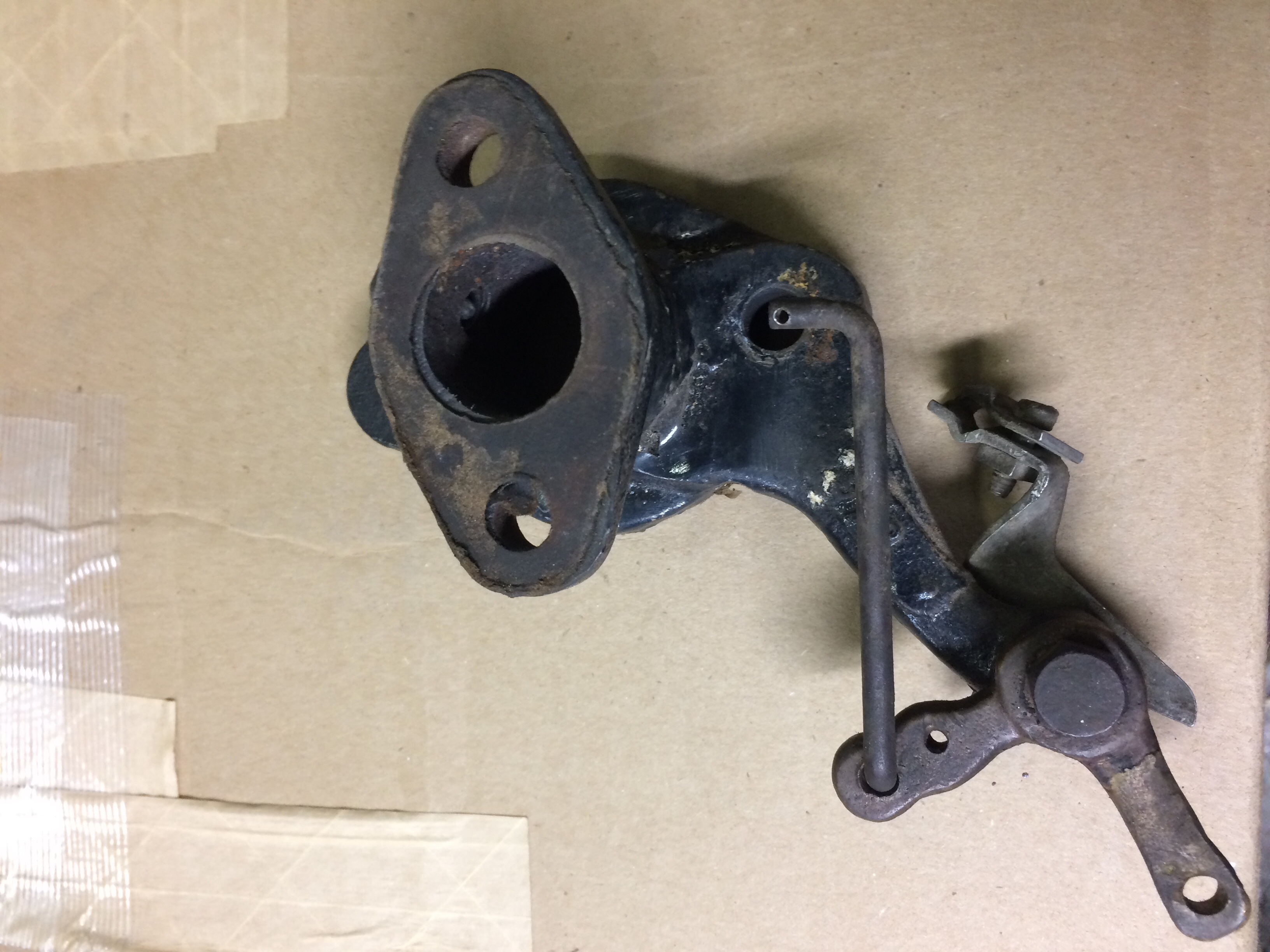

I will post a picture of the NH carb adapter later today.

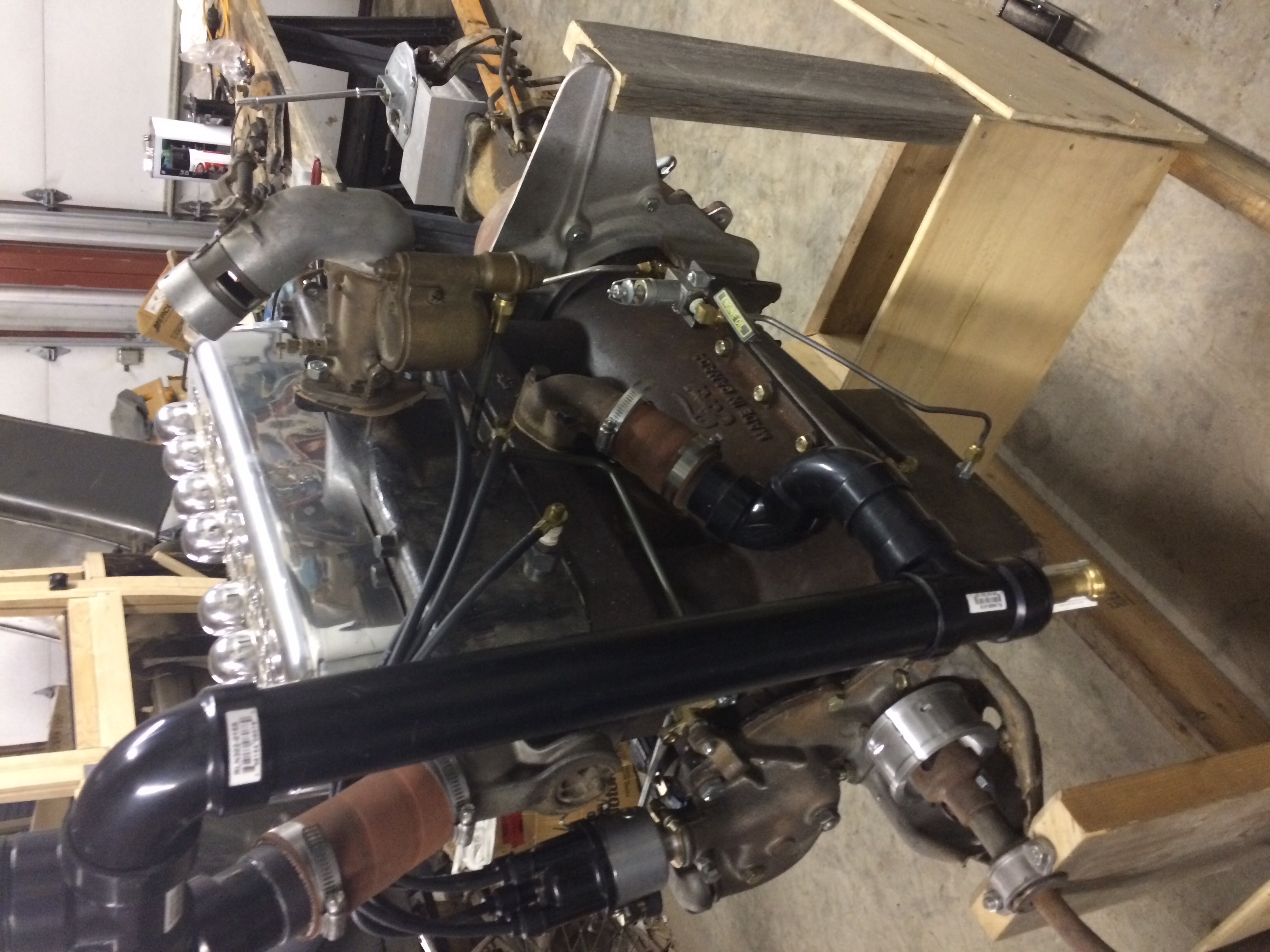

Here’s a dual NH set up.

Here are some pictures of the Roof factory NH adapter

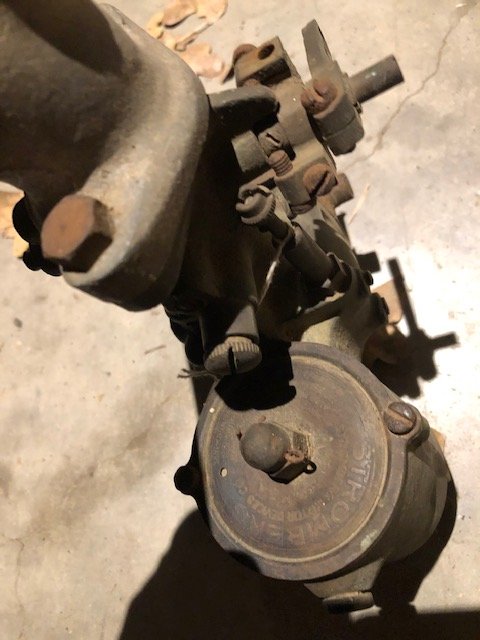

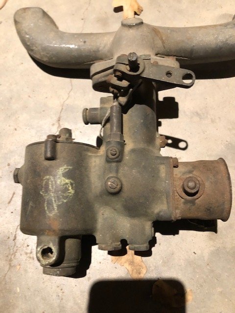

I was moving some boxes that was received from my late brother-in-law.
Found this Stromberg.
Would this work with the Frontenac?
What model?
Is a rebuild kit available?
Do you see any obvious parts missing?
What model?

That is an updraft and has the wrong mounting for your Fronty. You should be looking for a side draft carburetor similsr to this:
https://www.ebay.com/itm/STROMBERG-OS-2 ... Rk&vxp=mtr
If you could locate a copy of the original sales literature for the Fronty, you would see that a similar side draft was offered as the correct carb for that set-up. It would be a lot less work fabricating an intake manifold with a side draft.
Frank

That would explain why it was buried in a box.
Thank you for the link.
- Posts: 4408
Re: HELP It runs for about a mile and dies(Frontenac Touring head worth)
That's still a very nice set-up! But, not for your application...Mustang1964s wrote: ↑Tue Nov 24, 2020 10:34 amThat would explain why it was buried in a box.

We have a '26 touring with a stock head.
