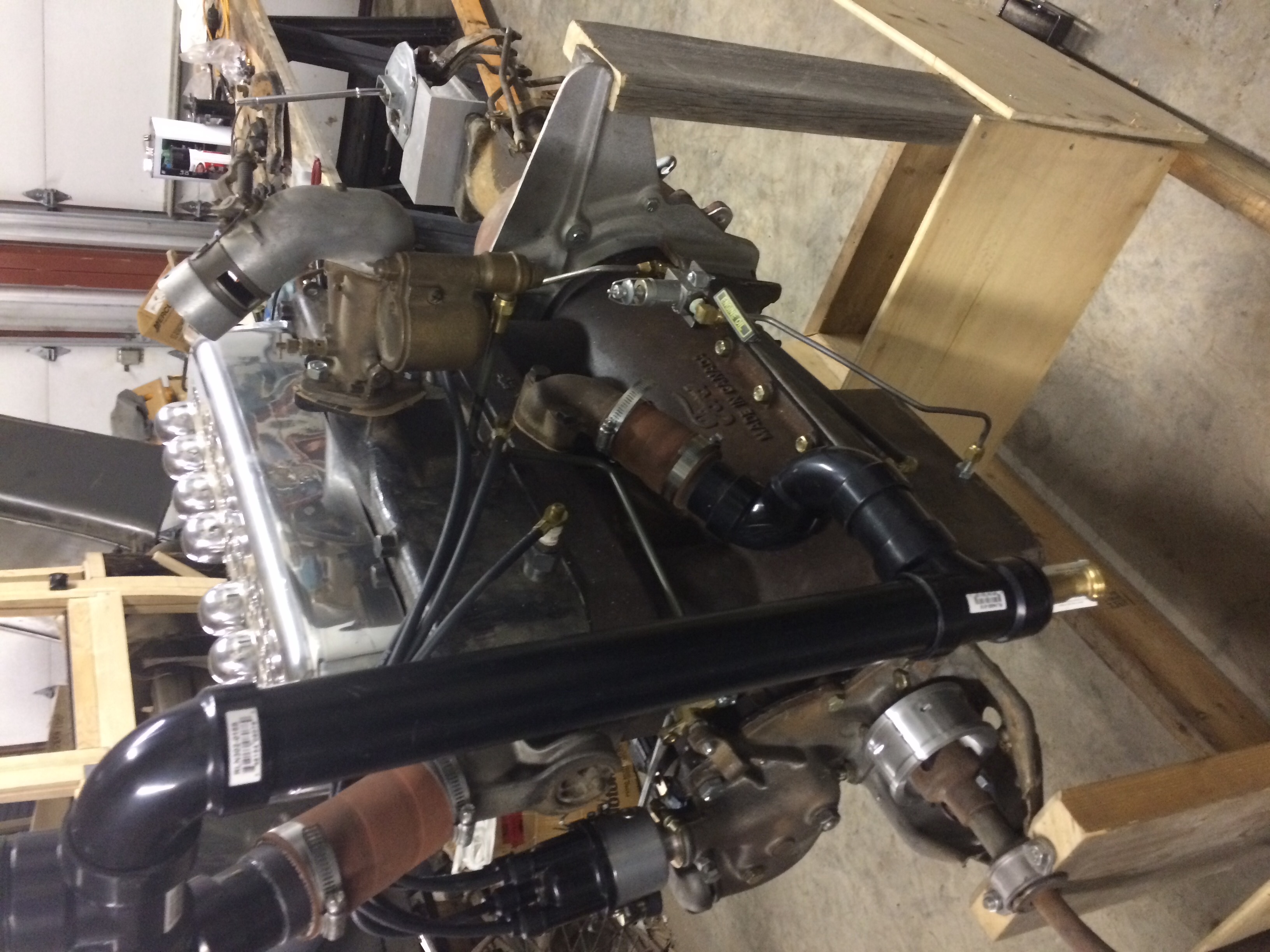

Re: HELP It runs for about a mile and dies(Frontenac Touring head worth)
Post by ThreePedalTapDancer » Tue Nov 17, 2020 11:26 am
Here’s a dual NH set up.

Here are some pictures of the Roof factory NH adapter
