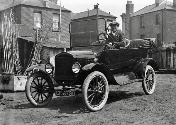

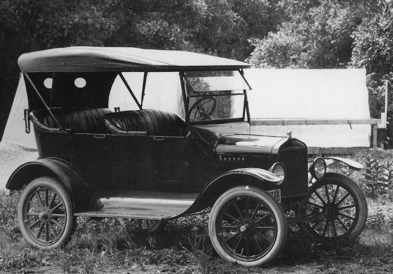

Ford used a lot of different windshield hinges between 1908 and 1927. The usual reference to "even" and "uneven" folding windshield hinges has to do with the straight windshield used on open bodied model Ts (USA built) between 1915 and 1922. The even folding windshield hinges were used on 1915 open cars which were late to market that year due to production delays with the new style front cowling on the open bodies. They folded the upper windshield glass down almost even with the lower glass, with the rear facing hinge pin roughly right in the middle between the upper and lower frames. This setup was not quite satisfactory for most people, feeling it lowered the windshield a bit too low for the high speeds driven back in those days. That design did however continue on through the entire 1916 model year and into the newer black era 1917 model year. With the late start for the 1915 model year, that design was used for basically two years of production, all of the short 1915model year, all of the full 1916 model year, and the first several months of the 1917 model year.
I have never heard of a given change date, however, I would speculate that the change to the "offset" or "uneven" folding hinge was likely right around January of 1917,mybe beginning slightly before? With the hinge pin moved up about two inches above the glass split, folding the upper glass all the way back and down left the two panes a couple inches higher than the earlier design. This seemed a better way with still enough wind deflection and enough cooling breeze for hot summer days.
Early 1917 open cars are easy to spot if the windshield is folded down (two photos). A little harder to spot if the windshield is up, but look closely at the position of the hinge pin.

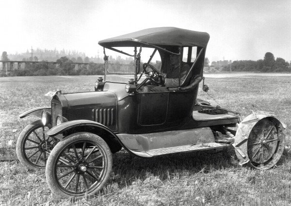

It has a form-a-tractor kit on it, but shows the later windshield folded down fairly well. Notice the differences.

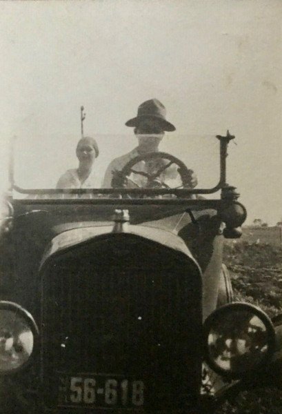

A couple more later ones. One up, the other folded down. Again, notice the location of the hinge pin, well above the top of the lower glass.
- Attachments
- stillshinyinterestingtouring.jpg (80.38 KiB) Viewed 3527 times
- stillshiny1920interestingfenderlamps.jpg (84.06 KiB) Viewed 3527 times
- Posts: 4404
Re: Windshield Hinges Question

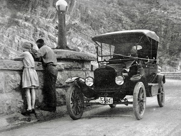

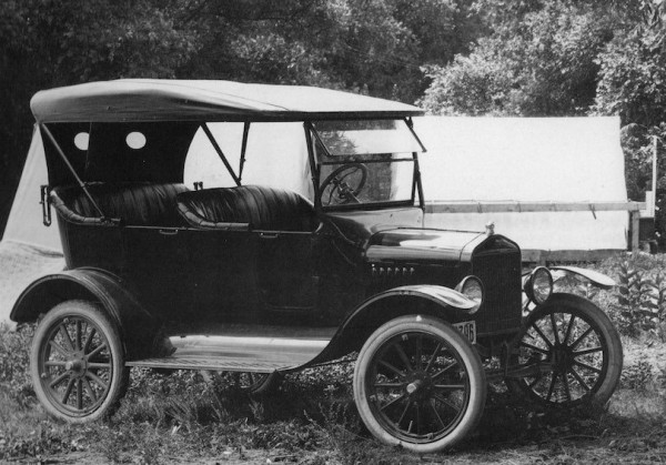

It should be noted also, that the photo with the man and child looking over the wall? Is a Canadian touring car. That is the reason for the top rear window (sometimes properly referred to as "lights") being different. Also, if you look closely, you can see the driver's door opens unlike the USA built cars. Canadian model Ts used basically the same windshields as USA cars from the brass era up until about 1919 or 1920. After that, Canadian windshields became quite different. Canadian cars got slanted windshields and one-man tops a couple years before USA built cars did. Also, later Canadian windshields had both lower and upper glasses "fold" (or more correctly "swing") whereas on USA built cars only the upper glass folded up and away for ventilation.
A couple more Canadian touring cars, with the later Canadian windshields.

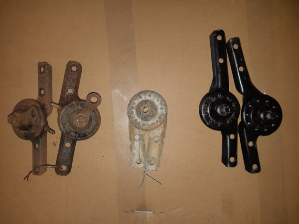

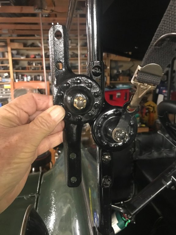

Here is a side by side comparison of the hinges. The later hinge has a longer bottom mounting thus moving the hinge point above center. I discovered sometime ago that I have the wrong windshield on my 21 Touring. One of these days I need to change out the hinges.
- Posts: 4404
Thank you John S! That should help some people a lot.
It also illustrates the forward offset fairly well.

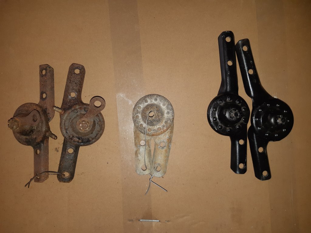

Hi All

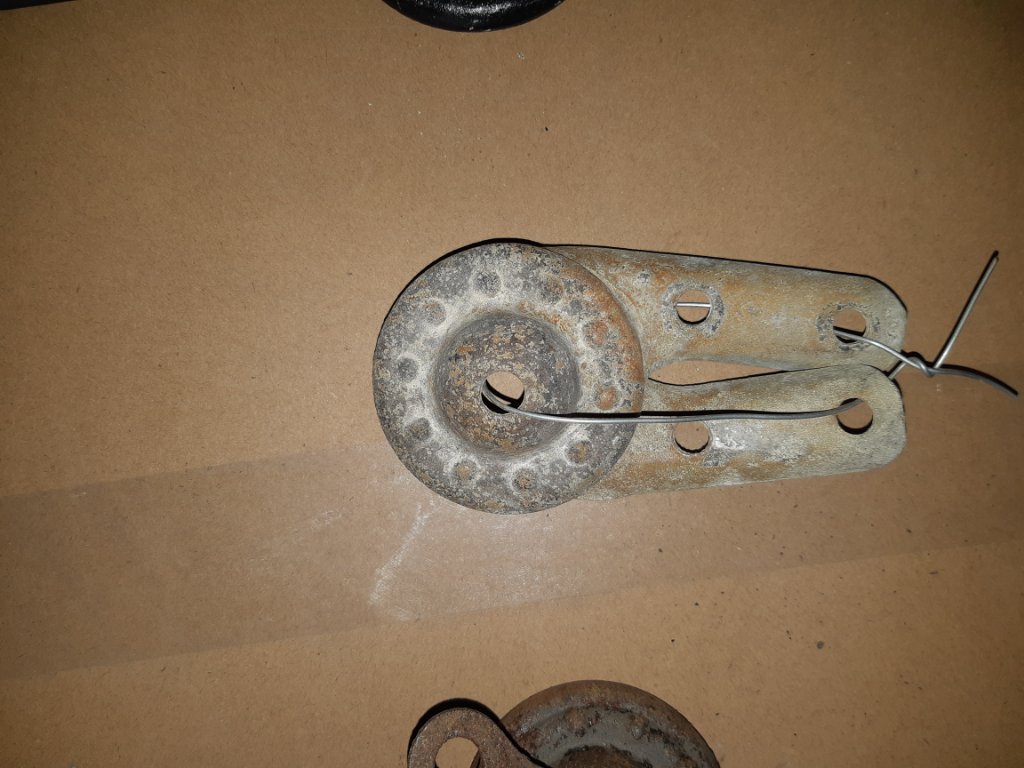

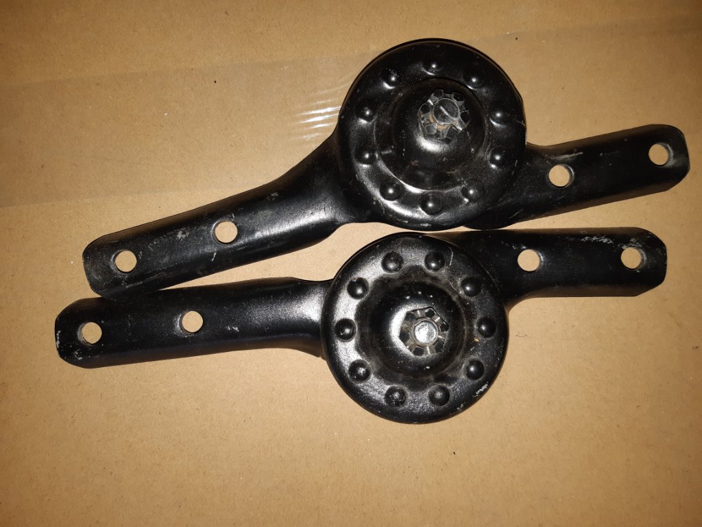

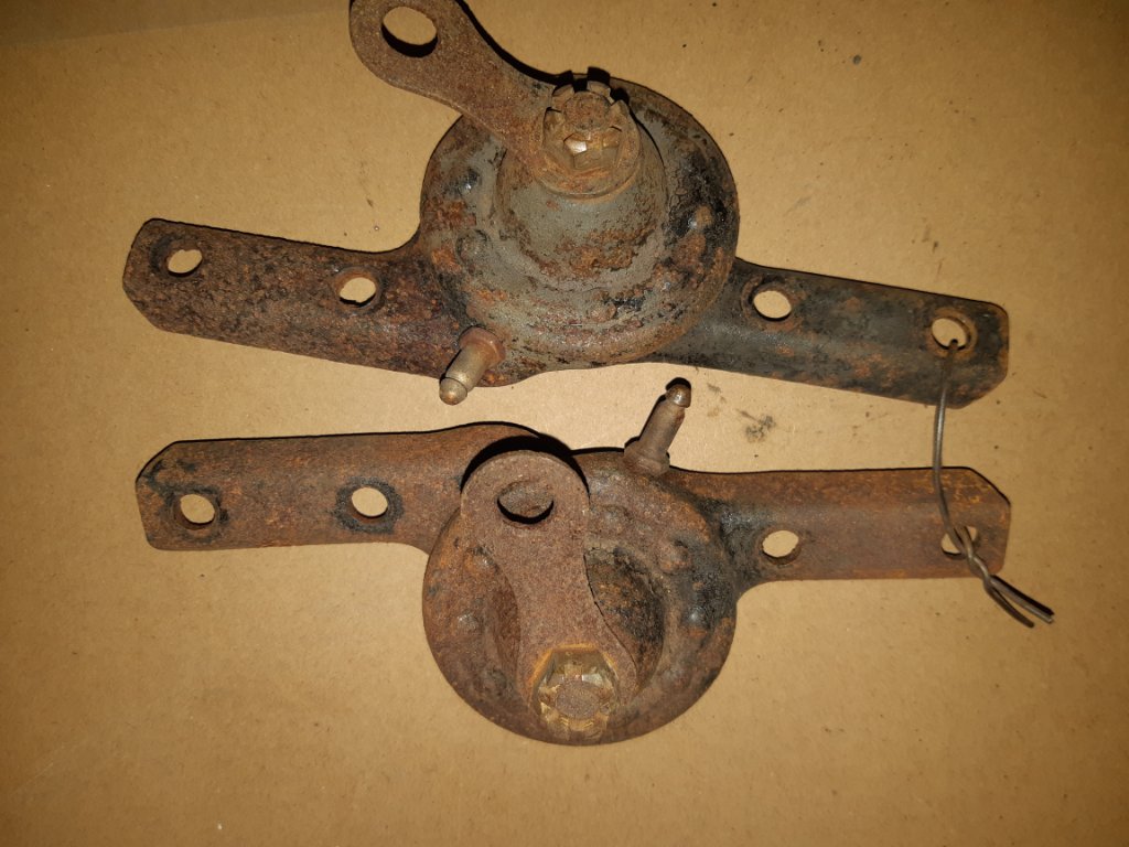

Here is some additional information on the differences between hinges.
I believe it goes something like, left '15 to sometime in '16. Middle sometime in '16 to '17. And on the right, '18 to '19 Canada, later in the US.
If you look close, the one on the left has a raised ridge between the indents and the middle one doesn't.
