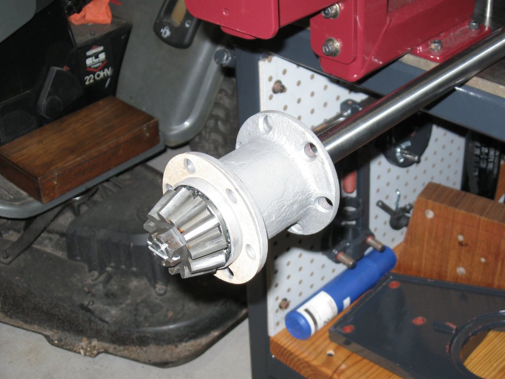

Well I'm done getting things apart and today and I ordered all the new parts that I couldn't get second hand. The only part on back order was the driveshaft bushing at the universal. Hopefully in a couple of weeks I'll be able to start re-assembling.
I got a set of detachable bands used and was glad to find them. I've ordered new linings and springs for them. I'm wondering how other people get slightly stretched bands (slightly oval, more then 4 or 5 inches between the tabs) back to round. I've searched the forums here and haven't seen much other then they should be round and not too open.
For the next few days I'm going to wash and paint parts so that I can scratch them up while putting them back together. :)
Thanks everyone for your replies. jim

I use an old T brake drum in the vice for a mandrel - there should only be a couple - 3 inches between the ears.

Post by Jim » Sat Apr 03, 2021 10:17 pm
Hi everyone
I'm making progress but a big set back tonight ( I think ).
I've finally got the sleeve on the shaft at the pinion end and the bottom end assembled and all looks great. Nice and tight. I ended up reaming it a lot with a socket and some very course emery paper wrapped around it that I have around. It took about 8 hours of trial and error and 350 degrees of heat but it's on.
When I installed the bushing at the universal end, the drive shaft went in but the pin didn't line up in the universal. Not even close. So I decided to take out the bushing and see what was keeping it from seating as it had to be the problem. The drive shaft pin hole was lined up perfectly with the access hole.
I don't have a puller so I set up the same way as I pushed to old one out - with the old drive shaft and a socket. The axle book said to use a socket with a 1.25 O.D. (15/16) so I found my impact 15/16 and measured it at 1.25. Stuffed it down the tube and .... sheared off two of the rivets in the tube.
Does this make my case a piece of junk? Can I put a couple of tack welds on the outside to make up for the sheared rivets?
Any way, I went and got a 13/16 socket that would clear the two remaining rivets and punched the new bushing out. When I got it out I compared it to the original that I'd removed very closely and they are almost identical in every dimension including the thickness of the bushing rim. What I did find was that the 1/4 inch hole that I drilled in the new bushing was exactly to low in the bushing compared to the old one - the difference I need to line up the pin. I couldn't see any reason in the shaft for it not seating properly so I guess I just need to give it a lot harder love tap when installing it. I may have to find something else to install it with then my 1 1/4 inch socket as it left a bit of a mark in the bushing surface on the first attempt.
Thanks for your help. jim

Post by Dan Hatch » Sun Apr 04, 2021 6:48 am
If the two rivets did not matter do you think Henry would spent the money to put them there? Either replace the rivets or the tube. Just my 2 cents worth.
Also , the bushing must be faced for the u joint the fit. This should be in the Service Manual and the rear end book. Good luck. Dan
PS nice set of Stevens Tool rear tools on eBay right now. Not mine just letting people know.
Posts: 7299
Re: drive shaft and rear end rebuild
Post by Allan » Sun Apr 04, 2021 9:32 pm
The sheared rivets are not that difficult to replace. I got a piece of solid round stock and ground four tapered flats on one end so that it could be driven down the shaft until it engaged the rivet heads. This became the buck against the rivet heads. Remove the sheared rivets and place two new ones in the tube. Then fit the buck and you are free to form the new rivets to suit. I have used this process a few times to fit new castings for two piece torque tubes.
Hope this helps, Allan from down under.

Post by Jim » Sun Apr 04, 2021 10:06 pm
Thanks Allan
I was able to pull one of the rivets with a pair of pliers and the other I had to drill out. I've attached a couple of photos just to see if I could.
I stuck a cheap aluminum rivet in the hole to see about fit. I've been informed about a specialty fastener place near here so I'm going there tomorrow to see if they have the structural rivets that seal themselves and have the shear strength and in steel not aluminum so that I don't have the corrosion of two unlike metals happening. (That's one run on sentence!)
We'll see what they say and will default to building the bucking tool if they can't help.

Post by Jim » Tue Apr 06, 2021 10:48 pm
Latest update
The driveshaft is back together and to speck! All I have left to do is peen the rivet in the universal joint. I ran out of time tonight.
The all steel blind structural rivets I got worked out great and instead of reaming the bushing I ended up having to shim behind it to get it thick enough.
Thanks everyone for your replies and ideas, its good to have a place to get help from people with experience.
Onto the axle re-assembly. jim

Another update:
I've got it all re-assembled except for the outer seals, sleeves and bearings. All seems to be looking and feeling really good. As I had the ring shims and shipping makes buying parts in dribs and drabs so painful I went with them. I ended up using .040 to get the spec on the back lash.
Jab35 - I sure didn't end up shaving any off of the thrust washers. I actually made my own shim from some .015 galvanized tin I had around. Used a hole saw, tin snips, and drill press to fabricate it but it looked almost store bought I must say when I got it done. Worked out well as it was just what I needed with one slightly thin steel thrust washer in the mix.
I've been thinking about putting a small (strong as I can find) magnet on the filler plug to attract any metal that develops on the housing from time to time. Sort of a way to keep track of what's going on in there. Has anyone had similar ideas or experience?
I'm hoping to get it off of the bench tomorrow and onto the floor to finish the outer axle stuff and maybe get it all painted up and back in the car on the weekend.
Frank - the perches arrived today with the card and are now on the backing plates. Very nice parts...much,much better than what I had. Thanks.
Thanks everyone for your ideas and help so far. jim

Jim, to get .040" I presume you used two .015" and one .010" shim. If this is the case, you now have 4 interfaces between the ring gear and the carrier where the original design is for one. Maintaining a firm and tight fit between the two components is now seriously compromised. The most likely scenario is that the clamping force afforded by the 10 bolts is now diminished at each interface and the gears will move under load, either in power or under braking, making the bolts take a sideways load they were never intended to take.
If you made a shim to go between the housings and the steel discs that was .040" thick, you could eliminate the ring gear shims.
