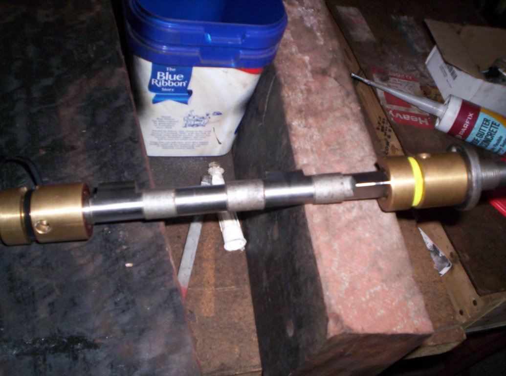

Dan, I have a cam that is well under size bearing grind and new bearings are machined bearing bronze, I've done this on a couple of Honda OHC' bikes that had sized as well and they pull 5 times the revs of a stock T.

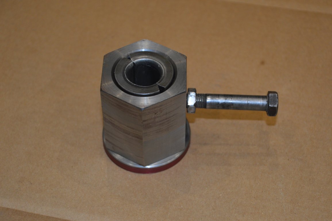

If the break line on the iron casting looks like a break and is not worn, you have good candidates for rebabatting. The fixture in the picture gives you enough babbitt to cut to any size you want. Call if I can help or answer questions, Bob @ nine o 3-824-194nine. PS some bearings were iron, with no babbitt, if you have them you’ll have to bore them to make room for the babbitt

We are working with wear limitations to get a GOOD ENOUGH outcome with these bearings, weather rebabbited or whats available new. As just mentioned "wear in the block". In many cases the optimal way, or only way to compensate for wear, is to hone the block & make custom bearings.
McMaster carr sells cast iron rod stock (done this) run in cast iron. Or make from bearing bronze like posted pix (beautiful work).

Dan This Is the fixture I use to Pour and Bore Model T Cam Bearings.
