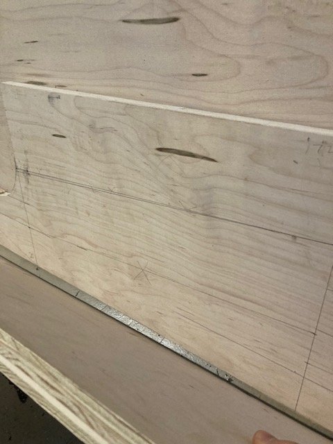

I am building a new body with some modifications with the old as a template so I don't destroy the 1912 body needlessly and I don't have to strip the paint or rough it up. I am to the point that I can scalp the front seat base lower for a speedster but haven't yet, see the markings on the first picture. I am told 3 inches above the floor board on the leading edge and 4.5 inches above the floor board on the trailing edge for comfort, 6.75 inches off the bottom edge of the body front part of the seat, 8.25 off the bottom edge at the back part of the front seat. I am wondering how to build the top part of the seat? I am told that if you have a seat bottom template that you can attach, bend, and cut sheet metal for the back. I don't have a seat bottom template.

Re: Da Body!
Is that making the seat lean forward? Shouldn't it lean back?

David is correct. You want the front of the seat higher than the back of the seat. Then I suggest making a platform for the seat templates. Hinge the platform to the front riser with a latch on the back. Then you can swing your seats up for access to the area under the seat. Your seat templates will be square in front and curved in the back. You will then attach these templates to the platform. If you would like pictures of how I did that, I need to use a camera, and I will do that for you. This software will not accept photos from my phone.
Humble Howard and others did a study on tilting seats in a speedster. Perhaps someone can pull out their speedster books and tell you what they found.

Re: Da Body!
Yes 1.5 inch lower in the back than the front is confirmed. Glad I asked. Yes please on the pictures. I am attempting to find the pictured hinges for the seats with no success so far. They are 4 inches long they may be called 'butt hinge' but only one side is butt and I am so far unable to find them this large.

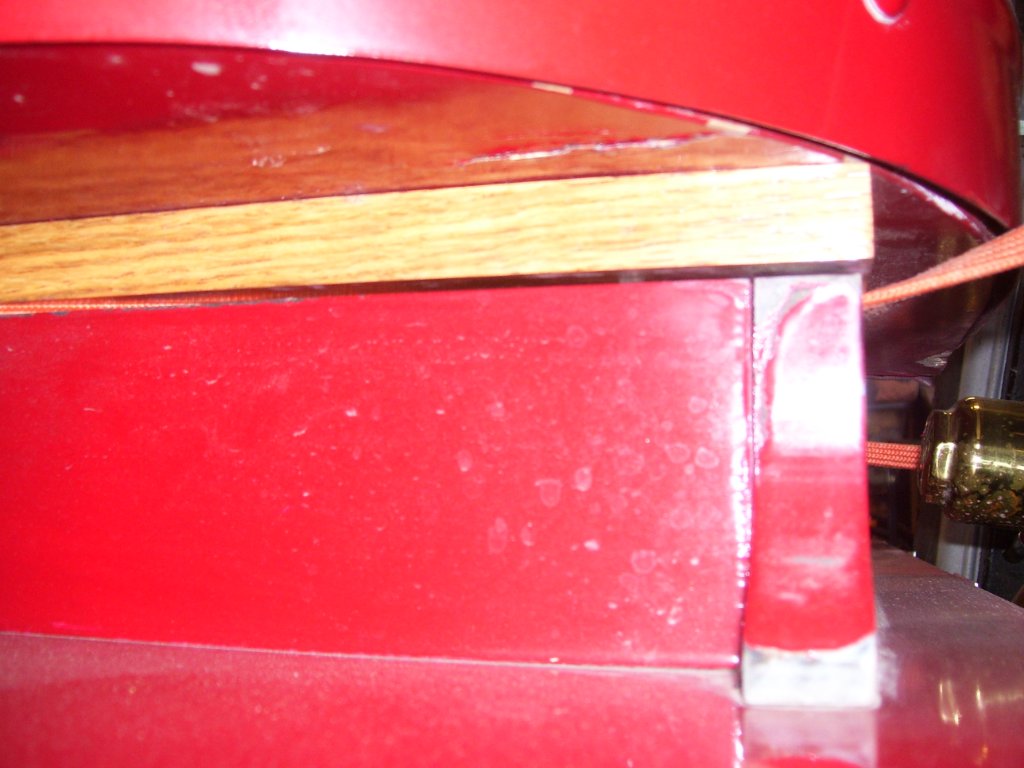

Seat riser with a slab of solid oak on top
Piano hinge the length of the seat. I was at the store and they had 4 hinges, 3 were brass plated and 1 was solid brass. You have to look. I did not want it to rust over the years as the plating wore off.
This is the underside to show you how the seat platforms were screwed into the oak slab This is the clip that holds the seat down in the back. There are neoprene washers because otherwise it goes click, click, click down the road.

I did not want to have to crawl under the car to get to the battery, so I cut a hole in the floor and installed a battery box. Look at all the storage space I have under here. To the right of the battery box is a converter that is not hooked up yet. 6V to 12 v for the cigarette lighter socket for my phone.
This photo shows you how I braced the four corners, again with brass, Speedsters get wet.
This is looking down at the bottom of the seat and how it was bolted to the oak slab.
This is just what I did. I hope it gives you some suggestions.
