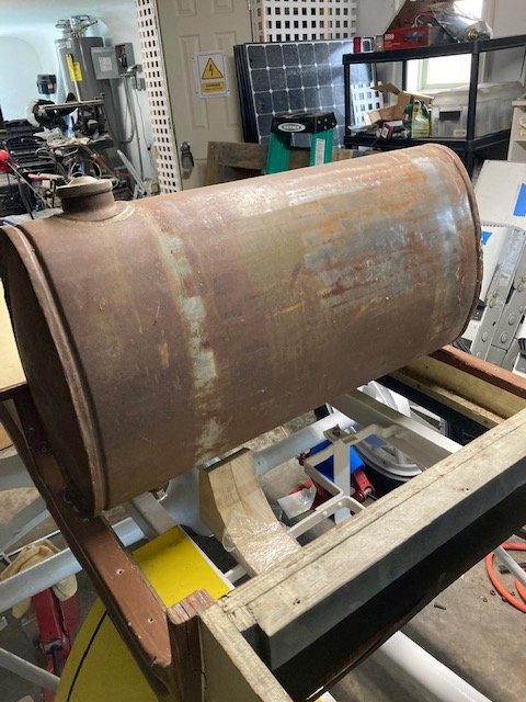

The rear crossmember humps up high inside what was the Mother-in-law seat platform. I don't plan a Mother-in-law seat at this time but would like storage. I think I would need to put a wood shelf support higher than what it comes with.
I am going to have to figure out a way to lift the gas tank to fiddle with the battery. The floorboard to be built for the gas tank I plan to lift up from the battery box (drivers) side but a rigid fuel line will be a problem. So either something I can temporarily remove like a outboard motor type fuel line clip or a flexible fuel line that will move with the tilt? Does that exist for T? The tank outlet is the same side as the cap so if it is on the passenger's side it won't move much on tilt up but it will have to move. Also some sort of rod or stand to keep it tilted while I fiddle with or replace the battery?

Modern style batteries don't need much fiddlin' .... if you get a good one.

Under the mother in law seat you want the floor as low as possible or you lose storage space. Cut a hole in the base, and cover the cross member with a piece of leather or vinyl. An Optima battery will fit better than a group 1 battery. They are not as wide. If you can put it under the seat you can use a battery box to hold the battery and then put the gas tank wherever you want. Front seat is then hinged so you can lift seat to get at battery.

Ignacio, Because you have that nice oval gas tank to mount behind the seat I would make a solid platform to mount the tank to and not try to use the stock T battery mount location. You could get a Rootleb wood speedster tool box with out the false bottom mounted. Reinforce the mother in law seat platform and mount the tool box on platform. You can mount your battery in the tool box plus have some extra room to carry some other stuff. You may want to lower the seat and mother in law platform to get the speedster lines you want. There should be plenty of room for under the seat for storage even if lowered.

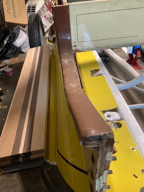

I am building a new body with some modifications with the old as a template so I don't destroy the 1912 body needlessly and I don't have to strip the paint or rough it up. I am to the point that I can scalp the front seat base lower for a speedster but haven't yet, see the markings on the first picture. I am told 3 inches above the floor board on the leading edge and 4.5 inches above the floor board on the trailing edge for comfort, 6.75 inches off the bottom edge of the body front part of the seat, 8.25 off the bottom edge at the back part of the front seat. I am wondering how to build the top part of the seat? I am told that if you have a seat bottom template that you can attach, bend, and cut sheet metal for the back. I don't have a seat bottom template.

Is that making the seat lean forward? Shouldn't it lean back?

David is correct. You want the front of the seat higher than the back of the seat. Then I suggest making a platform for the seat templates. Hinge the platform to the front riser with a latch on the back. Then you can swing your seats up for access to the area under the seat. Your seat templates will be square in front and curved in the back. You will then attach these templates to the platform. If you would like pictures of how I did that, I need to use a camera, and I will do that for you. This software will not accept photos from my phone. :(
Humble Howard and others did a study on tilting seats in a speedster. Perhaps someone can pull out their speedster books and tell you what they found.

Yes 1.5 inch lower in the back than the front is confirmed. Glad I asked. Yes please on the pictures. I am attempting to find the pictured hinges for the seats with no success so far. They are 4 inches long they may be called 'butt hinge' but only one side is butt and I am so far unable to find them this large.

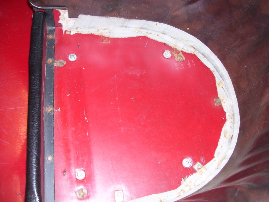

Seat riser with a slab of solid oak on top
Piano hinge the length of the seat. I was at the store and they had 4 hinges, 3 were brass plated and 1 was solid brass. You have to look. I did not want it to rust over the years as the plating wore off.
This is the underside to show you how the seat platforms were screwed into the oak slab
This is the clip that holds the seat down in the back. There are neoprene washers because otherwise it goes click, click, click down the road.
