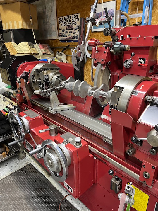

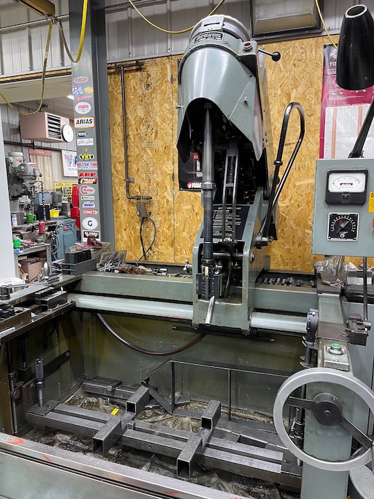

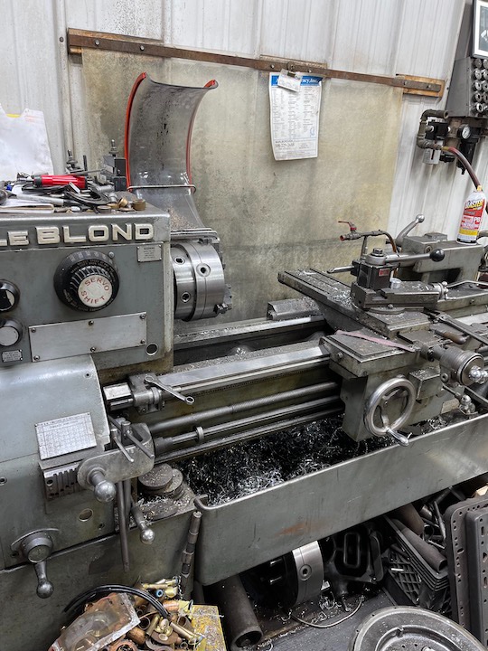

So I made a quick trip to MA this last week and I always try to stop and say hello to John and Michael at J&M Machine. They were instrumental in the work that went into the transmission of my T. I can't say enough about not only the workmanship but all the checking up on me as well. They are always giving me advice and extremely helpful. Hard to find people out there that follow up after the sale.
Here are some pictures of some of the equipment used.

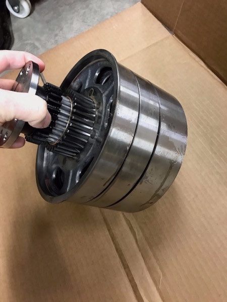

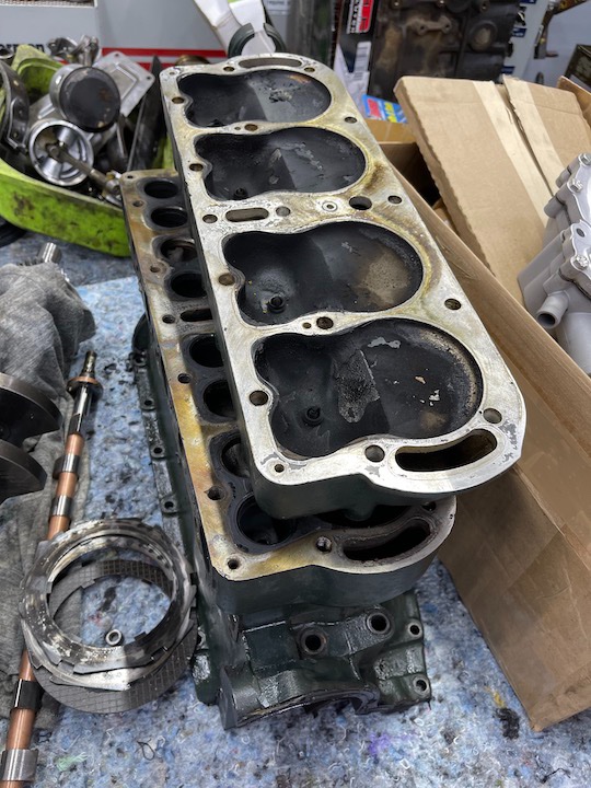

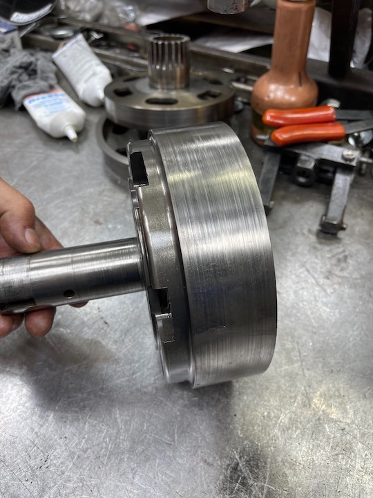

They also had a T engine in that had 1000 miles on a rebuild that someone did before it died. Car ran rich and gas was mixing with the oil.
You can see how bad the new drum got
Here is the head you can see where it was leaking.

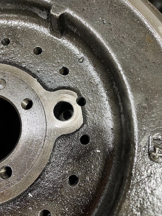

See the crack on the flywheel. The pins were put in wrong.

Not so sure about the wear cause. I did a re rebuild on a motor. The drums had a lot of wear. I assumed the trans was not done. Turned out they were new with less than 2000 miles on them. Ran with wood bands. During the rebuild process I discovered the drums were extremely soft. Never got the issue answered to my satisfaction. I dont know who made the drums, just that they were unmarked, new, CNC machined.

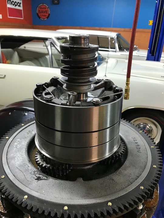

J&M Machine makes their own drums. I've got them in my car. They have new gears pressed on them as well not old gears pressed on a new drum.

The drums I saw had used gears. Do you happen to know the hardness condition of these new drums? How do they compare to Henery's?
Would like to know if I need to refer or run out of good original drums.

You are correct the drum shown has a used gear. The ones J&M Machine makes have new ones.
This is what they look like.

Another look.

The Drums you mention are also the same in picture that Mopar man took, fully machined.
We make our own drums and gears; with "Batch number J and M Machine Southborough MASS" cast in. Ours are made from class 20 Ductile iron. We don't have mentioned issue of drums being "Soft".
Herman Kohnke had used our drums in a Montana 500 car that he did engine on. They ran it out of oil for whatever reason. Though drums got really hot other than replacing bushings they were good as new and still turning today. There's a post with pictures of this in the forum somewhere.
Our drums are also in the cars at Dearborn Village driving visitors around daily.
Ours are better than Henry's drums as his were cast iron and not Ductile as ductile gives the metal ability to bend rather than crack like originals do/did. They're made to Ford's print right down to broaching of the brake drum lugs.

Since your drums are identified, I know the ones I had to resurface were not yours. Run with wood bands less than 2000 miles, were all scored up.
Have you done a rockwell hardness test on yours VS original drums?
The drums I redid were very soft. Like the difference between 6061-t6 & t0. Did not cut well with cobalt, hi speed or carbide. Original drums cut very cleanly with that same carbide cutter. Ended up grinding to get a satisfactory finish. I could see that a softer, giving drum could dissipate heat & expand & contract without cracking. Is this a planned trade off? (A further fail safe with kevlar) I am concerned the softer material might wear sooner. I have not been back in the reground drums transmission yet to see for myself.
This a personal fact finding mission. Not judging your product. By all accounts your drums/product is top notch. Very respectfully submitted. Thank you.
