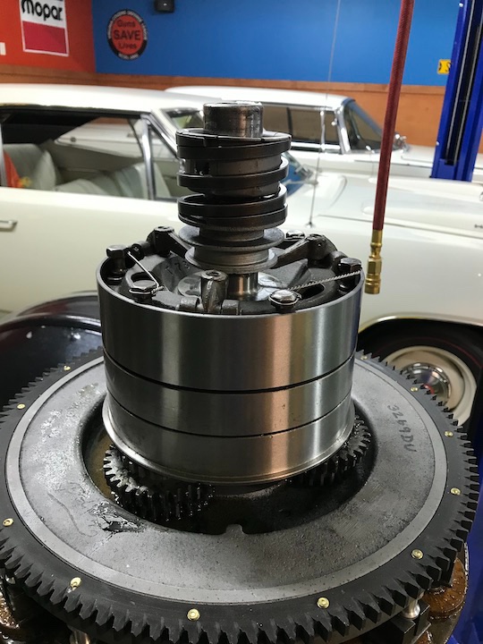

Here are some pictures of some of the equipment used.

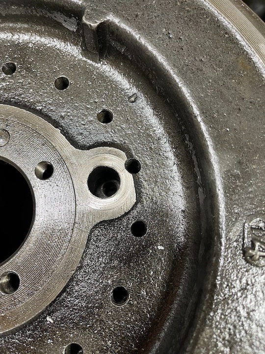

They also had a T engine in that had 1000 miles on a rebuild that someone did before it died. Car ran rich and gas was mixing with the oil.
You can see how bad the new drum got
Here is the head you can see where it was leaking.
See the crack on the flywheel. The pins were put in wrong.

Not so sure about the wear cause. I did a re rebuild on a motor. The drums had a lot of wear. I assumed the trans was not done. Turned out they were new with less than 2000 miles on them. Ran with wood bands. During the rebuild process I discovered the drums were extremely soft. Never got the issue answered to my satisfaction. I dont know who made the drums, just that they were unmarked, new, CNC machined.Mopar_man wrote: ↑Mon Sep 27, 2021 11:29 amThey also had a T engine in that had 1000 miles on a rebuild that someone did before it died. Car ran rich and gas was mixing with the oil.
