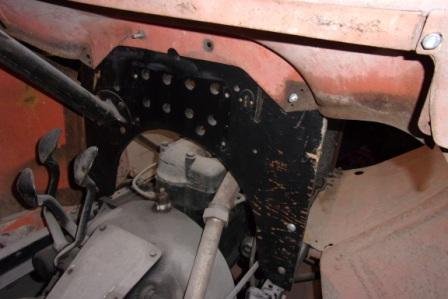

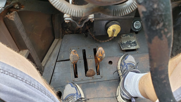

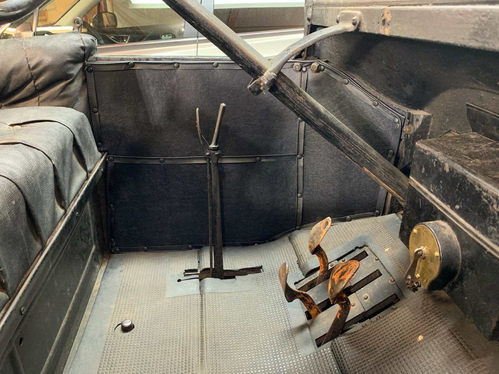

So, next on the inquiry list is the dashboard area. Seems that this jigsaw puzzle 20 roadster I am taking on as a project is a starter engine with the body of a non electric roadster. So, coil box mounted on firewal between driver and passanger, third pedal just barely clears the top and has non key switch on it. I'll take some pics tomorrow. But no dash came with this body as I have read that a non electric car would not have one. A mount for a foot starter switch riveted to the frame, but the seat riser flat floor skin is not drilled for the switch. And, no battery carrier on the frame and no access panel in the rear platform for the turtle deck.
So, if I want to leave the starter and install the foot starter switch and a battery carrier, what would be best for ignition switch. Do I get a dash, install key switch for battery and magneto and an amp meter? I hav a short wooden platform on two angled mounts on the depot hack that holds a amp gauge and switch. Can I mount something like that on the metal cowl? If I go with a key switch on some sort of dash, do I replace the coil box with a non switched one? Or just leave the coil box on all the time and wire it to the keyed switch?
I know I'm kinda making Model T salad here, but I'm trying to keep this family heirloom project in the condition of parts that it was entrusted to me with. Any suggestion appreciated.

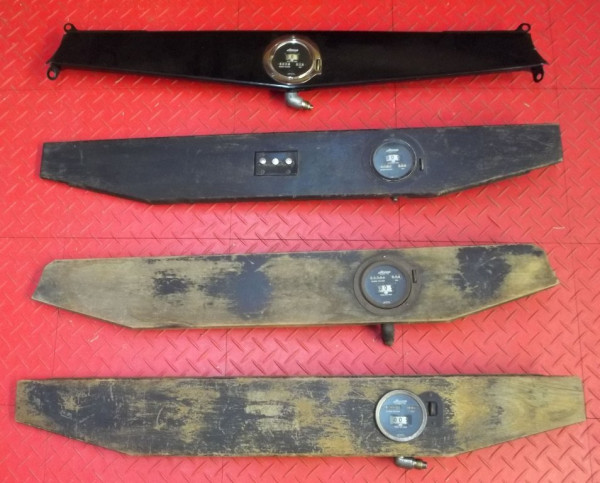

Accessory dashboard were available from Stewart Warner. I would not change the coil box as your car was originally a non-starter car. Here are a few photos of what Stewart Warner offered. I hope this helps, Russ Furstnow

Didn't think about head lights, but I will need some sort of switch for the head lights and a place to mount it and I haven't figured out the choke rod location with no dash yet. So perhaps leave the original coil box in place on the firewall and add a full length dash of some sort, either a roadster metal dash or even make a full width dash out of wood? I'm looking at some dashs for sale on eBay and no two are alike even though described as roadster dash for this model year T.

Since your car is a car that’s going to made up from non-starter and starter car parts. I think the kind of engine you are going to use which is a starter generator engine is the determining factor about which dash you should us.
It will be simpler to use a metal starter car dash, the coil box without the ignition switch and the ignition switch that mounts in the metal dash. It has the ignition switch, amp meter and the light switch built into it.
Drill a hole in the heel kick panel for the starter button and get you a battery holder. Drill the holes in the frame to mount it and install the battery.
It’s either doing that or using what you have as is with the starter generator engine. Either way you go your not going to have a 100% car a purist would build.
After all Ford added a starter to his Model T for a reason. It was to improve the car and make things easier for the owner.

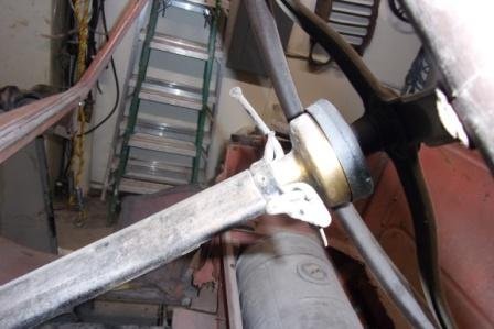

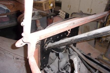

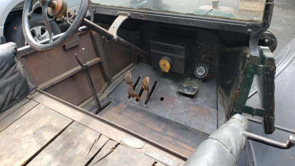

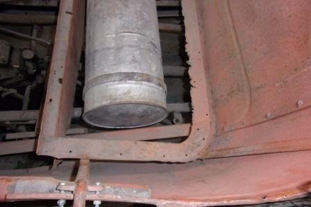

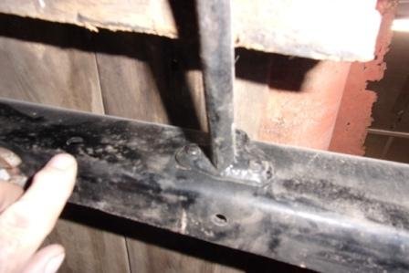

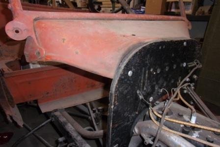

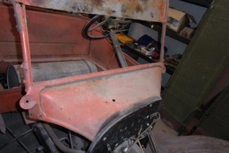

As you already know... there is no right answers to a T... especially if your is a Bits-n-pieces car. I have a 1915 cut-down touring that has a 1922 starter engine in it. My father and I ran into similar questions as you are running into. Compounding our decisions was the fact that the front part of the touring that is left is in really decent original condition albeit with some small modifications over the 107 years since its January 1915 manufacture date. These photos show what we did, right wrong or indifferent, there is no right way when working with a car like this. I hope they gives you inspiration as you find your own way.
P.S. since these photos were taken I have installed a Rubes horn, and some day I hope to find a close to correct style speedo to fit in that floor board hole.

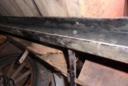

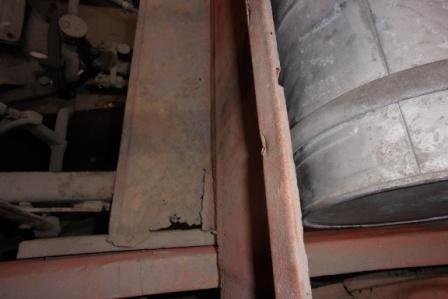

And again, there's no right way when dealing with a car like this... but I wanted a battery for the starter, and so dad riveted an old battery holder into my frame for me.

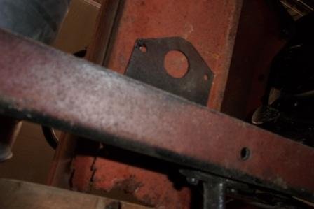

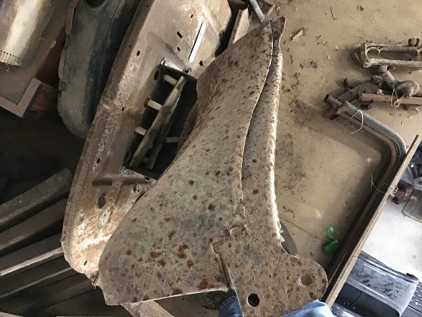

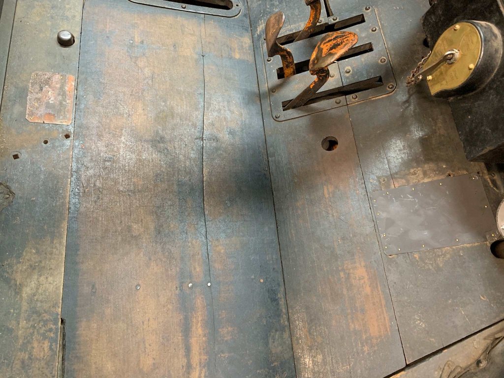

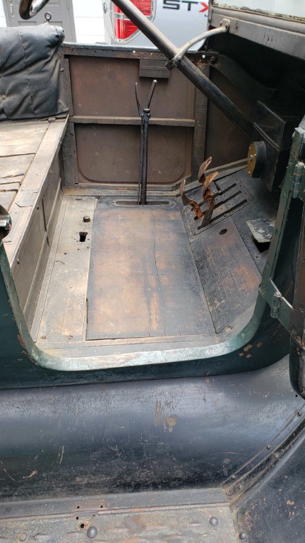

Bob, I'm with Andrew. The 18 Runabout here has a 23 engine with the starter switch on the flimsy steel lower heel board?
Coil box is in place with switch. The frame had been drilled for a battery holder, likely in the 70's and the holder bolted right in.
I do a Jelf and put the key in upside-down so I don't kick it OFF when I hit the brake pedal.
Works great! I put the old hand-made dash on the wall.

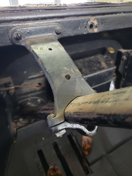

Retro54 Is there a name or any markings on the column support in your car? Interesting to see one like that as the ones I’ve seen were straight and not curved like your is.
Your correct about doing what you need to do when you have a T that’s has parts and pieces from different years.

Here are two of the aftermarket Stewart dash boards on Ebay….
https://www.ebay.com/itm/115134584375?h ... SwhWZhsnR3
https://www.ebay.com/itm/383699070459?_ ... 101224.m-1
Retro54
- Posts: 590
- First Name: Andrew
- Last Name: Blaydon
- Location: Middletown
Re: To Dash or not to Dash. That is the 20 Roadster question.
No name that i can see or recall... here's another shot I just took. Hope its not too much thread drift.John kuehn wrote: ↑Sun Jan 02, 2022 9:34 amRetro54 Is there a name or any markings on the column support in your car? Interesting to see one like that as the ones I’ve seen were straight and not curved like your is.

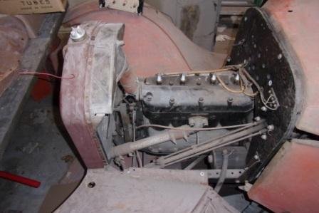

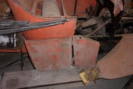

Drift away as I,myself, am drifting away from the original dash question and now seeking any info I can get on how to proceed with the ID and restoration of this family inherited T. Again, it looks like electric running chassis with non electric roadster body sheet metal. Here are some pics to help with my narration.
Some items that I am questioning...
Cowl does not seem to have mounting holes on side for windshield supports. Non on the drivers side and only one on the passenger side.
Large hole in center top of cowl ???? for what purpose???
No mounting holes on steering column for headlight or horn button, but if this was an electric chassis item, presume switch and button would have been on the dash. I do have a six volt trumpet horn with this T.
Coil box was mounted on firewall, but appears to have been restored already along with wooden firewall. No hood former mounted, but is in parts stash.
Primer painted windshield presume came with primer painted body sheet metal, but I have a second full windshield with oil cowl lamps on t. No head lights or irons found. Radiator and shell as pictured. No dash on this cowl and not in parts stash. Sheet metal is mounted to rotted wood supports and some original wood is on inside of sheet metal and bows.
Leaning towards getting a dash and mounting no switch coil box on firewall and putting light switch on dash and correct horn button where it should be along with ignition key and amp meter. In effect, making this an electric body. Installing foot starter switch and battery in frame mounted carrier with access from under car and not cutting access door in platform and turtle deck. Getting carrier from John and two rear fenders from Daryl in NC. Looking at dash from eBay seller in Ont, CAN and will need to find some head lights and irons for mounting and a tail light along with a million small parts. I will need a complete wood kit and then the fun begins.
See anything I need to know, let me know. I have done one T before, so have a little basic knowledge. And, I may complete my 26 depot hack before really getting into this T so I can "gear up" for taking this on for the supreme commander.

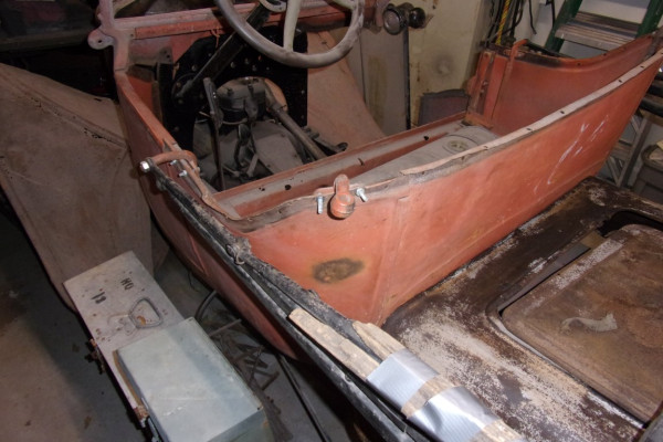

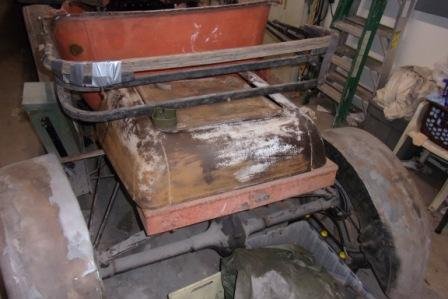

More pics . . .

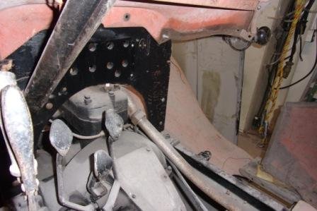

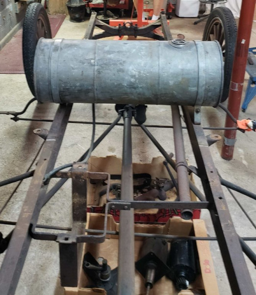

Holes in frame for starter switch and battery carrier appear factory, but if rolling chassis is electric, that would make sense...

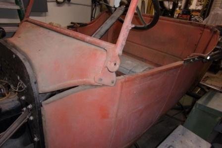

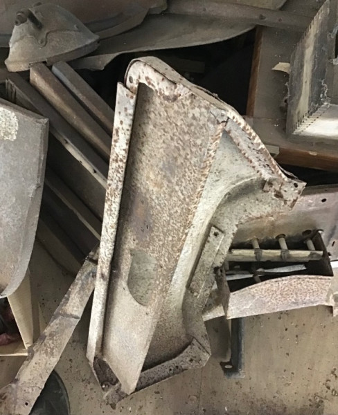

I am presuming that all sheet metal I received is all from the original body. But pieces may have been acquired seperately and I'm trying to make them fit together. Seat skin primed but loose passenger door is not?

- Posts: 4638

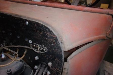

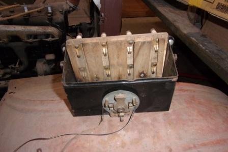

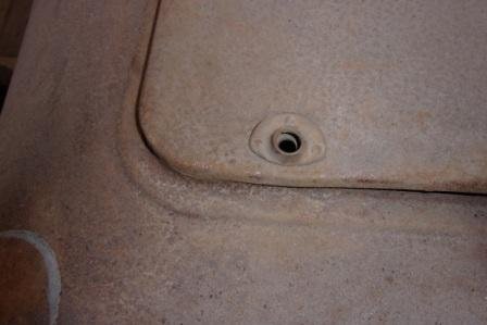

Signup——-You mentioned if I read your information right that your cowl hasn’t got any holes to mount the windshield brackets on it. Another question is what the center bolt on the cowl was for. I have a 19 Roadster and a 21 Touring and they do have the center bolt on them.
The cowls on the inside and partially on the lower portion have a metal bracket frame work that stiffens the cowl and where the windshield brackets mount through. Here are some pics of a real rough dash and cowl I saved for the low cowl cars like you and I have. One side has a ear broken off and the other side still has it intact. Maybe this will give you an idea how your windshield brackets mount and what the bolts go through. And the metal firewall that’s in the pics is for the later hi cowl cars. Late 23-25 and not the earlier low cowl cars. Your car doesn’t take the earlier hood former that was used on the 15-16 models. I think you asked that question too.
I hope these pics can help!
Hap_Tucker
- Posts: 403
- First Name: Hap
- Last Name: Tucker
- Location: Sumter, SC
Robert,
If your 1926 is closer to being on the road, I would encourage you to get it running first. Having one that drives is a big encouragement to most of us. (And one that also stops.) Although it sounds like you may have another one that is driveable? And if so then you have one to help keep you motivated. I would not normally recommend taking two cars apart at the same time. It can be done, but if you get discuraged then they are both basket cases. And if you only take one apart at a time - then only one is a basket case.
In the future, recommend you post higher resolution photos. Folks cannot zoom in much on the low resolution photos you are posting. But if you post a higher resolution photo when you click on the photo it takes you to a copy that you can zoom in on and see additional details. Sometimes that can be a big help.
Also if you can add your comments close to the photo that can help also. For example I reposted your wooden firewall photo below:
Above notice that there are only 9 holes for the porcelan insulators that stick out of the back of the coil box to go through the firewall. The coil box without the switch on the front only has 9 of those porcelan insulators. The coil box with the switch mounted on the front has 10. A standard 1915-1922 coil box with the switch on the front will not mount to that firewall without adding another hole or removing the extra insulator from the coil box. So it looks like the firewall was set up for a starter car coil box (1919-1925).
The running board brackets that are shown in the photo are the 1915-1921ish style before they went to the pressed steel running board brackets.
The horn button for both the non-starter and starter USA cars 1919 - 1927 mounted in a bracket that attached to the steering column.
And I don't know of an easy way to use the original style batter carrier/bracket and not have a door of some kind through the floorboards to put the battery in the bracket or to check and add water etc. The Roadsters/Runabouts had an opening covered with a door that was inside the turtle deck. Perhaps someone with more experience with the starter equipped cars will know more about that. I've only had one starter equipped T so I've got lots still to learn about them.
If you or anyone else would like a free copy of the R.V. Anderson's article that he wrote about rewooding his 1923 (low cowl) roadster -- send me your e-mail address, put "send 1923 Roadster rewooding article" or something similar and I will send you a copy. I'll try to send you a note with my e-mail using the contact on the forum. You can also click on the "contact" on the right side of the posting and send me your e-mail. [Hey -- when I send you the e-mail -- it may show me what your e-mail addres is, and if that happens, I'll send the article to you tonight.]
The top of the cowl is not suport by the firewall -- rather the cowl is part of the body and the body is fitted to the frame and the front is bolted to the firewall. So there is a good chance your poor body panel spacing is caused by the lack of the wood skeleton / structure in the body or could be the firewall is higher than it should be or a little of both?
A quick look, it appears you have the low cowl body parts -- which would be correct for 1920.
Respectfully submitted,
Hap l9l5 cut off
